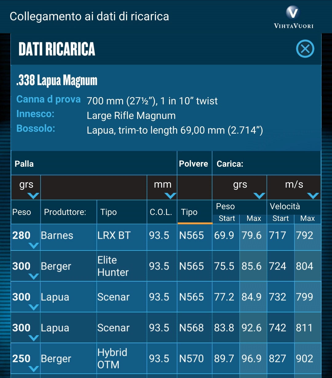

Anybody try n565 with their lapua and 300gr bullets? Looking for a retumbo backup and I have 8-16lbs of n565 available.
I know it will work fine, more so looking for reloading data and numbers to compare to.
I enclose a quick screenshoot from their app with selection of N565 and 300gn bullets.
Sorry, measures are metrics,col in mm and speed in meters per second.
I hope it could help.
