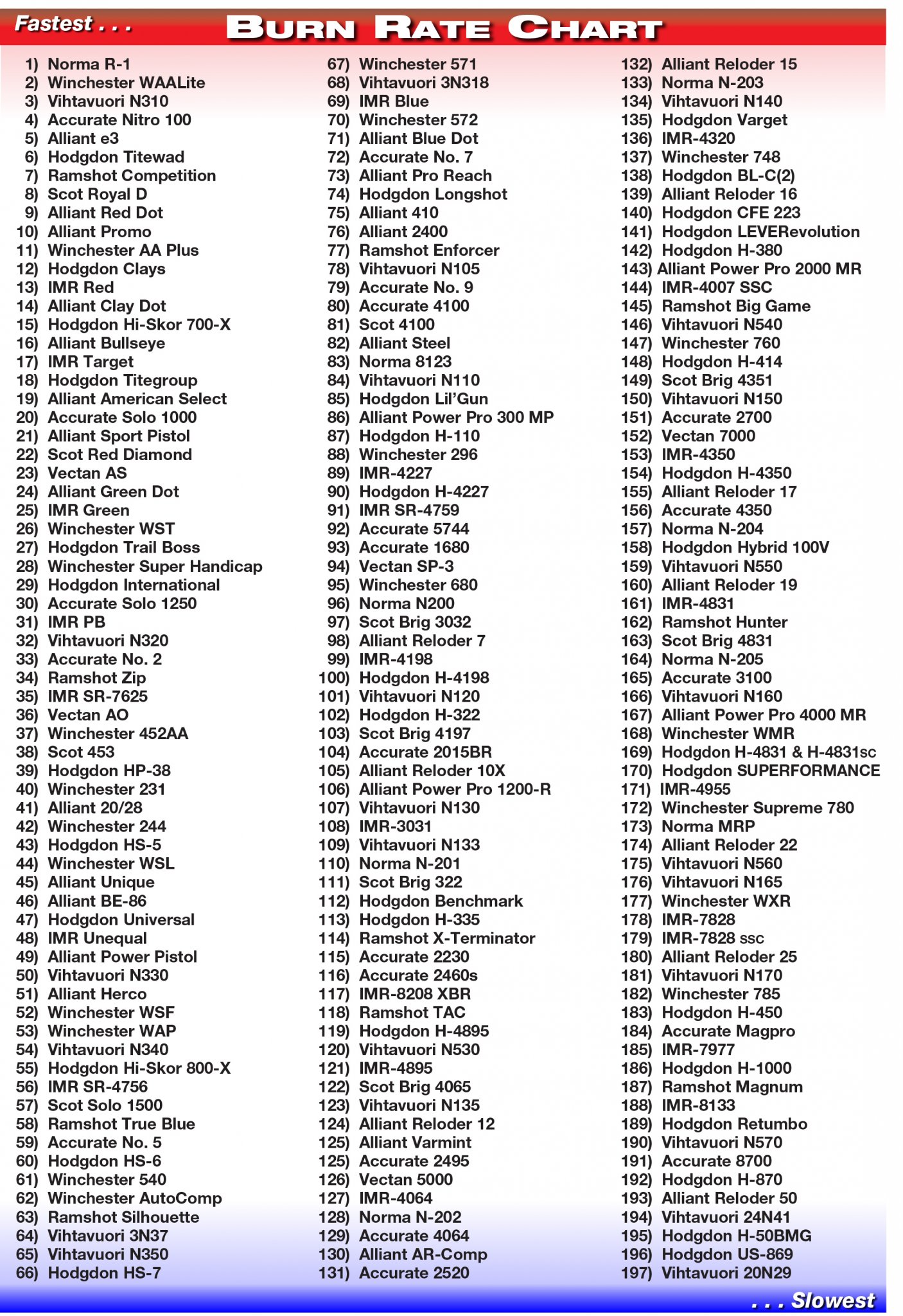

I don’t know what is available now, but here is a burn rate chart if that will help at all.

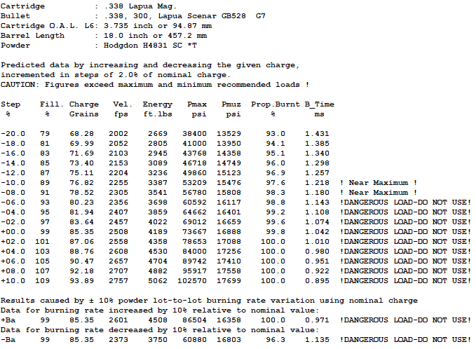

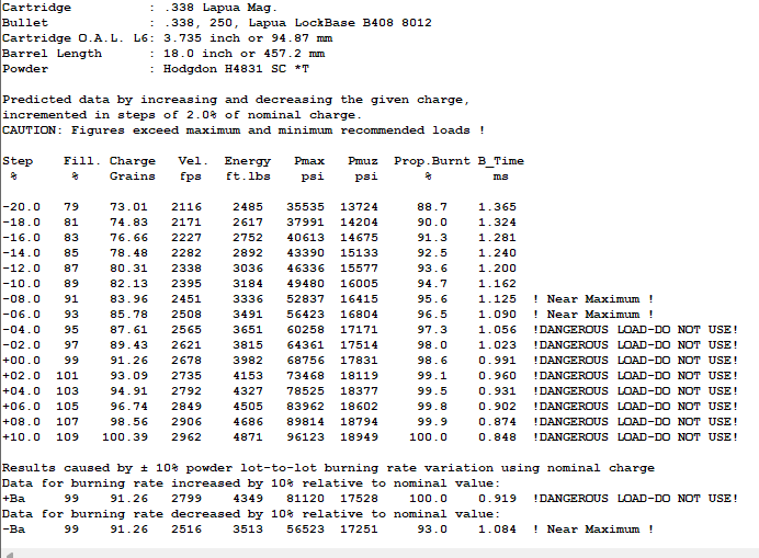

According to Hodgdons website you can use 85gn H4831SC with a 250 gn bullet and have a muzzle velocity 2740 and pressure of only 52000. With a 300 and 79.0 gn H4831SC powder you get 2511 at 53000 psi. Not as good as Retumbo but very doable. You seem to be only using software to make your determination on it. When the powder you want is not available you HAVE to find some kind of substitute. Hodgdon US869 is also doable but is not temp insensitive and is very dirty and does not produce very accurate groupings.
Well yes, that's the predictive power of the software, but it's no replacement for the ground truth (ie published load data). So when in absence of data, software can give you a good ballpark view of what you should expect.

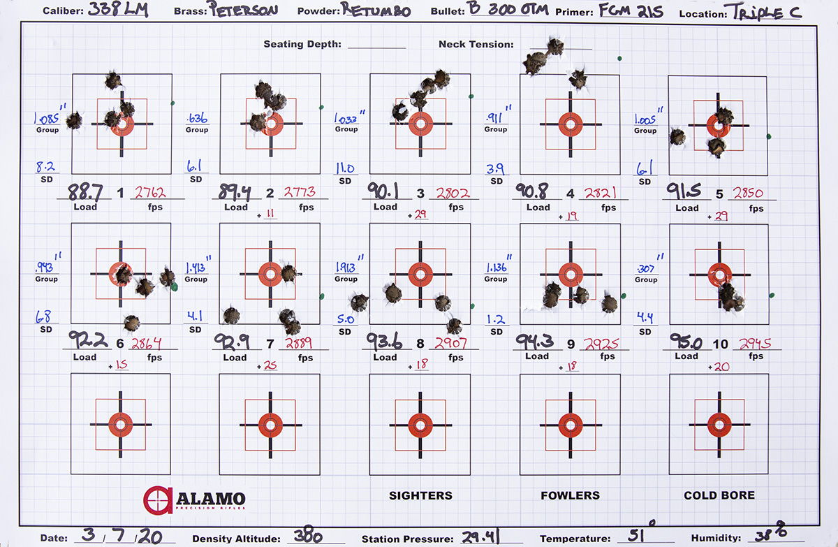

Hoping for a little guidance with my 338LM. This is the 3rd barrel I have put on this rifle, the other 2 shot great, but not this one. Is it possible this barrel just doesn't like the Bergers I have been using in the past?
Info on my rifle.
30" Bartlein Heavy Varmit
Standard JGS SAAMI reamer
Terminator T4 Brake
300G Berger OTM
RETUMBO Powder
The other 2 barrels (identical to above) shot really well. Both of them had a great accuracy node at around 92g to 92.5g. They were running about 2850 fps. There was another node at 89g running at 2770 fps - but slower than I wanted to use for competition.
This barrel however, there is no node to be found until I get up to 95g, and running 2950fps. That is about 2 full grains into signs of pressure. I tested powder charges from 88g to 96g. I tried seating depths at .005 apart from the Lands out to .100.
Strangely enough, it has incredible low ES and SD's, but about 1" groups is the best it will shoot until 95g.
Is it possible this barrel just doesn't like the Bergers? Or the RETUMBO? I have considered trying the new Hornady A Tips first... then trying some H1000.
Any advise from some seasoned shooters with 338LM experience would be greatly appreciated.View attachment 7269571

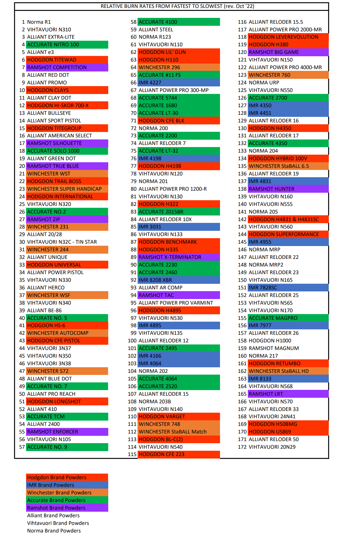

Sorry I ended up using the N568 in my 300m. I works great in that. Looking at Hodgdon's newest burn rate chart is only slightly faster than N570.
Take that Ramshot LRT with a grain of salt - it's slower than N570 and from my experience even a tad slower than RL33.
Reactions: lash
edit
do you think it's faster slower than 24N41?
or, in-between RL33 and 24N41?
edit
No, it's definitely faster than 24N41. From my testing it appears just a tad slower than RL33. It's really close in the way that H1000 & Retumbo are really close. Sure, it works in .338LM but it's almost anemic (same with RL33) so it's kind of a waste. It's better suited to .338LM Improved and 33XC (or .375CT), in my opinion. At this point, I only use LRT for fireforming .338LM Improved brass.
