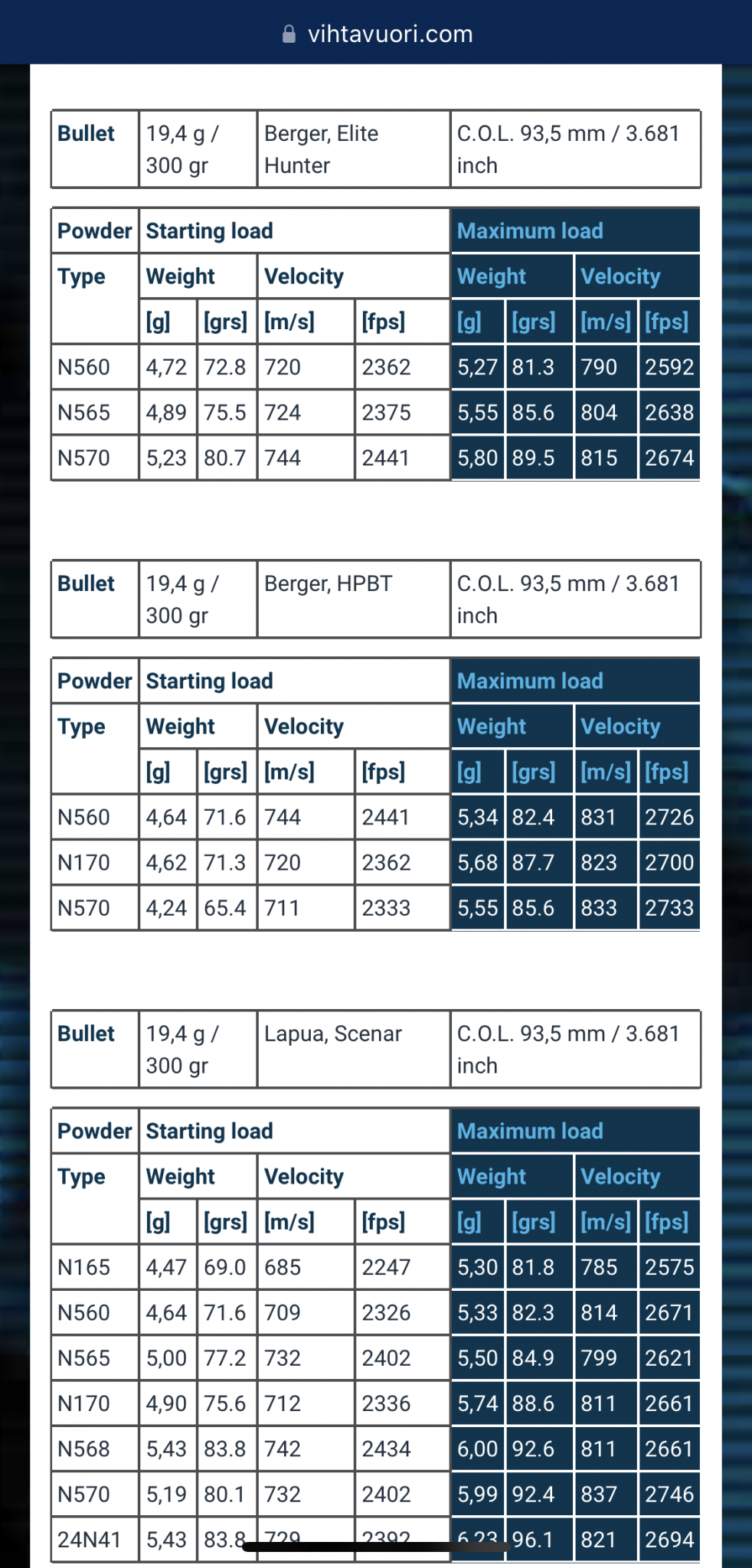

Did you try actually looking it up on the Vihtavouri website? I did and in less than one minute, found this info. Again, 3000 fps is nowhere in sight. Not even close.
Your data is slow, even as compared to theirs. Why did you make your c.o.l. So long? Note that they used 3.681”, or 0.214” less than you. Yours are needlessly almost a quarter of an inch too long.
That’s why your load is so slow. Reseat those you already have loaded at 3.681” and finish your pressure testing.

In response to all of you, yes I of course have vihta's data. I have it showing that a 78.6 gr powder charge should be giving me 2594 (call it 2600) and I'm 250 slower than that. I'm arguably slower than I should be regardless if I'm a novice or not.
I'm .214 inches longer because that's the seating depth that minimized jump. I took measurements about 30 times using an O.A.L gauge and felt real precise here.
And no offense taken, although you tell me if I should be asking for help at my local Whole Foods instead of here.
Take a look at the difference in charge weights listed for the other 300gr bullets on that page. The Sierra & Scenar have max charges much closer to what I use, yet for some reason their data for the Berger is quite a bit lower (though the Sierra load COAL is quite a bit shorter). We've seen this before in the VV data for .300NM where it doesn't seem to jibe with reality.

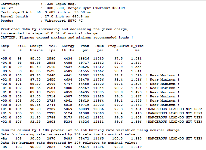

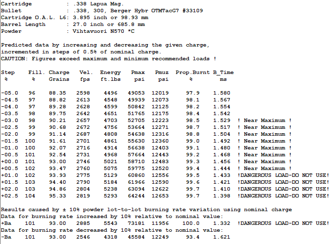

For comparison, here's a prediction from Quickload using the standard 3.681" COAL (note: mine are seated quite longer, so the 92.7gr works in mine):
Here's your COAL:
These are predictions, not ground truth.
Really appreciate that, I guess I'm now confused as to why Vihta is saying 85.6 gr is max charge for the 300 Berger but you're safely using 92. I'm pleased knowing that my velocity is consistent with what you just posted, thanks.
This is why it’s often wise to compare multiple sets of load data instead of relying on just one. But we all know in many cases that’s just not possible, which is why I use QL quite a bit, but also why we have these cartridge-specific threads.
You are also understanding the relationship between COL and velocity for a given powder charge. In most cases the increase in internal volume caused by an increase in overall length means a decrease in internal pressure and the accompanying decrease in velocity. That 0.214” results in a considerable increase in internal case volume available for powder.
That’s why dogtown ran the numbers for your specific load length. That’s also why he is able to safely load 92 gr in his longer COL rounds.
