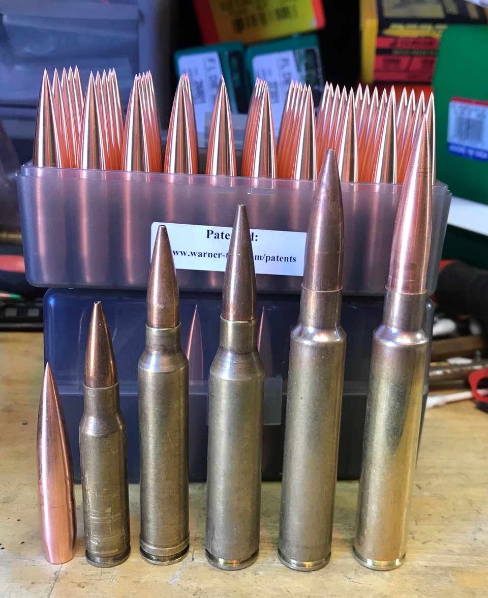

Left to right
Warner flatline 361gr, 308, 300wm, 338 Lapua, 37XC w/350gr smk,37XC w/361gr flatline

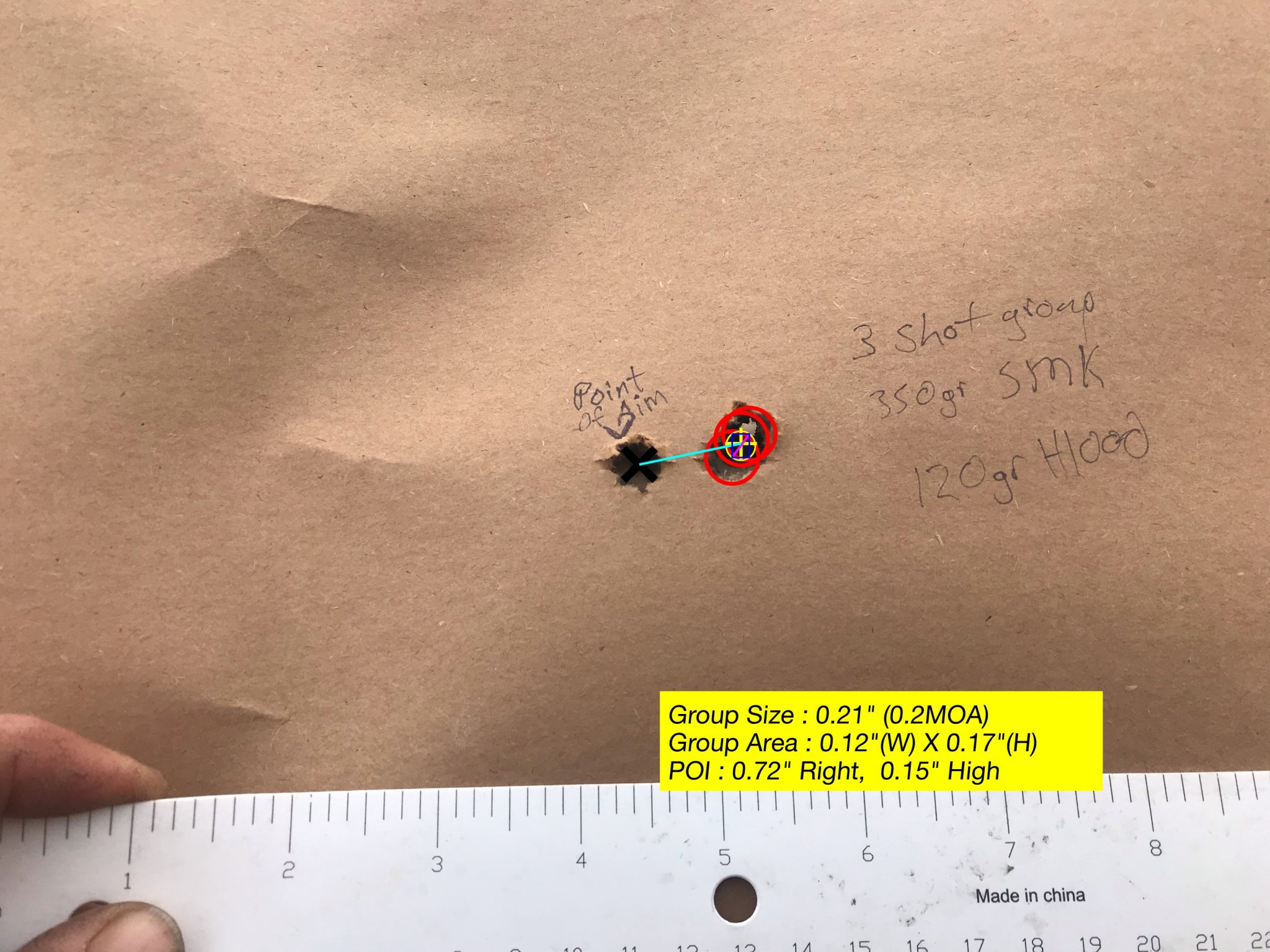

This thing is a pleasure to shoot! Less kick than my 243, can watch the bullet hits in my scope. Wow is it loud! About half way done with load development but have no clue on speed yet. Going to have to shoot it with out the break to use my magneto speed as the brake is too long. I did strap it on using the spacers and strap had to be on the brake. Bad idea. Strap was clean of the port but sill burnt the strap a bit and I quit that real quick. Starting load was 2900 with the 350gr smk. Been having troubles with cci 250’s. Two different lots and both are bad, bunch of duds and few went off after 4th time the firing pin hits them. Switched to federal 215m and no issues. So far the worst load was 3/4 moa. Will check back when I finish load work and get speeds. Wish I had a lab radar for this.

Well I shot it with out the brake. Not bad at all really. I’m at 2945 without the brake. Screwed on the brake, held 14.5 moa high and nailed the 735 yard plate. I’m thinking I’m pretty close with speed but got plenty of room for more powder. Hopefully I’ll get more time this next week to play with it

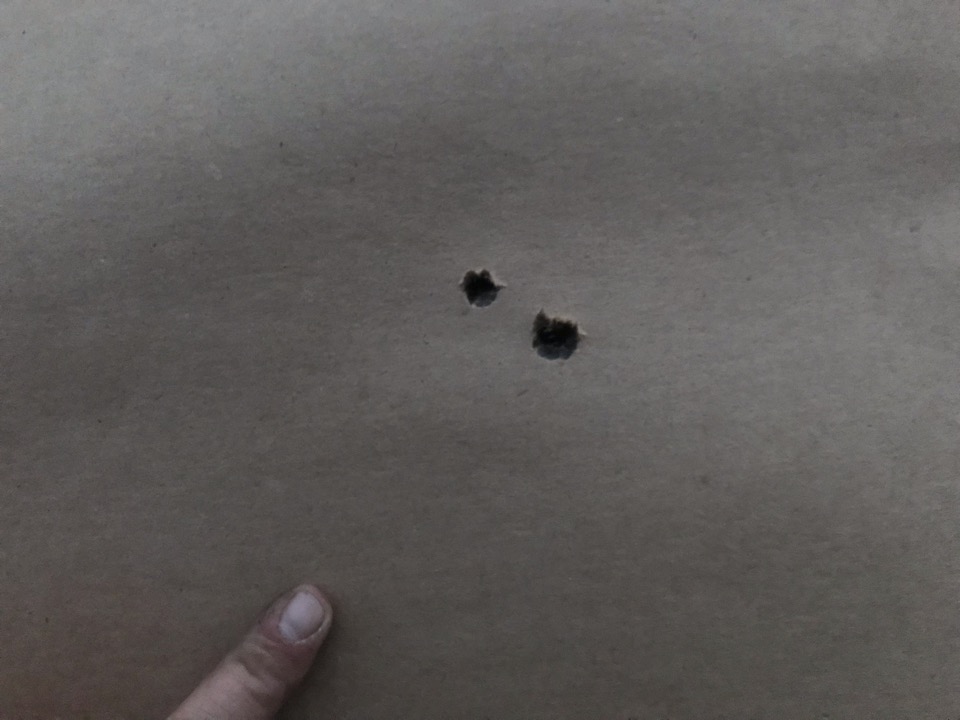

Got around to testing the flatlines today. I’m at just over 1/2” at 100 and 3029 FPS with out the brake. Still playing with seating depth.

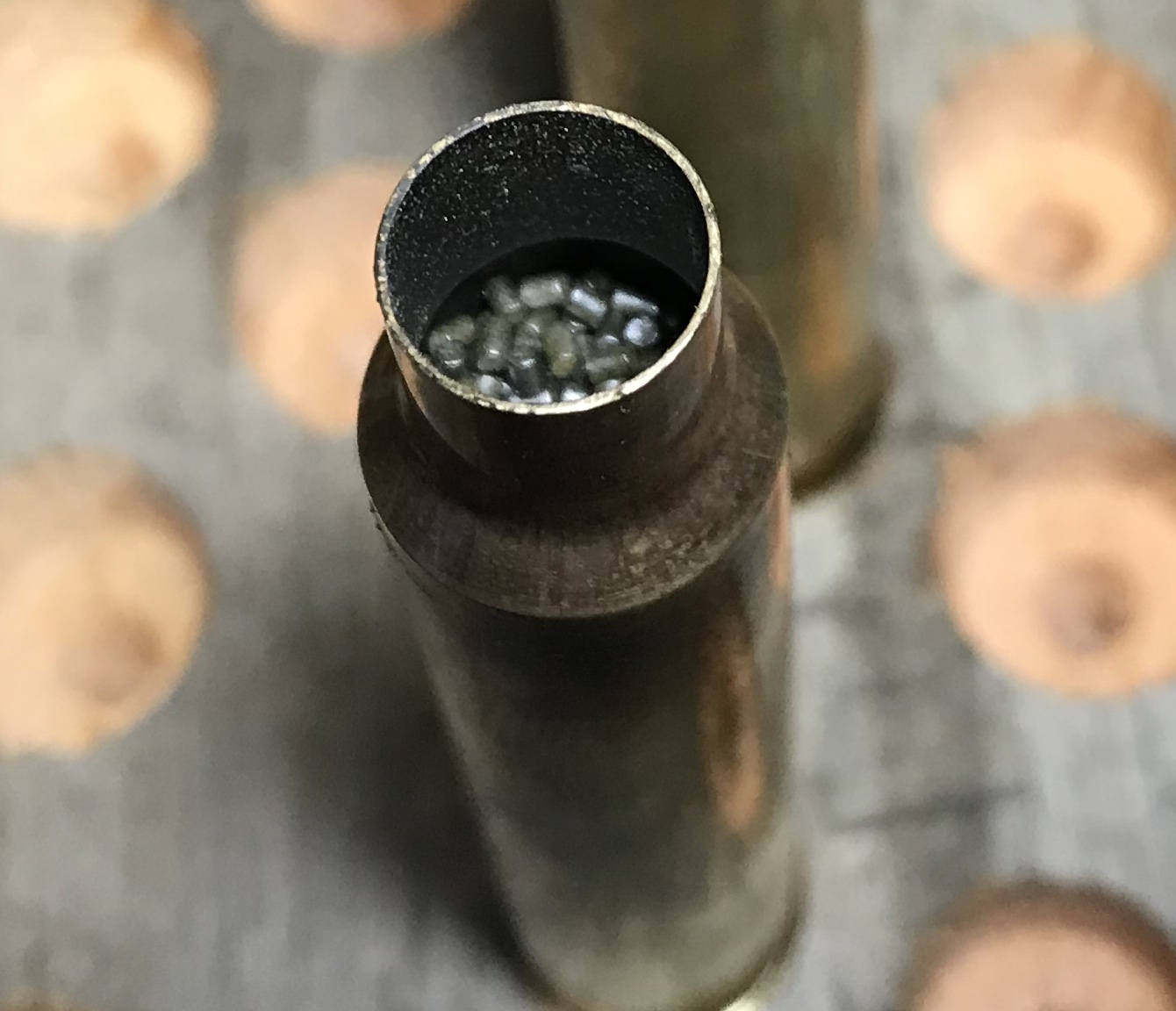

120gr h1000
Es 9 but that was only 3 rounds
