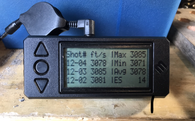

Got speed today

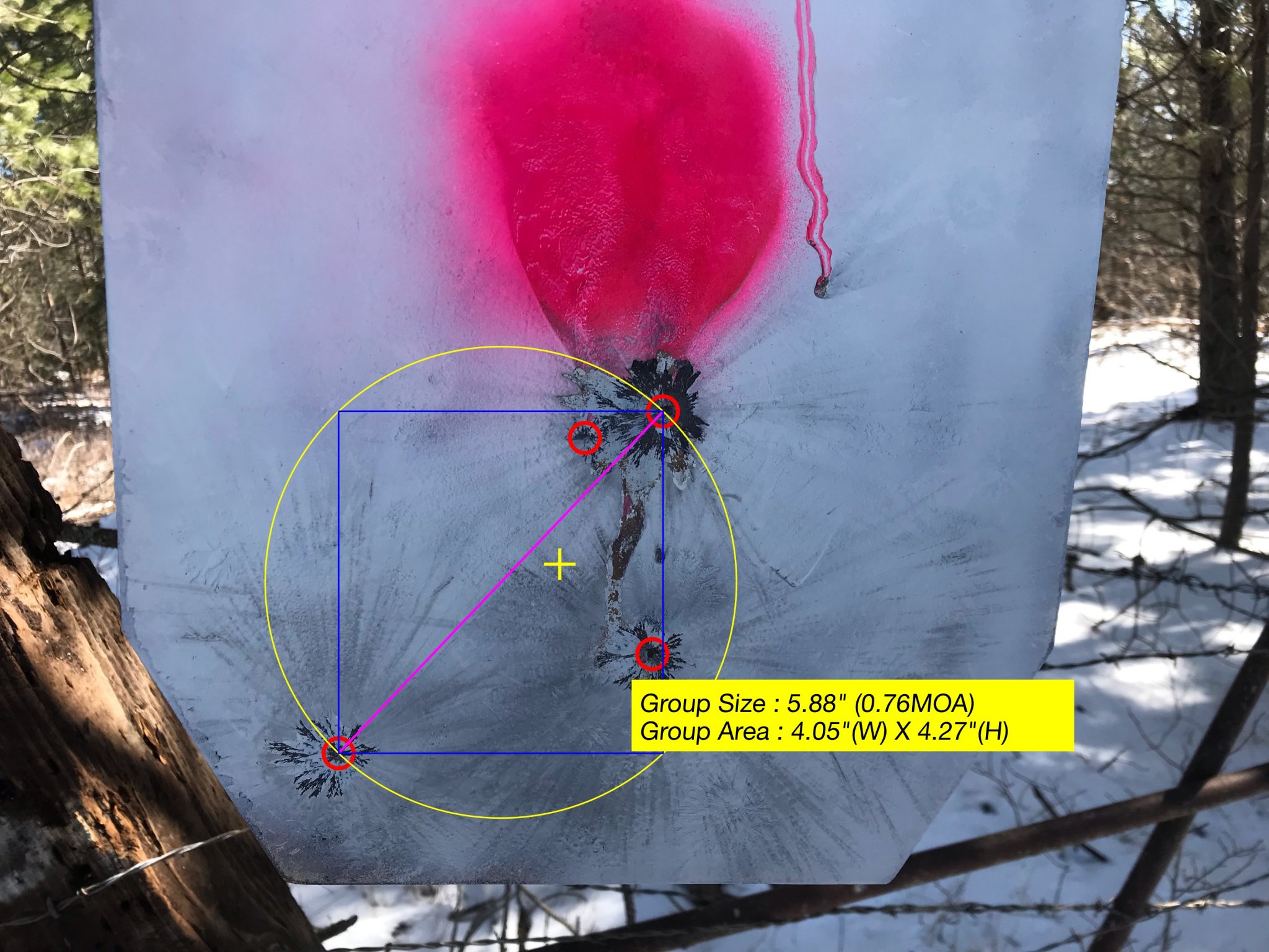

I've been running the petersen 33XC cases in my XC and so far have had no issues at all despite running a little over the limit on some of the load test pieces. Primers are all still tight and no cracks or other troubles. Only have about 5 shots on those 20 cases so far but no complaints. We got out to 2600 with the rifle.
