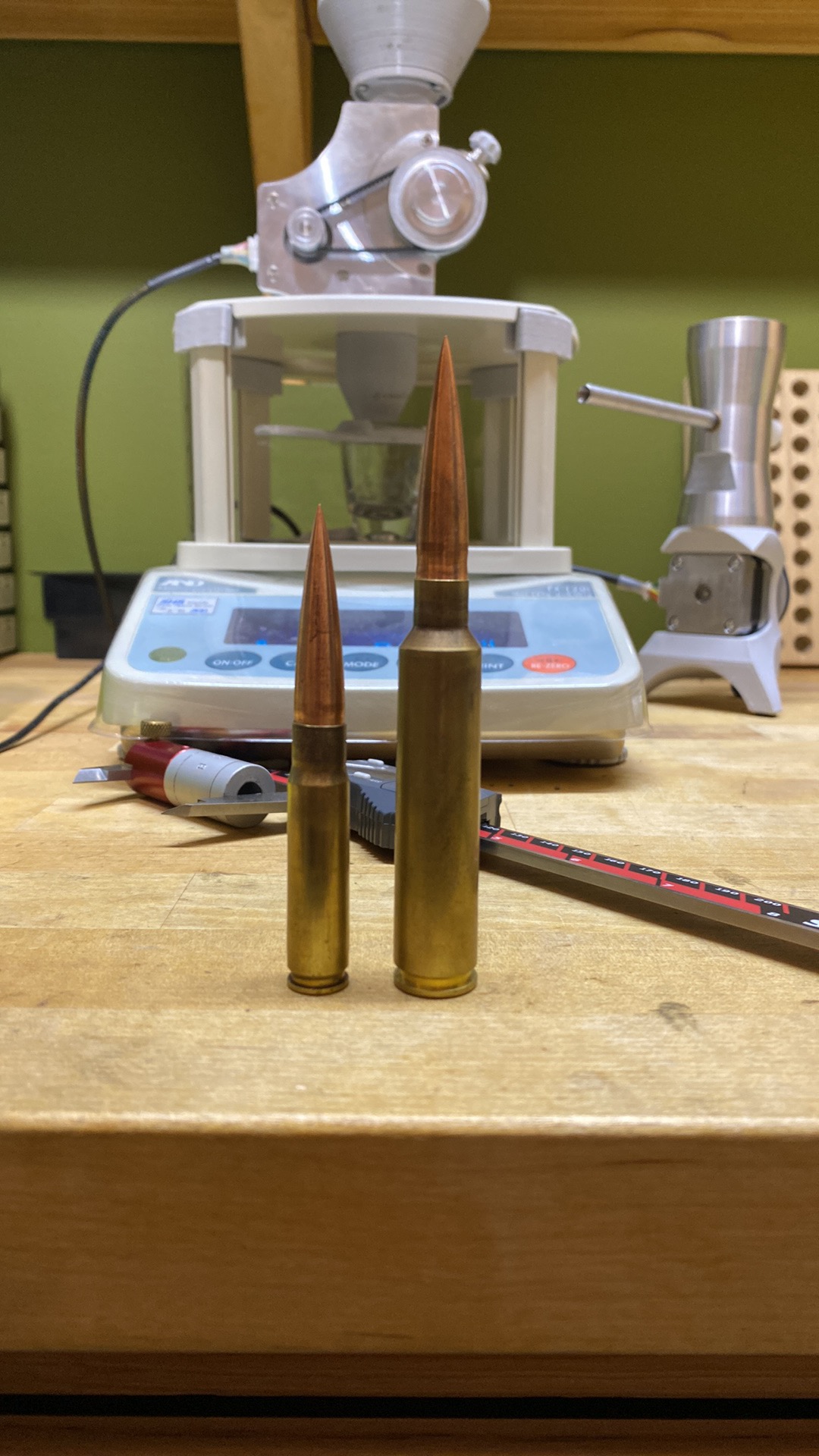

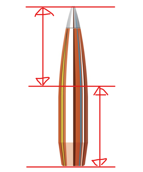

I am currently designing a 375 subsonic cartridge based on the 308 brass.

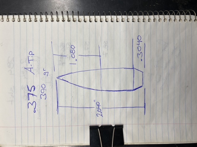

So, I am looking for information on the 375A-tip 390grain, but currently the only place that has provided accurate dimensions is here on the forum. If you have time, could you please provide the length of the nose, boat tai and bearing surface?
Thank you very much.

If I get around to it sure but I wonder why you would design a new cartridge for a bullet you can’t even get a single specimen of? 😂
I was able to find them a few months ago. I grabbed 500 of them, I could of got more but I'm not 100% commited to that bullet yet. gonna try some of the solids also.

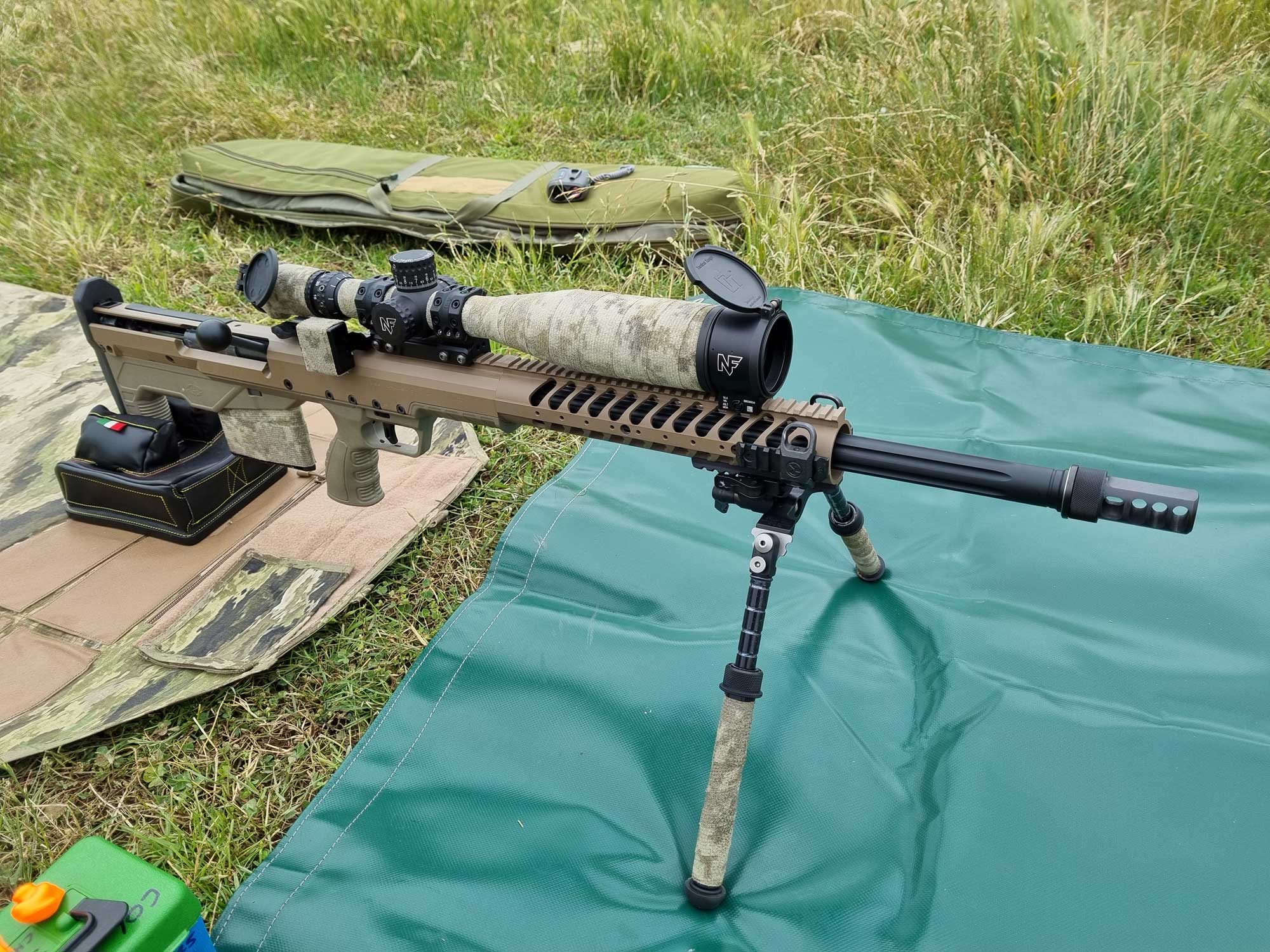

Yep...Factory DT 1 in 10.5 twist barrel. Velocity around 2900fps..

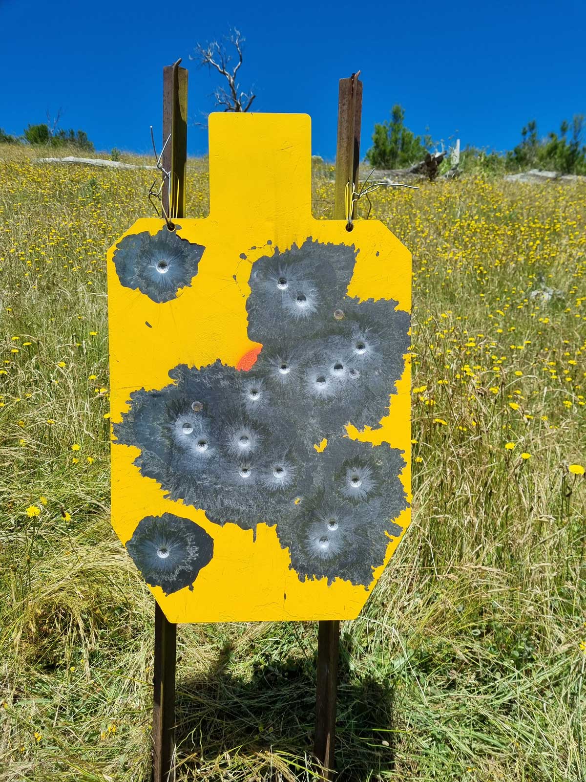

Initially tried the 352CE with my 375ct which is supposedly what Desert Tech use in their factory ammo. Results were shockingly bad!! 1-1.5 moa!!! Nothing i tried would improve the accuracy using these projectiles. I amost gave up with my 375ct and then decided to try the Atips......best thing i could of done..
The 390 Atips shoot consistent 1/4 moa with my HTI...

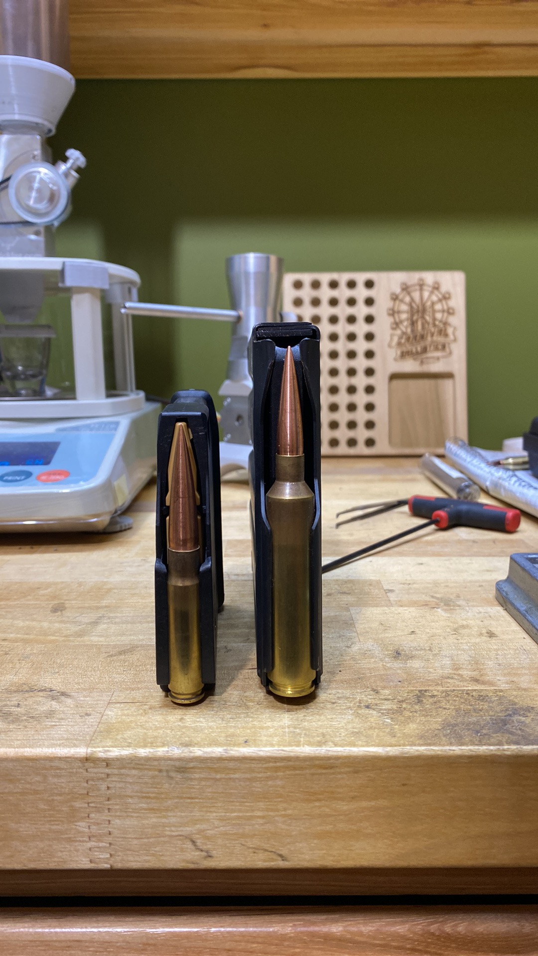

Go long action and run any bullet you want.
Deer Geno.C,

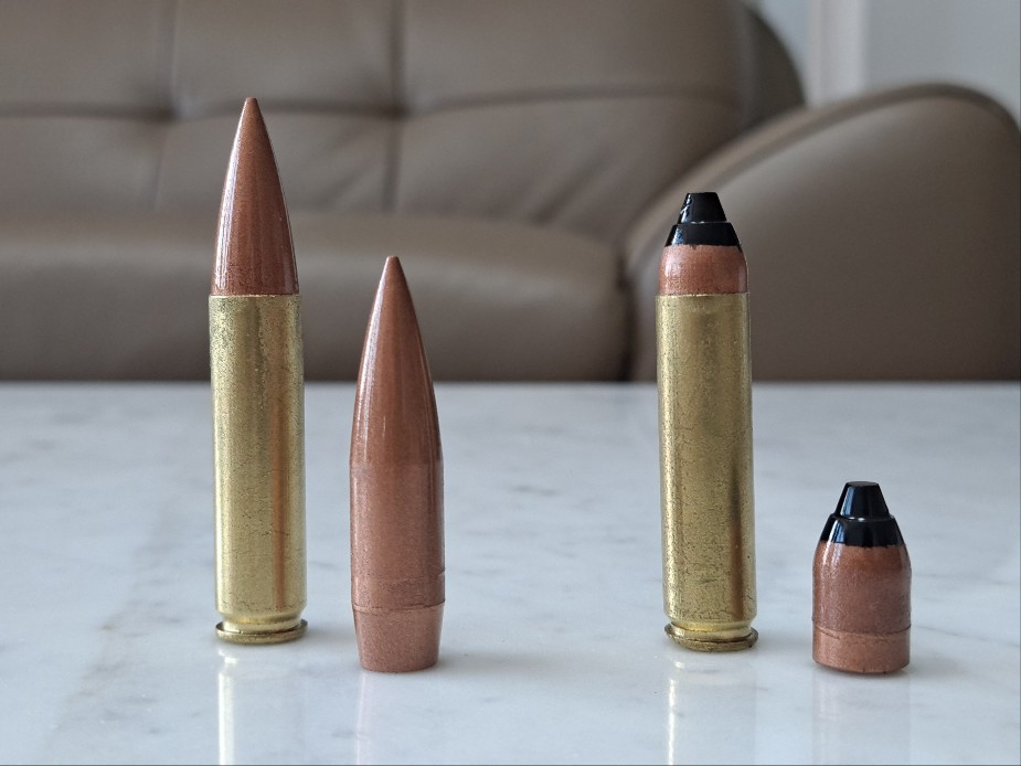

thanks for the kind reply. However, since I am designing bullets to ultimately make bullets for use in an AR10 or AR308, I am going to limit the overall COAL to "2.8inch".
Below is the ammo I made in Pakistan about a year ago (before the Ukrainian war broke out). It was tested with a then modified lee-enfield and tested with a total barrel of 320mm (12.5inch). The poor brass, barrel quality and hand-made gun heat made the 100meter MOA was terrible(Perhaps there was a problem with the barrel twist rate.), but the bullet velocity and kinetic energy were quite satisfactory.

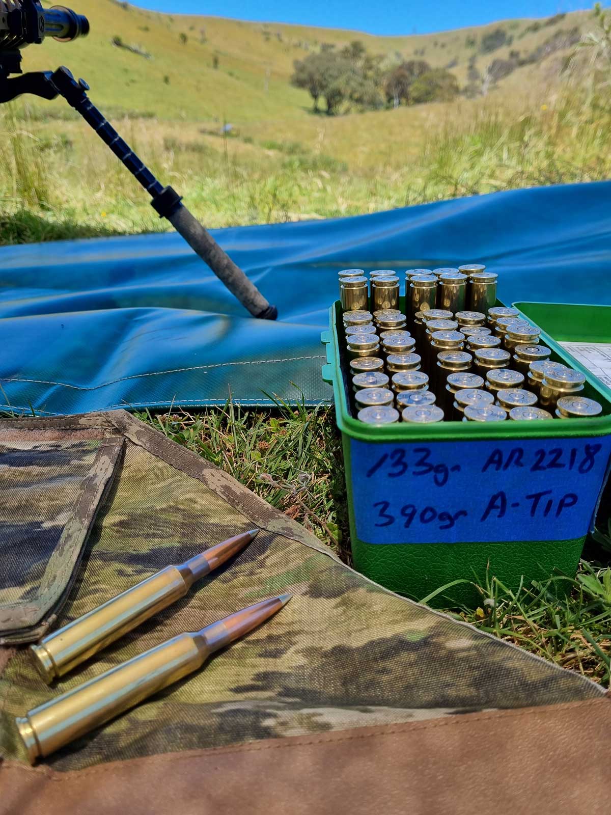

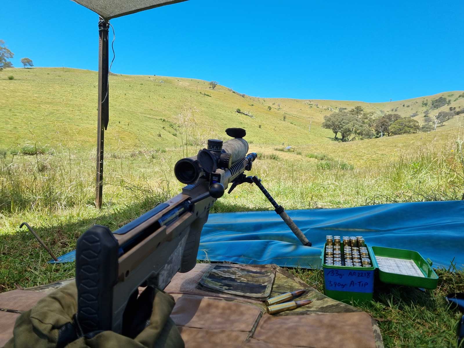

I did a pressure/ Satterly test today with H50BMG & Peterson Brass and RL50 and Bertram Brass ( found some I forgot I had).
Thank you for the H50BMG data, I think I have a node at 134-136 grains (2899-2925) that I can start to develop. I went all the way up to 138 (2991 FPS) grains and I saw no pressure signs at all.
@secondofangle2 that Bertram Brass made all the difference with the RL50 and the ATIPs. No pressure signs at 137 grains and 2918 FPS with my stock barrel. I may test 137.5 and work up a bit more in .5 grain increments next week to see if there are additional flat spots in the chronograph.
I loaded the ATIPS .010 off the lands for the testing. It seems they like less jump in my gun.
Thanks again

Seems like with Peterson Brass and H50BMG my gun likes 134 & 136 grains. Both groups are 1/3 MOA maybe 1/4 with the 137 grain load. The ES on the 137 grain load is about 11 fps. Problem with the 137 grain load is I start to get very slight pressure signs. Ave velocity is 2916 with 134 grains and 2966 with 137.
I went up to 139 grains of RL50 and Bertram Brass and did not see any pressure signs.
For some odd reason the H50BMG and Peterson brass seem to like .010” jump. Bertram & RL50 not so much. I think I’ll try deeper seating depths this Friday if I can make it out to the range.
