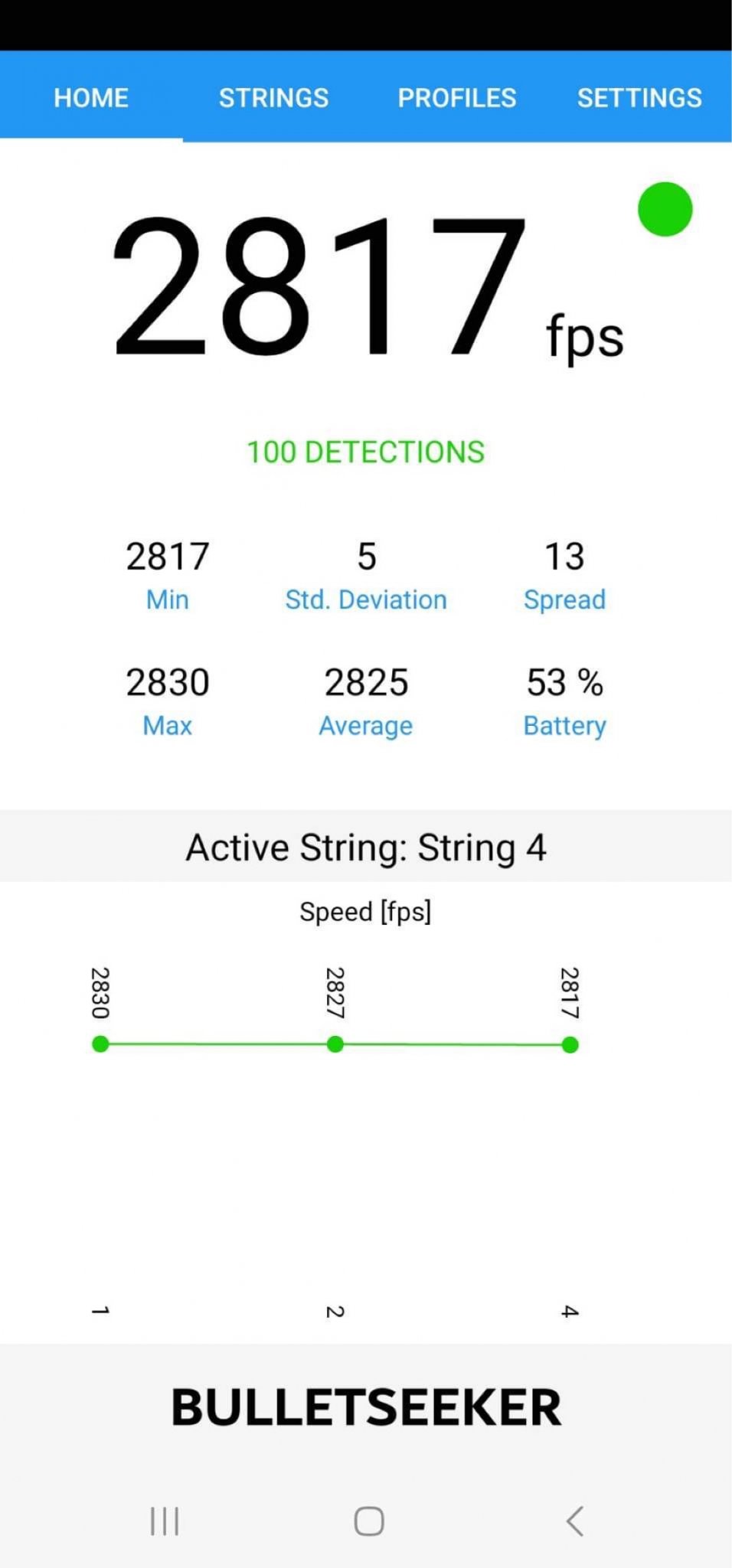

We also tested the Bullet Seeker chrony out, with the parabolic adapter, same deal as before the muzzle blast of the Cheytac is to much for it to get reliable readings, the parabolic adapter did get more readings than without though, some strings only getting one shot reading, positioning under the barrel was best we got 3 readings out of a 5 shot string, the velocities matched the cheap and nasty Cauldwell chrony that reads every shot, the program for the bullet seeker chrony is good though once it is worked out, with smaller guns it is all good.

Was a 5 shot string, first shot failed to read at all, 4th shot didn’t have enough detections for a real reading was only like 30 detections and a silly velocity, the program highlights these shots to edit them out
BTW thanks for the report on the bullet seeker and muzzle break issues.

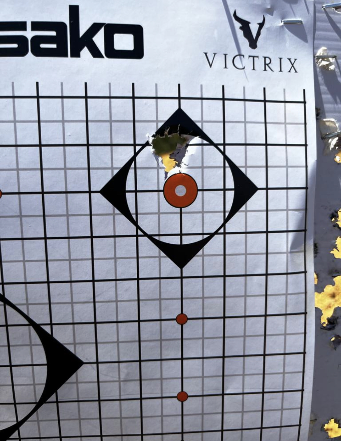

Gents, I have recently won some competitions in ELR 1 and 2 mile with my .375 CT, setup is as follows:
VICTRIX factory .375 CT THRONE rifle
1:8 twist
38inch Bartlein barrel
Running necked down .408 peterson brass
VVN570 propellant
Hornady ATIPs 390gr
TPL is 4.310 inches
Load is 124.5gr
Average temperature in SA (this is where we shoot) is 30 degrees C.
3009 fps is the average (after the barrel has set, took about 130 shots) and before that it was 2980fps on a 0.8SD over 5 shots with a 2 ES.
I now get a SD of 4 and ES of 8 over 20 shots (including cold bore).
I really struggled to get to this point and hope this can help other fellow shooters.

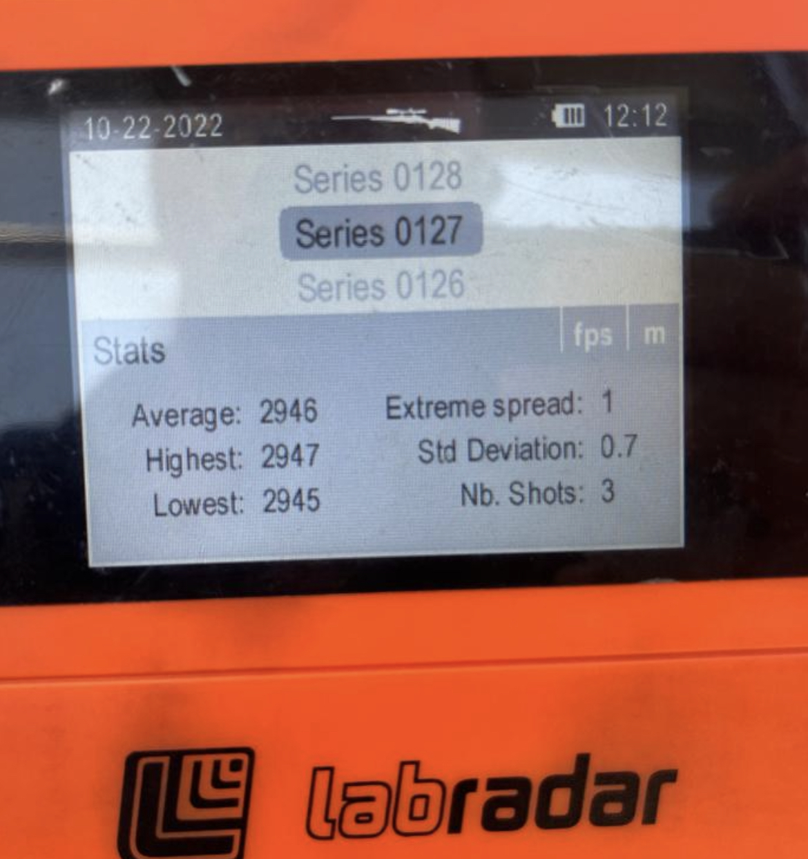

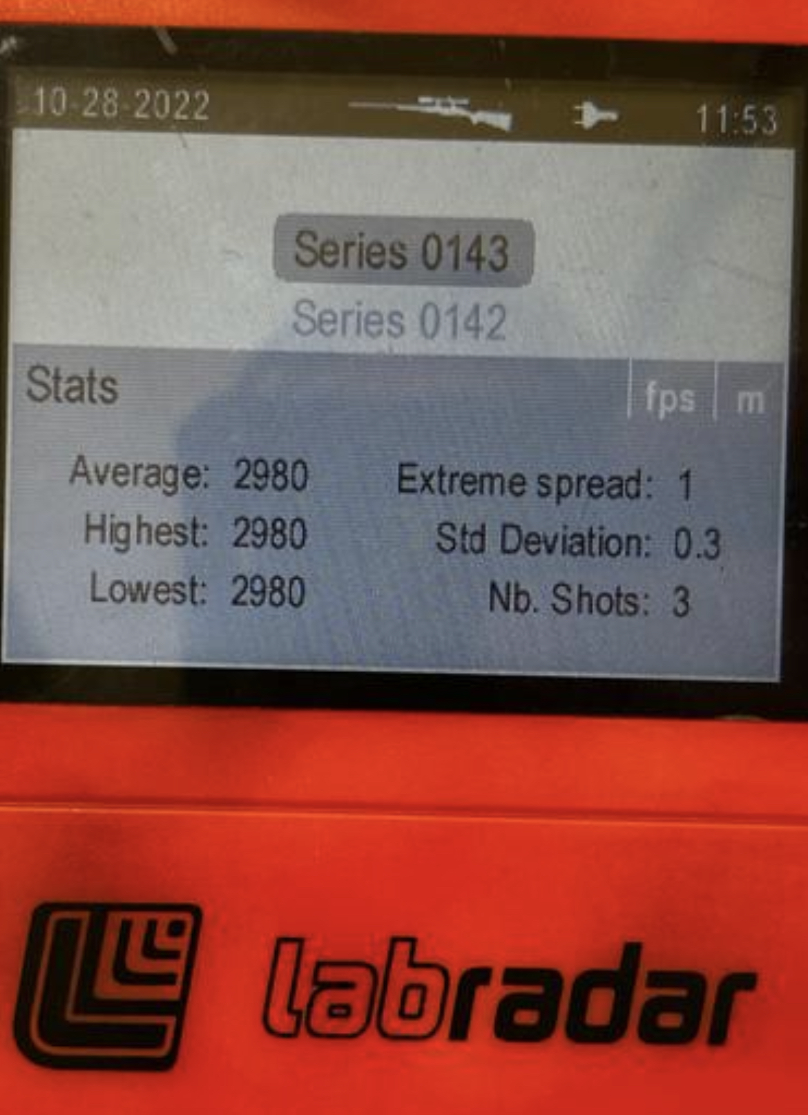

Nobody has 20 shot ES in single digits. Almost nobody.
Almost nobody, unless the labradar lies, owner of the range couldn’t believe it either, below is ones from my labradar.

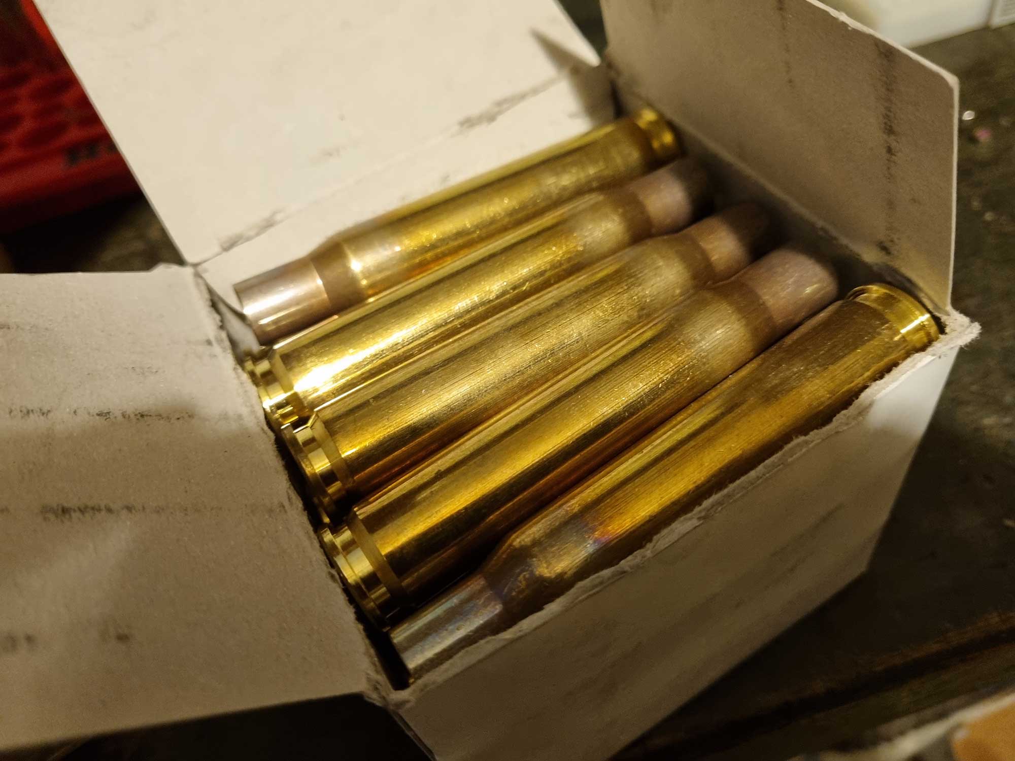

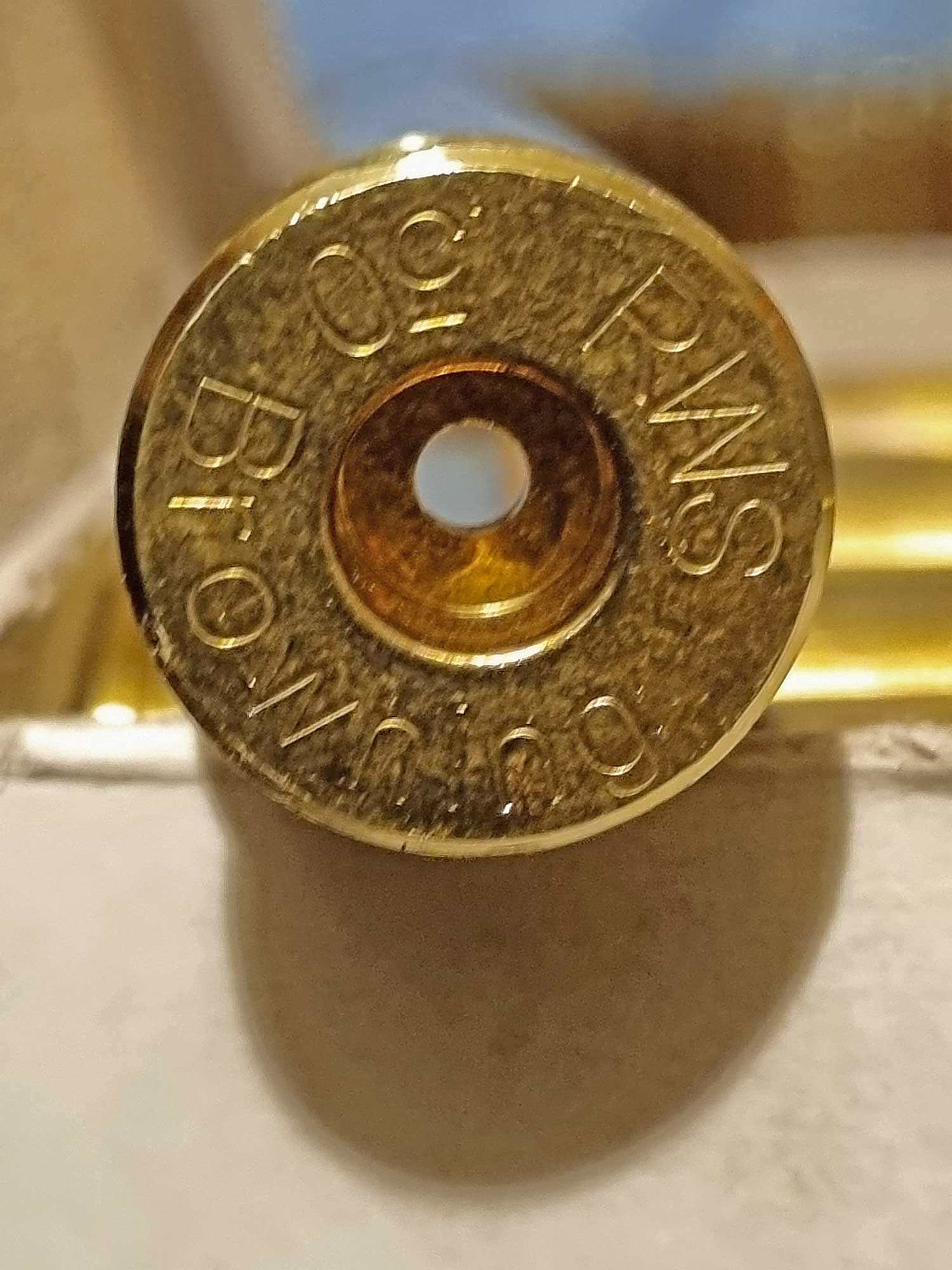

Speaking of 50BMG RWS.....just got 200 new cases..:)
