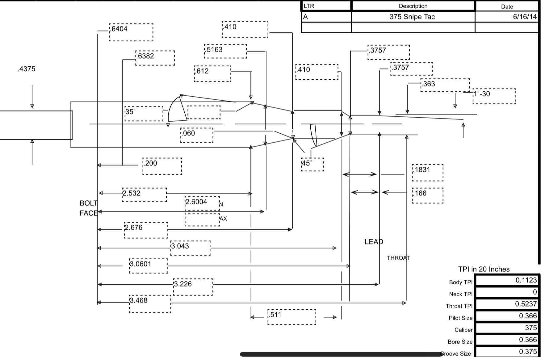

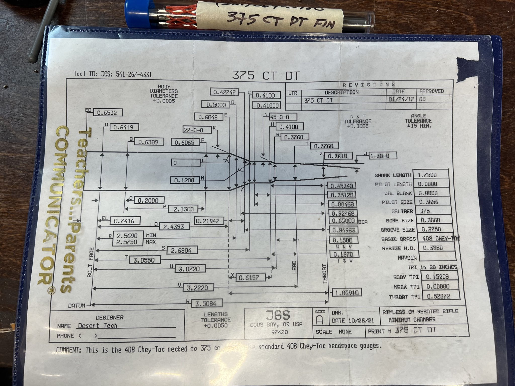

We have 3 cheytacs shooting A-tips into a quarter inch at 100 and none of the chambers are the same. Each chamber is roughly 0.070 different in freebore.
We have an additional 3 guns all shooting a PTG reamer and they like 4.240 with the A-tips and 142 grains of H50BMG.
We have several snipetacs and they like 3-5 grains more powder than the standard 375 cheytac.

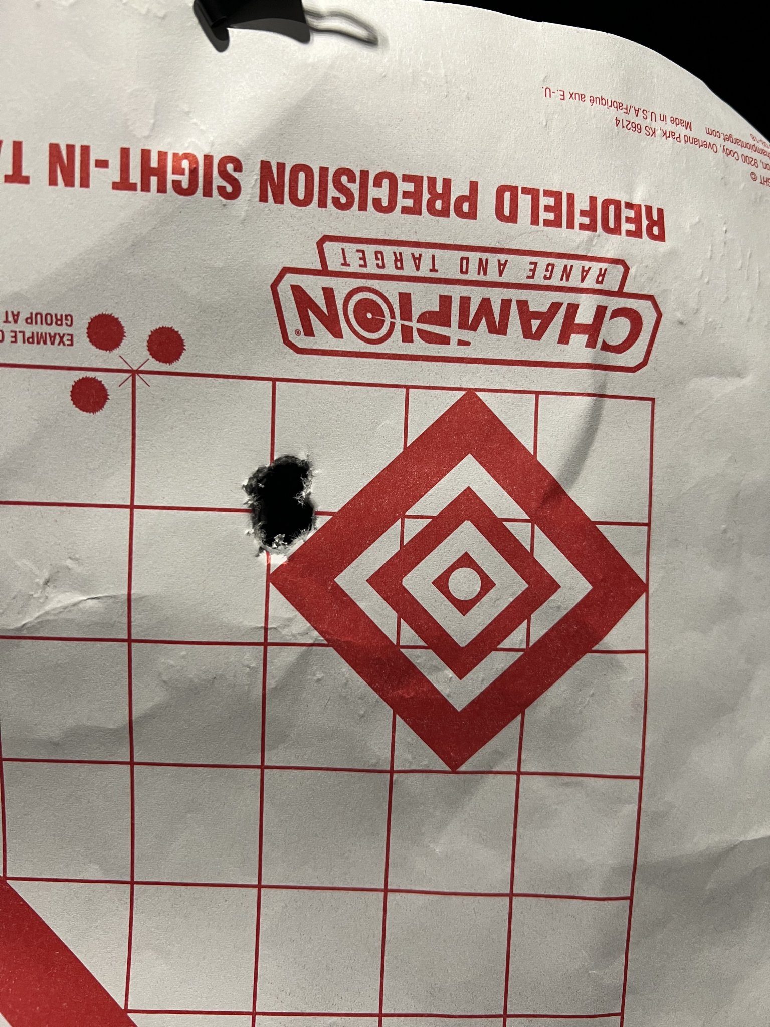

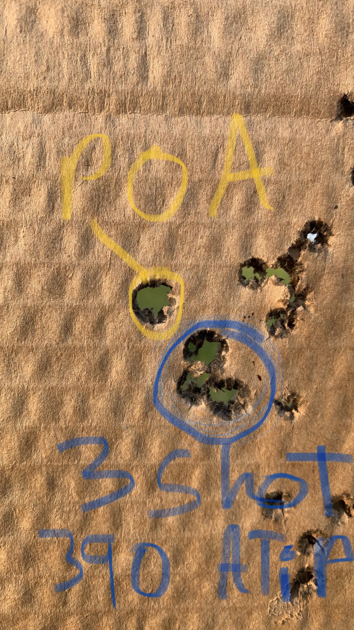

Picture is 3 shots at 100 yards 0.120 group 4 Mils high of point of aim.

To summarize its tough to give a actual seating depth number with the 375 cheytac due to the huge variation in freebores from the various reamer manufacturers.
They seem to like a large amount of jump with a very slow powder and you don't need to shoot Retumbo to get best accuracy as 5 of our last 6 match winners used H50BMG at 2147 yards.

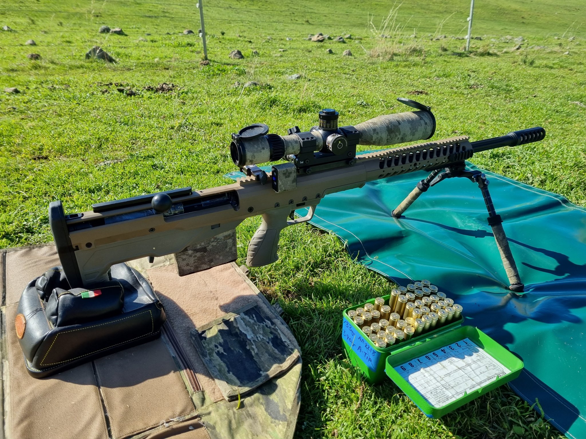

I loaded the first lot of Atips up today today

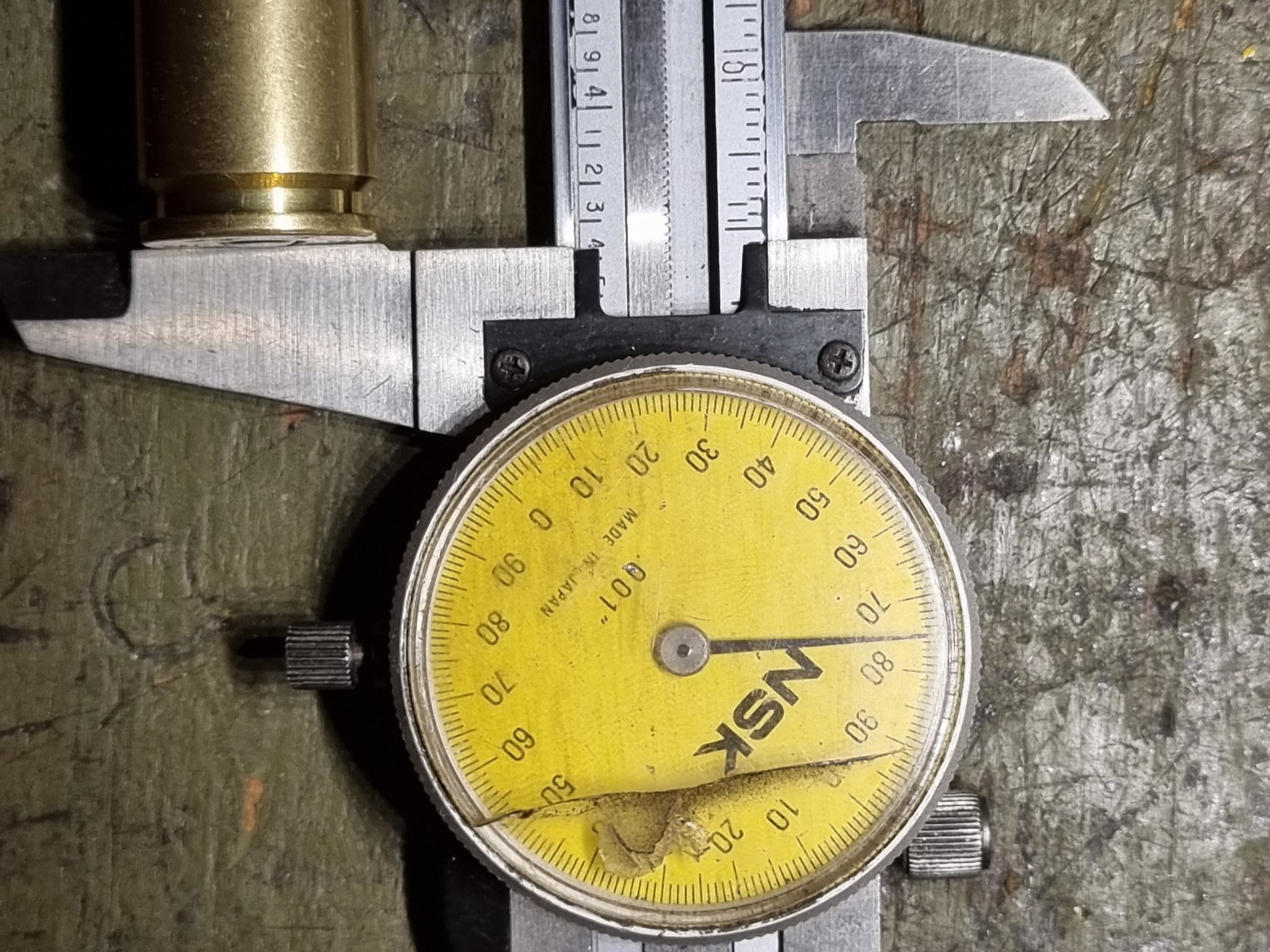

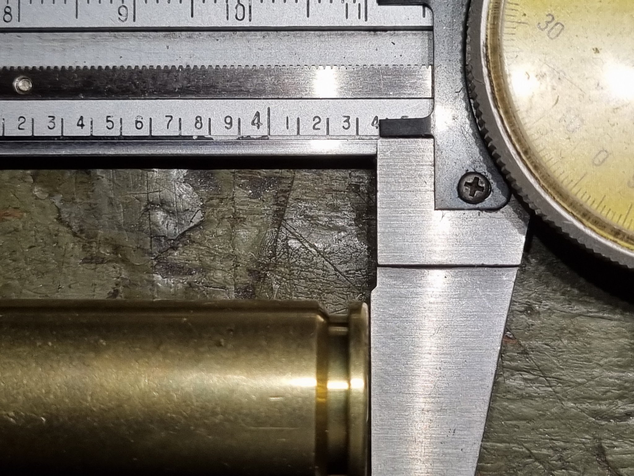

With a “hard” jam in my chamber I was at 4.395”COAL, talking to some others shooting this projectile some were having success at 0.1” jump and others said 0.04”, I started with 0.04” and seated to 4.350” COAL, I don’t have a BTO measurement I need a new wheel for the Forster tool for 375 cal
BB brass, Fed gold primer, 2218 powder
I only have the CH4D dies but they are producing repeatable ammo, the neck tension looks to be 4 or 5 thou, getting tight but not silly, with SMK’s I had 3 tho but that was with many times fired brass
I have access to ADI 2218/H50BMG, I loaded from 130 to 134gr, at 134gr I had zero pressure sign the bolt fell open easy, no swipe or stamp on the case head and a SD of 5 on a 2825fps average, I will do another test from 134 upto 137 and see what can be achieved, I hoping to find the next node before pressure gets to high would be good to get to 2900fps but not sure I will achieve it
Just doing pressure tests at 100 everything grouped better than expected
We also tested the Bullet Seeker chrony out, with the parabolic adapter, same deal as before the muzzle blast of the Cheytac is to much for it to get reliable readings, the parabolic adapter did get more readings than without though, some strings only getting one shot reading, positioning under the barrel was best we got 3 readings out of a 5 shot string, the velocities matched the cheap and nasty Cauldwell chrony that reads every shot, the program for the bullet seeker chrony is good though once it is worked out, with smaller guns it is all good.

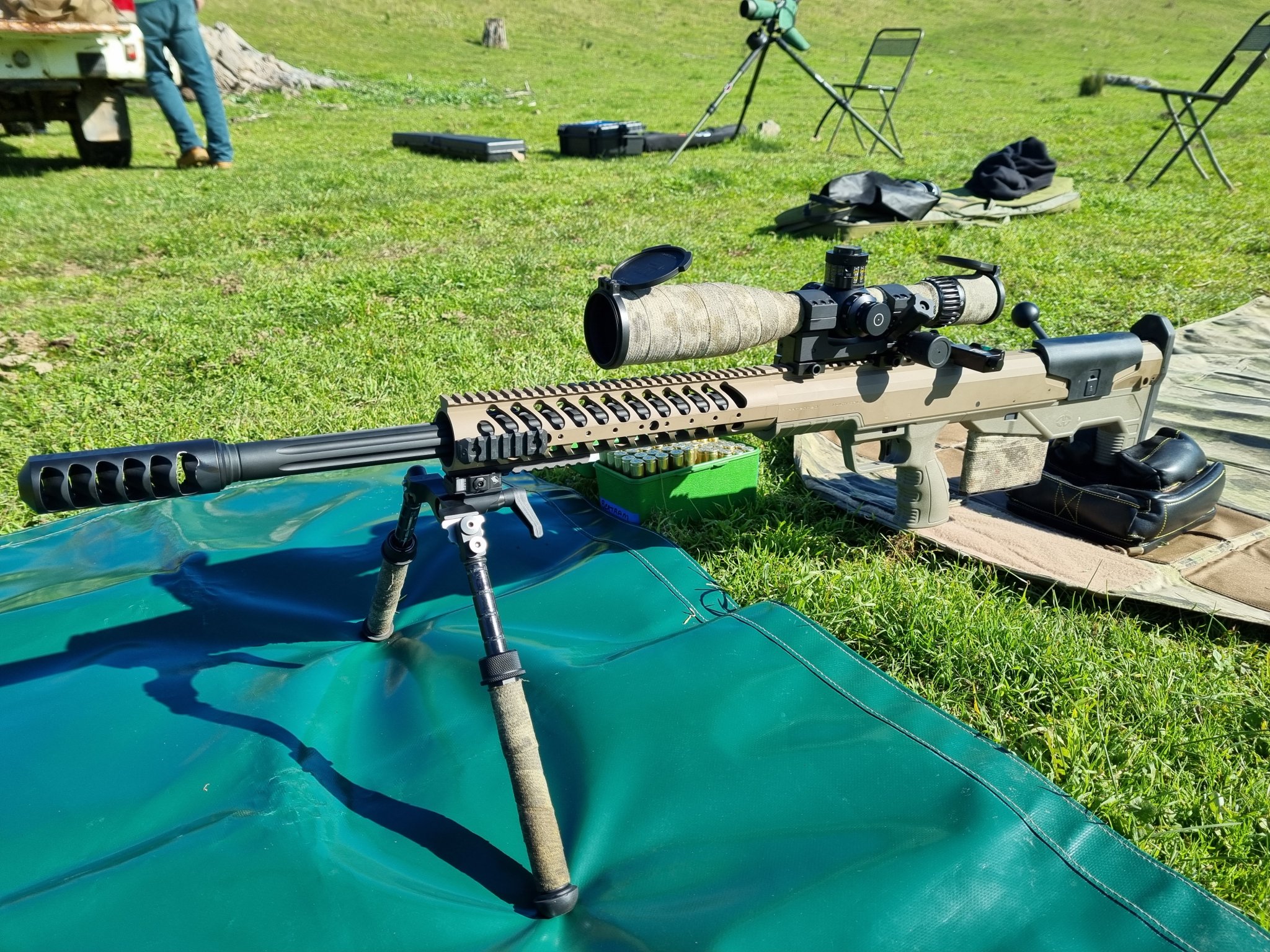

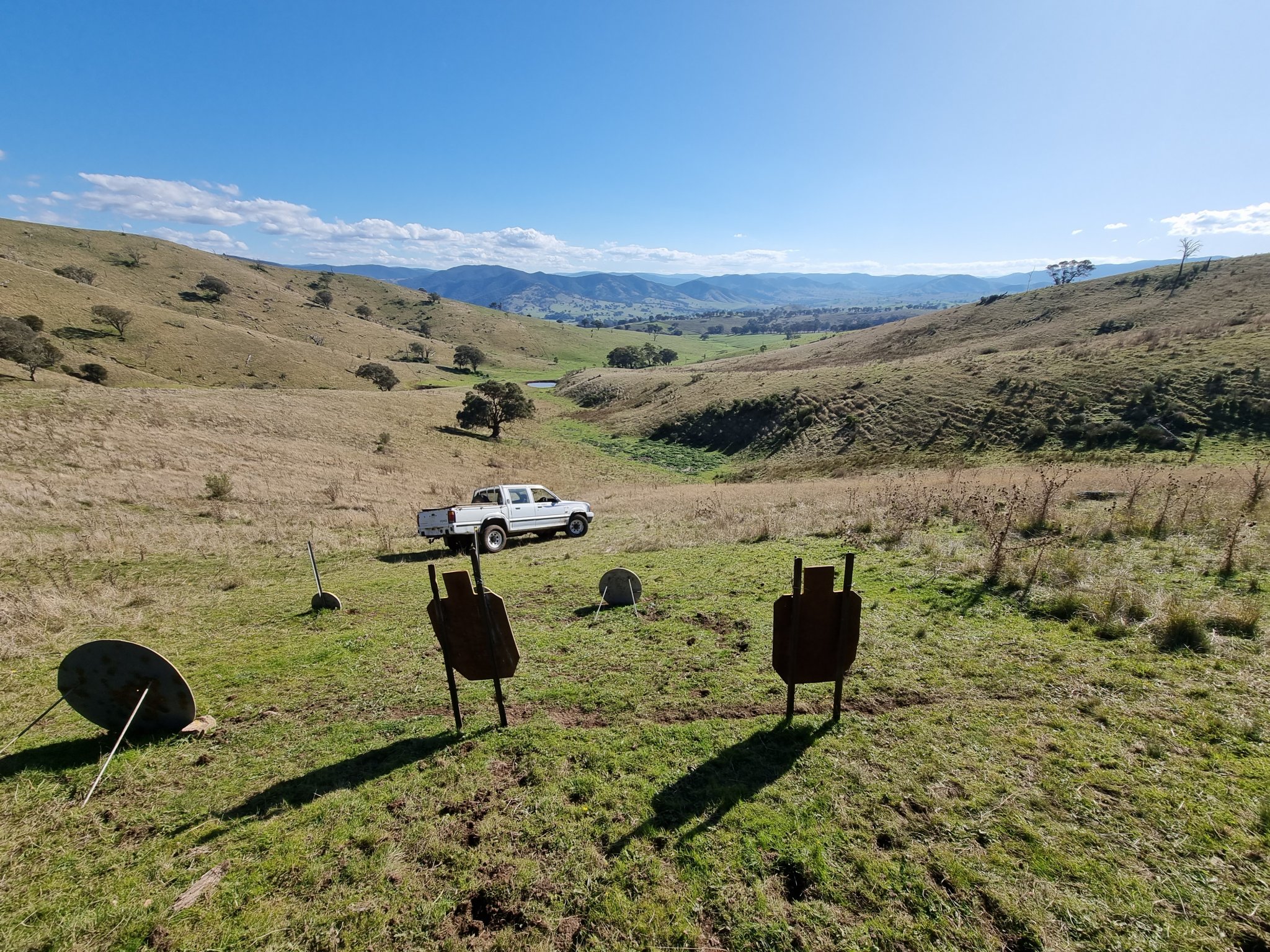

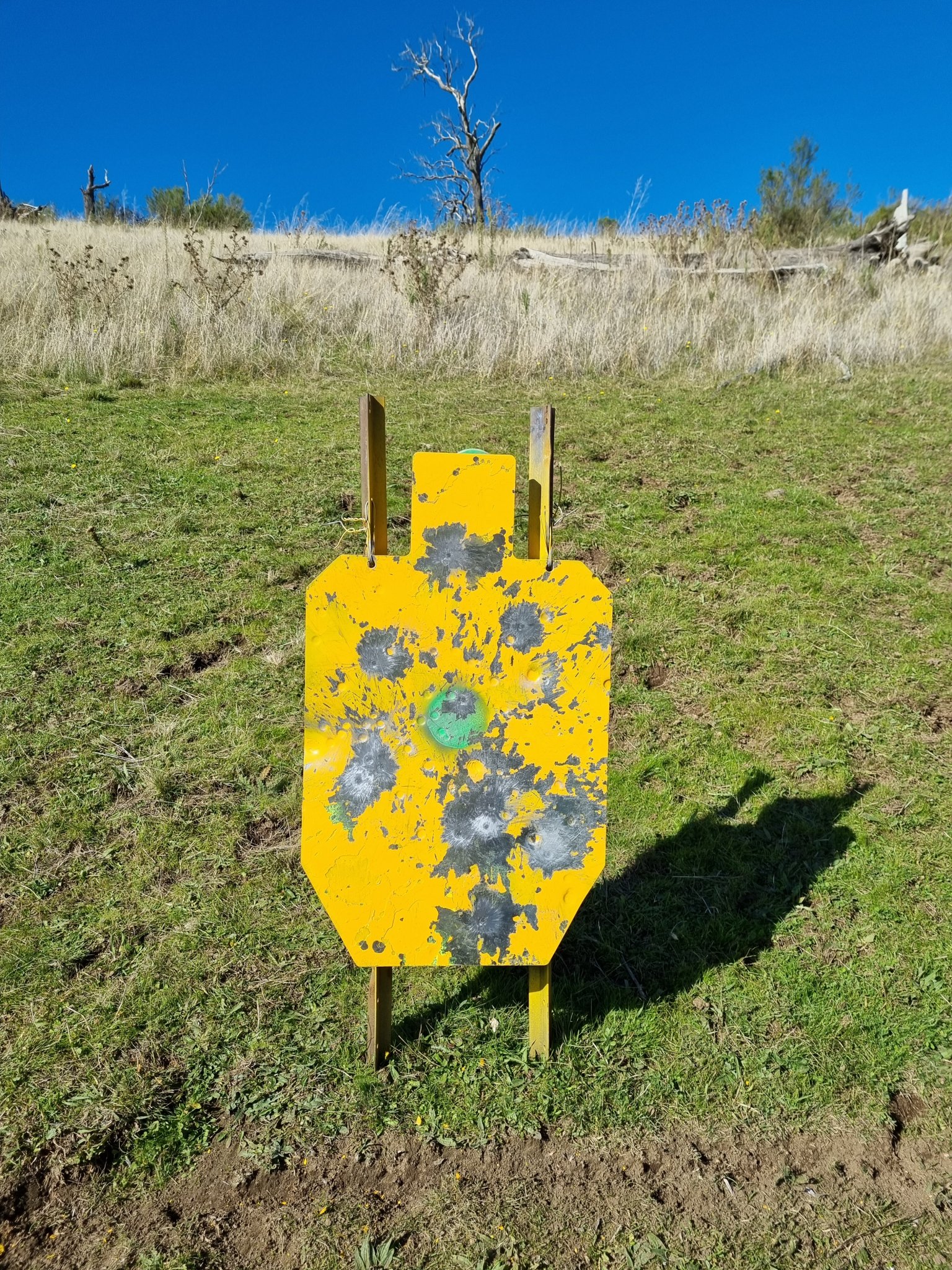

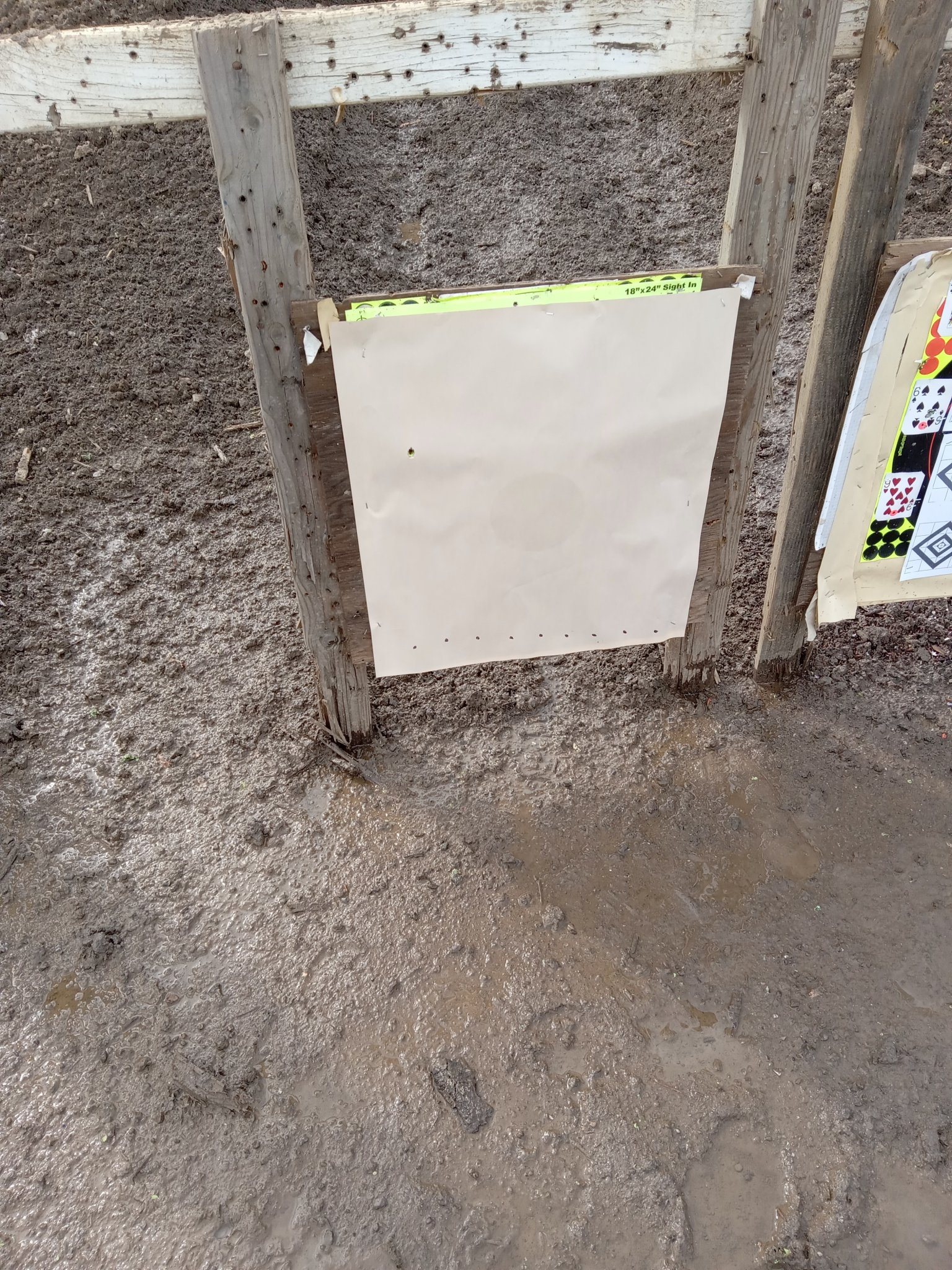

We shoot 2147 yards 2630 yards 3380 yards and 3720 yards. We shoot across a deep canyon for the first 2 gongs and over a mountain peak and across 2 canyons for the next 2 gongs.

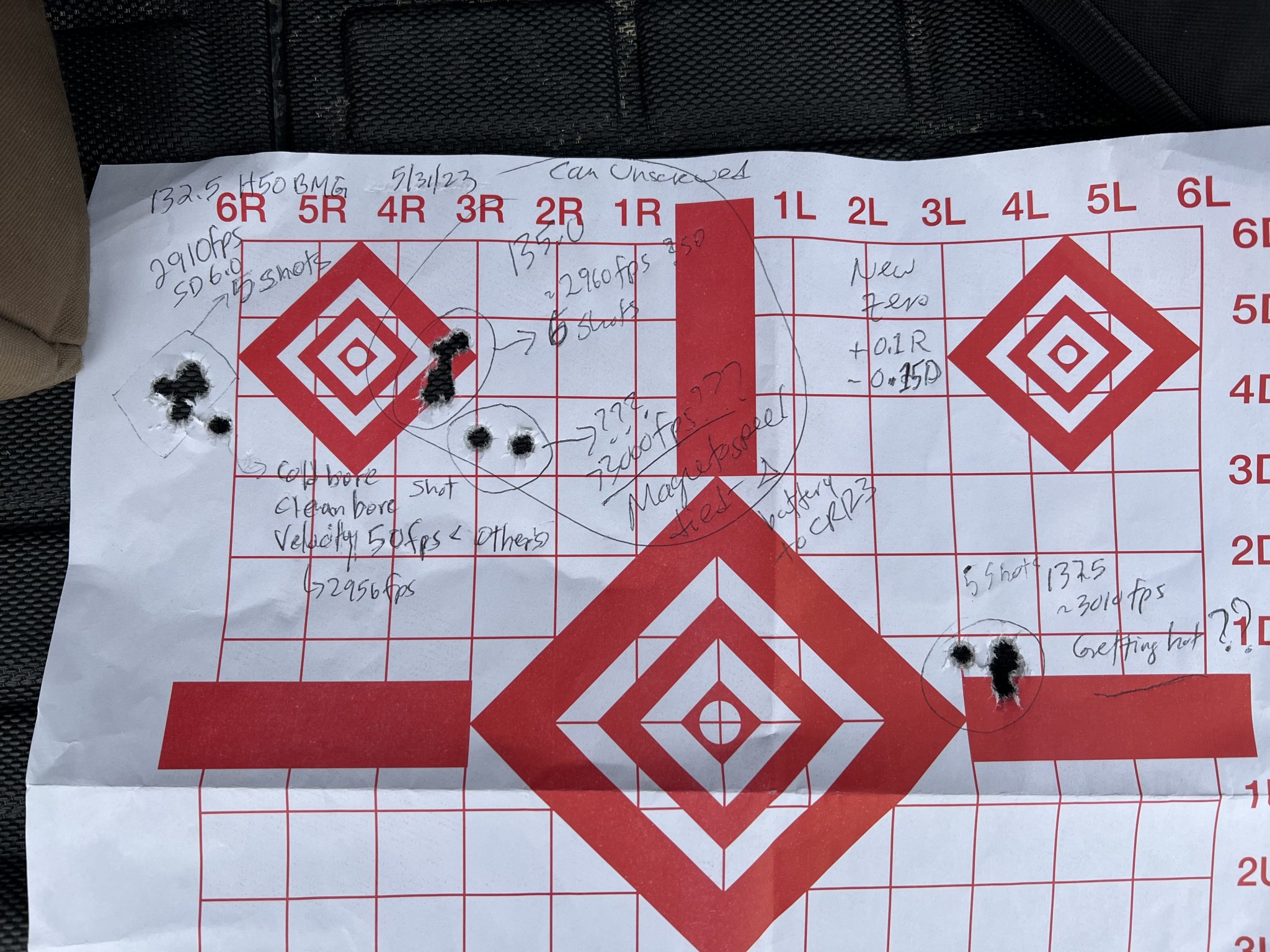

Full report to follow but H50BMG somewhere in the range of 132.5-137.5 is THE powder for the ATIPs in my barrel. Way more accurate and consistent than RL50 and about the same speed. 2910 to 3010 from 34” pipe. I’m gonna take the middle ground at about 134-135 and 2950-2960
Reactions: TripleBull

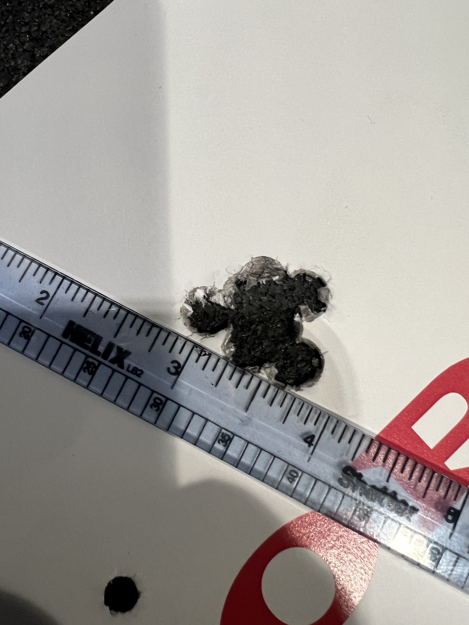

First group top left (ignore POI) is 132.5 H50BMG Bertram 4.250" .100" off lands. (One error in the whole sequence: my brass for some reason was slightly oversized, I needed to adjust my sizing die, not sure why, but needed another 0.003" shoulder bump and chambering was slightly hard, probably an issue with brass from two different barrels, problem fixed now.) First one was clean bore, cold bore, cold shooter and it was the outlier, and it was also 50 fps slower than the rest of the group so I excluded it from the stats for velocity. Ignoring that shot, the group is clearly under 0.5" for shots 2-6. 2910 fps, SD 6 fps.
Second group at 135 grains went haywire. First two shots were the top two in the group, almost one hole, 2951 and 2957 fps.. Shots 3&4 went to hell, low & right. Suppressor was slightly loose. Tightened. Then the next two shots didn't register on the magnet and the battery went dead. Replaced it and replaced the magnetospeed closer to the bore line. Next two shots went below the first two but speed was 3000 fps, inxplicably. Last two fell back in line in the lower part of that vertical group (excluding the two outliers) and the last two were right there at 2950-2960. Let's chalk that up to equipment failure.
Third group is the right one with 137.5. Bolt lift was notably slightly harder and there were very faint ejector swipes. Still, 4 of 5 in one hole, and abotu 1/2 MOA.
When I got home, i resized and reprimed first the 137.5 and I know for a fact the primer pockets were looser (but useable). So 137.5 is too hot for long term use of brass. The 135 and 132.5 were still tight (all had 5x firings before this session).
I'm going to settle on 134 grains and test that tomorrow I hope. SHould be pretty close to woofercau 133 load, allowing for seating depth and chamber differences and give me wiggle room. And be right abotu 2950 fps, just like my RL50 load but hopefully with better accuracy, SD, and less temp variation.
