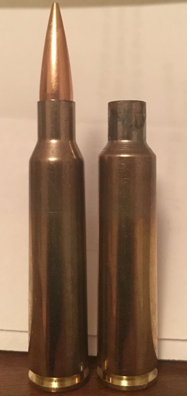

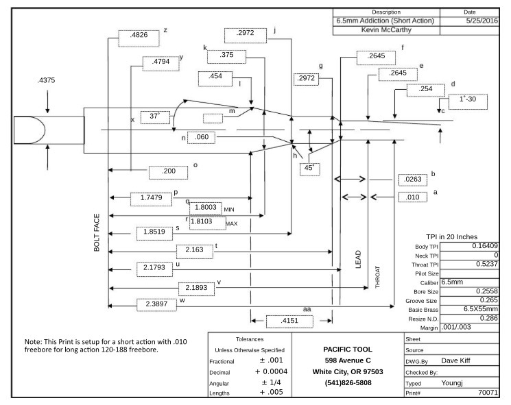

Looks suspiciously like the 6.5x55 Ackley Improved.

Looks suspiciously like the 6.5x55 Ackley Improved..
Sorta, close...
The 6.5 Addiction has a VERY short freebore (0.010" standard cylindrical throat IIRC) and it's setup like this for shooting 140's from a short action magazine.
It's a 30 degree shoulder I believe too, maybe 35 but I don't think it's a 40.
Fun catridge, does everything a 6.5-284 does without the more expensive brass or the rebated rim. 6.5x55 Lapua brass is very inexpensive; not like 6.5-284

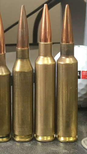

Fdkay, it is similar to the Ackley. Slightly more taper and a 37* shoulder. It would be interesting to see if anyone is running a straight AI in a short action.

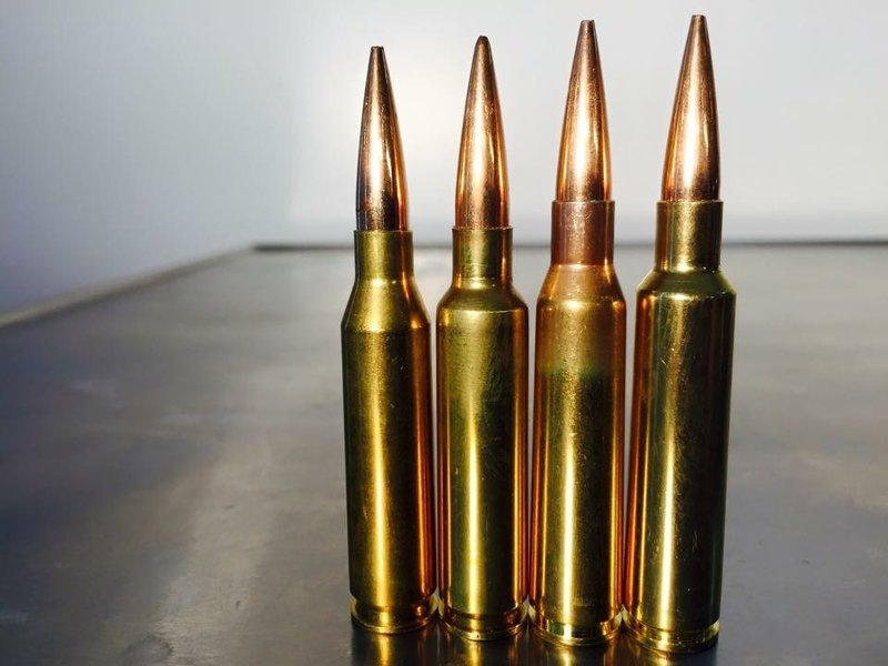

pic attached is edge of 6.5 creed - 260 - GWI - Addiction
I chose the GWI for 3 reasons, even though it is very similar to the addiction. As an old 6BR shooter, I love that little cartridge. The GWI was designed to "mimic" the 6BR. It has the same body taper as well as shoulder angle (30*) as the 6BR. it is smaller than the addiction obviously as the shoulder angle as well as body taper both limit capacity over the addic. I believe its within a grain of capacity but don't quote me. ha.

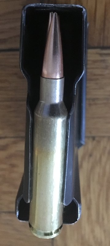

This is shot out of a short action. OAL is 2.94 with 2 thou neck tension and BR2 primers. barrel is 24" long. I use, and you will have to use, Accurate Mags that don't have the plate in front of the bullet that the AICS mags have (for that long OAL). Also, since the case is larger dia, you will only be able to fit 9 in the single stack mag. SO I bought a +2 extender. I would STRONGLY recommend against the +4 as the spring is not strong enough and if even a little dirt gets in, it wont push the bullet up and youll hate life. In the PRS match at Las Vegas last year, I used one and it cost me a top 5 finish as I had 2 stages I almost got 0's on because rounds weren't feeding and I wasted a ton of time working bolt and click then repeat. dang it.

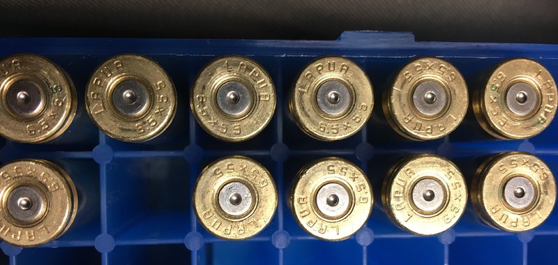

Appreciate the input, and nice shooting! That is the one down side of the Swede, European brass has that bigger case rim.

Where the hell can you find dies other than a group buy through accuracy addiction? Dies are what holds me back from this over a good old Swede. That, and I'll be running it from a long action so I don't need the 0 freebore.
I bought mine off a guy that decided to go another direction, so it made my decision to make the jump easy. I think you could buy them straight from Whidden, just count on a wait time. An Ackley Swede might be the easier route for convience and cost. I plan on running this for a while so the up front cost wasn't as bad. I also have a Win 70 long action that I'm thinking about rechambering in the addiction with the idea that if I go to a longer freebore I could run factory 6.5 Swede ammo in a pinch if I needed hunting ammo. So many projects, so little time!
Lash, I was referring to 6.5 creed..
Ah, that explains... I suspected that might be what you were asking about, but since the thread is about the 6.5 Addiction, which is based upon the 6.5 x 55 case, I wanted to make sure. I did look around to see if maybe Lapua was offering the 6.5 x 55 in small primer version first, as I'm always up for new information and knowledge.

6.5x55 has a slightly larger case head than 308 Win (and 30-06). Standard non-rebated 6.5x55 brass work with some 308 Win (and 30-06) bolt faces but not all. I tried to fit a 6.5x55 Norma case in an AI AX 308 (2011) bolt face but the case head was too large. So you might have to modify the bolt face if you want to use 6.5x55 brass in an AI AX 308.
Good point, you may have to have your bolt face opened up 8-10 thou to accommodate European brass, i.e. Lapua. Not a big deal and doesn't affect being able to go back to standard calibers.

had a talk with accuracy addiction folks and they said there was a string of bad reamers and a whole bunch of gunsmiths were making bad chamberings or what not. They said for the 6.5A they're the only ones that can currently guarantee the proper work (this was as if 2 weeks ago when I spoke to them)
Anyone have issues with this?
First I've heard of it. I did get a reamer but since Kevin did the barrel I'm on now, I haven't used it yet. I'll have to give him a call and see what the deal is. Thanks for the heads up!
A heads up for anyone looking at the Addiction. There is a batch of bad go-gauges going around. If you have some, make sure you get them checked out before using them to chamber or set headspace. You can contact the guys at Accuracy Addiction if you have questions. Please spread the word.
