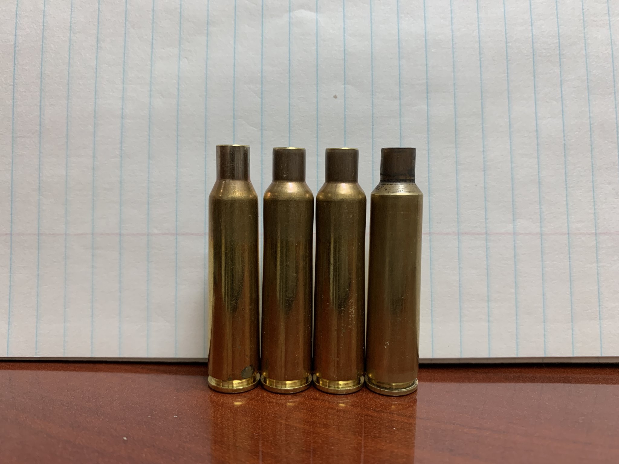

Couple months ago I ordered up a hydro form die from Whidden. I had it made from the JGS reamer print. I wanted to save my barrel 2-300 rounds of wear from fire forming. Considering I use this for PRS style shooting and most all the rest of the LR shooting I do as well, I plan on about 12-1500 rounds from a barrel. I’m pushing a147 at 2900 give or take some velocity depending on powder. So 2-300 rounds of 1500 on a 700 dollar barrel, pretty much paid for the cost of the hydro form die kit. I get about a 75% form. The 6.5x55 case is about 56grs h2o, the hydro formed case is about 59, and the fully formed is 60. The shoulder blew out to full diameter, but the sides did not get fully straightened.
When I used plain water the results weren’t all that good. Rubbing alcohol works marvelous, but right now that is almost liquid gold like toilet paper. I used listerine as a substitute. Pretty high alcohol content seemed to be the key for good performance.
I have another 4-600 rounds of life probably left on this barrel before I get to test the hydro formed cases, but it is close enough I expect good results from a full power load.
TRG65, so instead of using water to hydro form, you are using rubbing alcohol or listening? With good results?
I gave up on my hydro form die because I could t get results anywhere near what I thought they should be. I might Have to try this with my next batch of brass.
Right now I have 400 rounds down my 26” 1:7.5 tube, and as I look back on my numbers, the barrel just keeps speeding up!
MattSplat, Correct with water I was getting very poor results. I also had to space the die .010 off the shell holder, I tried more (actually significantly more, but started getting a line in the neck I didn't like the looks of, but the shoulder definition was much better after full length sizing, I think the most I'd space would be about 15-20 thou). I gauged it using a piece of shim steel. If you can get rubbing alcohol it gives the best results. However, I was using mostly listerine (the yellow version with the most alcohol). Like I said, it is about 75% of the capacity gain. Below on the left is a x55, then two hydroformed and FL sized cases, then a case with 7 full power firings.
  • Love
Reactions: MattSplat
TRG65, I turned the necks of 1/2 a box of new Lapua brass on the weekend, and tonight I used my hydroforming die on a few cases using pure alcohol, isopropanol I think. Like your experience, the sizing definitely worked better than with water, thanks for sharing your tip!
When I first got my barrel chambered, I loaded a heap of new rounds at magazine length, with 129/130 gr pills, but I think because of my long throat for 140 gr Bergers at a long action length, I had terrible results with most failing to fire. Once I disassembled them and jammed 140s, my fire forming when without a hitch.
With this hydroforming and then FL sizing, it seems I have a false shoulder, so I’m going to test a few and see if I can successfully fire form with my old stock of 129 gr ABLRs st magazine length. I feel reasonably confidential that it will work this time. I want to get some cases formed before I set this barrel back and get my new long action rifle up and running.

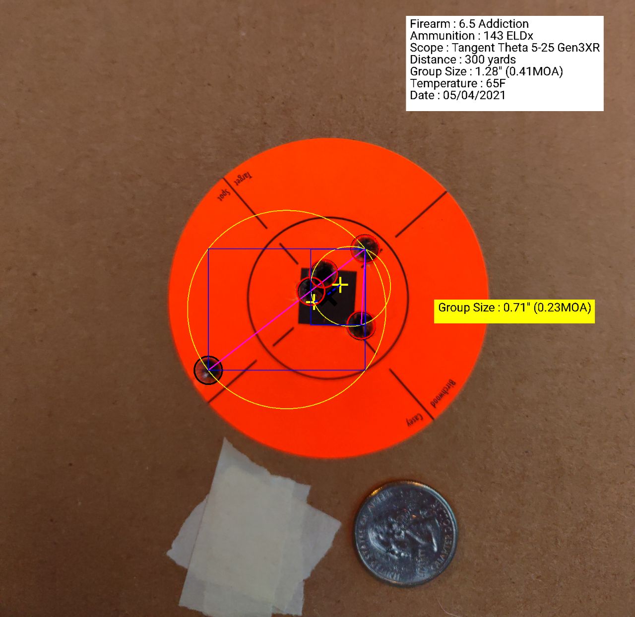

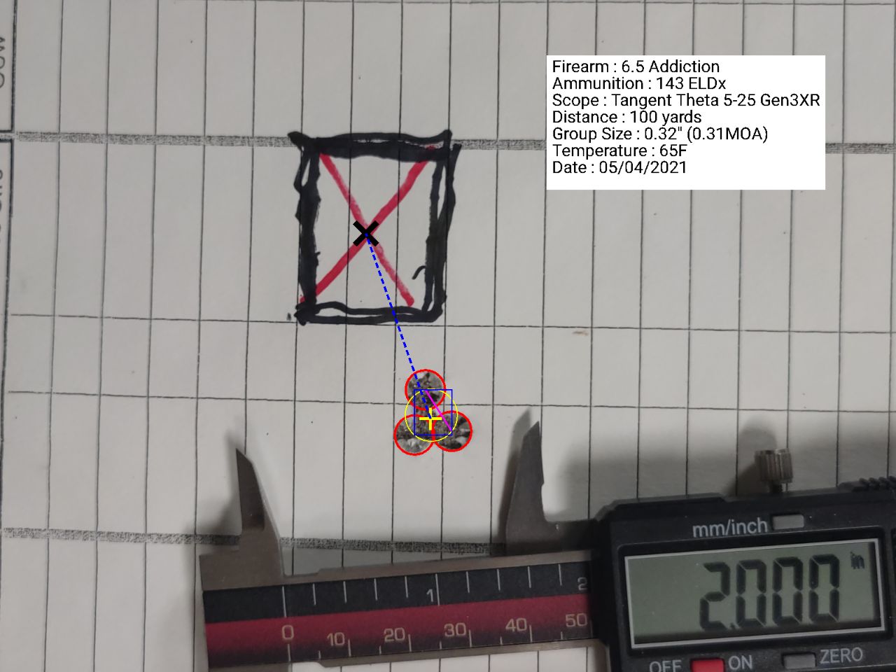

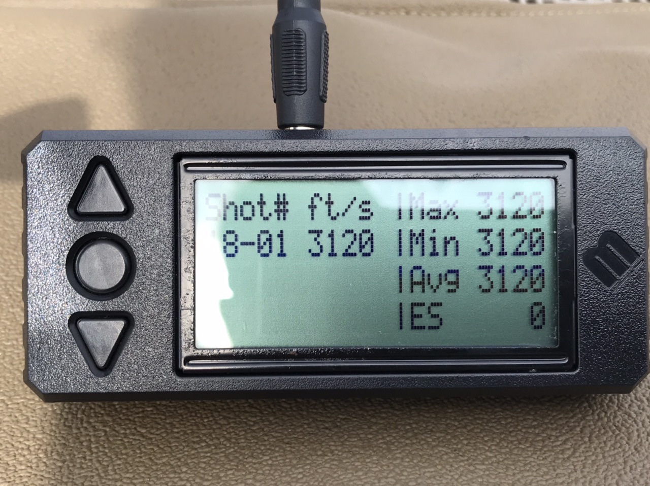

The sweet sauce for mine ended up being with 143 ELDx and RL26. Relatively warm load at 3120fps with an ES of 20fps over .4gr spread of powder, although primer pockets are solid and brass is in great shape. The one issue I am having is the dimensions of the case head being .4803 for the Sweed, and the standard .308 case being .4728 ... the Sweed case head is 75 thou larger. (maybe it shouldn't matter) but about 1-2 cases per hundred will have a failure to extract and the claw extractor of my BigHorn TL3 will slip off the case rim.
Taps out very easy with a rod, so it's not excessively over pressure.

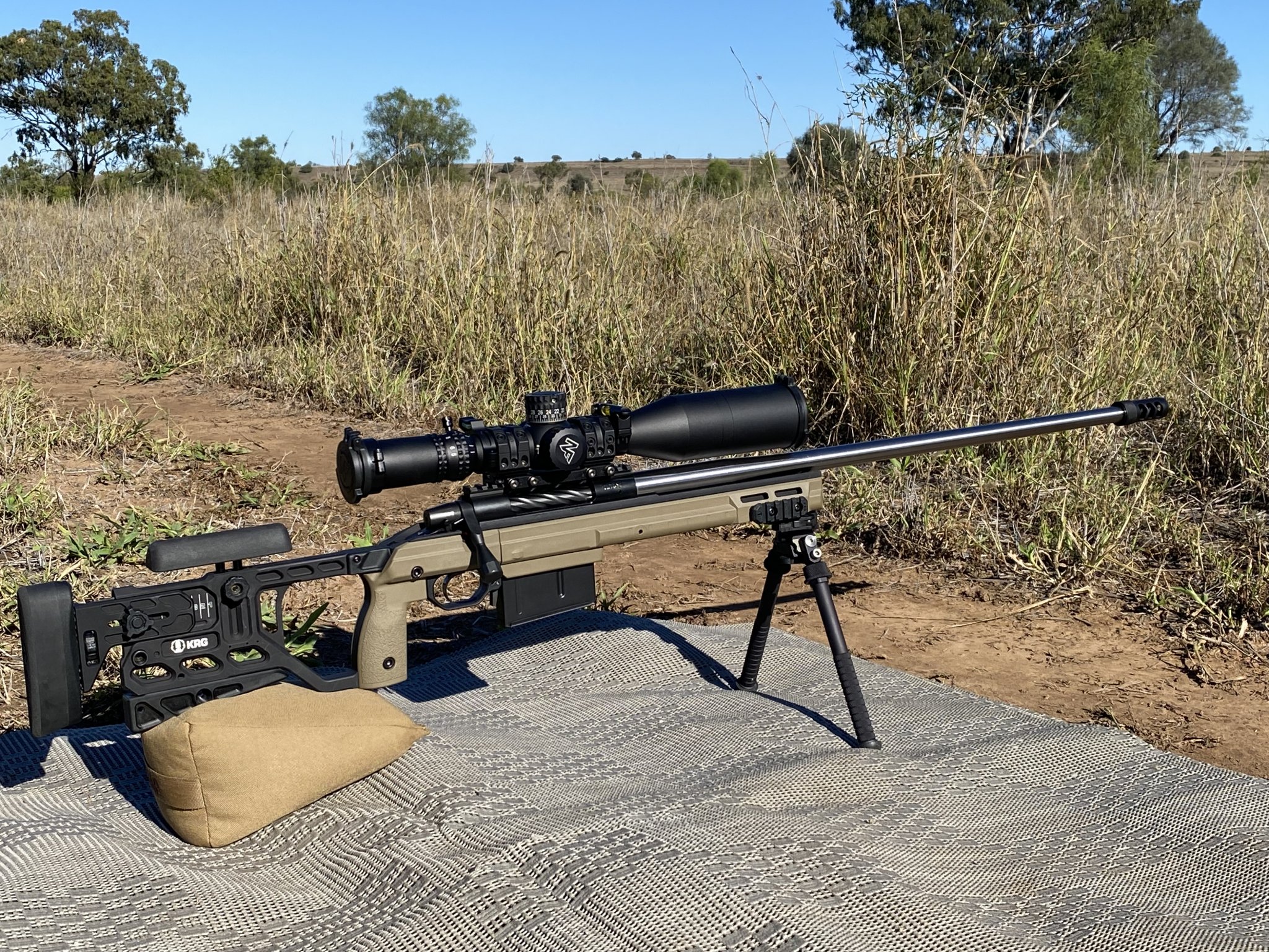

Wow, how quite is this thread. I’ve got 76 rounds down the tube of my new long action. 52.7 gr RL26 under a Berger 156 gr is giving me 3,006 to 3,017 at around 20 degrees Celsius, with the occasional fast and slow shot.
I don’t hold much hope for RL26 as we get into the Aussie spring and summer. Soon I will have to go back to 2225/Retumbo.
