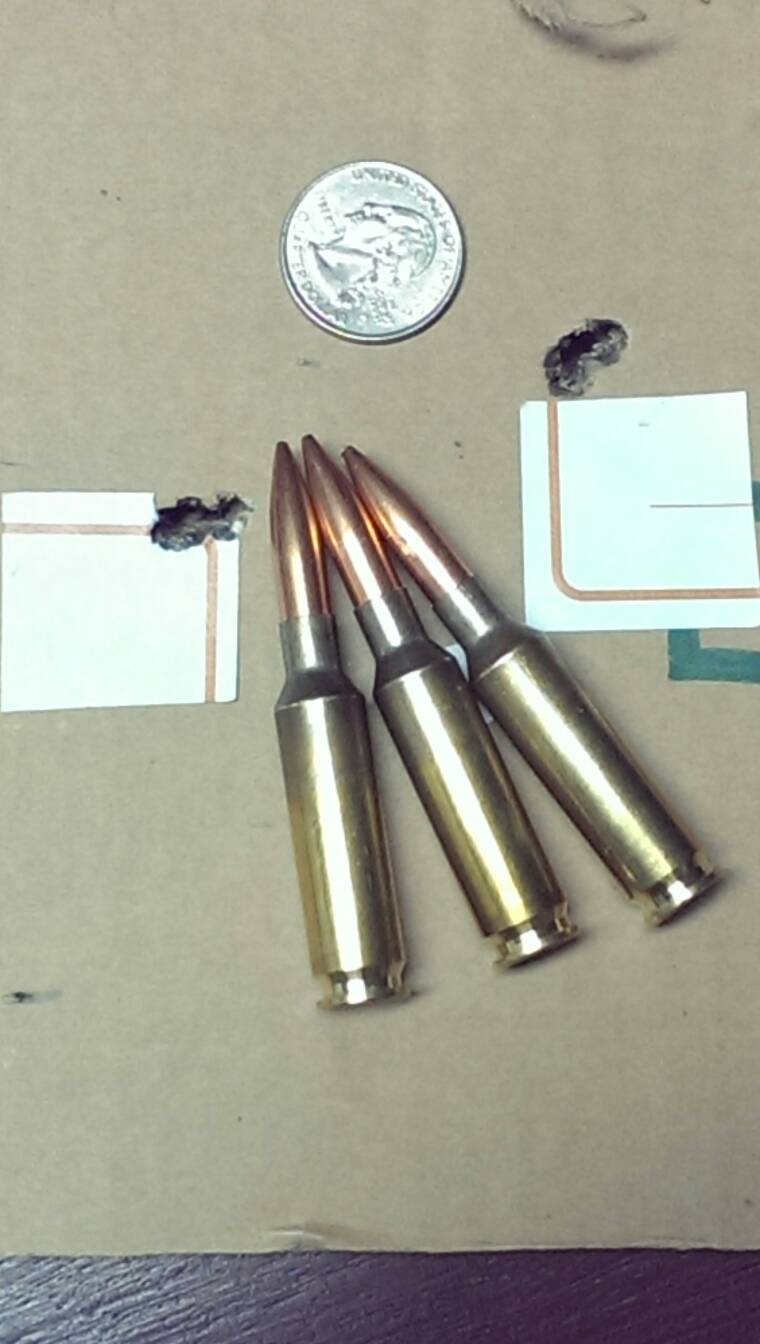

Reloading gurus please advise... I have a load using 41.9 grains of IMR4350 that is a hammer but I would rather use H4350 so here is what I have so far. All are 3 rounds @ 100 yards.
All are loaded @ a COAL of 2.860" which is where my IMR loads cut a 5 round ragged hole.
I'm going to leave my opinion out of it in order to not sway anyone's thoughts.
I would sure appreciate any input.

If you know you threw a shot on thet 42.3 then that would be my load. I would definitely test it again. Elevation is identical it seems in all three rounds.
Really, you should test at 200-300 to see the difference, that's where you'll be able to tell the difference from a good load to an awesome load.
Yeah Pusher, my plan was to run out to the farm & shoot'em @ 500 but it started pouring rain so I opted to use the local indoor 100 yard.

OP. I am with you. I would use the 41.7 grain load. It is in the middle of your accuracy node and should give the best results over a broader environmental range.
As far as switching to H4350, do you need to change because you are out of IMR4350 or do you feel there will be come magic advantage to the H4350?

The magic advantage is it's consistency throughout various temps which IMR lacks, to a certain degree. Pardon the pun.

I didn't read the entire thread , bit this is a question to a question. If its shooting in the same hole at 100 yards.... Wtf is the problem. I once had a problem... It was called "trying to improve things that did not need improvement ". After enough $$$ spent , time and bbl life wasted ... I said to my self " Holy Shit, the time I've spent chasing the perfect load to satisfy my OCD, I could have spent out in the range having fun" and the money spent on bullets and powder could have bought a new bbl plus some on the smithing. I'm not out to criticize the OCW method, as I see it as a very useful tool. But out of EVERY SINGLE RIFLE I have ever owned, the ones that shot "one ragged hole" at 100 yards were absolute hammers to whatever distance applicable for that particular round.
H4350 is not magical fairy dust , although some might argue its "more temp stable than IMR 4350". That may be true, but I've seen some HUGE mv changes with drastic temp changes and h4350.
I really don't want to come across as a jerk or a know it all, but I see it WAY TOO MUCH.... Guys who have loads the majority would kill for but think it needs to be improved.
Take it from me, get a pen, pad , and write down your dope at each range trip and ENJOY!!!

Took it out to 300 today. Wind was 11-15 FV with gusts to 19. Probably should have held out for calmer winds but decided to roll with it. Wind would not allow me to use chrono so unsure about speed but 42.4 - 42.6 are obviously faster than my 42.0 load of IMR 4350 (2810 fps).
Thoughts??
Sent from my iPhone using Tapatalk
Another question, are you running a tight chamber, what action? Only reason I ask is my loads are at 2.800" (2.215 to ogive ) and they ( along with the vlds shoot better jumping. They absolutely will not shoot anywhere near as good loaded long. I've had the same load since I bought the rifle and only up'd the charge weight up .2 grains after 2,000 rounds to compensate for bbl wear and a lot more freebore. Other than that I'm running the 140 hybrid at 42.6 h4350. It was 42.4.
Remington 700 SA. Standard chamber. I shot the 41.9 of IMR4350 @ 2.800" to start. & worked my way out to 2.860" which is where I found my tightest groups. I am going to get out & shoot the 41.9 of IMR4350 & the 42.6 of H4350 head to head & see what happens. If the H4350 shoots as well or better, I will work my my back to see if I can get it to tighten up.
