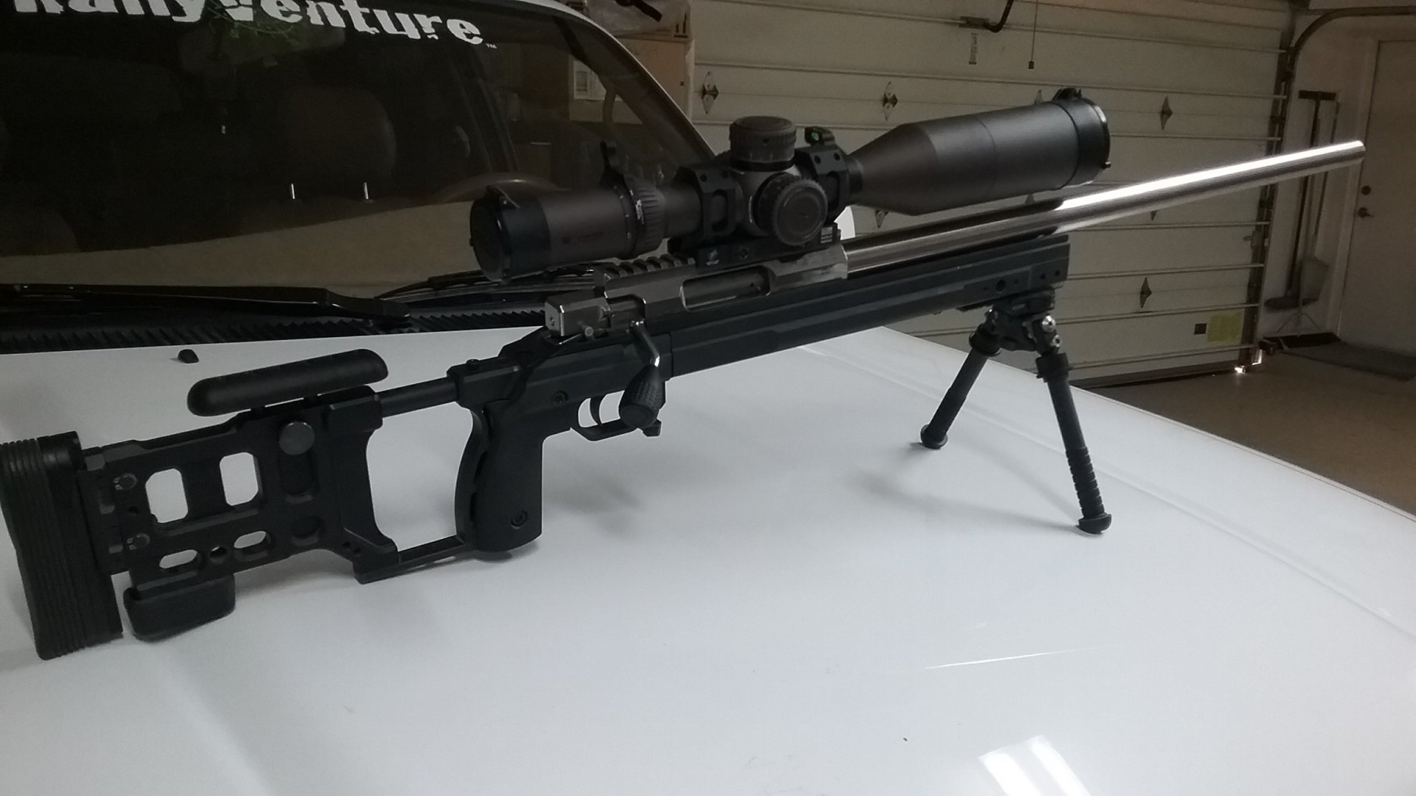

20" Bartlien chambered by GAP
2.900" OAL with a .010 jump. Would like it longer to get more speed.
2799 FPS with a 3.7 SD
I just don't see the need for a longer barrel when it can shoot faster then most with a 24-26" barrel.

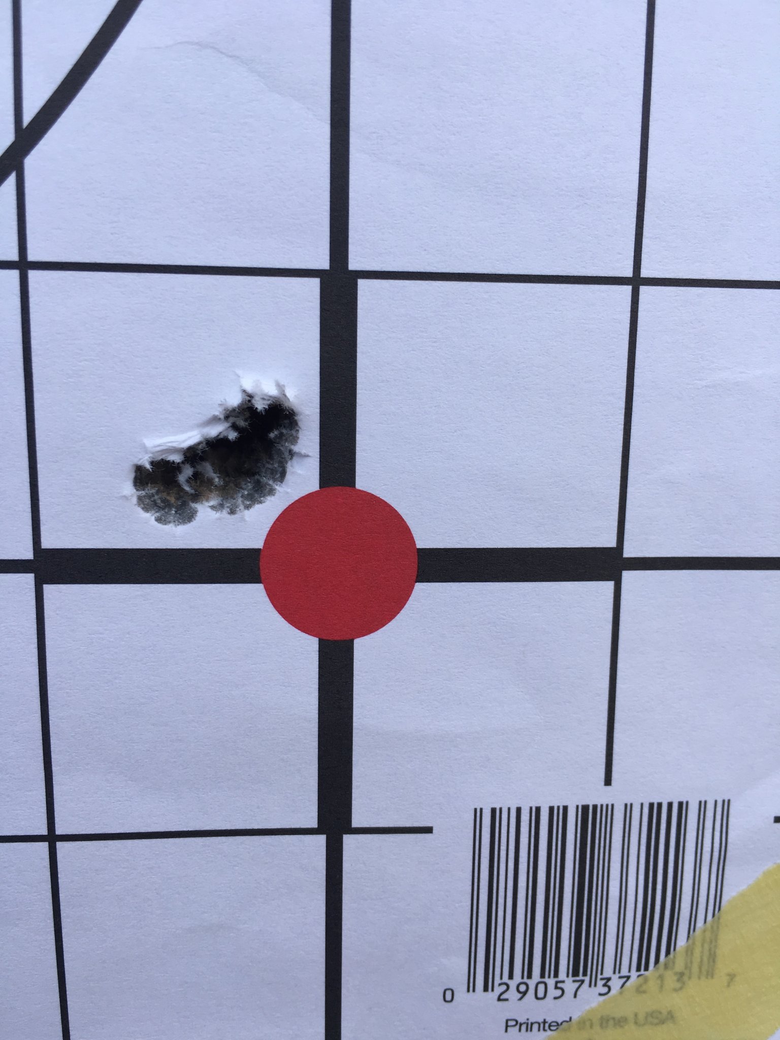

On seat test Thursday at 500 5 different depths of 5 shots averaged 2.43" with 2 wide shots
Best depth I shot better then I can and got 5 in a nice little .96"

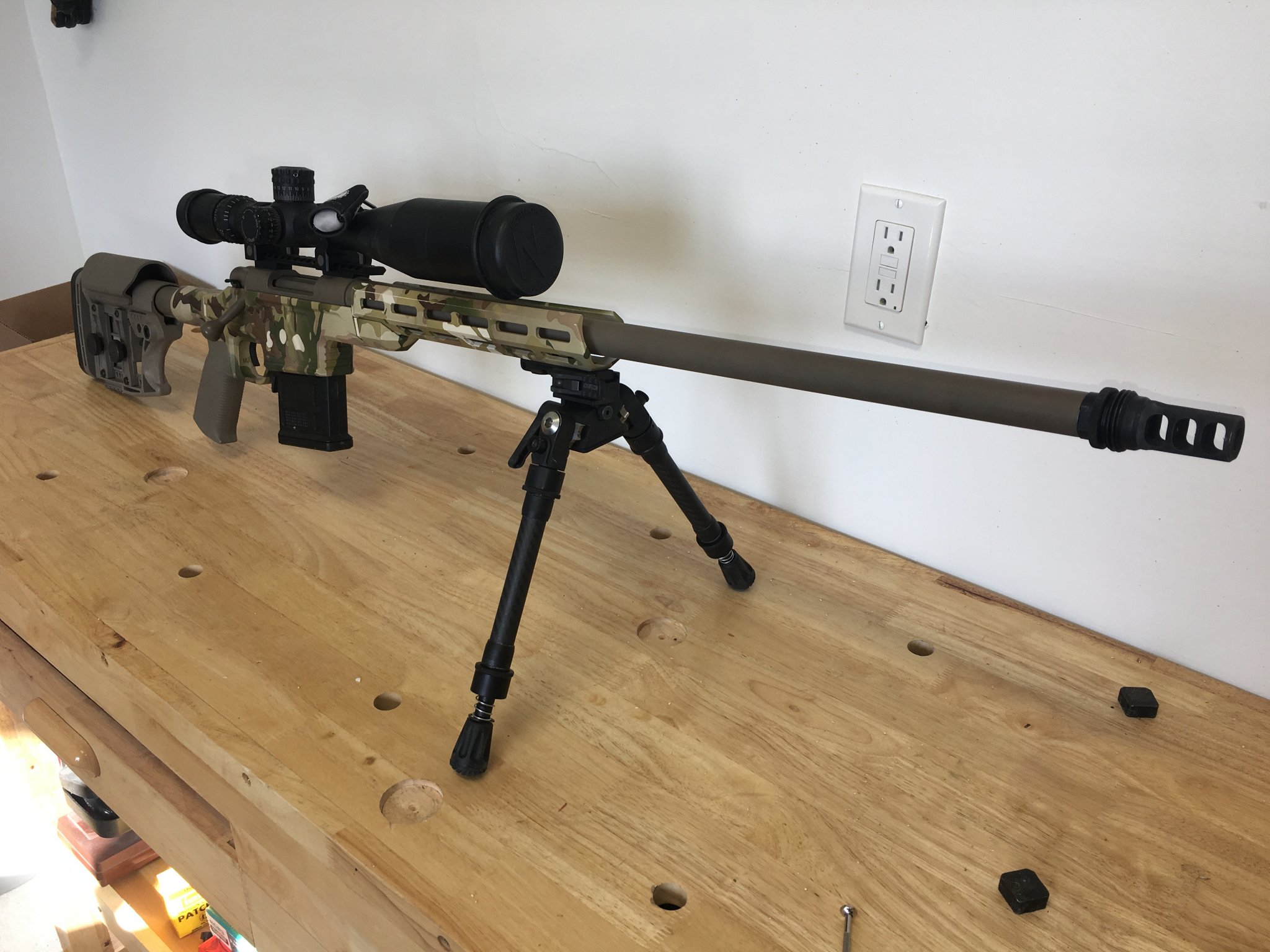

23” criterion
Savage 10 action
Aics
42g H4350 140eld @2750.

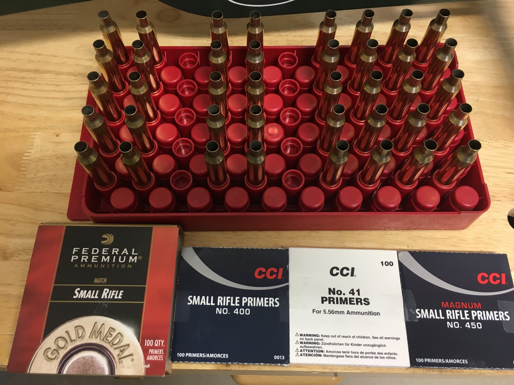

So today I ran a primer test of sorts. I loaded my preferred 6.5 CM load into 40 once shot Lapua brass, all with the same specs, changing only the selected primer.
My load: Lapua Brass, 42.5 grains H4350, Berger 140 grn Elite Hunters, COAL 2.865” (Max length for a P-mag).
Best Primers? TBD Today
I tested 4 different primers to see if there was a difference with primer cratering. I figured I might as well make thing as scientific as I could, so I ran everything on my Magneto Speed to gather as much data as I could.
I wanted to test for 5 things at once. #1 MV #2 SD #3 Group size #4 Evidence of Primer cratering #5 Any other signs of over-pressure besides the primer cratering.

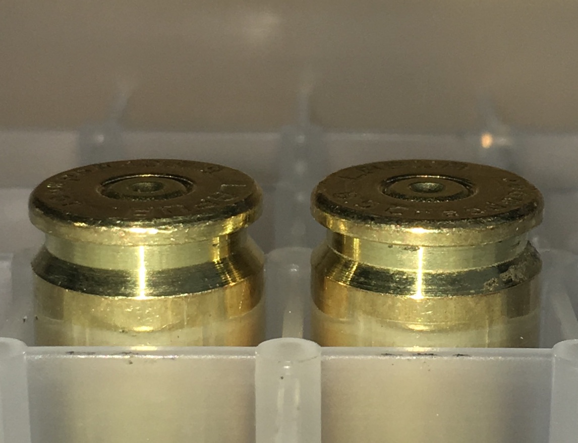

Primer test results

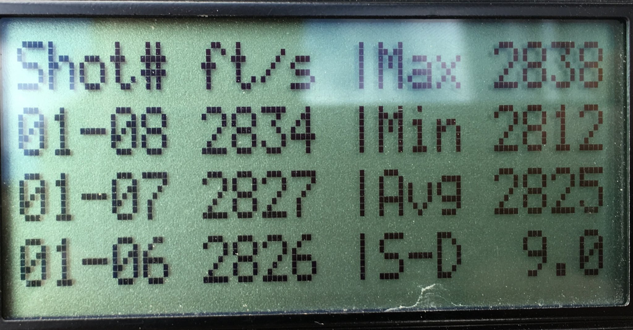

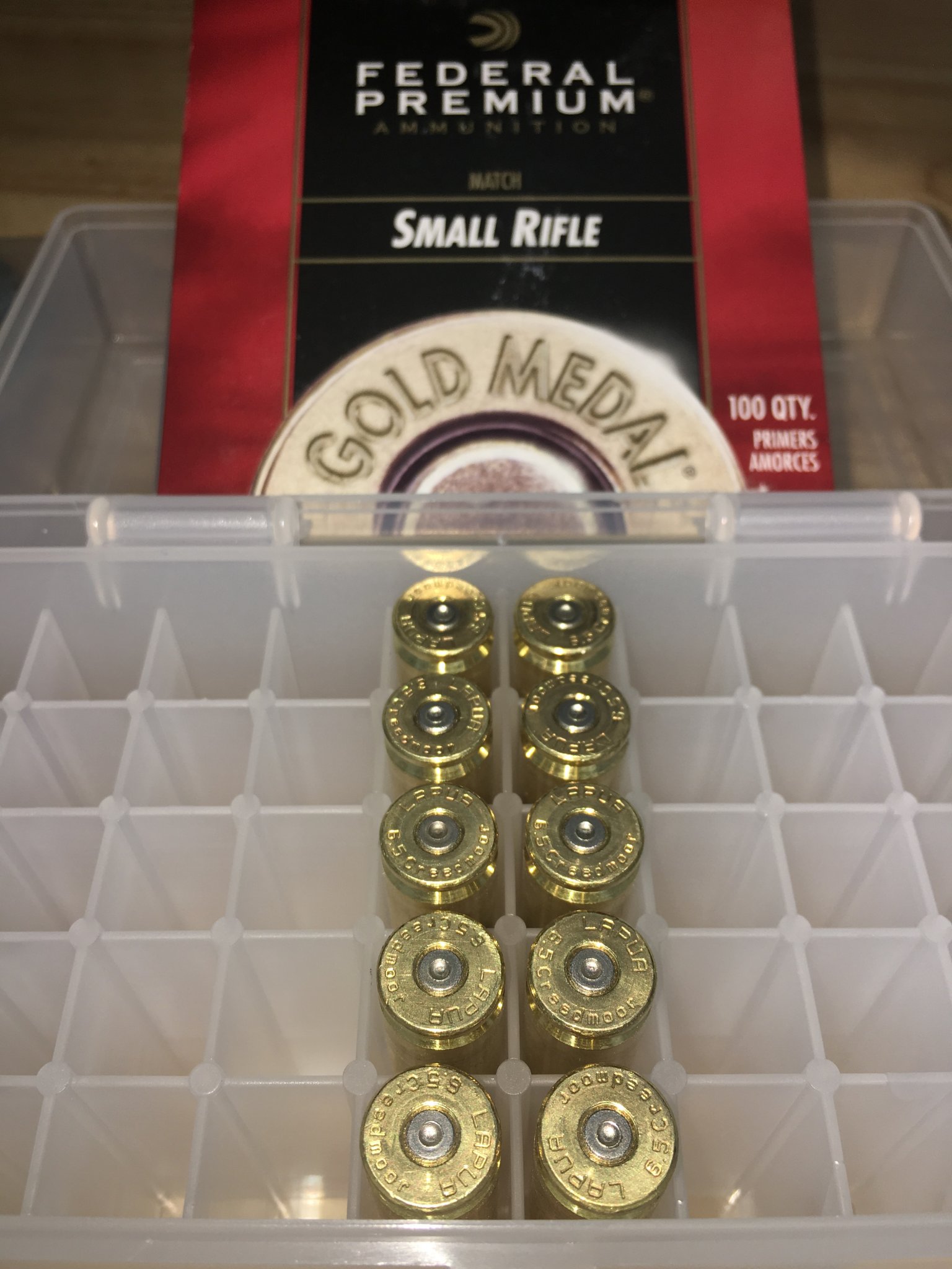

Federal GMM Small Rifle primers performs as follows.
MV: 2825
SD : 9.0
Group Size: .6 MOA
Primer Crater: Minor cratering I could barely feel a ridge with my fingers on 4 of 10 brass.
Other signs of overpressure: Barely noticeable case head shine on some cases.
Small but noticeable craters on the F GMM small rifle primers!!! Enough to worry about? Pretty small, I might experiment more. Should definitely check these with my can installed, it could push it too much. This close-up makes them look obvious, but you could actually barely feel it.

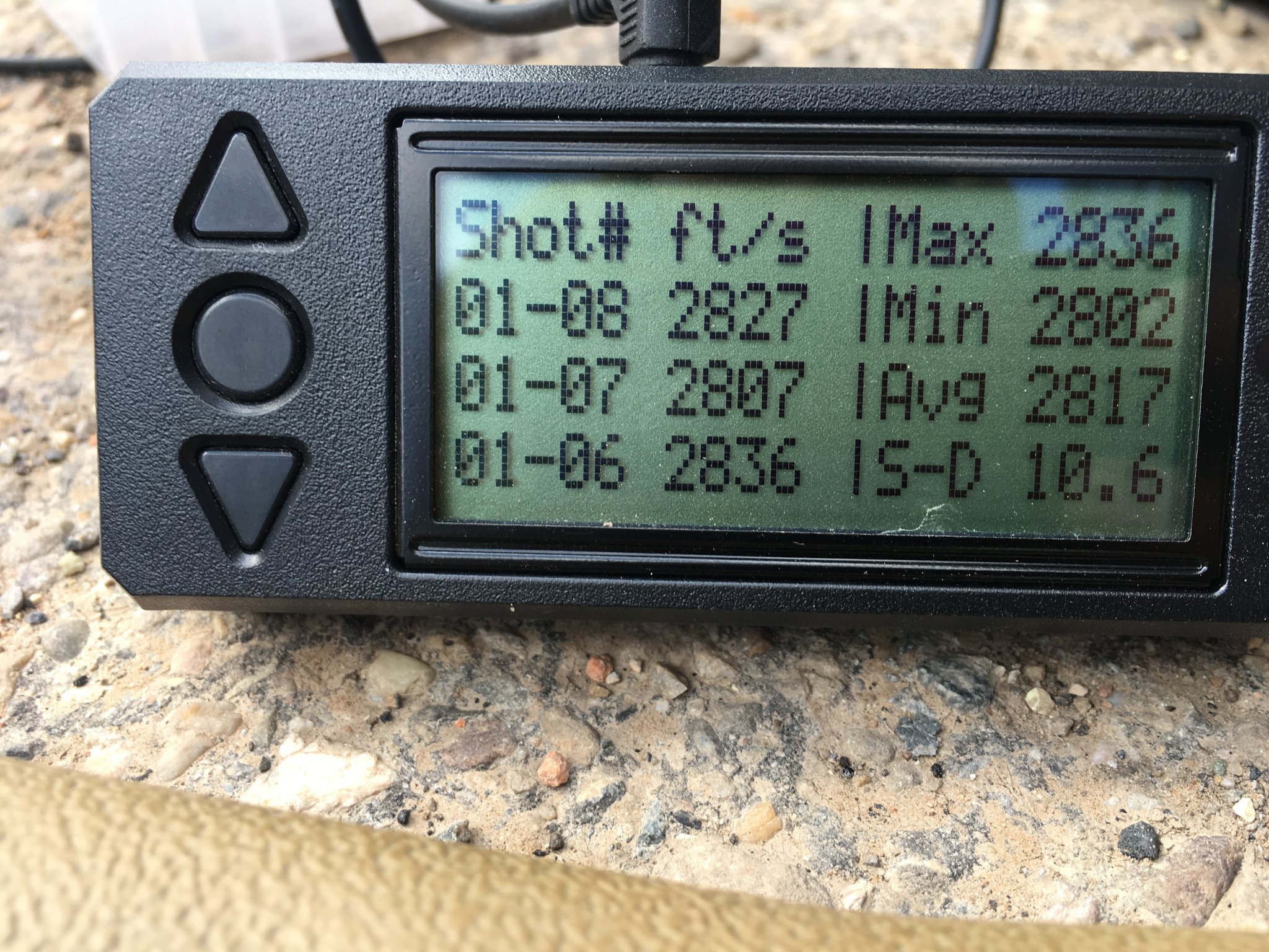

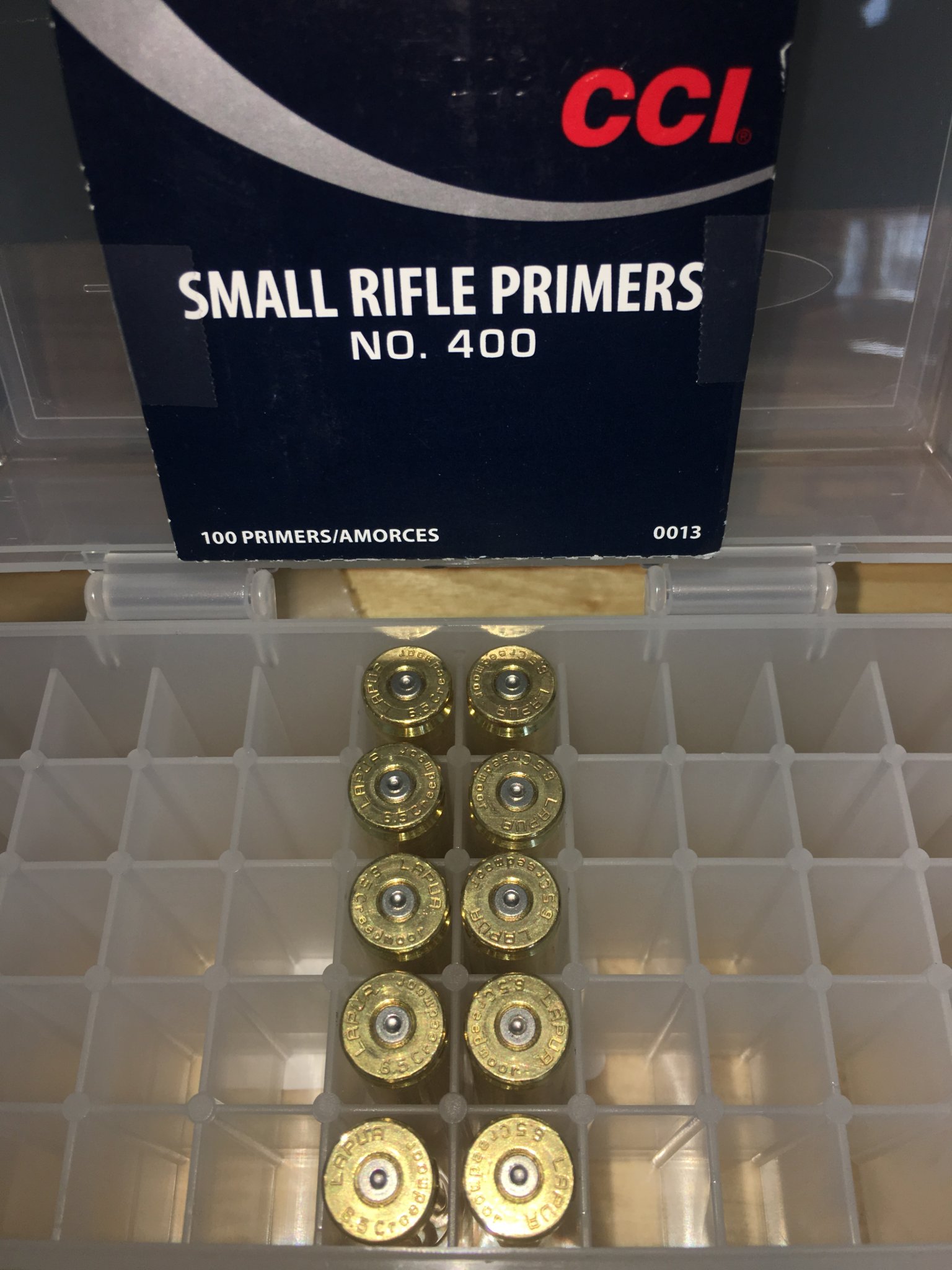

CCI #400 Small Rifle primers performs as follows.
MV: 2817
SD: 10.6
Group Size: .33 MOA
Primer Crater: I could feel a pronounced ridge on all 10 primers and it was noticeably larger and more pronounced on all 10 than on the FGMM primers.
Other signs of overpressure: Minor case head shine on most cases.
CONTINUED BELOW

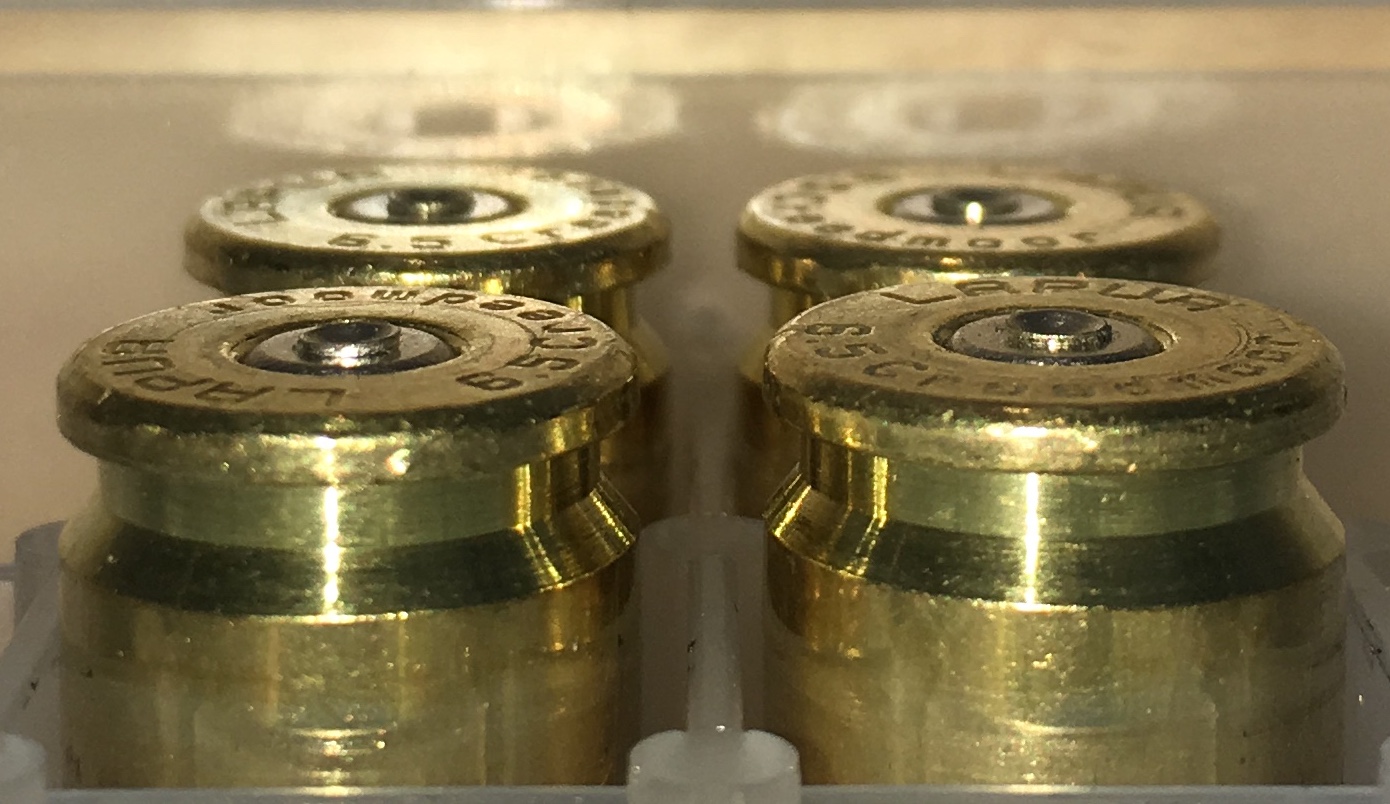

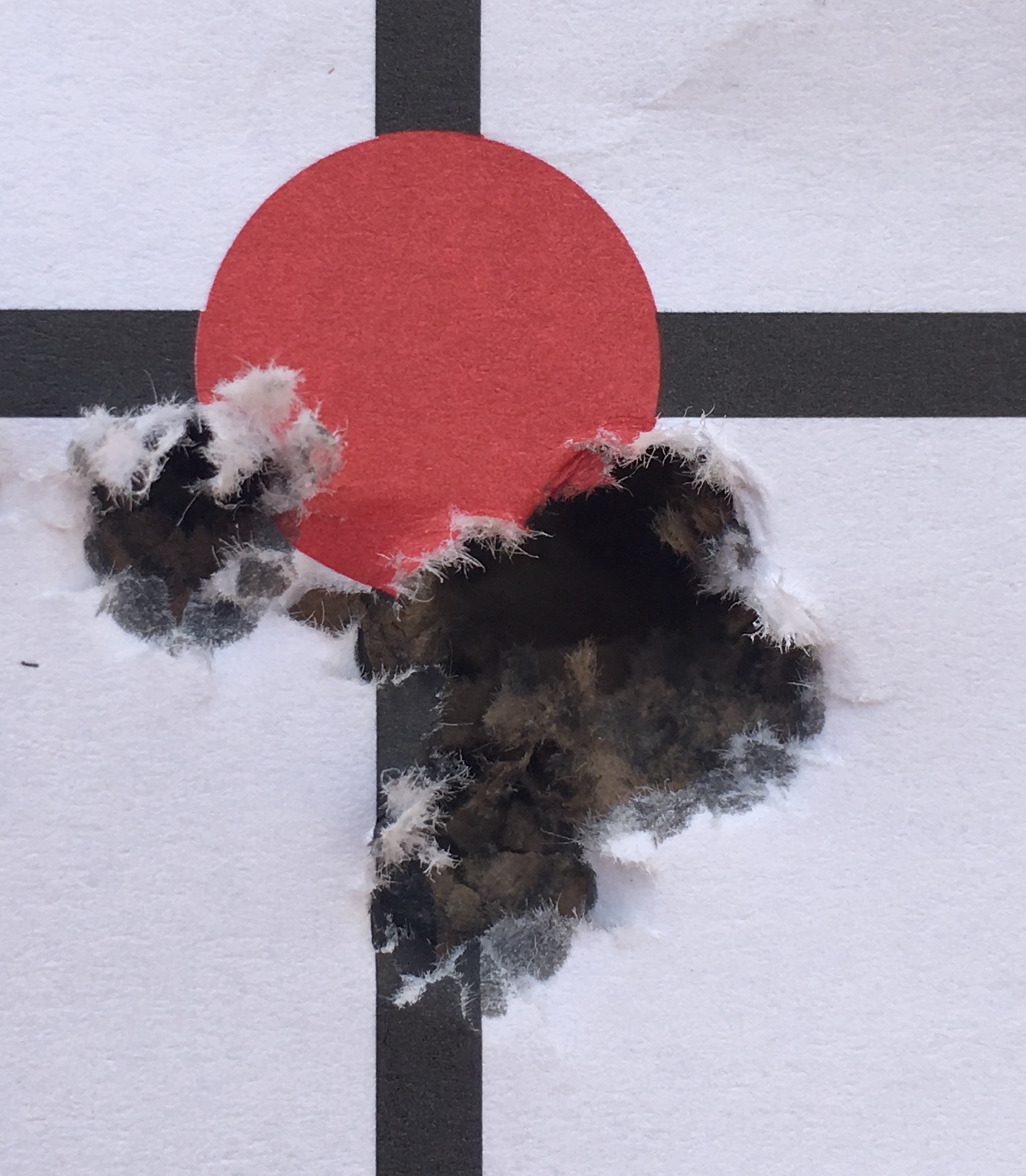

Primer Test Part 2
LOOK at those craters!!!!!!! I can't recommend running these primers with this hot of a load of H4350, in this rifle.

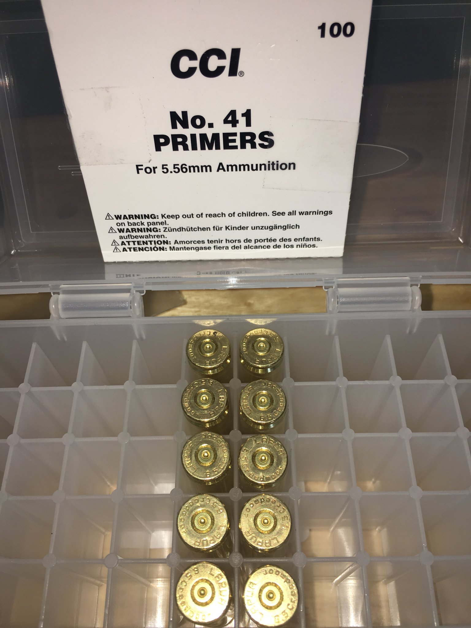

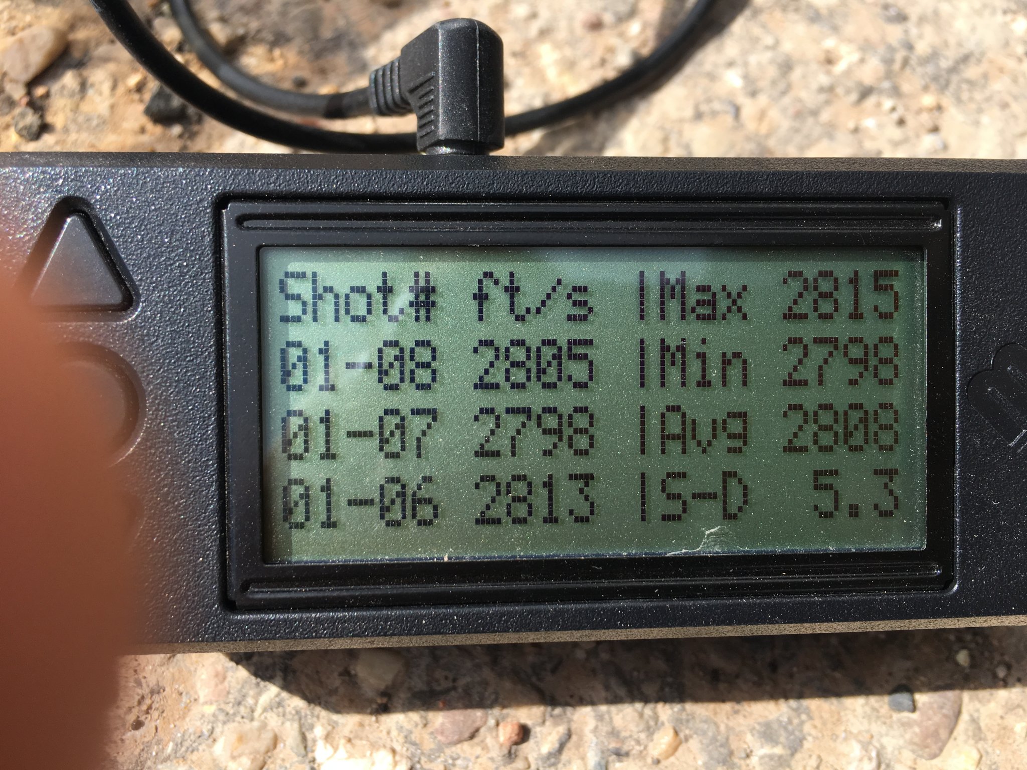

CCI #41 Small Rifle primers performs as follows.
MV: 2808
SD: 5.3
Group Size: .738 MOA (with one called flier)
Primer Crater: Absolutely None discernible.
Other signs of overpressure: Extremely minor case head shine.
Beautiful, no cratering whatsoever!!! Yes, these babies are gold colored.

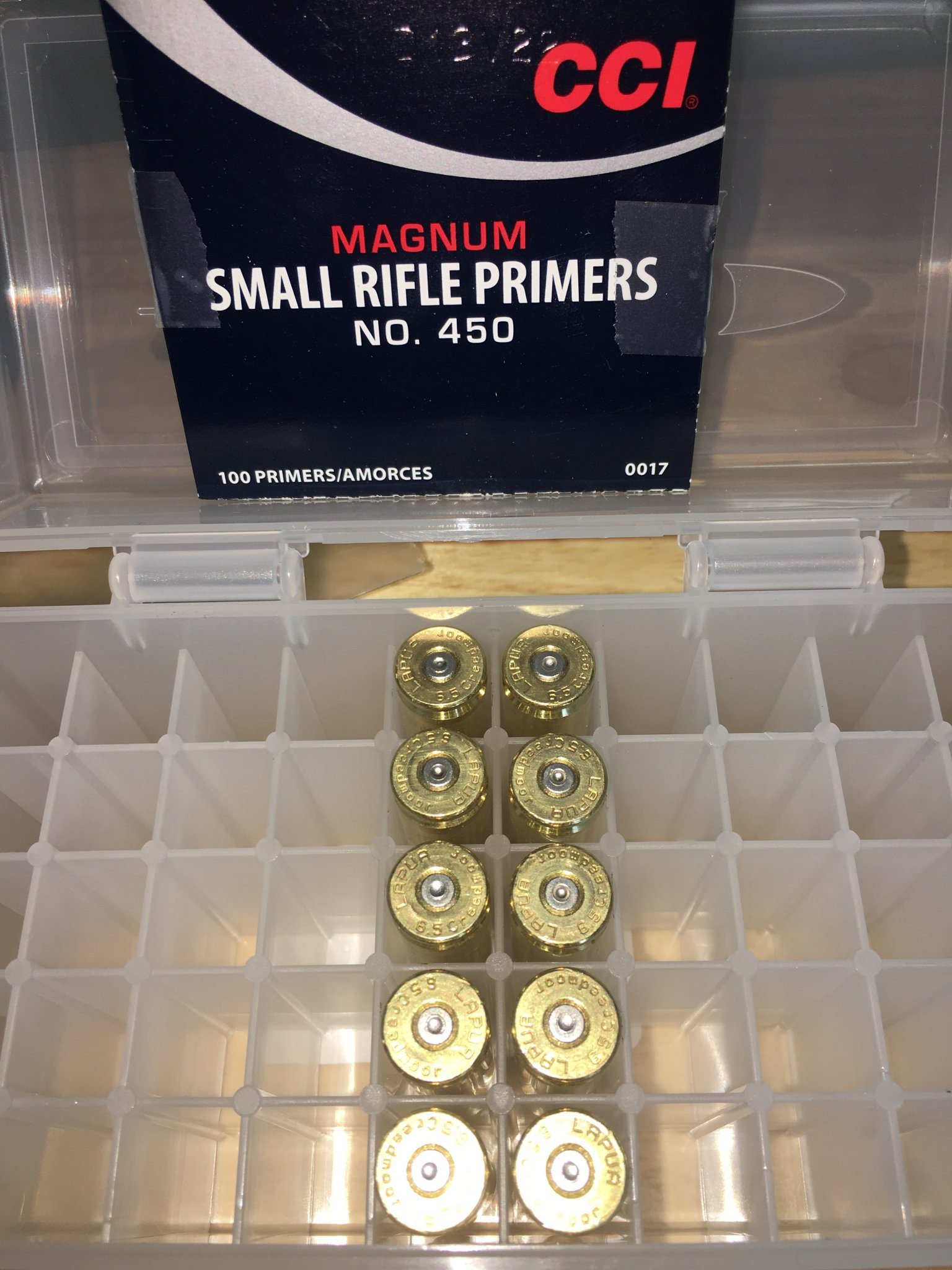

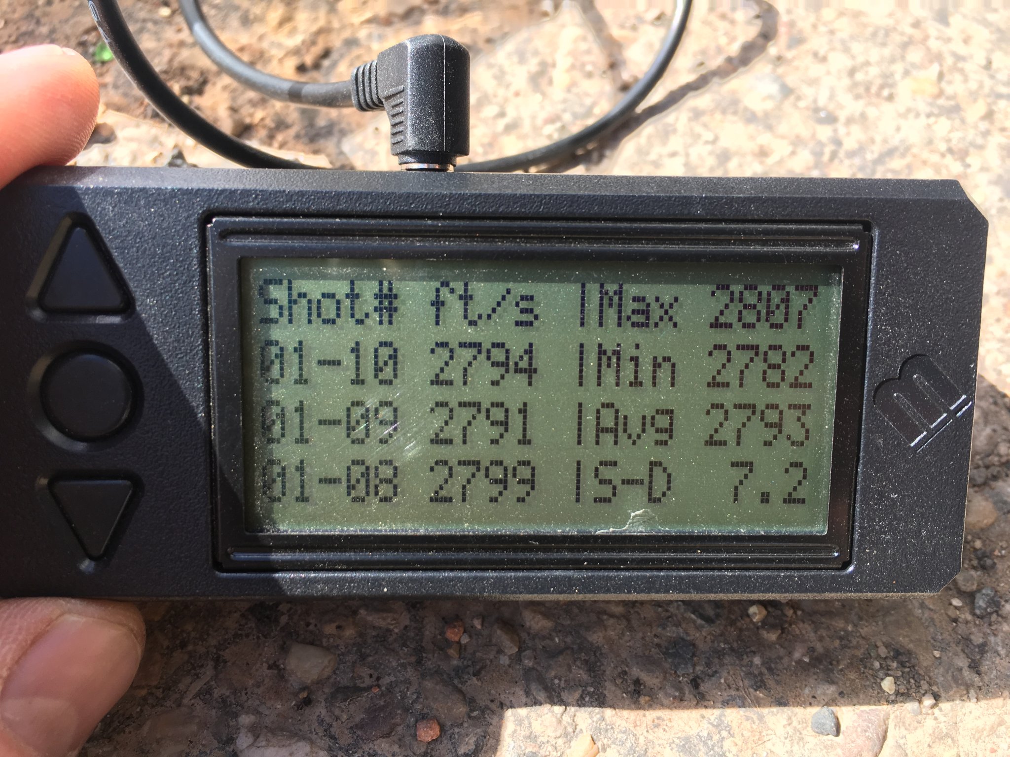

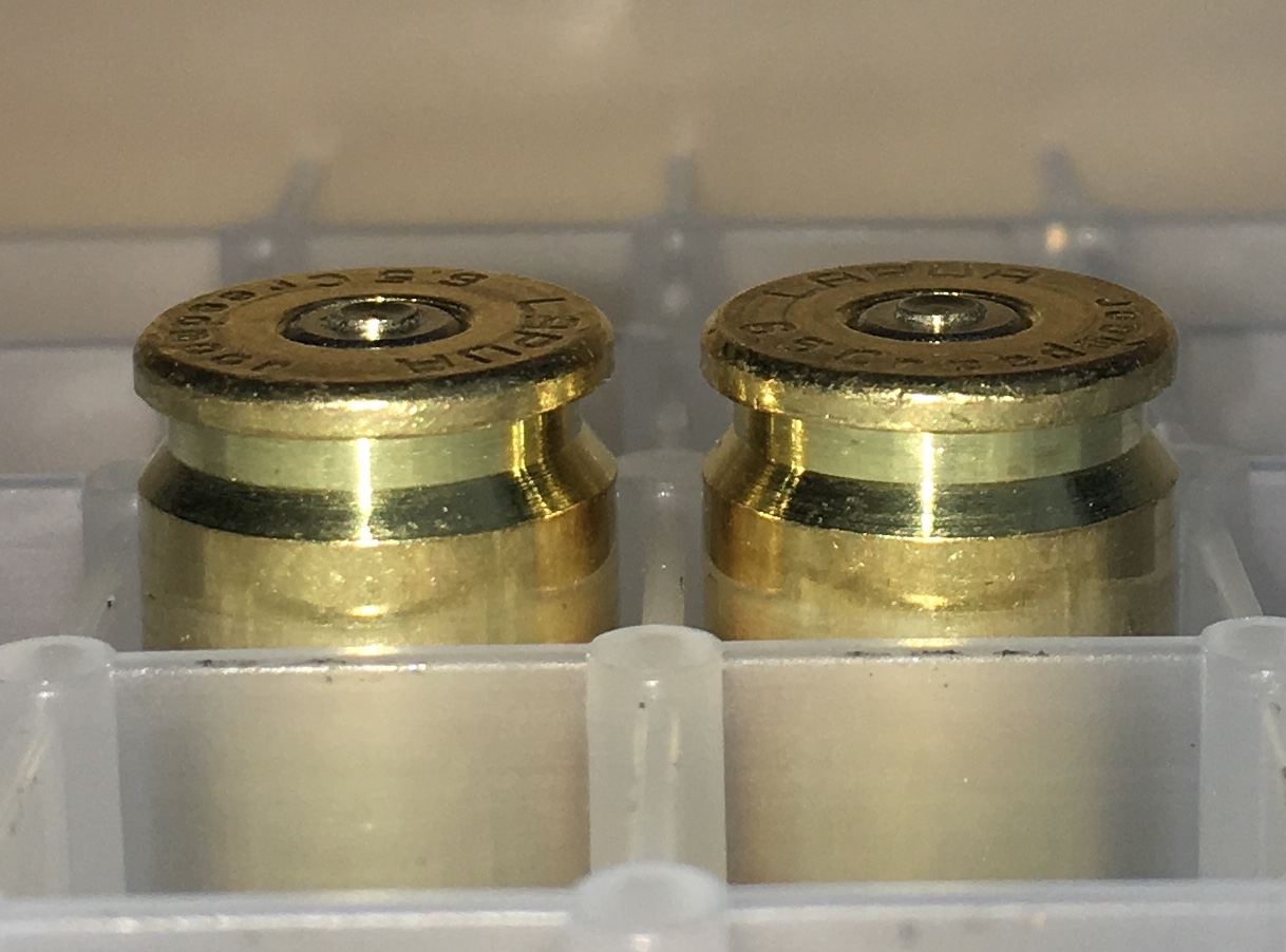

CCI #450 Small Rifle primers performs as follows.
MV: 2793
SD: 7.2
Group Size: .33 MOA
Primer Crater: I could feel 6 of 10, all felt larger and more pronounced than the Federal GMM, but not as bad as the CCI 400’s.
Other signs of overpressure: Minor case head shine.
Yowza! Crater city!! Same thing, too hot for me with these primers too!!

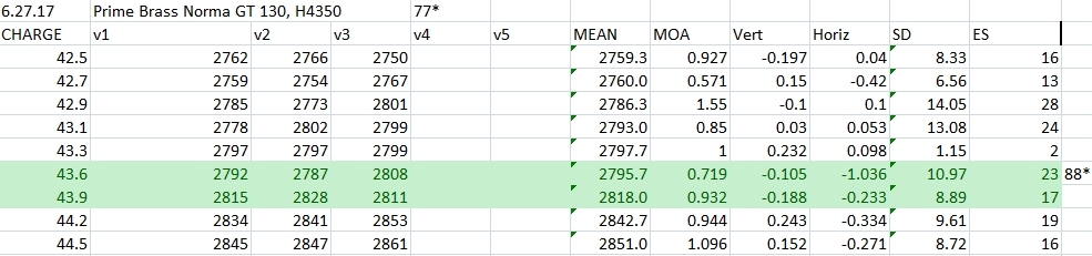

*using CCI-450 primers, H4350, Once fired Lapua brass, Hornady 140 ELD-M.
2. I'm finding max load on my Tikka Tac A1 24" and I've hit 43.6 grains with the only signs are some case head shine. Confirmed by my armorer.
3. I'm seeing average speeds of 2800+ beginning with 43.2 grains with a high average of 2821 w/ 43.5 grains. SDs ranging from 2.0 (43.5) to 5.7(43.2) and ES max of 14.
Similar FPS to yours should mean similar pressures.

I can tell you that 44.1 Gr H4350 will push the Norma 130 GT out of Prime brass at 2853 fps at 80 degrees with my RPR. DO NOT start at this level as all rifles/barrels are different. Work up to this if you need that velocity.

Do you have any pictures of your brass after shooting or can you report on the state of the brass? Did you do any chrono work and do you have data?
I will start a ladder test starting at 43 and work my way up.
Damn! I looked thru the spreadsheet I keep on the Prime brass and Norma Golden Target bullets and could not find the load I quoted above. I don't know where that came from and I apologize for not being able to track the post.
Here is the most complete run I could locate in my data. Hope it helps. I have had no issues with the Prime brass as far as losing primer pockets though I load predominately Hornady brass with the 140 ELD-M bullets. These numbers are from a Magneto Speed V.3 chrono. 24" barrel.
RMD
Does anyone use Berger 130 Gr VLD Hunting bullets on H4350? I had great luck with that bullet, just can not find them anymore. They shoot sub quarter MOA out of my stock RPR wearing an Athlon Cronus.
Berger 130 VLD Hunting
43.2 GR H4350
COAL 2.824"
Average 2,813 FPS
