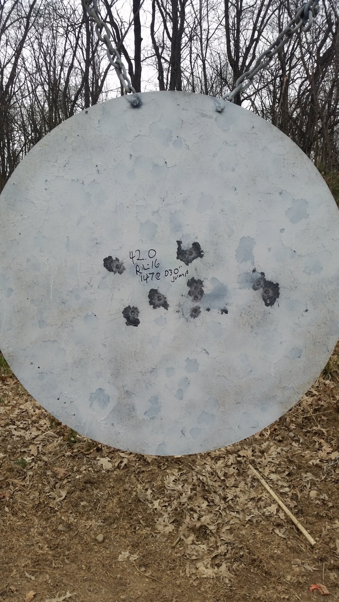

42 grains Reloder 16 in brand new Hornady brass with a pass through the Sinclair neck expander mandrel, 147 ELD @ .030" off the lands 2753 fps sd-1/es-1 for three shots over the magnetospeed from a Bartlein 25" 8t. 1k, 9 shots for verification, 6.5" vertical in the rain and 11-12mph wind from 10:30-11:00, gusting 15-16mph.
Pot of gold under a rainbow bridge, LOL.
