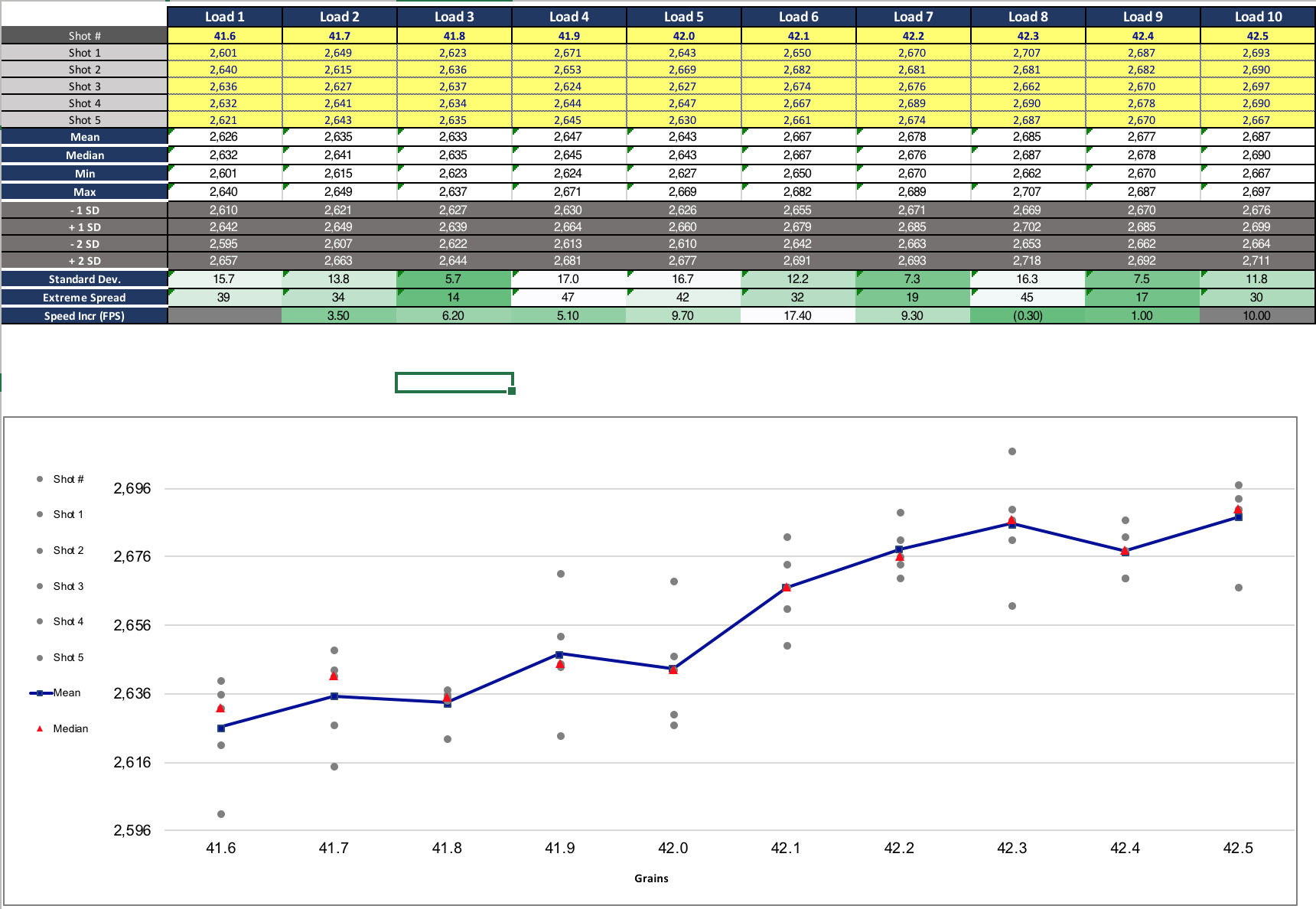

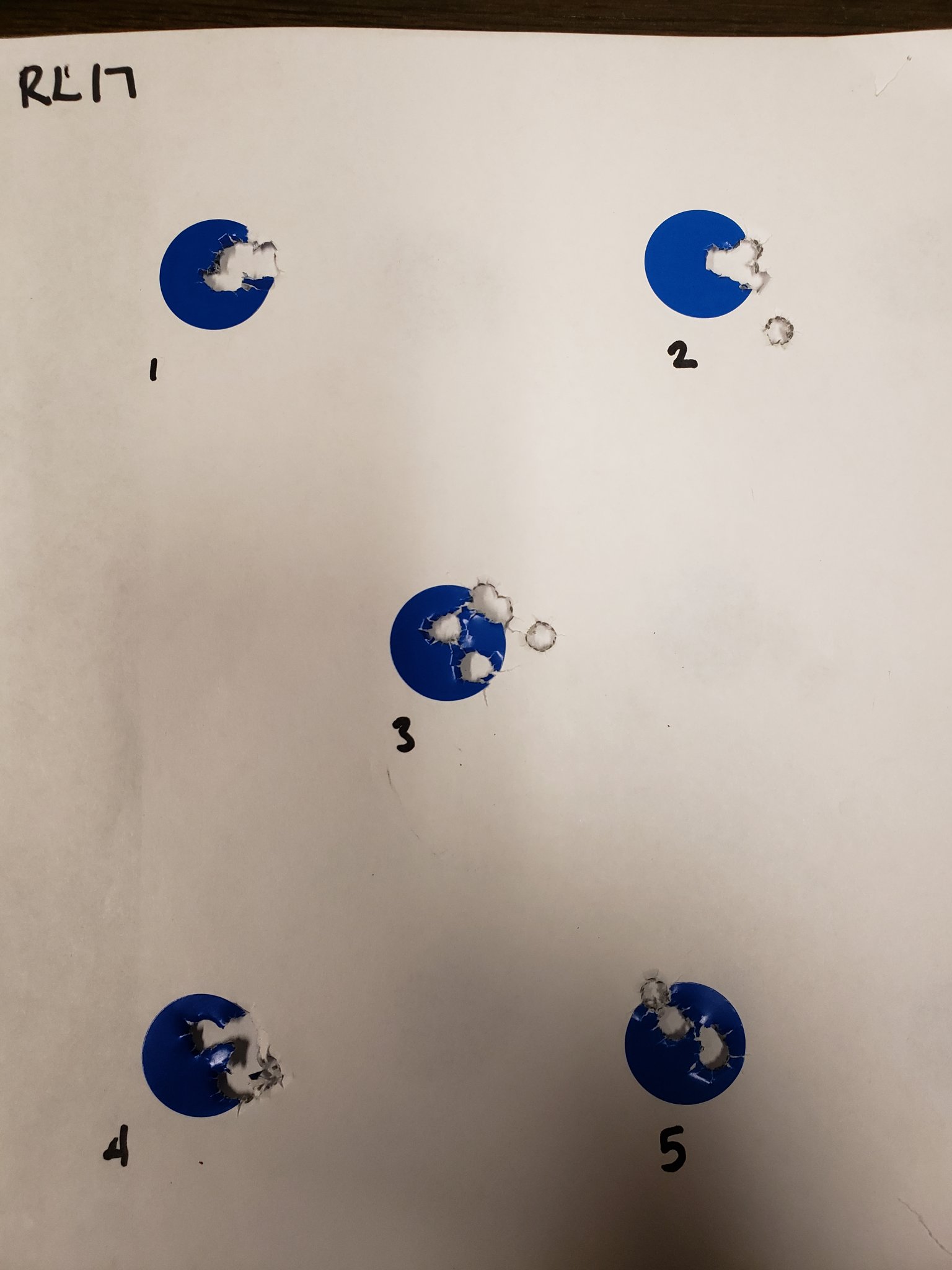

41.7-42.5
RL17
3 time shot Hornady brass shoulder bumped .001
CCI BR2
41.7 - 5 shot average of 2801, SD 11.5
41.9 - 5 shot average of 2807,
42.1 - 5 shot average of 2841, high SD, one outlier on speed at 2860
42.3 - 5 shot average of 2842, SD 7.9
42.5 - 5 shot average of 2863
41.7 was about a .3moa group, they opened up at 42.1 to about a 1 moa. 42.5 they started to close up again but I started getting hints of pressure

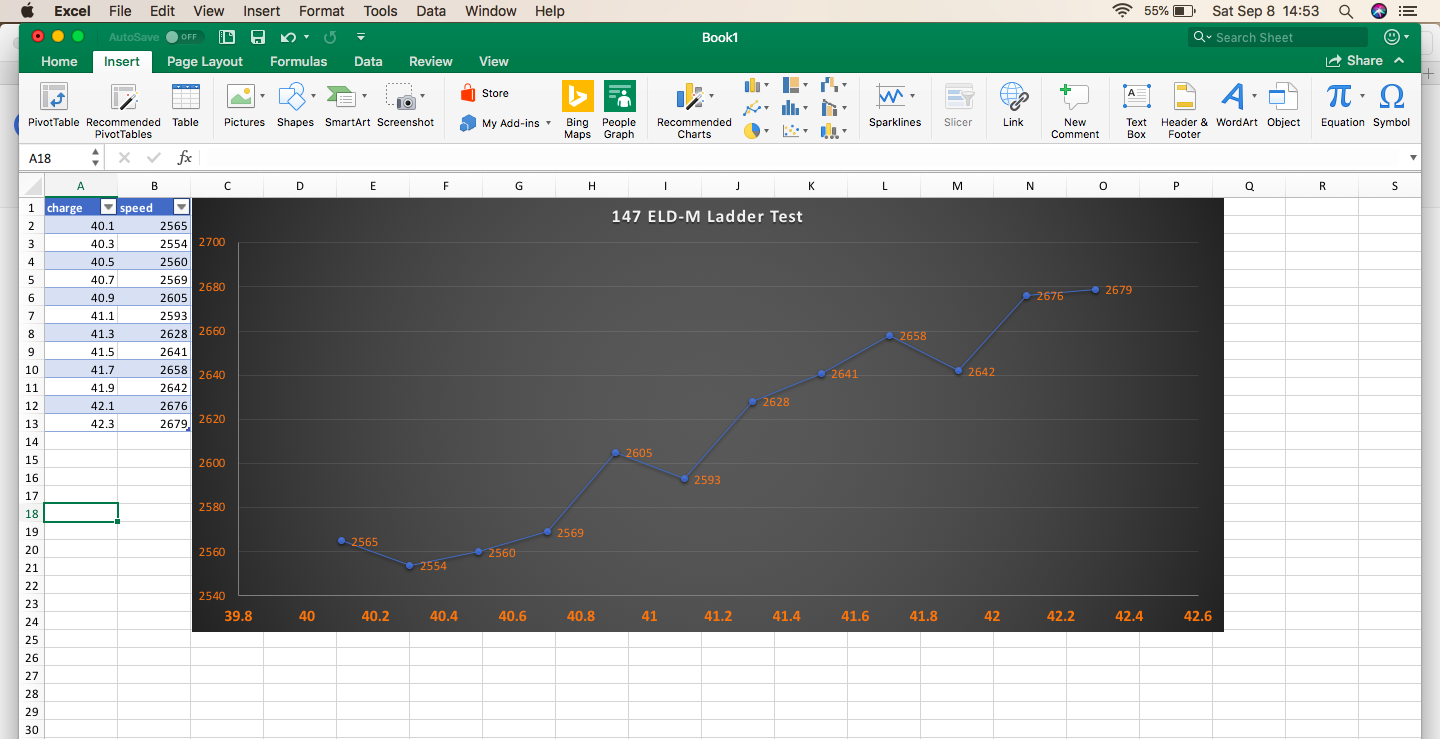

I got ahold of some 147 ELD-M projectiles for free. Loaded up a 12 round ladder at .2 gr increments from 40.9-42.3 with H4350. Interestd to see where the nodes are compared to the 140gr ELD-M with the same powder and rifle. Will post results later today!
So here it is. Looks like a low node between 40.1 and 40.7 and another high one between 42.1 and 42.3. I didn't see any pressure signs at the high end so I would like to shoot one at 42.5 to see if the node continues, but im going to load up five at 42.2 in the middle of the high node and see how it shoots.
That's fun. My 22" JP also had a node at 40.7 grains of H4350 in Hornady brass with the 147 grain ELD-M. I also had a node at 42.1 but the groups were not as tight as the lower one in my barrel.
I only tested group size at 100, no velocity numbers yet. First test was 5 shots in 0.3 grain increments so each of these were the tightest groups in a +/- 0.3 grain window without a significant shift in point of impact. Follow up test was 10 shots at a tenth over and a tenth under the load again looking for the tightest group without a shift in point of impact.

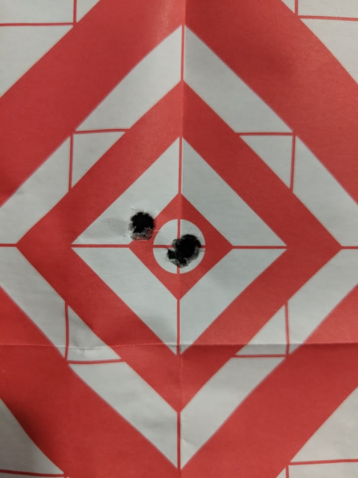

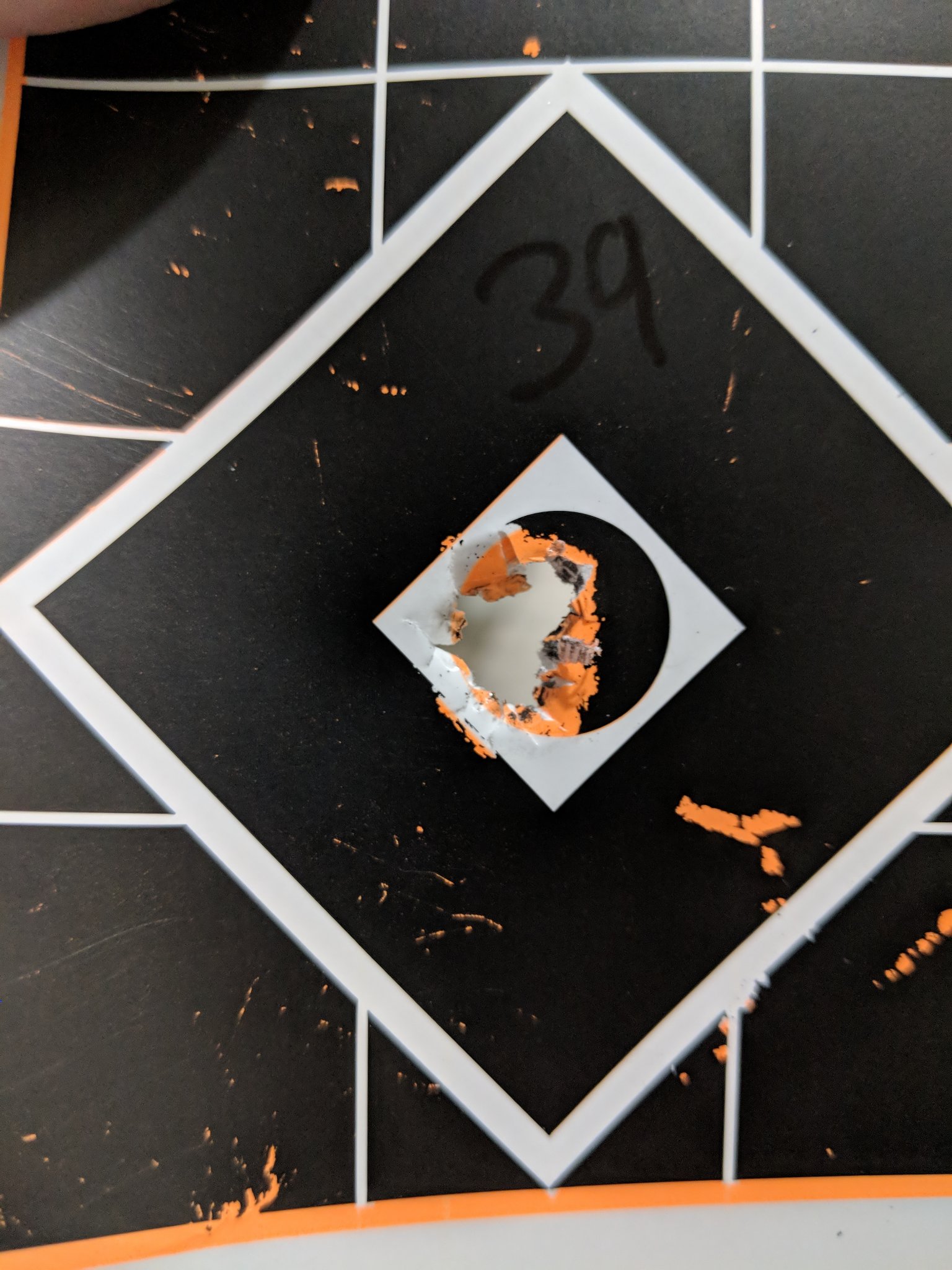

Loaded some 143gr and found a great node at 39gr for fire forming my new lapua brass. Only issue I had was it is very slow at 2450fps from my 24" Tikka T3X CTR. I tried up to 43gr without pressure signs but it was less than accurate. Once formed I will try to find a higher node otherwise will try H4350 or R16, just hard to not use what I already have.
great looking group. I would look for the higher node for sure, i load h4350 and im at 2950-3000fps with 43.2 gr, 22" 1:8 twist. I found that my groups opened up at the end of my ladder test because of hot the barrel was and not the load when I revisited. 6.5 deserves to be shooting faster than 2500
