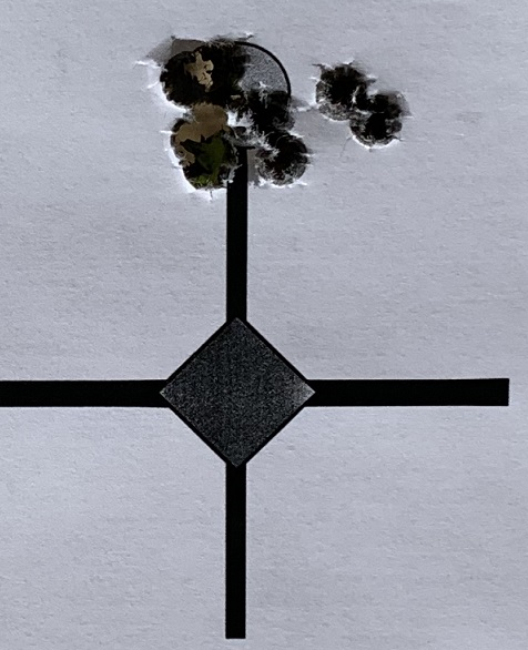

Im in need of some help. I have a rifle that i just put together. its a terminus zeus with a 24inch 1:8 twist 5r M24 bartlein barrel. I have it in a mdt acc chassis and a vortex razor on top. I have tried nosler 130 rdf, berger 140grain Long Range Target. federal 210m, lapua brass Im cleaning after every range trip. Before this rifle i had a bergara LRP and i made that thing shoot 1/4 moa on the regular. this gun i cant get it under .5moa. im tired of throwing components at it. Anybody have a good bullet load combo that you guys can recommend? I have a total of 500 rounds thru it. the barrel is from southern precision rifles ( bug holes).

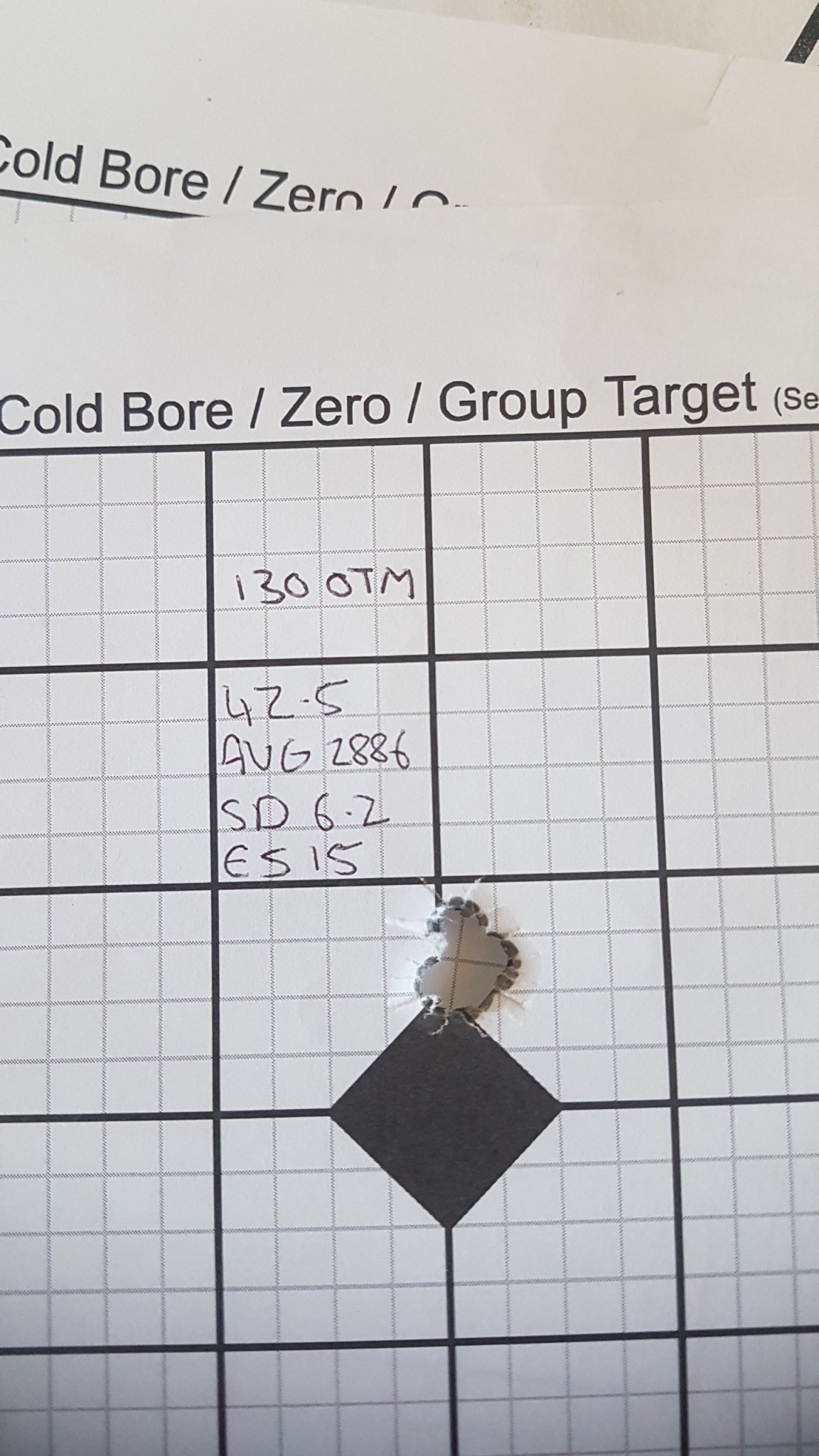

I have a very similar set up and man I would look at the Berger 130 OTM. You can run it a litter faster and it will do whatever you want. It will shoot too. That with 4350 and that bullet, it should shoot. There's tons of guys who shoot that bullet well though so

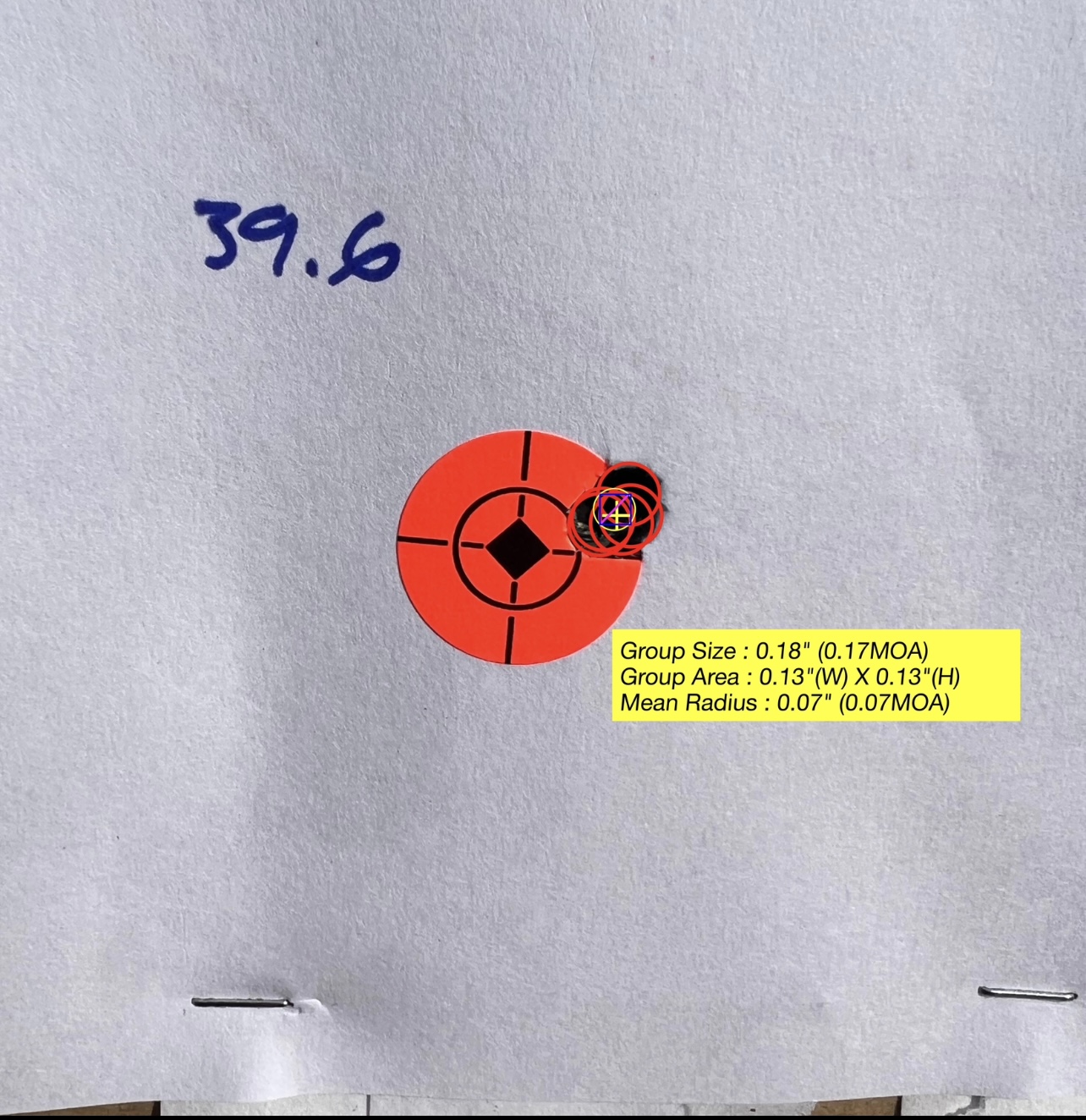

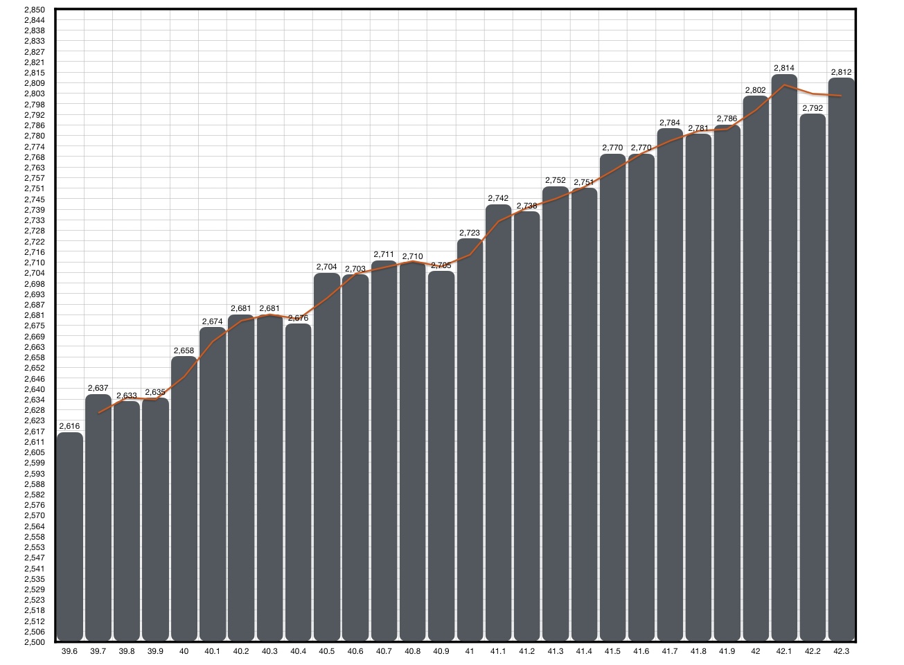

T3x Lite w/ original barrel cut to 19.25". New starline brass 1x resized w/ CCI primers & H4350. Measured w/ a magnetospeed sporter attached to a suppressor w/ sensitivity on Hi 2.
Went through a ladder with some 140s and 143s today just to get an idea of what velocity I'm getting. 32 degrees out. 70 in the house and I brought rounds out 3 at a time and shot them in different orders each time. Just trying to see if I get pressure signs anywhere. Loaded as long as they'd fit in my CTR magazine. I have all the measurements written down and how far off the lands they are in a different book. I loaded these a year ago and never got around to shooting them. Will post headstamp pics later and see if anyone has an opinion on pressure signs. Maybe a minor swipe at 43+ but I get that fairly often from this gun so hard to say.
One thing that's interesting is that the 143s are slightly faster than the 140s. Guessing that has to do w/ bullet shape and bearing surface? 147s are also faster but it was 15 degrees warmer when I shot those.

26” Bartlein MTU
Virgin Alpha OCD SRP brass
.002 neck tension
H4350
CCI450
CBTO 2.233 (.030 off my lands)
62F 56% humidity 30.23 inHg -7.1’ DA
Measured with Magnetospeed v3
Reactions: dmuffman80

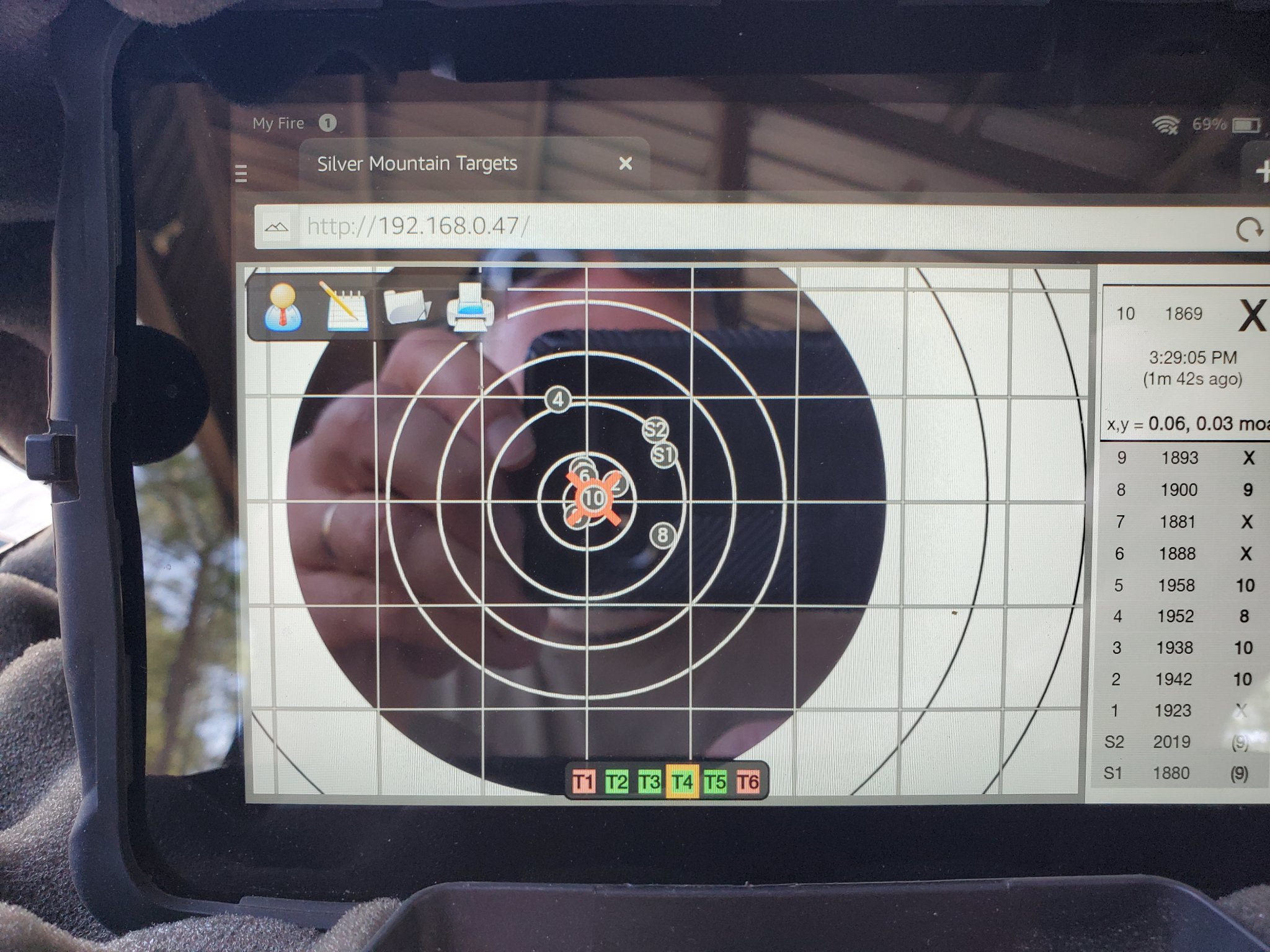

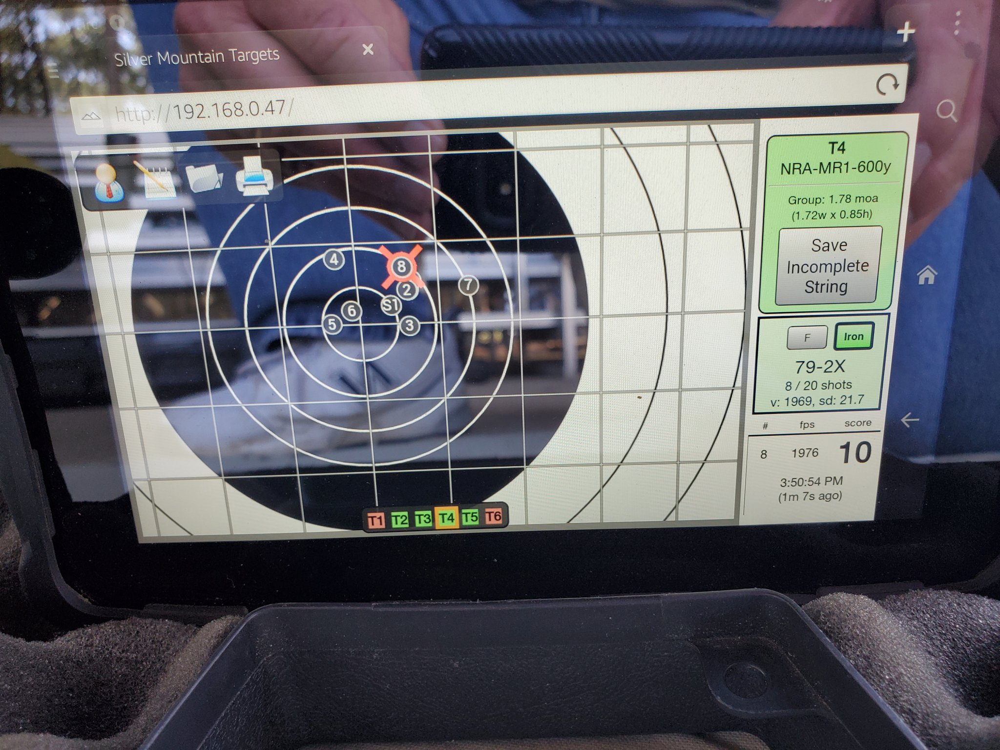

After reading a lot of posts here and other forums.... when it comes to reloading 6.5 Creedmoor, the most common powder agreed upon is 4350, about equal between Hodgdon and IMR brands...
That being said, I'm going to buy a pound and give it a try.... I like to get close to 2700 fps with a 140gr Hornady ELD-M. I'll ladder from 39.7gr to 40.4gr in .10gr steps.
Hodgdon load data says 40.0Cgr gets 2660 fps.
Chrono: Labradar
Ballistics: Kestrel 5700 Elite
Gun: Bergara HMR Pro 6.5 Creedmoor, 24" 1:8 twist,
Optics: Vortex PST Gen 2 5-25 ffp, zero 200yrd .75 tmoa
Cartridge: Lapua brass, Federal 210 primer, trim 1.917, oal 2.792
I'll post back on how the 4350 performs in this rifle..
