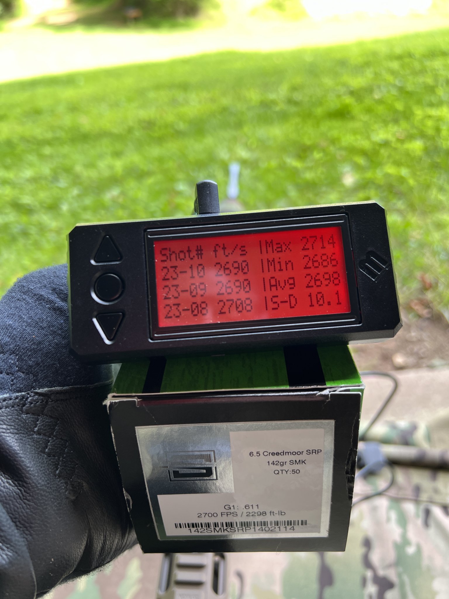

Same rifle as the post above… One of my new favorites that I wish I could get more of:
After trying to figure out what bullet this is it is a 140SMK… The G7 BC was derived from ammunition testing by eagle eye.
It’s another one of those ammunitions that shoot a 1/2 ragged hole (10rnds) at 100 yards.

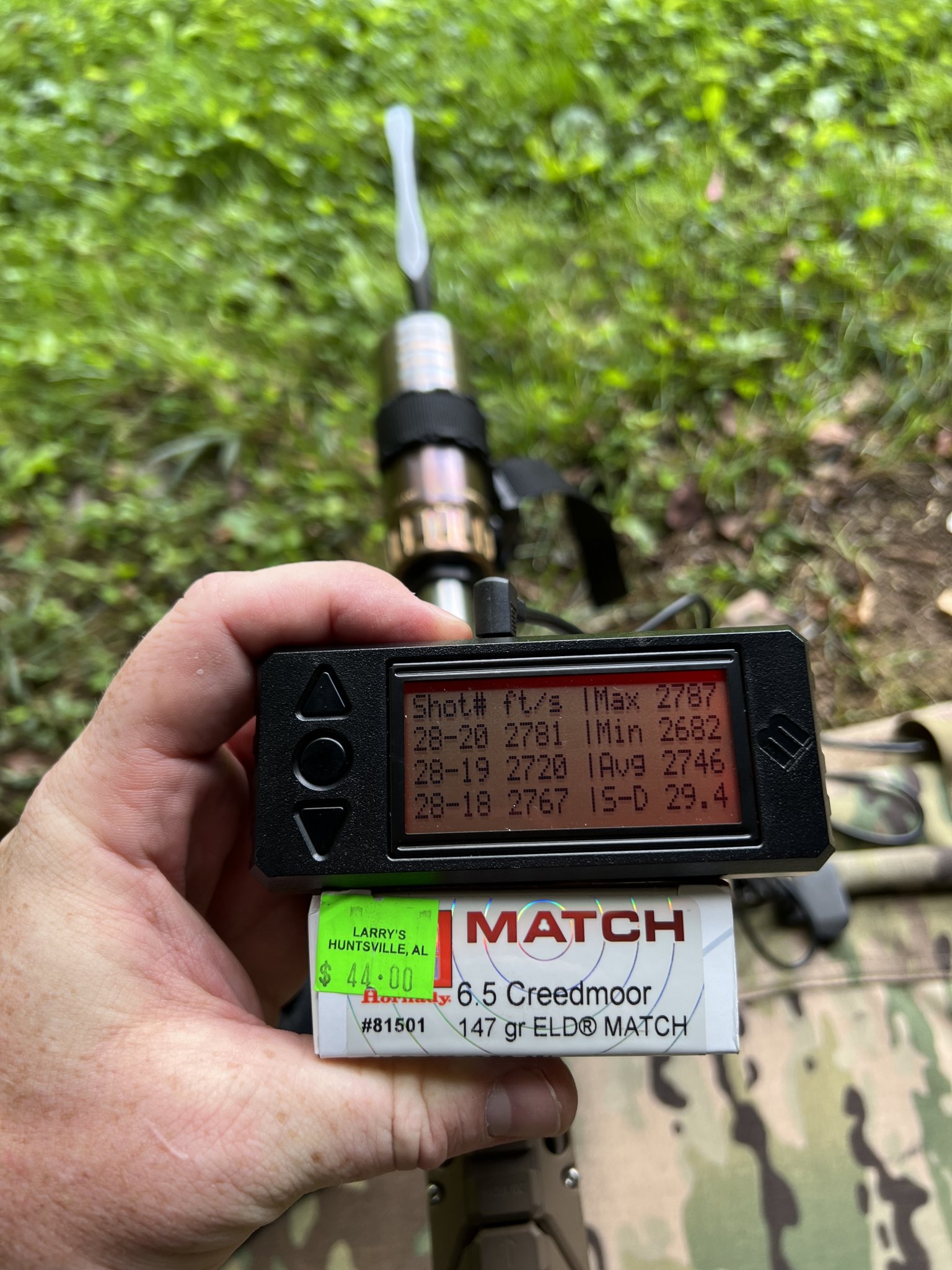

In general the Hornady has been unimpressive when it comes to SDs. The TAP 147gr ELDM is better then the rest.
Given that I loaded 147s with an under 10 SD means that it’s a Hornady issue.
TAP 147gr 65CM:

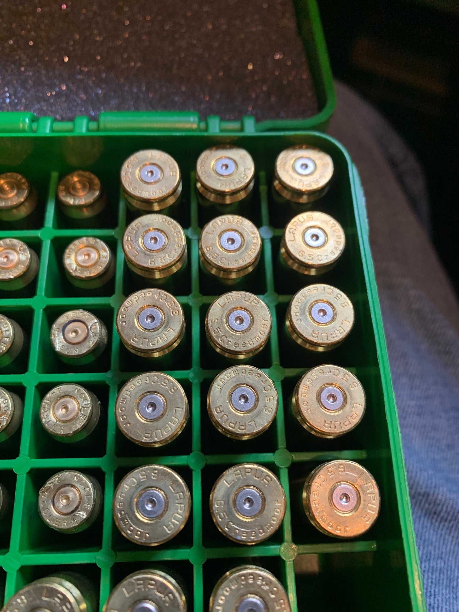

Does Norma make all the Prime 6.5 CM brass? I purchased some Prime 6.5 brass about a year ago. I thought it might be made by Peterson.
This is the original Prime brass from when RWS was contracted to make the ammo. However, they dicked Prime over in a move to take over the brand, and then they sold off all of the components….

Hornady factory match ammo is close to the max load. When they can get it they use H4350. I've measured dozens of their factory rounds and they average 2.814 COAL with 140 ELD-M's. So, length translates to the jump to the lands. Change that around for accuracy. Of course, if you can do a ladder test of powder weights you can find a flat spot to assist with velocity consistency.

The only thing with some of the hornady factory ammo I have is that some of it has very large SDs.
i’ve been very surprised by how bad the ES and SD has been, in fact.

See, I've had the opposite experience. All I've shot in 6.5 CM was their match 140 & 147 ELD-M, and everytime the SD's were single digits. But, my gun, being a gas gun, hates them. I shoot my reloads at a 2.800 COAL much better. Of course, my SD's are in the high teens, lol.

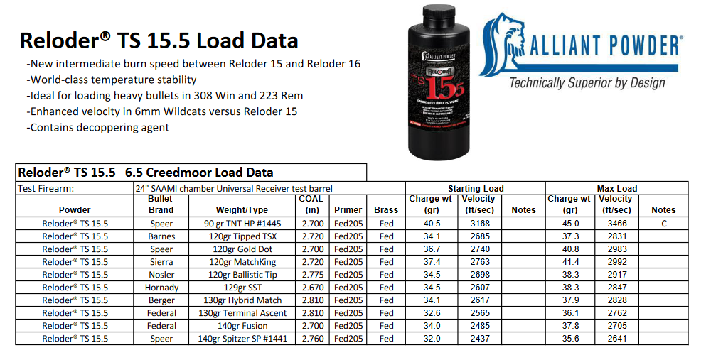

Yuge Disclaimer: The below loads are way over published loads. The following is not a recommendation! Start below published and work up for your rifle.
I haven't been able to find much good data for Reloader TS 15.5 in 6.5 Creedmoor.
Published loads from Alliant show top end of 37.9 for Berger 130 Hybrid's???
This is a bulky powder with a burn rate between RL15 & RL16 so something seemed a little off with their load data??
My thoughts are that with 120-130 class bullets it should be a sweet spot for this powder.
After doing some modeling in Gordon's it looked worth a try.
The disparity between Alliant's load data & the Gordon's model are huge. One of them is FUBAR!
I'll get this out of the way now. Gordon's or any other internal ballistics software is not to be taken as gospel. Sometimes it's pretty damn close & others not even close. For example with Lever Evolution it's out to lunch on speeds & pressure for 6ARC & 224 Valk.
One of the first things I look at in Gordon's that's very useful is case fill. It has been very accurate with that as it should be. It's also a good first check. If case fill prediction doesn't jive with what your seeing I'd stop right there & not trust anything predicted beyond that.
For this TS 15.5 at Alliant's max load for the Berger 130 hyb (37.9gr) modeled in Gordon's predicted an 86% case fill. Tells me the powder might not be a great candidate, since I like to be 90%+ and ideally (personal preference) 92% +.
But wait, before ruling it out I look at pressure & here is where there seems to be a huge disconnect in data. Max Alliant load in Gordon's is showing an anemic 47,354psi with MV of 2712. This is way off the data posted above, over 100fps.
Alright my original theory seems to hold water based on Gordon's so down the rabbit hole I go.
Another check I like to do when entering unknown territory is this. I simply write down all the Gordon's predicted MV's for the charges I'll be trying and then compare to actual data for the first shots. Who's data is closer to correct? Gordon's or Alliant's.
Spoiler it was Gordon's, in this instance their model for TS 15.5 seems to be pretty close.

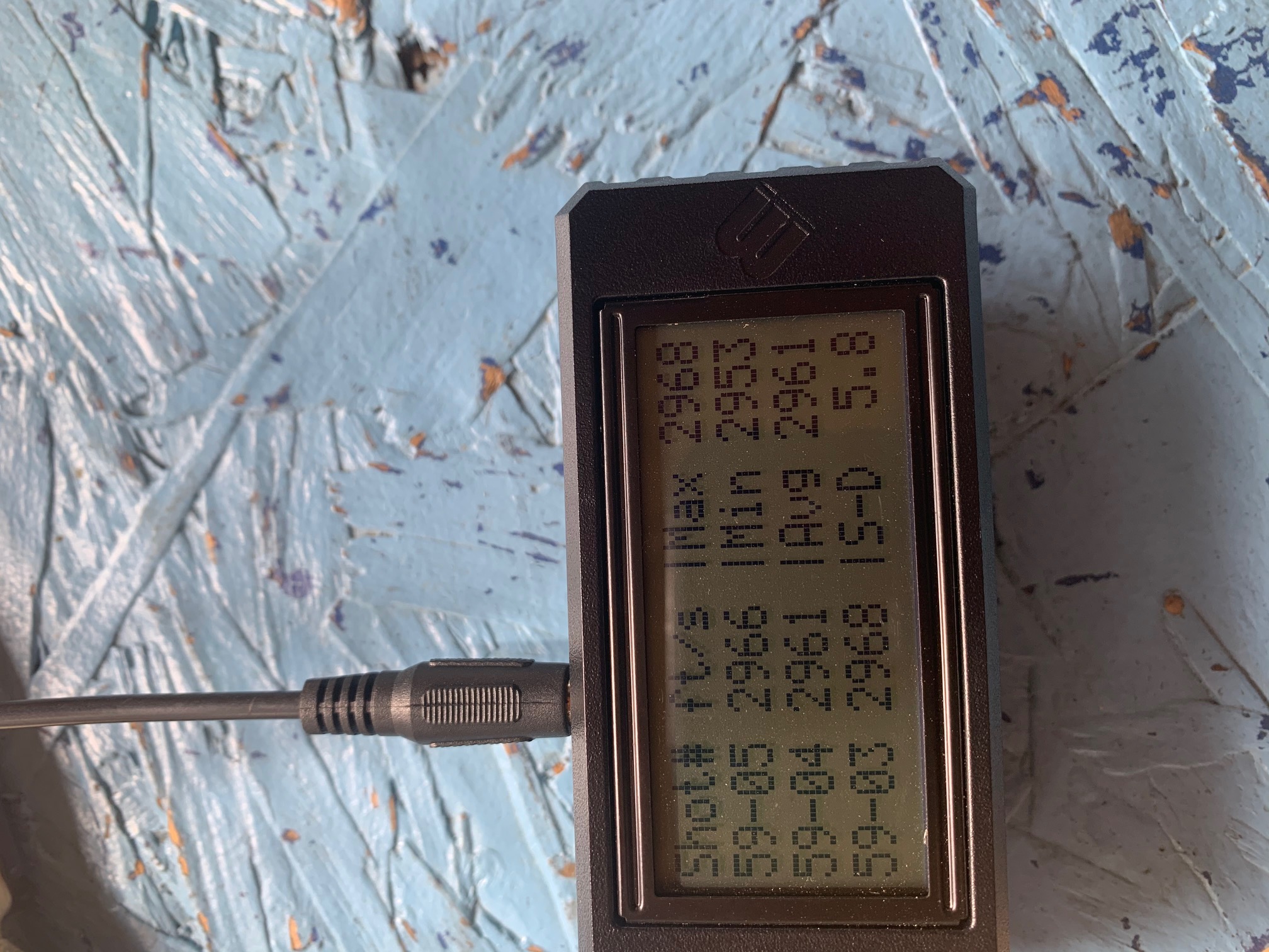

Before this gets to be a damn novel here are the results I landed on. Again, this is my rifle worked up, don't start here. My accuracy and speed node starts 2.9gr above Alliant's max load.

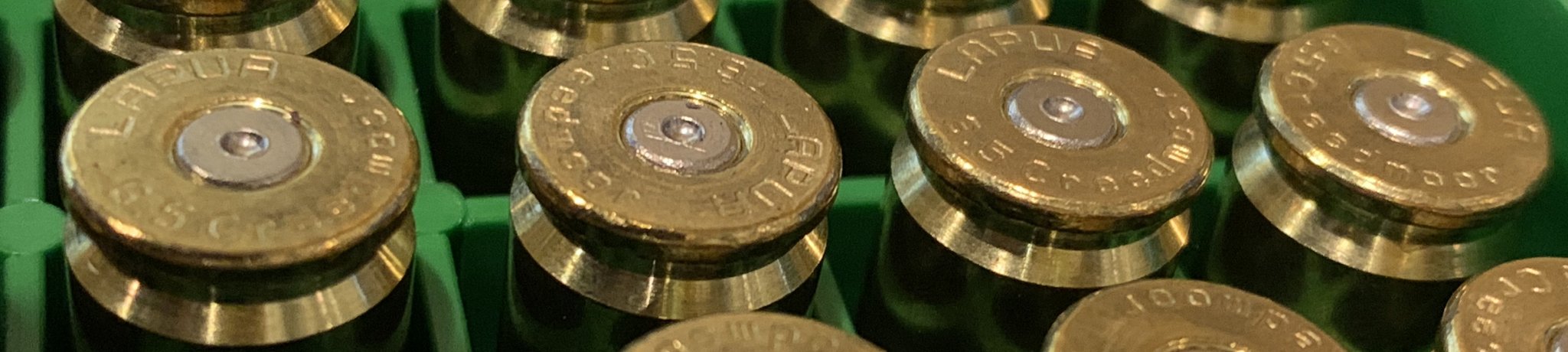

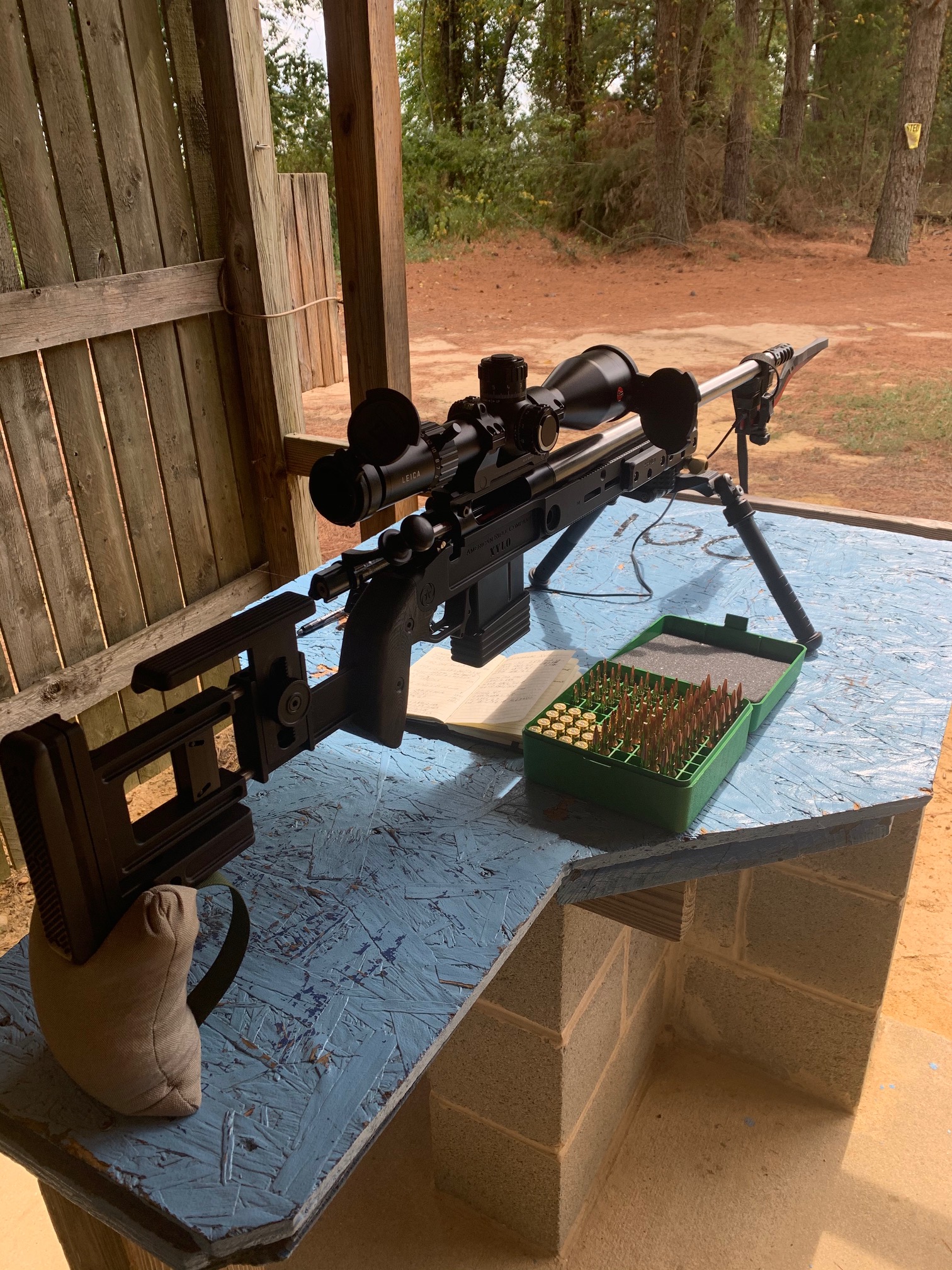

Gun Is ARC Nuke with PVA 24" Rock Creek + Precision Armament 4 port MB. Shot from bench with Magnetospeed V3, Atlas Cal, & Mark Taylor Rear bag. about 750 rounds on barrel. Also worth noting it is a fast barrel.
Lapua virgin SRP brass with unknown primer. I bought the brass already primed? It's Silver & not BR4 so could be CCi450, FGMM 205M, or???
Brass prep was to run it through Redding type S with .289 bushing followed by 21st Century .2625 mandrel with dry Graphite lube. No shoulder bump. The Lapua was spot on for shoulder location.
Berger 130 OTM hybrid all testing seated to 2.816/2.196 = .055 jump in my chamber.

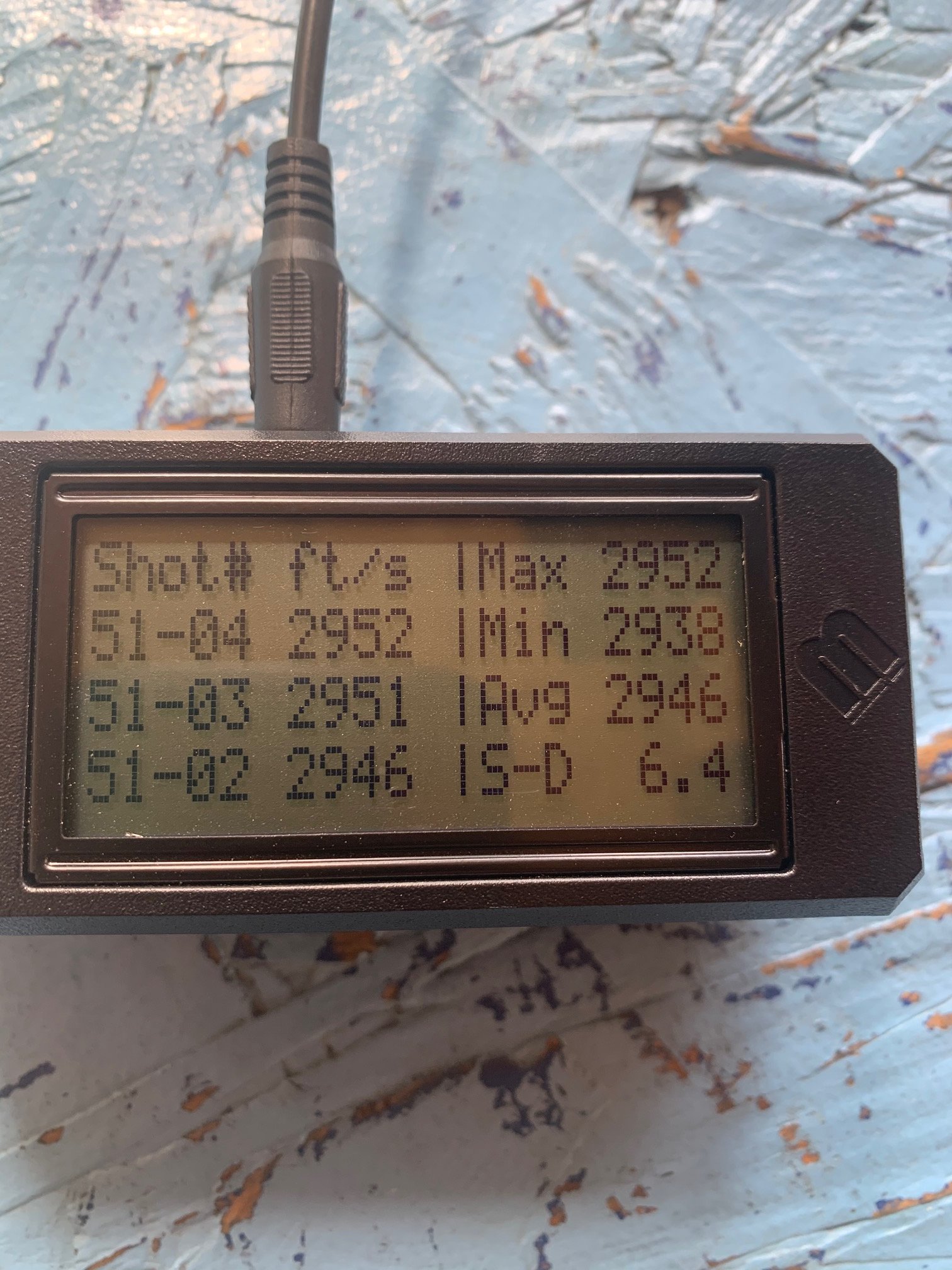

Reloader TS 15.5
40.8 x 5 = 2910 sd 6.3 Gordon's prediction 2882
41.2 x 5 = 2936 sd 7.3 Gordon's prediction 2905
41.4 x 5 = 2961 sd 5.8 Gordon's prediction 2929 predicted pressure for my top load was 62,375psi or just under max allowable (63,091).
Case fill is 94.4% for the 41.4 load. I like it. This is showing 100% powder burn and burn out happening at 10" so this powder appears to be an excellent choice for short barrels.
Also worth noting the incremental MV jumps per charge weight predicted vs real life are pretty close. To me this is another indicator that Gordon's powder model of the TS 15.5 is pretty damn good.
Target for the Berger's below was shot left to right. 5 shots each @ 100Y. Before someone asks, yes I adjusted the scope for the 41.4 load far right.
Turn your eye's away from the chewed the fuck up 224 valk brass. Let's just say TS 15.5 isn't a good option for the Valk.
Ran some RL 26 with the 147 ELD's
ARC Nuke with 24" PVA 6.5 Creedmoor
This combo is like Vudoo
Virgin Lapua SRP with unknown primer? Brass prep same as post #2810 above.
147 eld seated @2.807/2.175 (Hornady comparator) = .053 jump. I started with this jump based on the excellent Cal Zant/Mark Gordon bullet jump article. If you haven't already seen it, it's well worth a read.

46.9 = 2904 sd 5.4 .430" group. This shot the best & basically matches the box numbers for factory Hornady 147 6.5 PRC ammo. Slightly compressed no bullet marks with SAC seating die.
47.2 = 2928 sd 8.0 .730" group x .610" vertical*. Compressed with light bullet marks.
47.5 = 2946 sd 6.4 .661" x .170" vertical. More speed than I need. No pressure. Compressed load, bullet marks from seater.

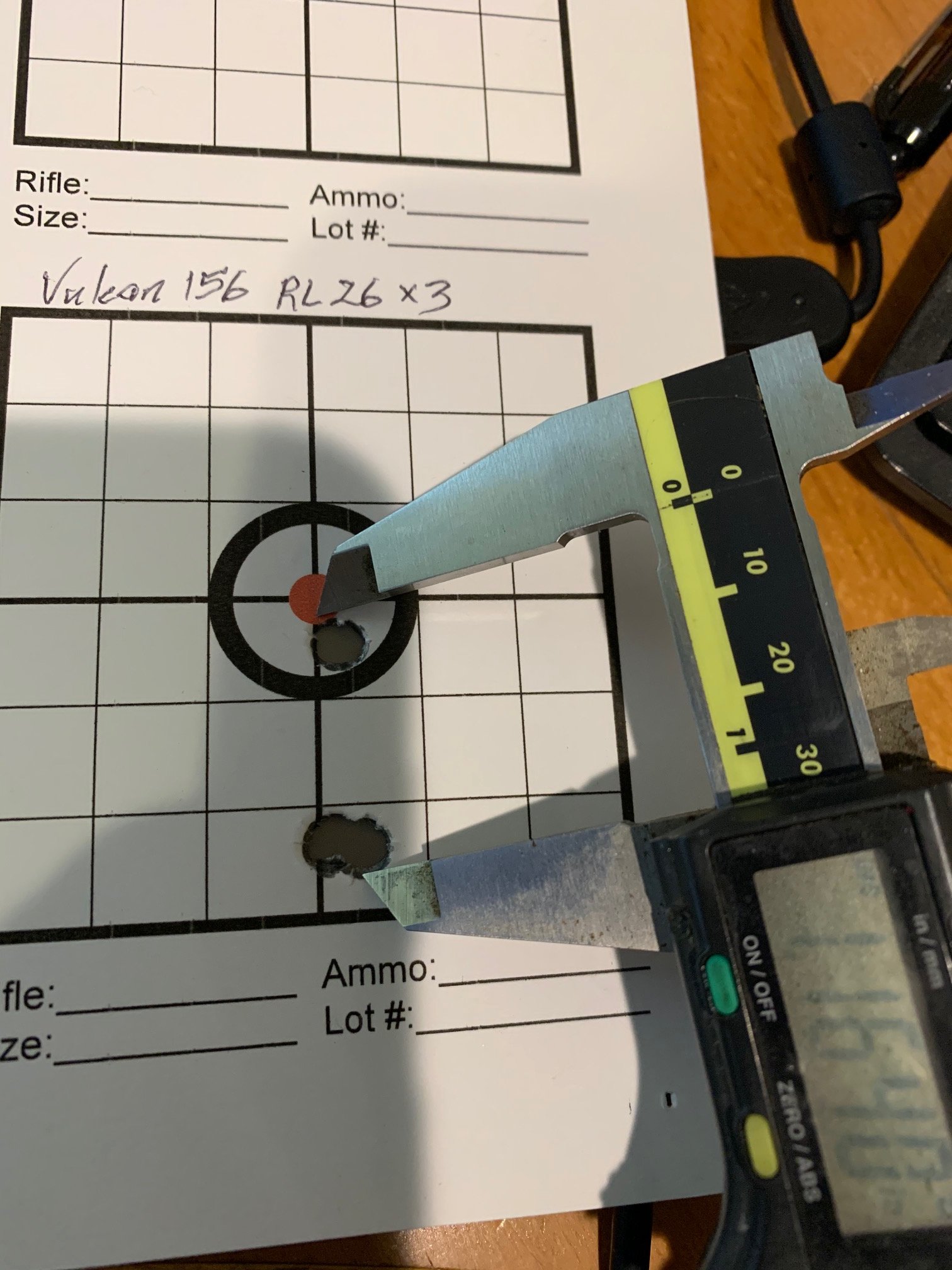

Norma 156 Vulcan seated 2.702 oal/2.258 with Hornady comparator = .020 jump
Lapua SRP virgin
RL 26
45.8 = 2810 sd 8.0 & .9" group @100y showed some promise 2x touching and 1 up.
No pressure signs.
Might shoot a few more with .028 jump, but it's already good enough for any Deer shot I'd be taking. 350y max in WV.

@357Max thanks for 15.5 load data Iv been curious about it looks like it delivers velocity and accuracy. Rl26 is awesome in the 6.5 creed

I have been having amazing luck with freshly loaded Lapua, and Peterson brass. Here are some .1 and .05 groups shot, so literally the same hole. I have a bunch of those groups, granted they are all three shot groups. The Tikka Tac A1 is still getting zeroed so the precision is still off, but it's a very accurate gun right now with this load. My question is when I take the same load but use Hornady brass that has been shot, resized, annealed.. so prepped, I am getting groups around 1/2 inch, thus the Hornady brass does not seem to perform like fresh Lapua or Peterson. What is the consensus for Hornady 6.5 brass? It's either that, or my brass prepping is off. Not sure what the deal is. I do have a buddy who know's a lot about this stuff, he suspects the Hornady brass.
Thoughts?
Thoughts?
View attachment 7962539View attachment 7962540
I've just started working with better brass in my reloading education, so take it for what it's worth. But I would try increasing powder charge a little in the Hornady brass. Lapua and Peterson are thicker, have less case capacity and therefore are shooting faster with the same load. I'll be interested to see if others think the same. The premium brass is also going to be more consistent, so you have to overcome that too.
Thoughts?
Lapua and Peterson more consistent. match grade.
Hornady, not consistent.
Thoughts?
What is your COAL?
