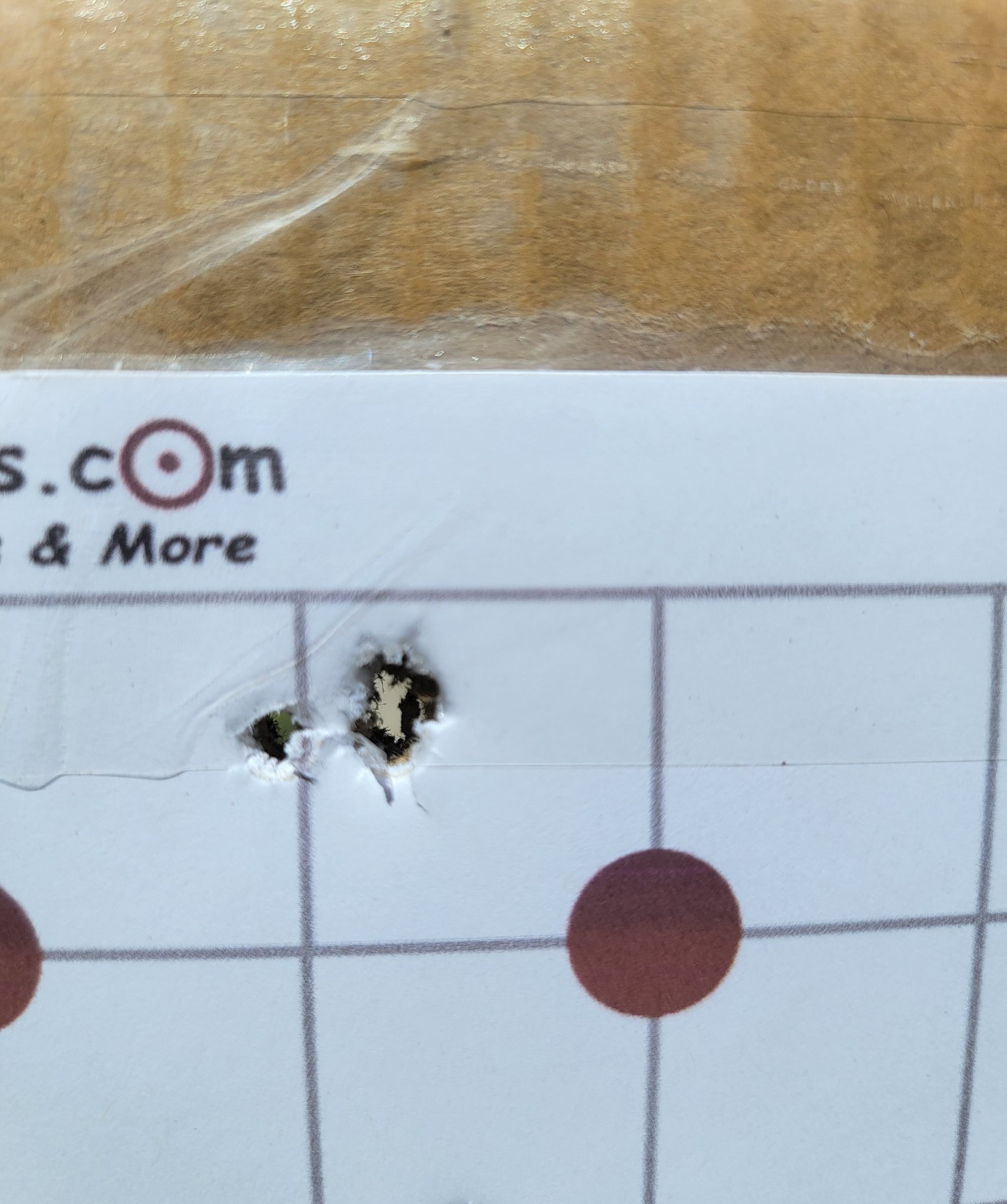

With factory ammo groups like this. Why would one even reload? PS I'm still planning to reload, just testing bullets. I'm a sh*t shoot too, (2) 3 shot strings and 100yrds

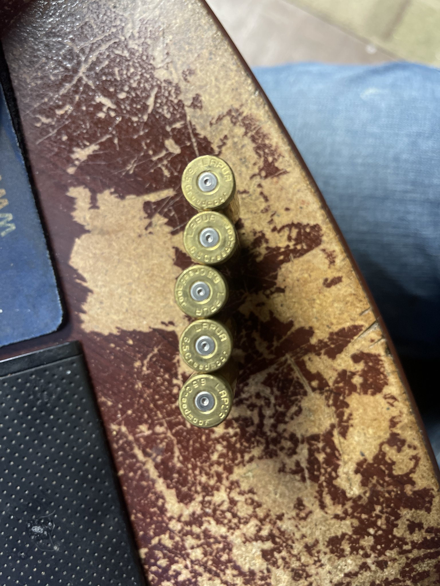

Yep, LRP primers have been hard to find.
One viable work-around is to switch to SRP brass like Lapua, Peterson, both top-notch quality, or Starline (an econo brand), and then prime with CCI450’s, which is their small rifle magnum primer. They seem to be in stock most of the time.
Just fair warning that some bolts/firing pin holes have too much gap, and are not SRP friendly and you may see pierced primers. Then you need to get your bolt bushed. I had no issues using SRP brass so far, and never needed to get a bolt bushed, but maybe i was just lucky. Lapua SRP brass lasts 20-25 reloads, making them cheaper per shot.
Maybe try to get one or two boxes of Berger factory match ammo, which uses Lapua SRP brass.

I did need a new bolt and firing pin as either they've upgraded it or I had some erosion, but Lapua SRP is working well now with CCI 450's. Question: Do you know what the difference would be between the CCI 450 and CCI BR4 ?? I'll be testing it out but curious if anyone else has tested the difference.

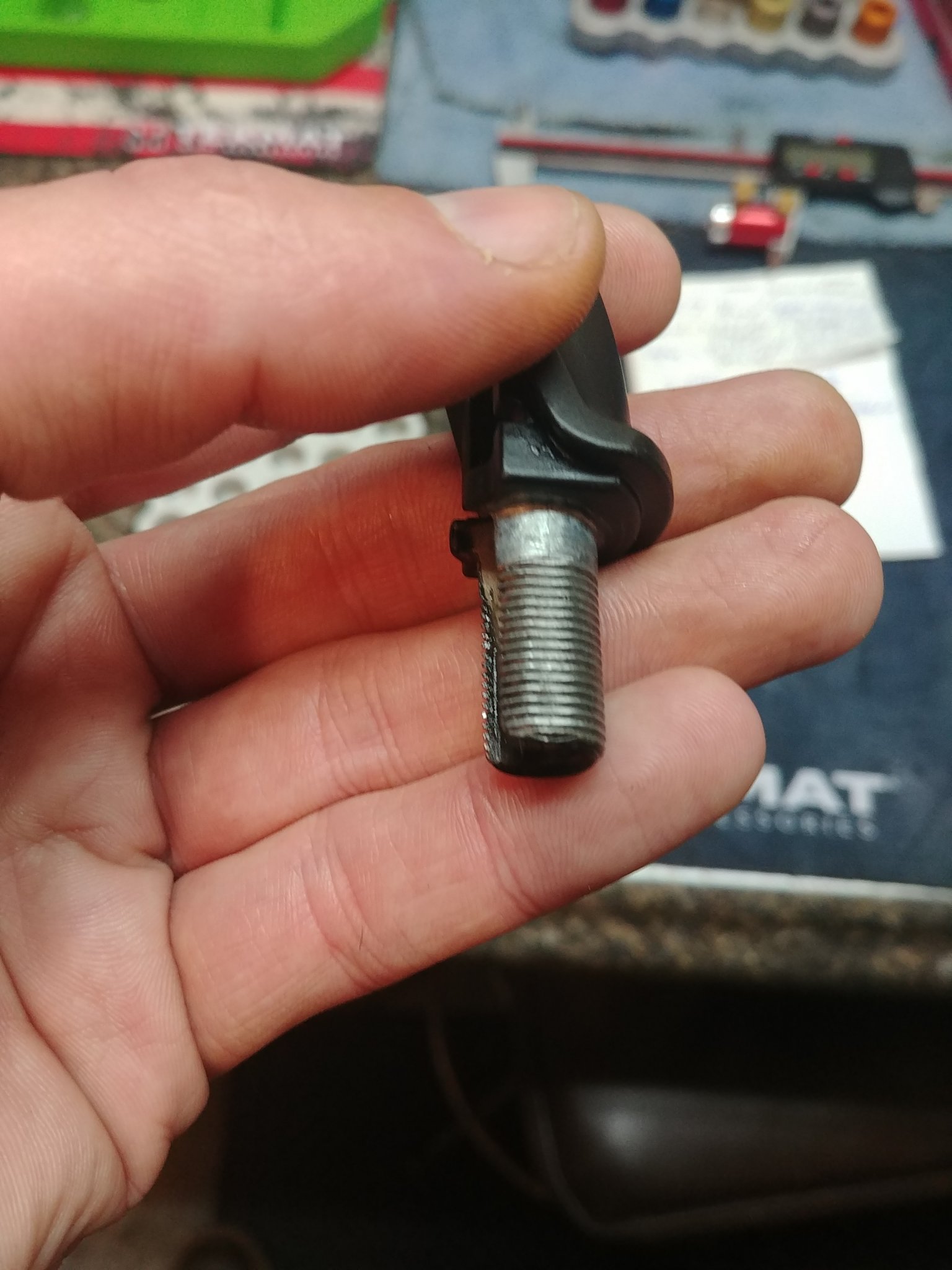

So I'm attempting to disassemble my Bergara B14 HMR bolt to remove the extra grease in the assembly. I noticed these flat spots on the bolt shroud. They are 180 degrees apart at 3 and 9 o'clock. Does this seems normal? Also, does anyone know if there is a "proper" way to remove the firing in from the cocked chamber indicator? It seems the firing pin just threads in, but it seems like there is quite a bit of resistance and I rather not snap it off. Thanks for any insight
Just wanted to update... BPI sent me out a the new MIM shroud. I was looking at trying the Crossroads Precision SS shroud, but I'm running with the updated factory for now. Thanks BPI, much appreciated!

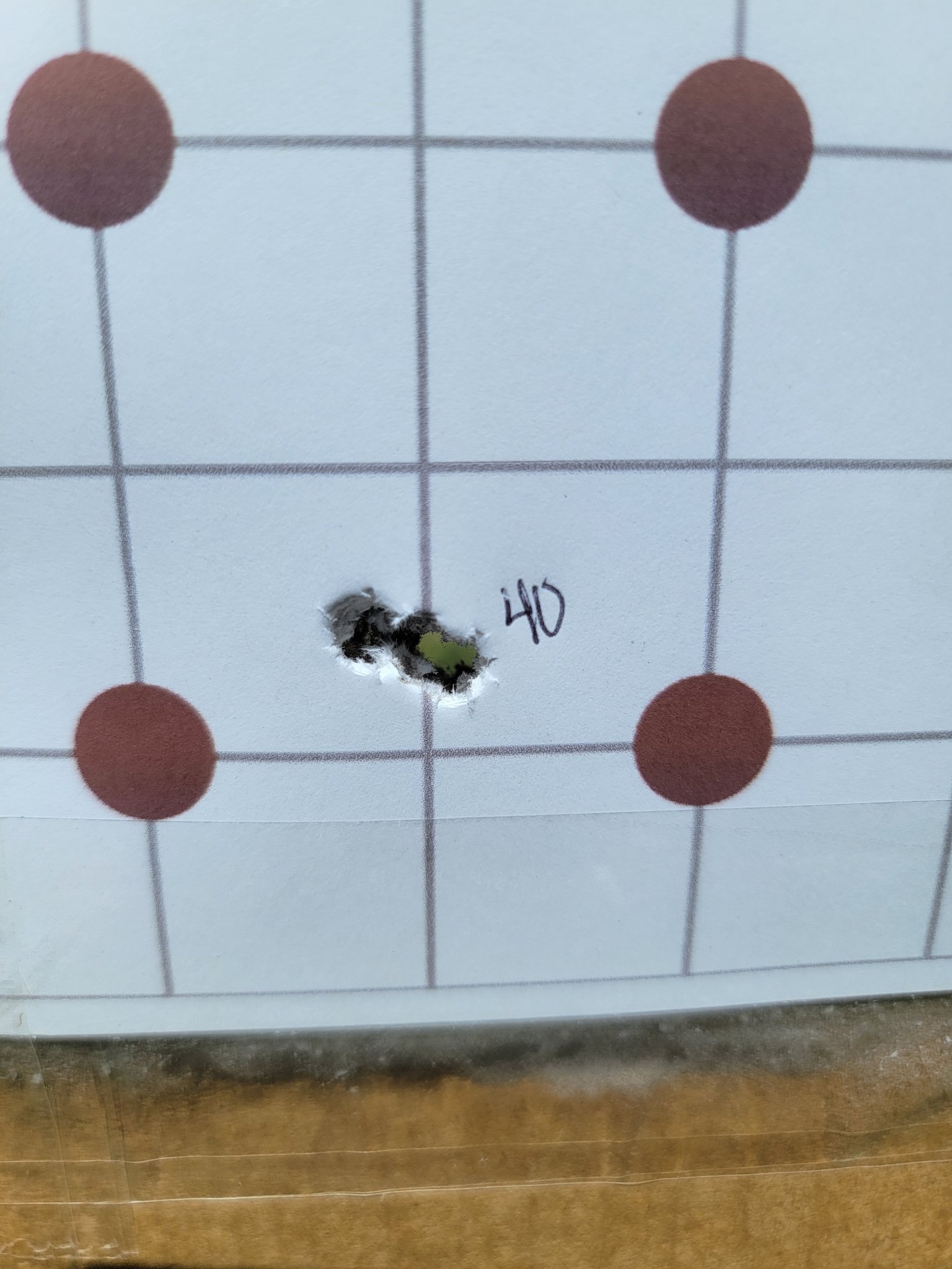

So this was interesting... cold bore + 2 groups.
22" supressed Proof carbon prefit, 1/8
Lapua SRP Brass, cci 450
43gr of Varget
85gr Hammer Hunter
2.640" COAL
3290FPS
have you had any issues with the 147 ELD-M blowing up? Sounded like they shot good for you?
No. No issues. I duplicated the load 4 times and shoots 1 hole every time. I will have to load up those 140gn ELDM with RL16 and see if I have any better luck.

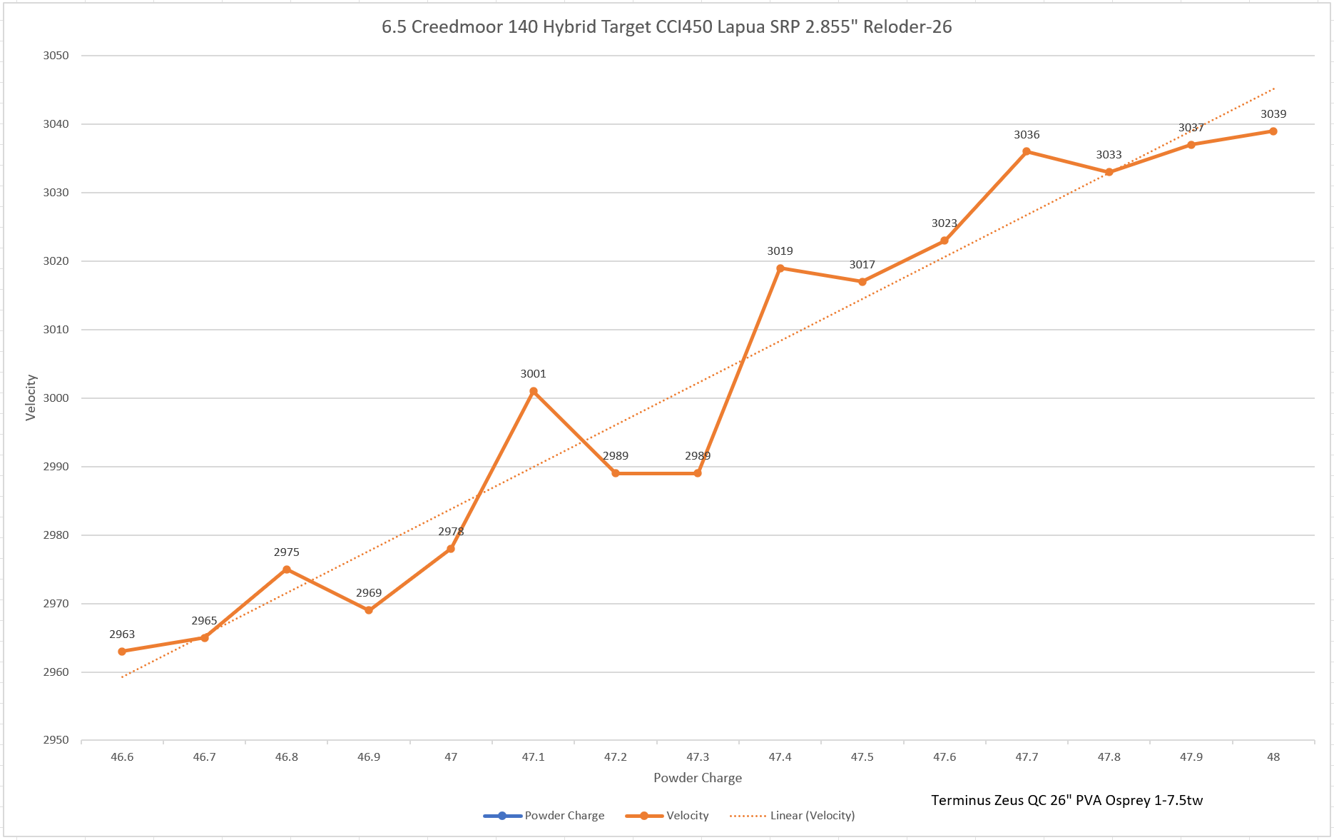

Scored some 140 Hybrids locally and decided to try the Satterlee method but I'm having trouble figuring out where I should investigate further. They are about .090 off the lands at 2.855, about as long as I can go with the Pmags though. Velocity is all taken from a labradar and using a griffin paladin suppressor. No pressure signs whatsoever not even a stiff bolt lift or ejector mark.
Scored some 140 Hybrids locally and decided to try the Satterlee method but I'm having trouble figuring out where I should investigate further. They are about .090 off the lands at 2.855, about as long as I can go with the Pmags though. Velocity is all taken from a labradar and using a griffin paladin suppressor. No pressure signs whatsoever not even a stiff bolt lift or ejector mark.View attachment 8016526
You’re gonna die
That is some smoking velocity.
Slow that thing down.
I've been this fast with 2 different rifles, both 26" chambered by PVA, one a Rock Creek 1/8, and this osprey 1/7.5. Nucleus gen 1 and a zeus qc. Had 800 rounds on the nuke when I sold it, nearing 500 so far on this zeus.
Reactions: Hkmiller
Well....you are shooting a 6.5 creedmoor not a 6.5 PRC. Try slowing down between the 2700-2800 mark. You want good consistent case fill , if you are crunching powder which most likely im guessing you are, then you are going to get erratic crazy numbers.
