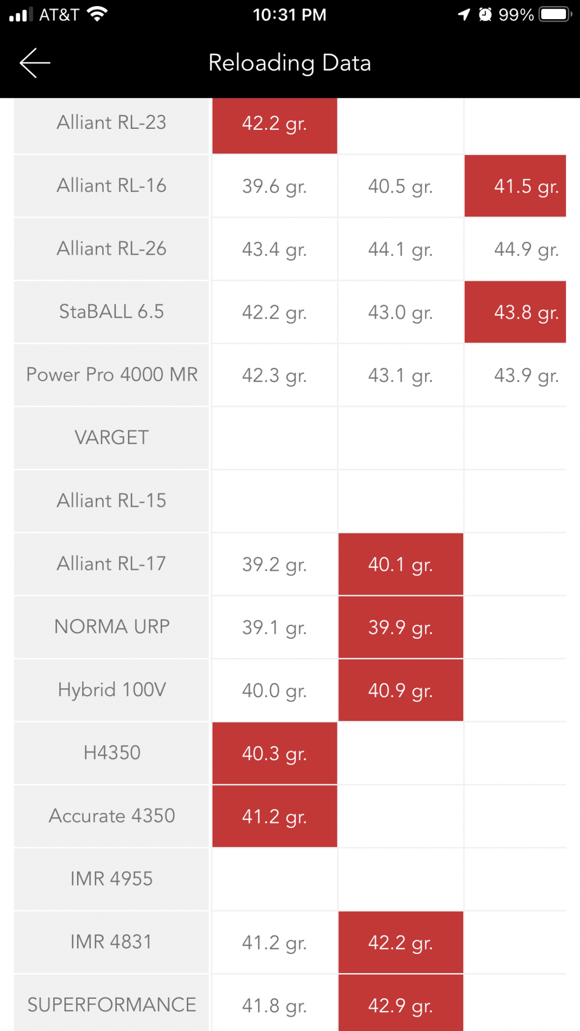

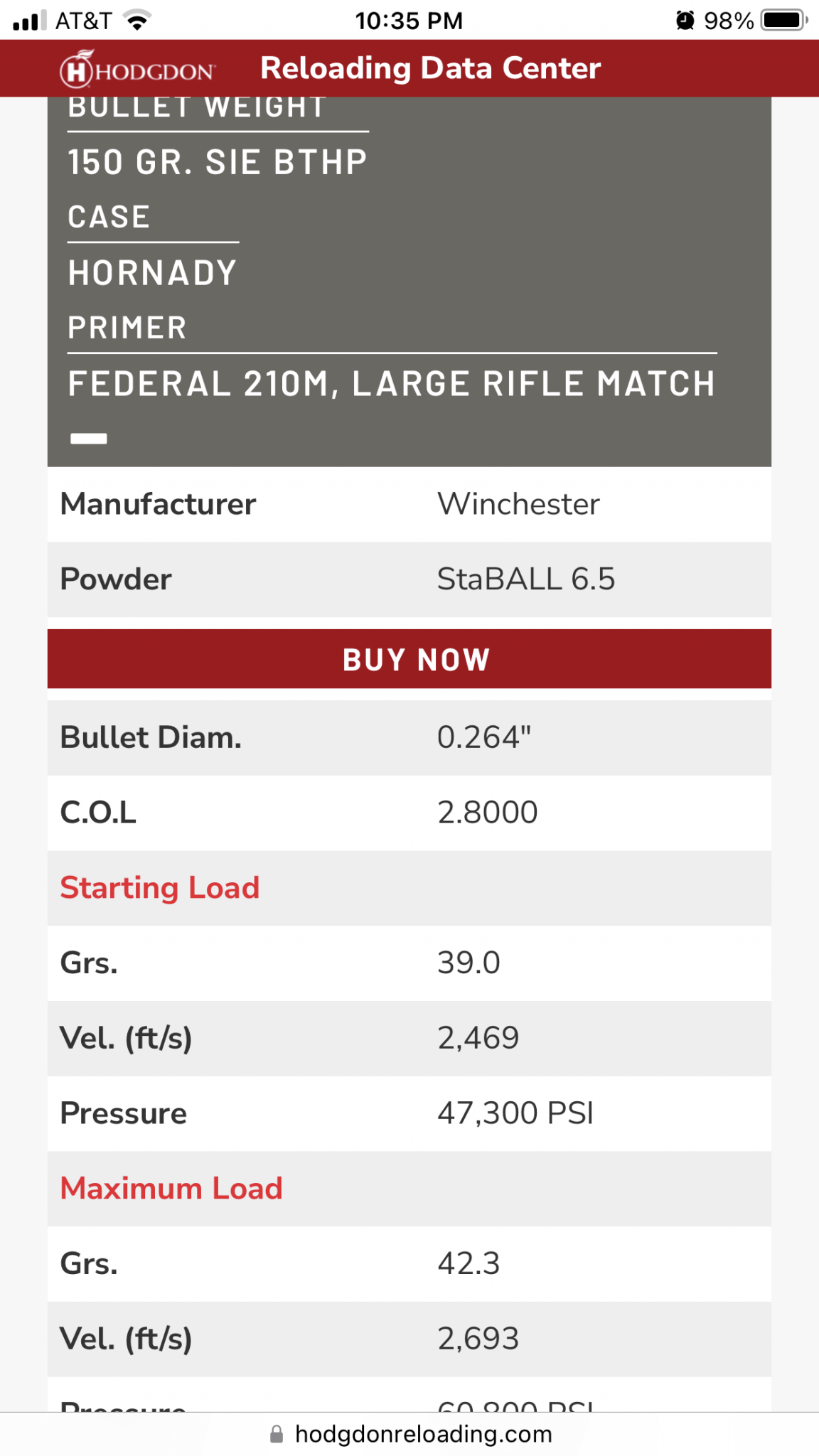

Question for the masses. I have a bunch of 150 SMKs and some Staball 6.5… I see that the Staball is a slower powder than h4350 so thought it may be a decent combo for my 26” 7.5tw barrel.. anyone have any recipes for this set up? Thanks!
The Hornady loading manual (11th Edition) lists the following StaBall 6.5 loads for 147 ELD-M through 153 A-Tip Match bullets:
2700 ft/sec 43.8 gr
2650 ft/sec 43.0 gr
2600 ft/sec 42.2 gr
2550 ft/sec 41.4 gr
2500 ft/sec 40.5 gr
Reactions: category_theory

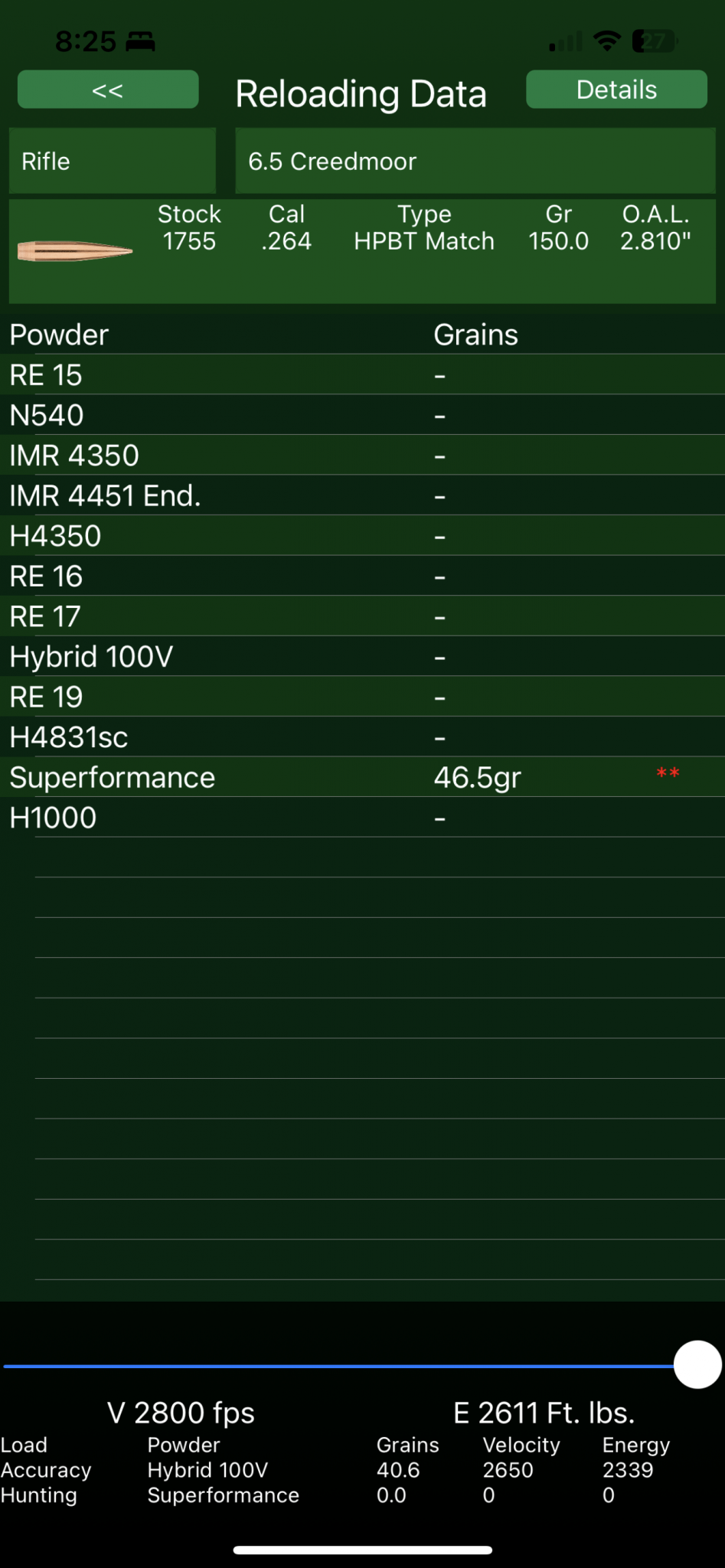

Oh there is also a Sierra reloading app featuring their bullets and common powders including Staball
just looked and I don’t see ST6.5 :(.
I have been thinking about testing Staball 6.5 for my 140gn ELD M’s. I only have what the Hornady app, the Hogdgon website and a couple of pre-Staball books for information. I have watched a few YouTube vids that make Staball seem like a good option. Currently using IMR 4350 with good results, but as usual, I like exploring new lands lol. I think I can probably get more speed from the Staball and lower sd’s as well, but that remains to be seen.

Here is from the Free Hornady app 147 gn- 153 gn bullets

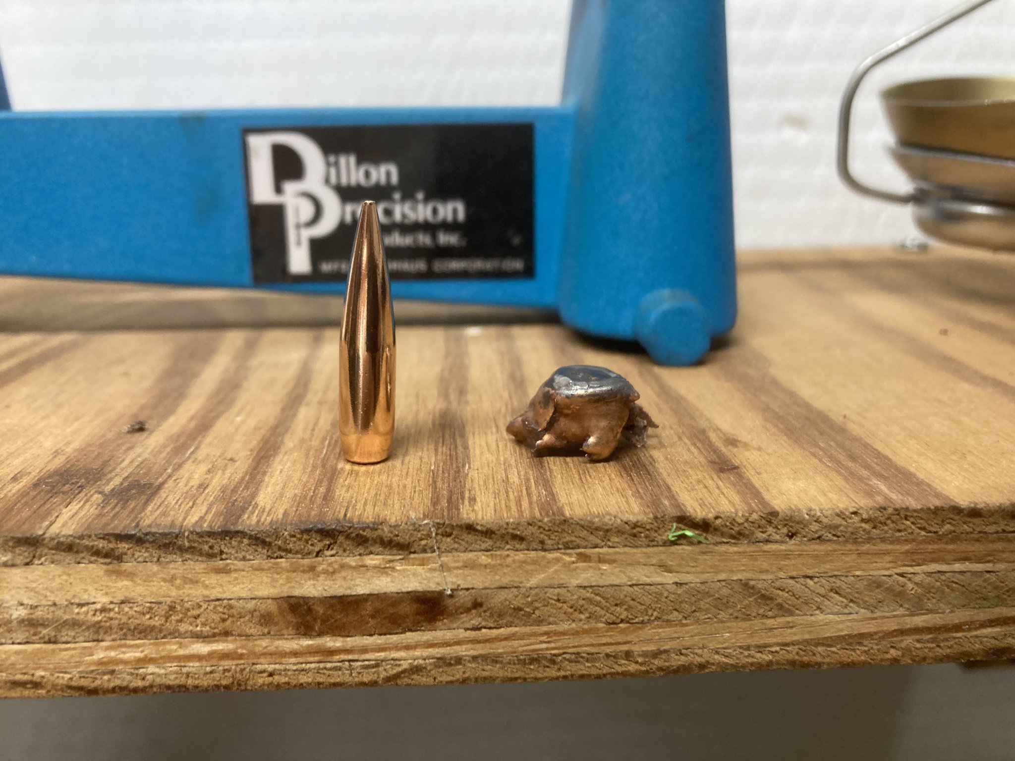

I'm new to the 6.5 CM and I see a good number of you posting the use of Amax bullets. I take it that this is the Hornady Amax; however, I can't find that Hornady makes a 6.5 Amax bullet. According to the Hornady online catalog they only make a .30 cal. Amax. What am I missing? Thank you,
Amax was dropped, look for Eldm or Atip. There was a problem with poor material selection for the plastic tip which melted away at long range and affected BC’s. But a lot of people still are burning through their stock (for example my brother who has 3000 of them). Essentially functionally equivalent to the Eldm supposedly with a material change to the plastic tip and a rebranding moving forward as I understand it.

Since most shooting is 600yd or less before the bullet tip melts, why worry, just shoot them. That being said, I’ve watched several Hornady podcasts, they come across as sharp guys. But they must be idiots to have missed this. You take the stagnation pressure and the Mach number and air density and look up in a table to find the temperature and easily find that the temperature is above the melting point of delrin. Boneheads to miss that and go into production with long range bullets.
I mean seriously even a .22 has a ring of vaporized lead around the target. How do you miss this? Every exposed lead tip rifle bullet has vaporized lead deposited around target paper, everybody has seen it. How do you miss that? Heard of the SR-71 leading edges glowing orange hot when it flies, and it’s at 80,000 feet with almost no air? Let’s go into production for a few years with plastic tips that melt, wait for a bunch of complaints, improve the product with something that should have been foreseen in design and engineering and Testing, then fix it and phase out the old stained product name because it is so screwed up the long range shooting community won’t use it anymore. Sarcasm alert.
Yeah, I also listened to the Hornady guys podcasts, up to the point that I head them explaining the Magnus effect in an incorrect way. At that point I stopped listening to them and went to Applied Ballistics podcasts and ordered all of their books.
I'm unable to forgive professionals, making bad explanations of basic physics to their audience. I then hear during different courses that the magnus effect causes spin drift, which is not true.
Hornady has an excellent propaganda and sales department...which seems to work very well, all those new cartridges, providing the world's best performance...beating every cartridge on the market is proclaimed, according to Hornady...so special the military may adopt them.
Before discontinuing the Amax, it was used to set accuracy records at 600 and 1000 yds in 6 mm Dasher. So the bullet points melted perfectly to help these guys set records? Is the 6.5 Creedmoor better than the 260? Probably not. But I have several 6.5 Creedmoors, and like it in the AR10, because shorter COAL. But in a bolt gun, it's nothing special...unless you run it to 80,000 psi in hybrid cases..but that's true of the 260, 277 Fury, or 7mm-08...

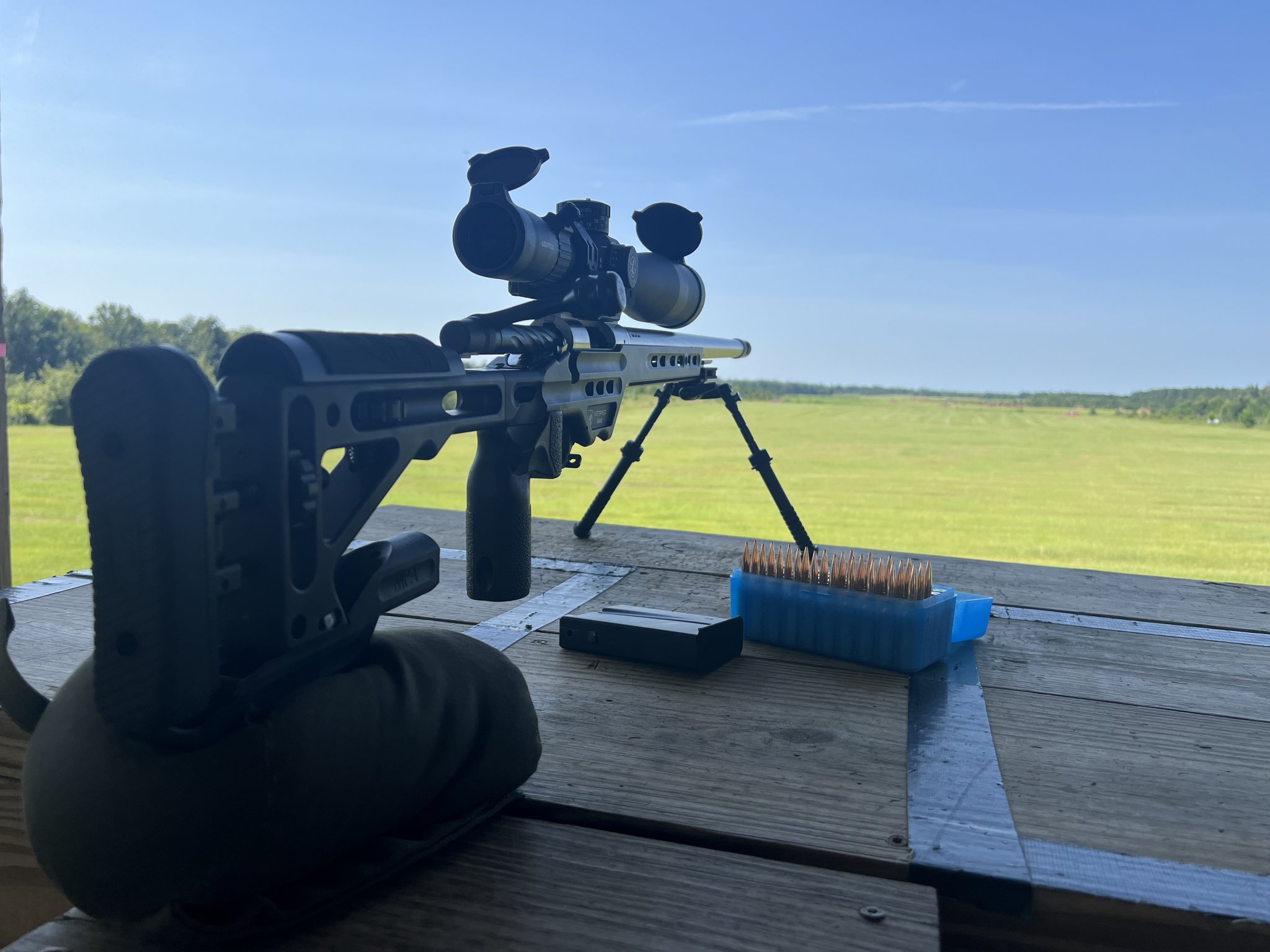

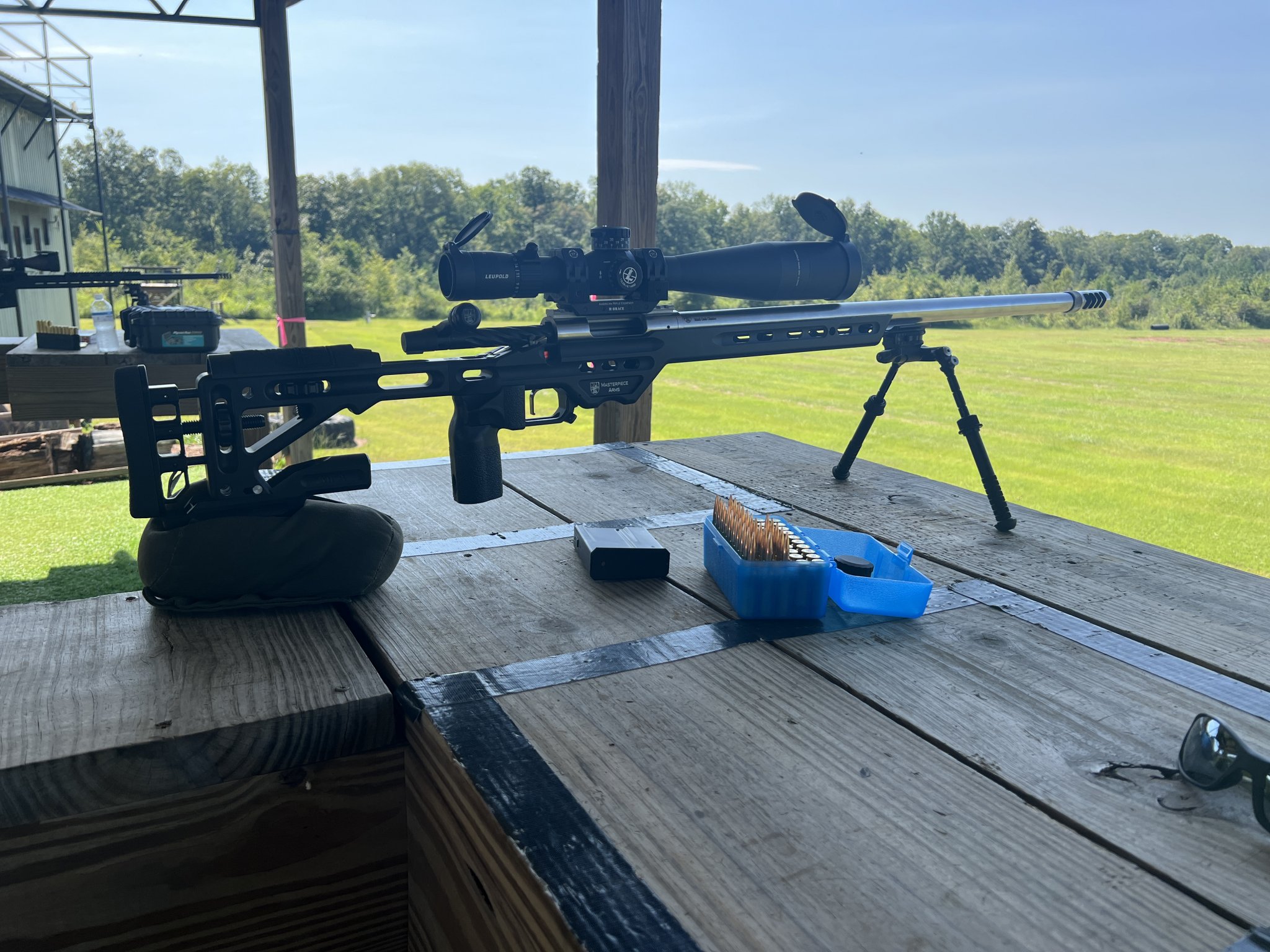

Hit a mile 3x today at Arena Training Facility.
Lapua SRP brass
140gr Berger Hybrid Target
CCI 450
42.3gr of H4350
2840fps out a 26” barrel MPA PMR Pro 2
Was a good day. 1223 and 1350 was consistent, easy work all day.
