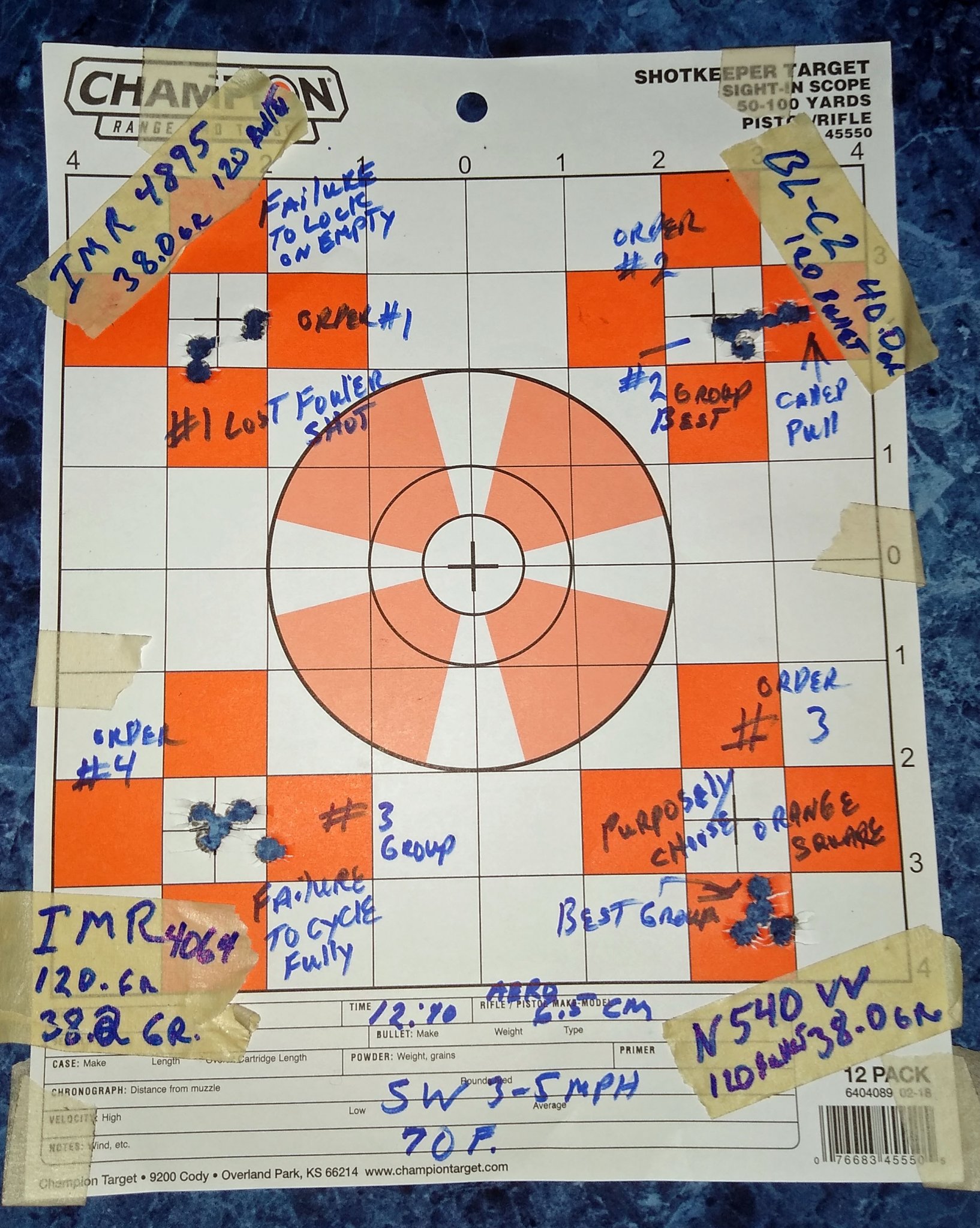

Sorting it out ,step by step . Go figure N540 & BLC-2 front running . NO rest Aero custom 6.5CM @ 200 yd. forgot My bags ,so sling & elbow on bench . Glass Meopta Optika6 , 4.5x27x50 SFP using 8 power .
Purposely ate the orange square W/N540 . I blew off #1 fouler on IMR4895 ,which cycled OK but failed to lock open . IMR 4064 Failed to fully cycle action .
Reactions: Bbracken667
Good job! Specially sling and elbow at 200 yds.
Thank You . However I felt pretty stupid leaving My shooting bags at My range . So now have Two sets and one along with all else necessary resides inside MY custom fabricated truck storage box. Combination exotic hardwoods and honeycomb S glass epoxy with ballistics armor :)

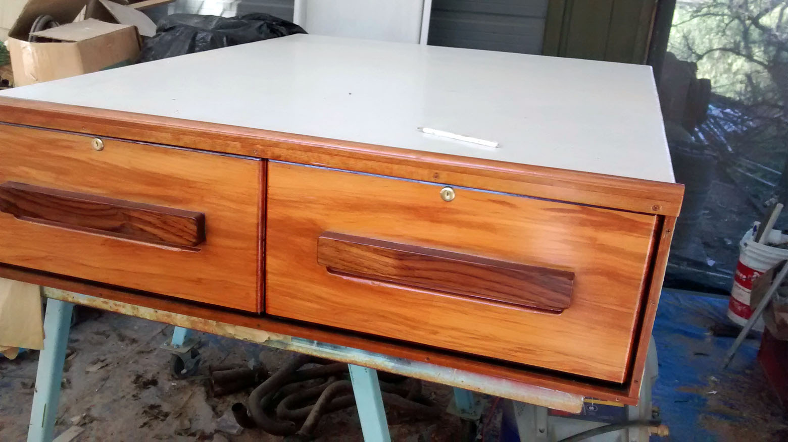

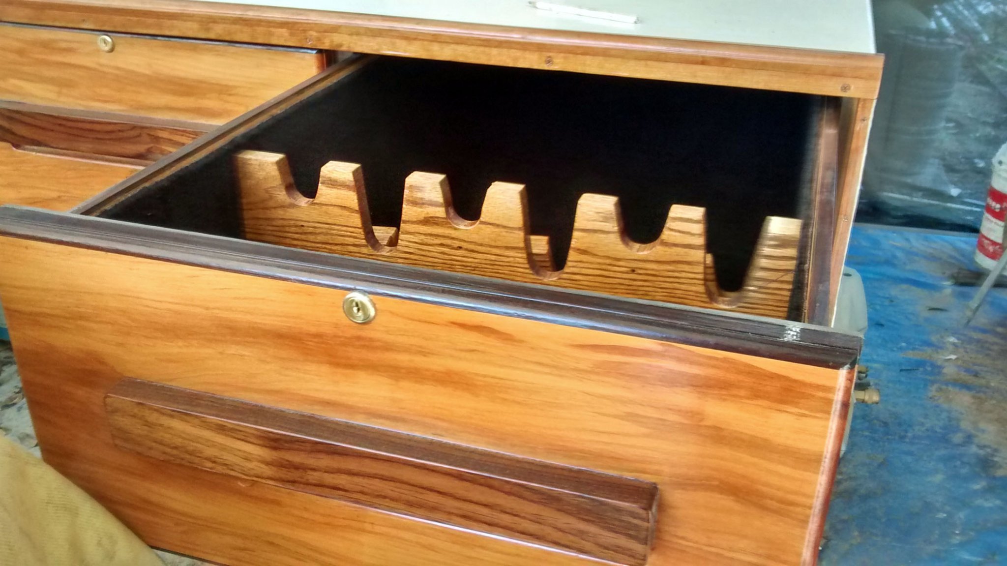

As each side has the option of mounting opposing stacked racks ,each drawer can carry up to #24 long guns . Along with numerous other items .
Drawers slide on opposing runners of HDPE slides ,easily handles 500 lb. each . I cobbled them together prior to our moving .

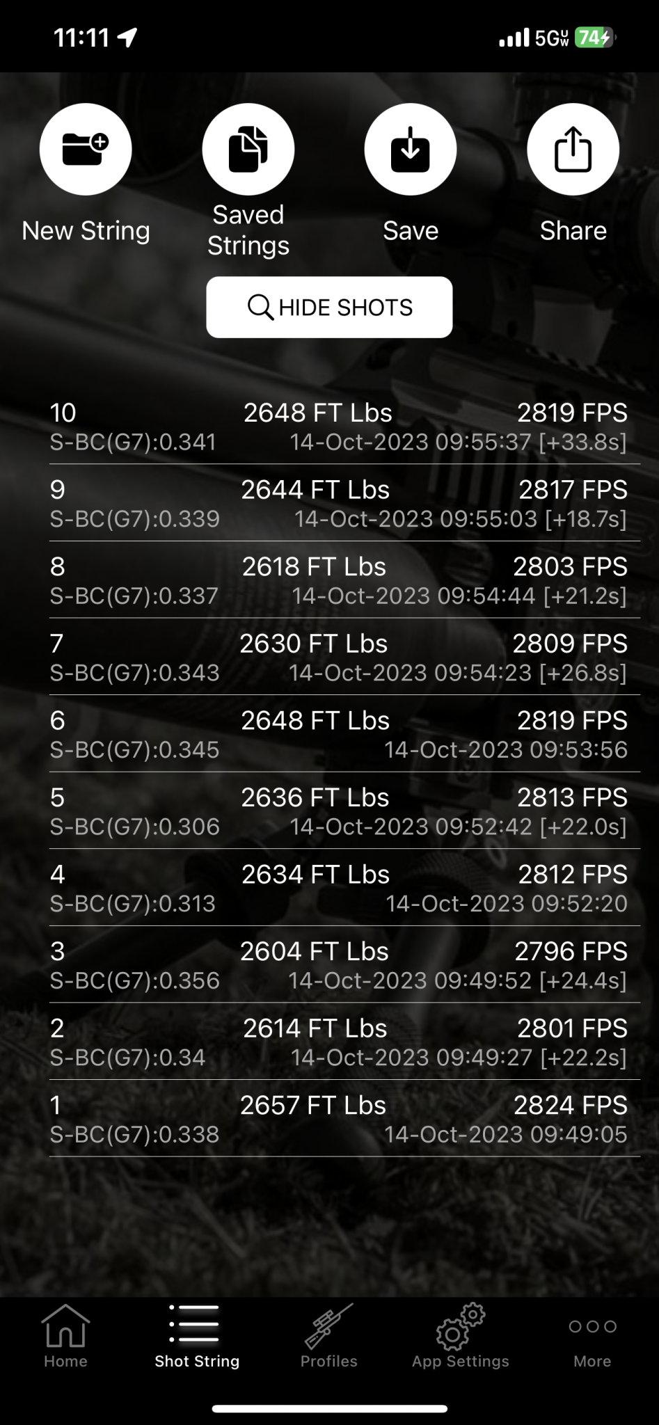

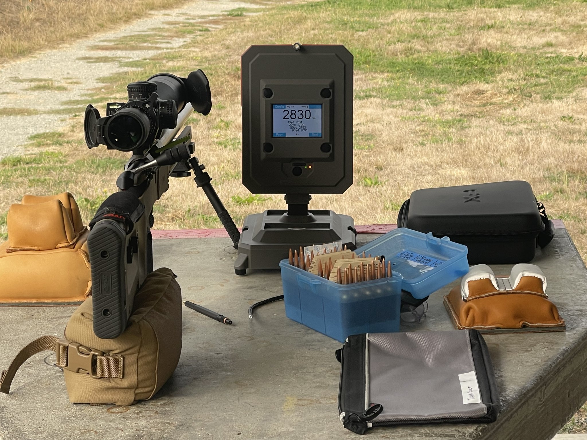

I’ve posted a few times here regarding if anyone was using SMK 150gr and I’ve seen folks ask a few questions as well so thought I’d make a post w some data.
Gun / Barrel: running a Bartlein 26” 7.5tw MTU (or close to it) barrel.
My final loads are:
- Lapua small primer 6.5 CM brass (3x fired as of this load).
- CCI small rifle mag primers
- Reloder 16: 42.5gr
- bullets: SMK 150gr (obviously)

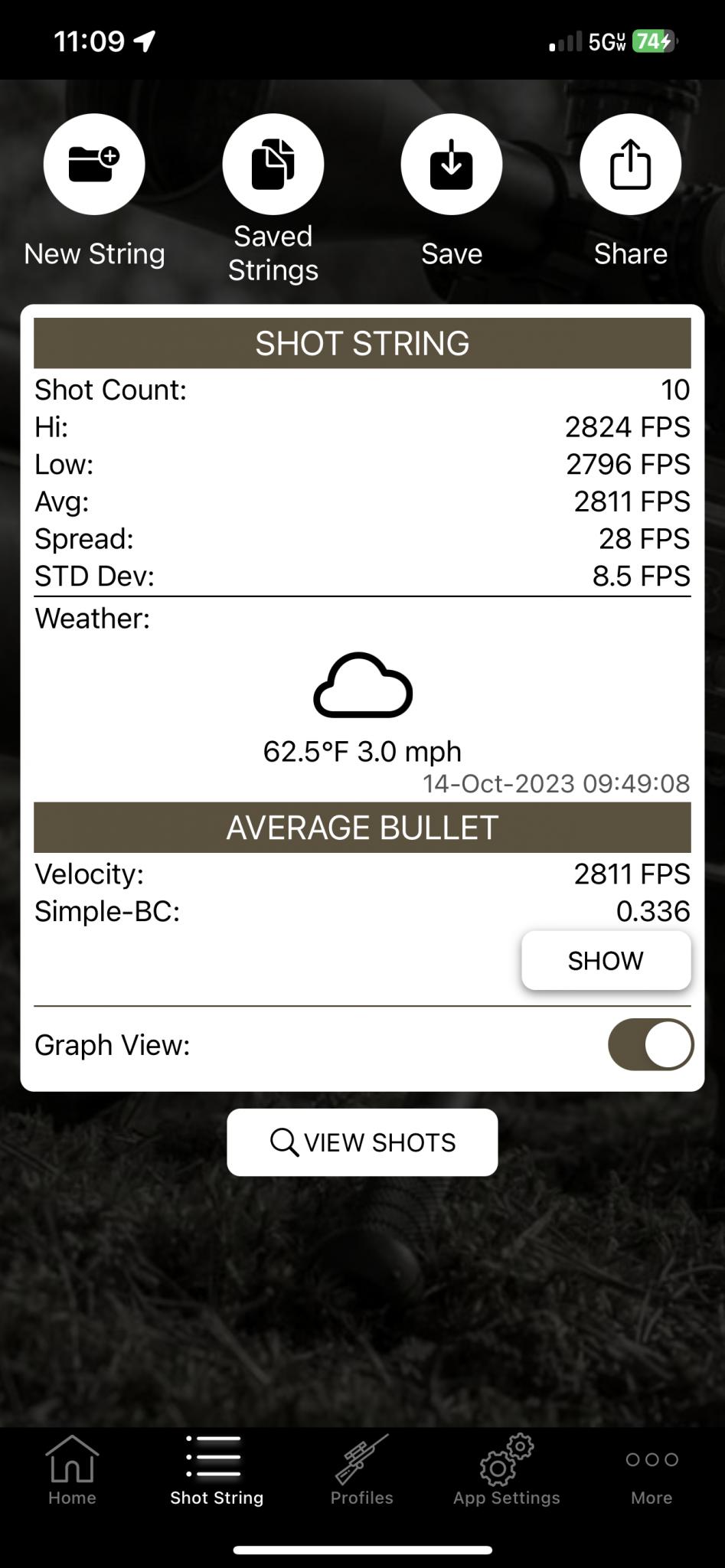

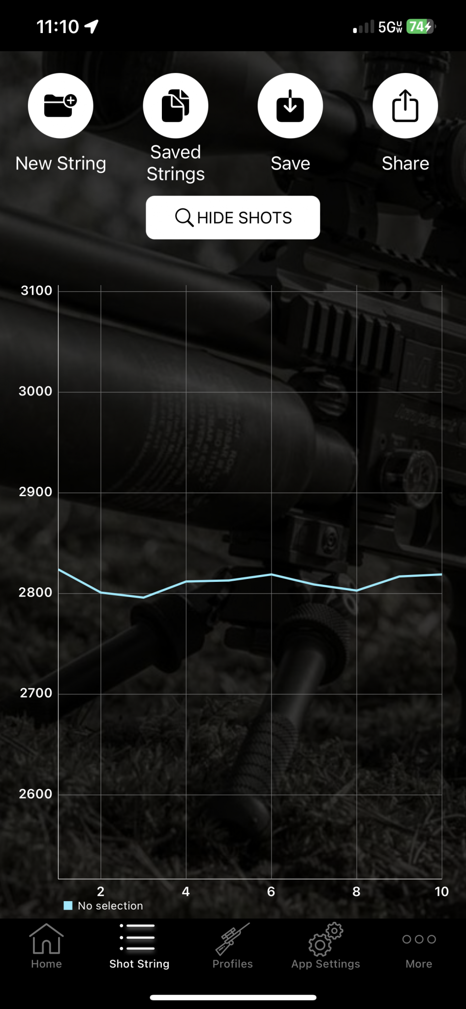

Ok so Sierra doesn’t give an actual G7 from what I’ve found BUT I recently picked up an FX Chrono and directly measured it. Below are velocities and measured BCs.
TLDR:
Avg Velocity - 2813 ft/s
G7 BC - 0.334

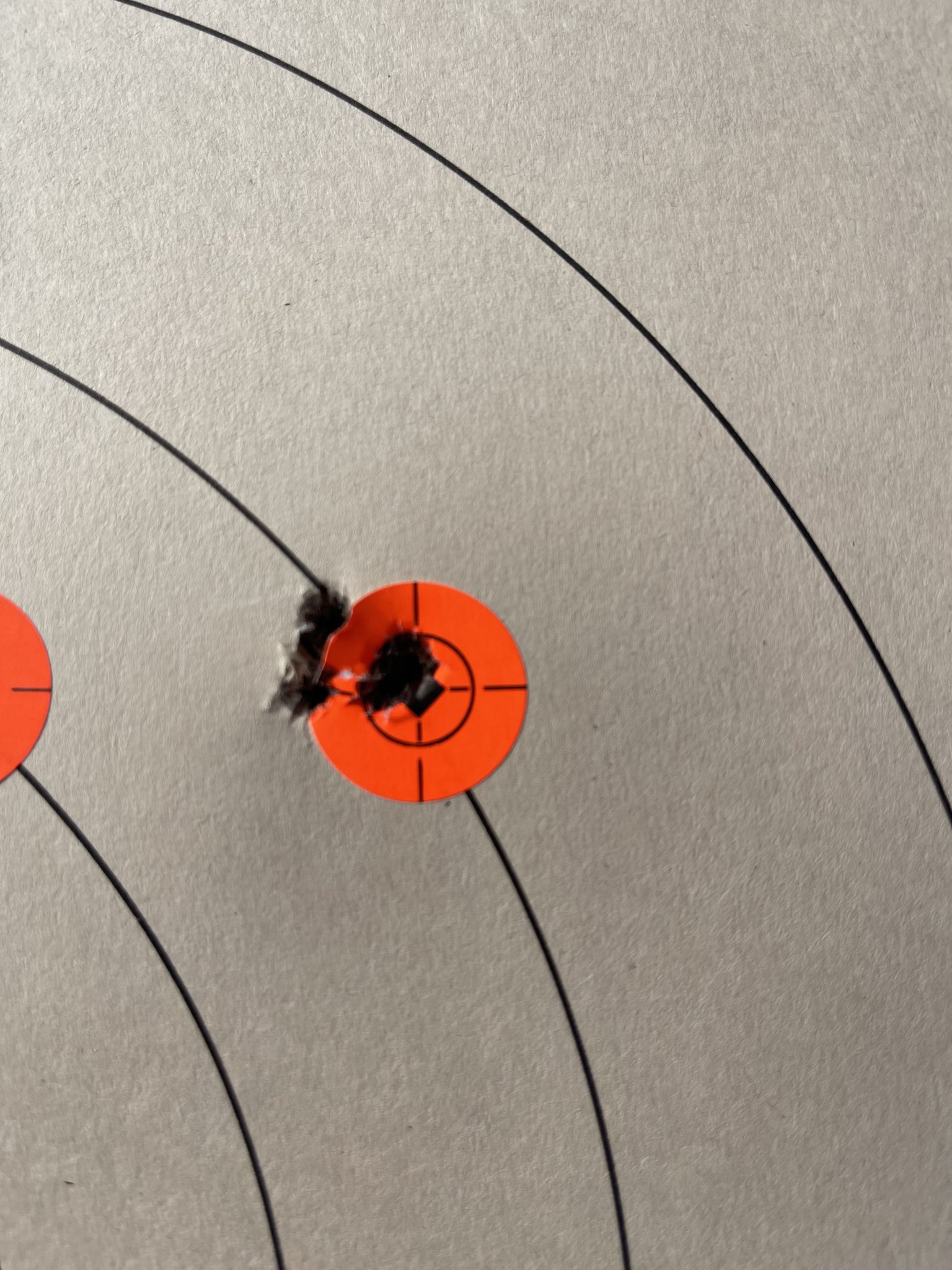

The last pic is the group of 10 shots as well.
Anyway hope this helps anyone thinking of trying them!

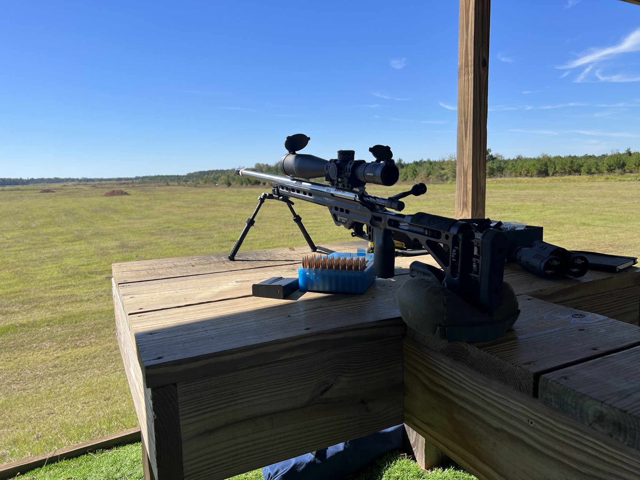

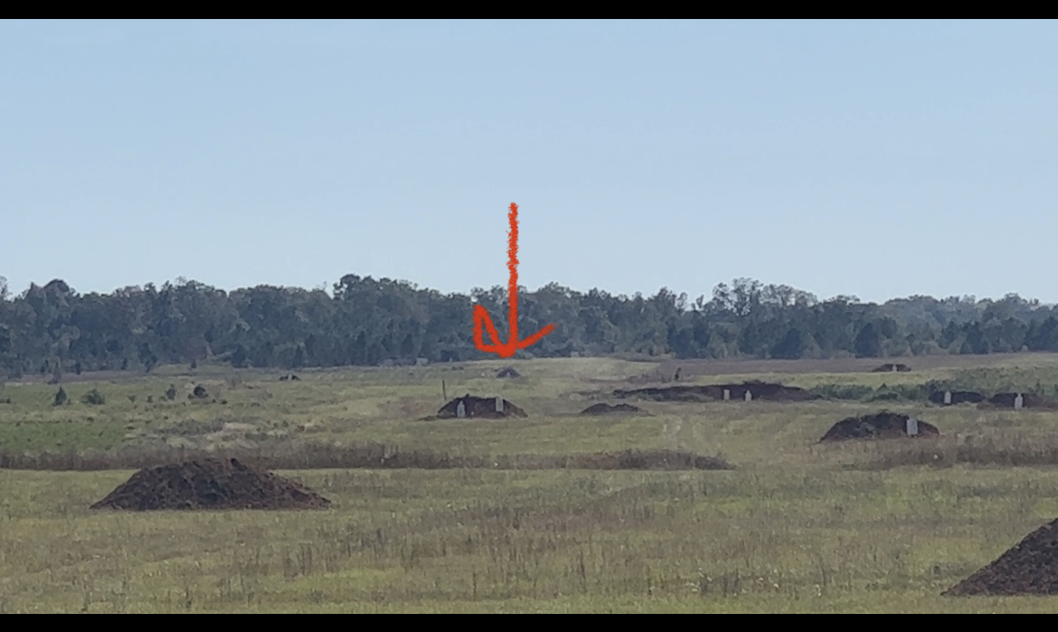

Finalizing my load for Arena Training Facility trip in late October.
H4350 42.3gr
140gr Hybrid Target, .020” jump
Lapua SRP and CCI450
2867fps 4.6SD 13ES
26” PMR Pro 2

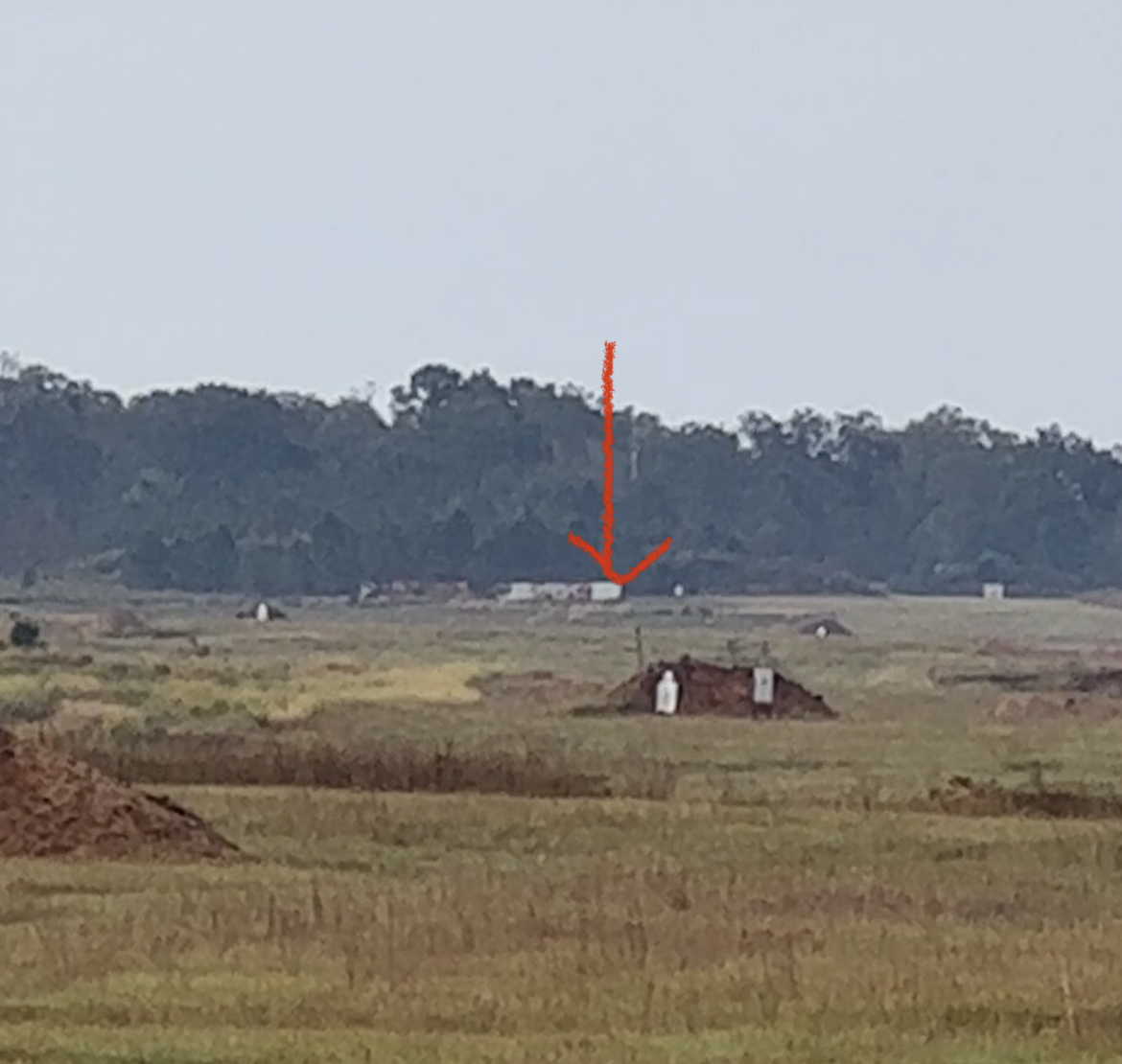

Hit 1955yds about 10 or 11 times today with this load. Impact were broken up between 3 shooting sessions and let barrel cool once it got around 115 -120 degrees. I got a video of the second session where to it took 6 rounds I believe to make an impact.
Later in the day I had 12 rounds left, made 5 impacts and did 3 in a row at one point. Didn’t have the camera on though. But plenty of witnesses!
In this video was the second session. Target is the small berm straight back in the middle of the video field of view. Impact at the end.
Going for 2100 today and try to get better footage of the events.
Very nice!! 1955 yards? Amazing.
Reactions: bf2junky
2100yds impact 3 out of 6. Watch on mobile and zoom in! This was a big plate, not sure in size. Edit: it’s a 10x10 plate
