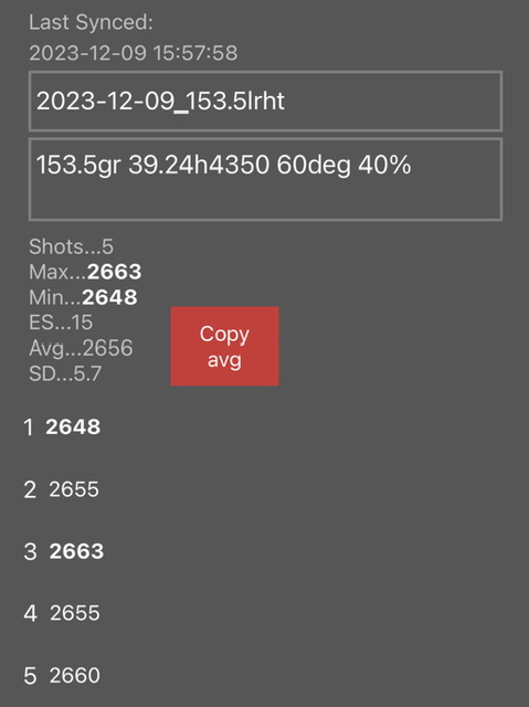

I just started working on the 153.5s, although I’m unfamiliar w/ N160
39.24 H4350 got me to 2650 @ 60deg F, same 28” bbl above, also same issue w/ neck tension mentioned above
80k jump, going to tweak it for accuracy
(ignore the MOA, this was 100yds w/ MS bayonet attached)
Edit - oops, you said A-Tips. These were 153.5 LRHTs. Time for bed

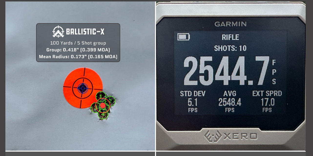

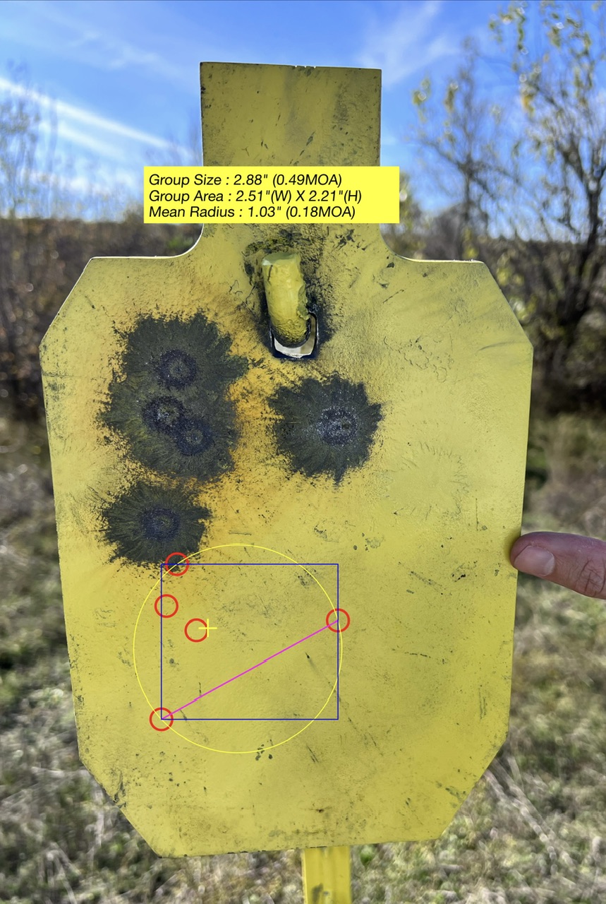

Hello. I think this fits in this thread so please let me know if it doesn’t. A bit new here and to long range/reloading but could use some experienced advice. Worked up a 6.5cm load and shot velocity tests and groups at 100yds.
Load - 144 Berger lrht
H4350
Lapua srp
Fgmm primer
Fl sized. 289 bushing trimmed to 1.911
One node was 40.2. - 40.4 the groups were good (for me) and 0.4 moa when I did my part. Best ES was 17 and sd 6.4
Next node was 41.2 - 41.4. The groups were not as good around 0.6 moa but the es was 7 and the sd 2.6.
Is it worth the accuracy gain but be 10 fps greater on the velocity spread?
The hotter load only gains 50 fps (2660) and will be used past 1000 on steel. Hopefully to one mile next summer.
I’m a 0.5 moa shooter on a good day so please tell me if I’m just plain overthinking it too! Curious if anyone had made such a choice and if there were any lessons learned. I don’t want to use up any more of these bergers on load development!

289 bushing
That .289 bushing on Lapua brass is probably giving you more neck tension than you need. A .290 bushing on Lapua (0.015 neck) gives me 0.003 neck tension. Reducing your neck tension to ~0.001 or 0.002 might improve your SDs, although SD of 6fps isn't bad
Across a 20 shot string gave me an SD of 1.68.
H4350
Lapua srp
Fgmm primer
try that higher node again, but try different seating depths.
