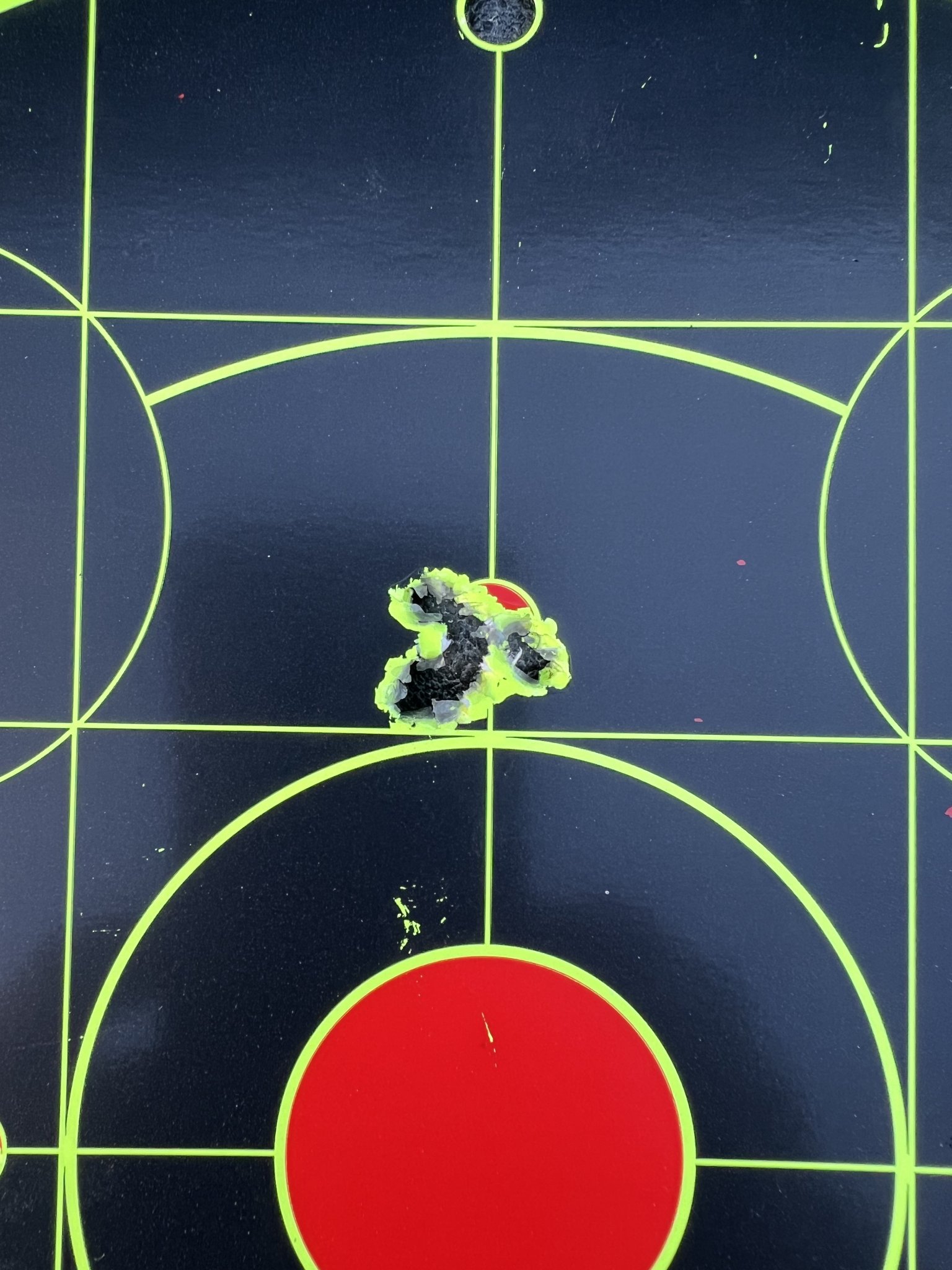

This was 12 round group out of it a the range yesterday

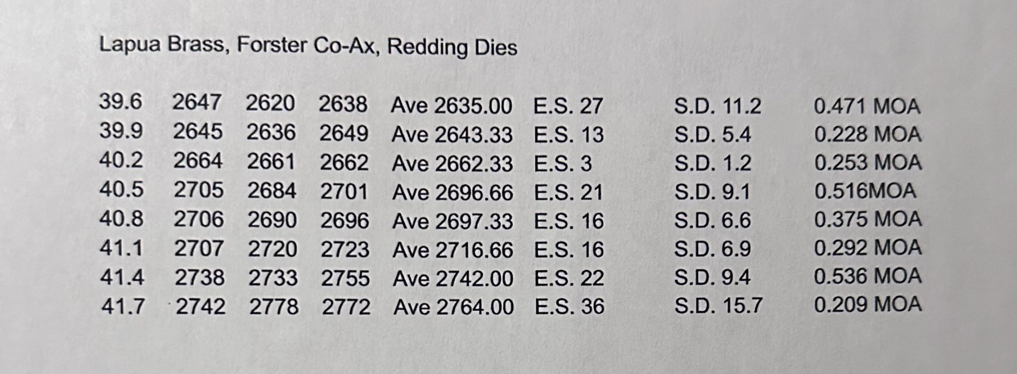

Berger 140 ht, Lapua SRP, CCI450, H4350 … Five rounds each weight of 39.6-39.8-40.0-40.2-40.4-40.6-40.8
COAL 2.8” …CBTO 2.093+-
Three lowest SD's
Are these good considered a good SD?......@ 39.8 SD was 5.4 (2626-2630-2632-2622-2619)
@ 40.2 SD was 5.54 (2671-2676-2681-2186-2191)
@ 40.6 SD was 6.08 (2708-2718-2708-2721-2710)

That 40.2 Data looks off. Typo on the last two velocity inputs?

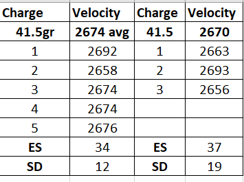

Yeah they are considered good, but with 5 shots it doesn't mean a lot. If you did that with 20 or 30 shots and got that same SD it would be very good.
An impressive SD for 10 rounds. What are you using to measure your powder? What primer are you us
No they are what the Magneto speed captured. BUT...I am newish to reloading and I will say that I am using an auto trickler and i set it to 40.2...sometimes it throws a tad more or a tad less...i.e it might have thrown 40.29 or 40.27 .... I'm trying to be realistic when doing the test....does everyone buy these fancy machines and still baby sit them to the exact grain? That is a sincere question.... If i buy a box of Hornady 140s am I getting an exact grain count or am I getting the same variable?

The 40.2 numbers are most definitely wrong.
Those 5 shots with the velocity you have listed would give a SD of 267.
If the MagnetoSpeed gave you the SD of 5.54, then it read the speeds correctly and either displayed them incorrectly or you misread them.
Thank you for the info. I will look at the data again…additionally I am going to rerun the test And look closer at the throw numbers to test consistency there as well.

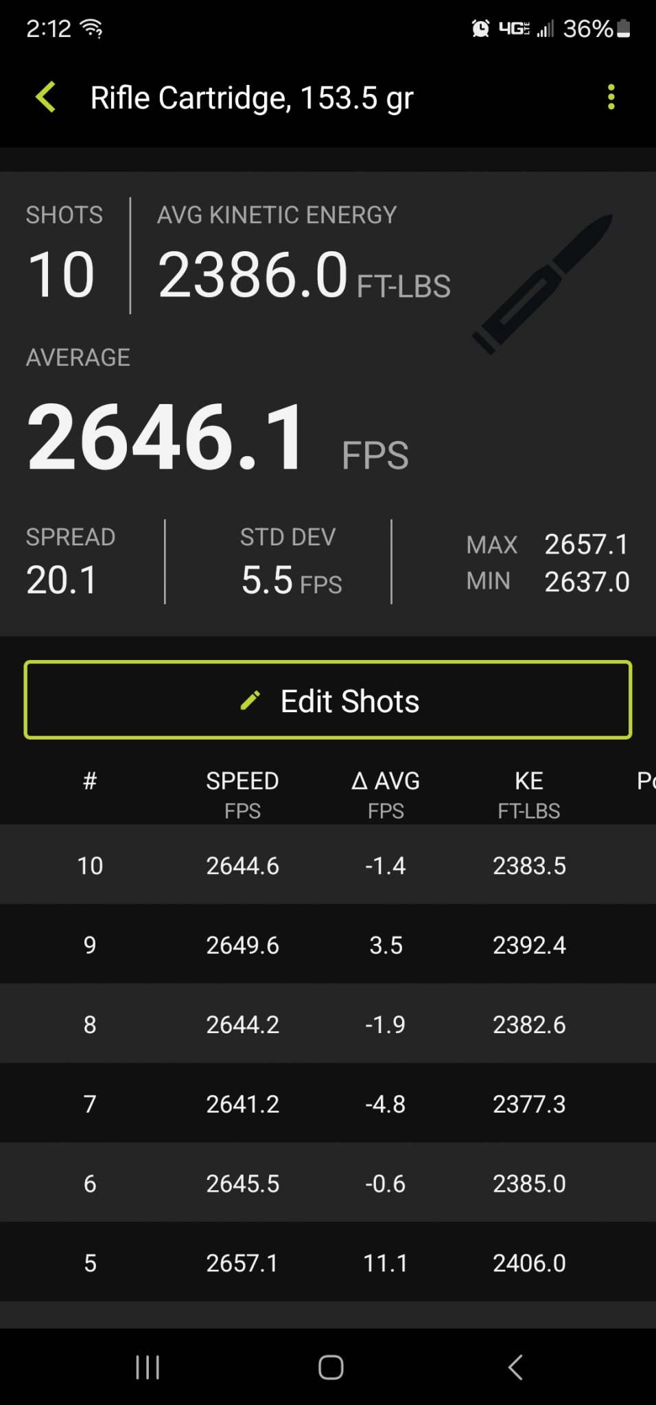

I am looking forward to the release of the 100 gr ELD-VT from Hornady for coyote hunting. Going to post data for a 12.5" Christensen and 24" Proof. Both suppressed. If anybody gets ahold of them before me, please post your findings. I want to find a good temp-insensitive powder since I'll be using it year-round that still provides enough speed for the short barrel of the Christensen.
Berger 153.5
Lapua virgin brass
40.5 H4350
CCI 450
2.1950 BTO (80 thou off)
26" Proof Prefit.
Hoping to see this tube speed up a touch and get the ES a little lower.
Groups are at 200 yards. Bigger group with the two flyers is off a tripod.

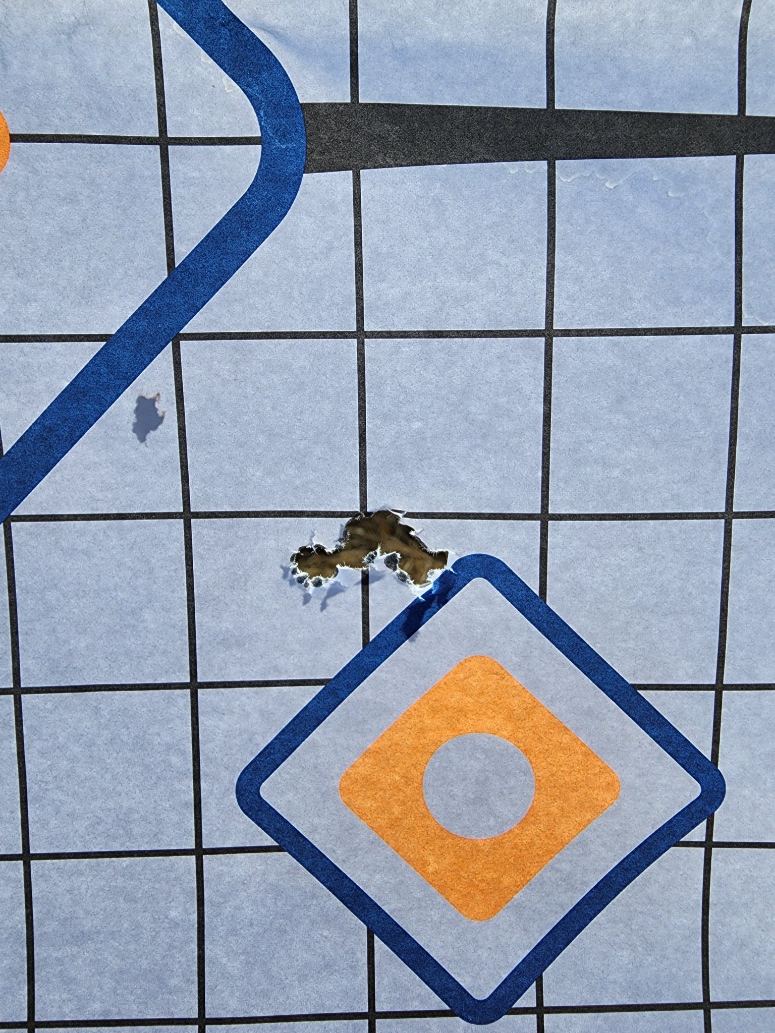

Where should I go from here?
I only had 100 bullets and I had lost my previous data.
Barrel is a 24” 1-7.5” twist IBI
OCW test Nosler 140 RDF, H4350, BR-4, Lapua brass.
If you click on the target it will bring you to to photo bucket with better resolution.

I'd say 40.0 gr. and see where E.S. and S.D. are in relation to MOA and velocity . Just MY personal observation . Try #10 rounds and see if it's consistent .
