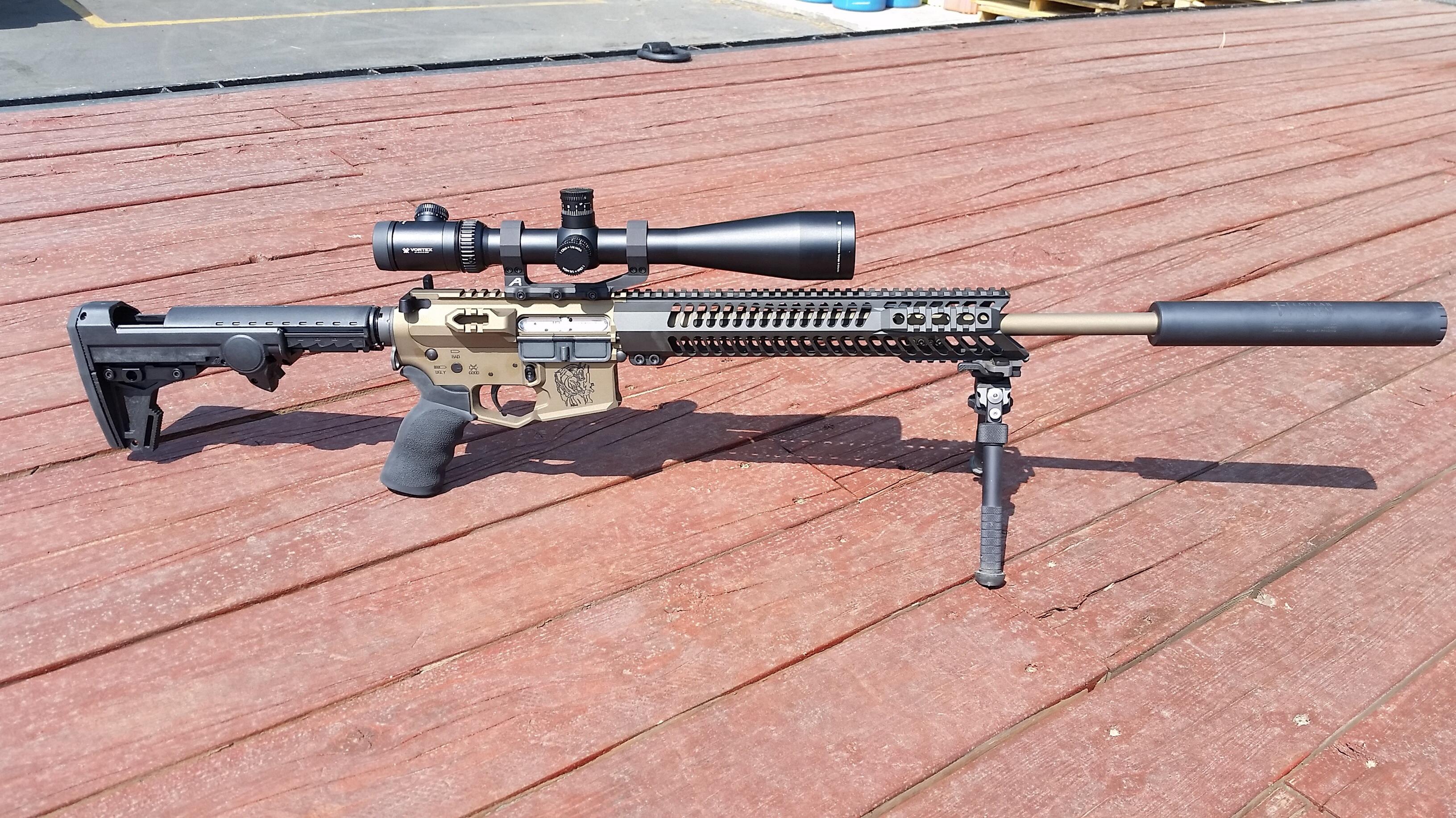

I like this caliber. I have two in an AR platform and use them sometimes when I hunt. I am sure you could have one built in a bolt gun. :cool:
I have a dozen or so AR platforms the Grendel is my hands down favorite 5 shots at 200 yds 24 inch barrel 107 gr Smk 28.5 gr XBR 8208 i can break clays at 500 meters no sweat I shot F class with this rifle usually 8 x +/- 145
