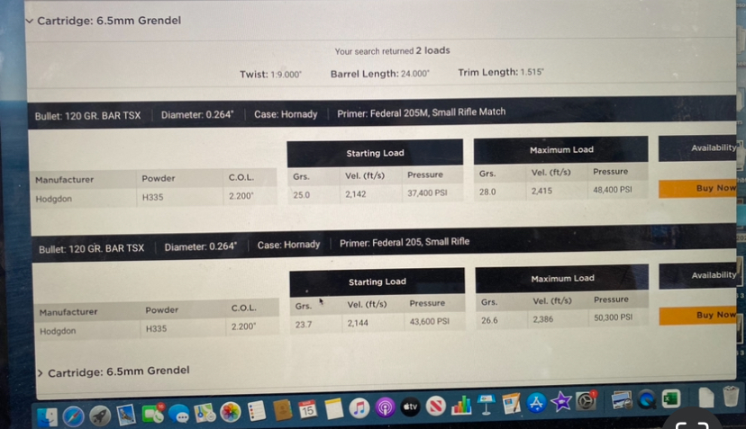

Thanks for posting that about hodgdon. That said, WTF hodgdon? Accidentally entered 335 twice when I was making a chart to print and saw this…
Which is it!!! Am I missing something?
They still have their older data and the newly-published data, with quite the variation between identical loads.
Is it a change to their pressure transducer, propellant burn rates have shifted, or something else?
I don’t know, but I noticed it immediately because I have gone over their original 40 loads for 6.5 Grendel hundreds of times.

My inkling is that something more meaningful has changed, whether it be propellant burn rate from these later lots, or something else.
It’s one of the reasons why I always chase the latest load data available and collect it from multiple sources to get as close to the component combos I have, if not exactly what I’m using.
