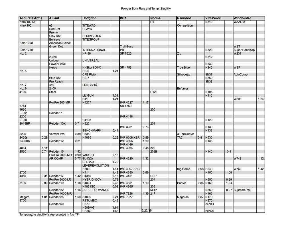

Has anyone used TAC, A2520, BLC2, shooters world match rifle, or big game?
I've never reloaded but may get into it soon. I've scrolled through this thread over the years but realized there's a ton of different powders used for the grendel. It's not like the CM where there's really only just a few that people stick to.
I'm trying to see what powders are more temp stable but also available. Some of these have the hardest time hitting the shelves and have not been consistently in stock for years or have taken a massive price increase.

Tac is a popular choice and also works for heavy 223 projectiles. I had a 1/2 moa group with 69g 223's and need to finish up testing on that.

Is there a temp sensitivity chart? I know there is one for burn rates. I'm in south texas and I want to hunt with the grendel eventually. Temps range from 110 to 20s or 30s in the winter.

2520 is one of the best suited powders for Grendel.

Is there a powder you know of which is very insensitive to temp changes?
I'm only iffy because I've never reloaded. Im going to be a first time loader and want to start with whatever is less risky in drastic changes. It can be in the 90s here in South texas during the winter and a cold front can come in and the next day will be in the high 20s.
I want to load 6.5grendel for hunting so both ends of the temperature extremes are highly possible.

Good question about temperature sensitivity. I know enough to know I don't know enough. That said, I never load jagged edge and don't run into problems. However, I typically shoot calibers that appreciate some pressure for best accuracy. Loading with hunting in mind, extreme heat of summer won't be too mich of an issue IMO. a lot of knowledgeable shooters will develop their load with environment in mind. With me living in the South, it never gets so cold I have to worry about large velocity differences.
The Extreme powders play nice but I don't use any of the extruded powders (XBR8208 is my exception) in the Grendel. I use either AA2520 or LeverRevolution with 120+ grain bullets and 8208 for the lighter stuff. 8208 has always been accurate with the heavies but I cannot reach the velocities with it. Everything I'm referring to is for AR's and worth what you paid for it....

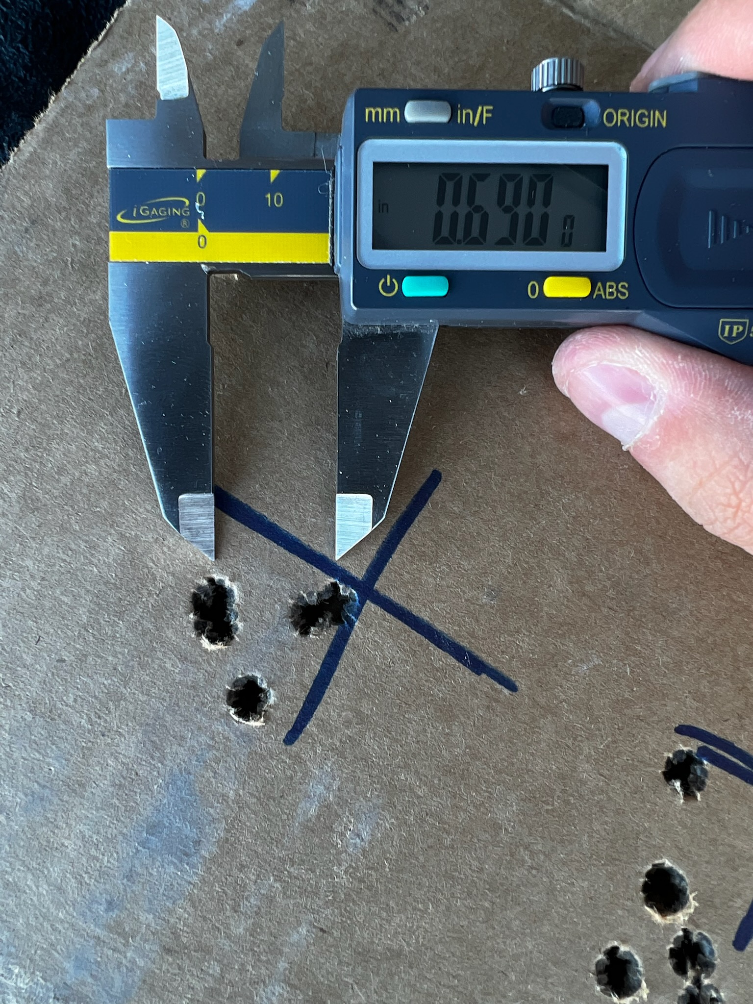

So I found a good node at 28.6-28.8gr of TAC. COAL is 2.300(fits nicely in 6.8 ASC mags, feeds better than the grendel mags actually). 3/4-1.0 at 100yds. Getting 2496fps out of a 20" barrel. This was using the 123gr ELD-M bullets.
Also found an MOA node with 115gr Barnes black tips with 29.5gr of TAC. 2.275 COAL.
Both loads are well over book max, so use caution. This was at 58 degrees at 5900' ASL.
