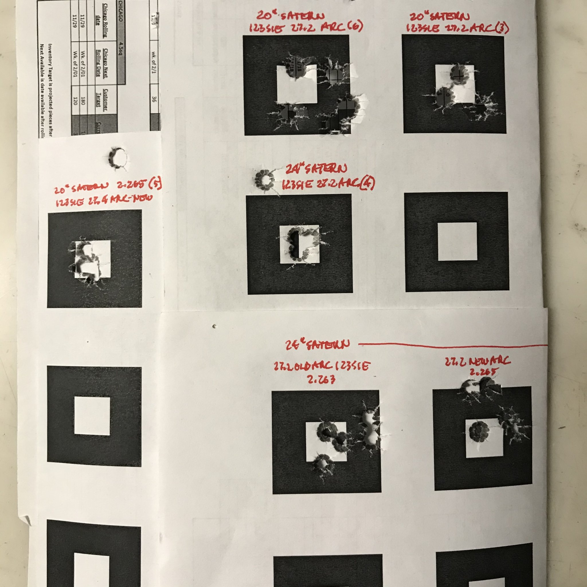

These are a few from 20” and 24” Satern barrels. Small square is .47”. Yes, threw a couple of shots-that’s on me, but these are indicative of Grendel potential, and more so for how consistent AR Comp has been performing in Satern cut rifled barrels. All are under .75”, with some exceptions wanting to go well under .5”. The shooter still has work to do, but these indicate current results. E9A36CF1-7CD9-48A6-8C17-AD5DE6AE7FCB.jpeg

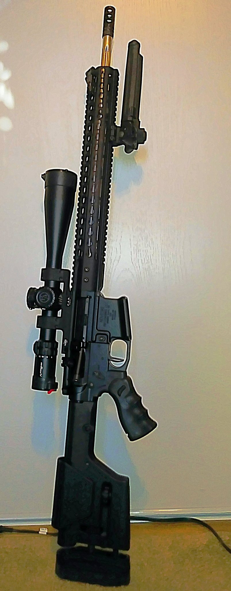

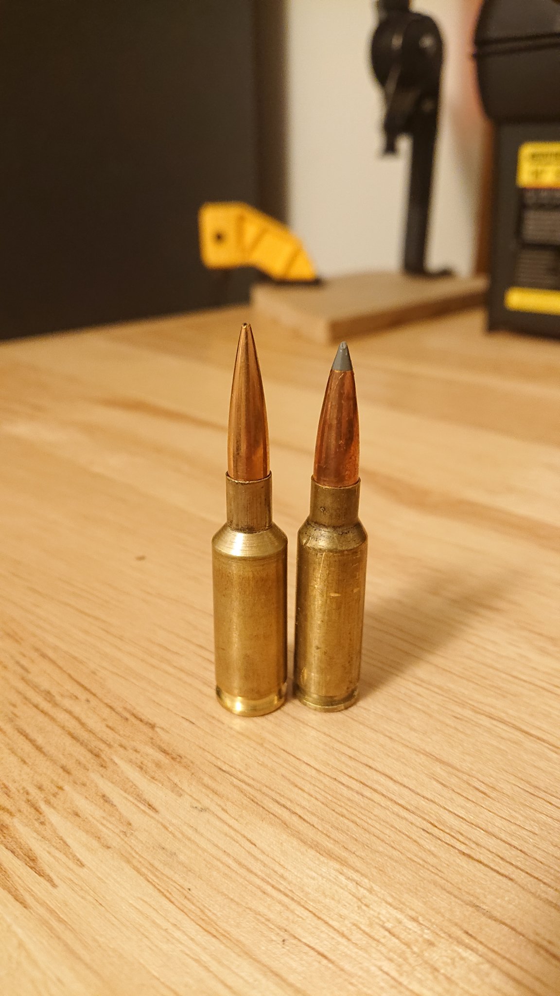

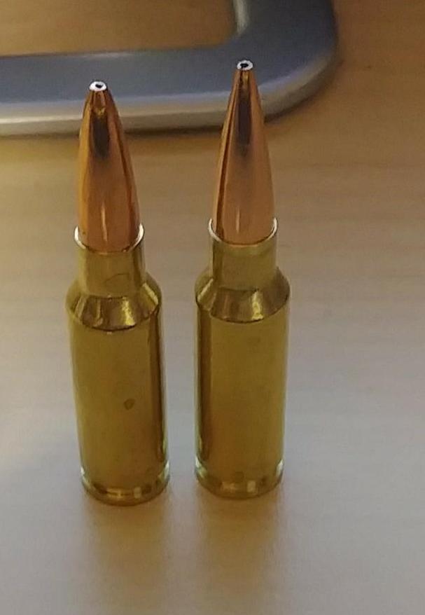

RIFLE: AR15 - NOVESKE MATCHED SET
BARREL: ATHERIS RIFLE CO. 416 S.S. HEAVY, FLUTED 20" 1:8 TWIST, 5R RIFLING./MATCHED NIB BOLT AND BCG.
CARTRIDGE O.A.L. : 2.280 ± .003 (LONG ENOUGH TO FIT MAG.)
BRASS: HORNADY
BULLET: BERGER 130 G. VLD HUNTING (ALL WEIGHTED 130/129.9)
PRIMER: FEDERAL GM205M
LOADS: 5 WEIGHTS, 5 SHOT GROUPS AT 100 YDS.
POWDER: CFE-223 (INTERNET WISDOM DATA)
29.1
29.4
29.7
30.0
30.3
VIHTAVOURI N540 (VIHTAVOURI WEBSITE DATA)
26.2
26.7
27.2
27.7
28.5
PICTURES OF RIFLE AND LOADED ROUND COMPARED TO A HORNADY A.G. 123 BTHP

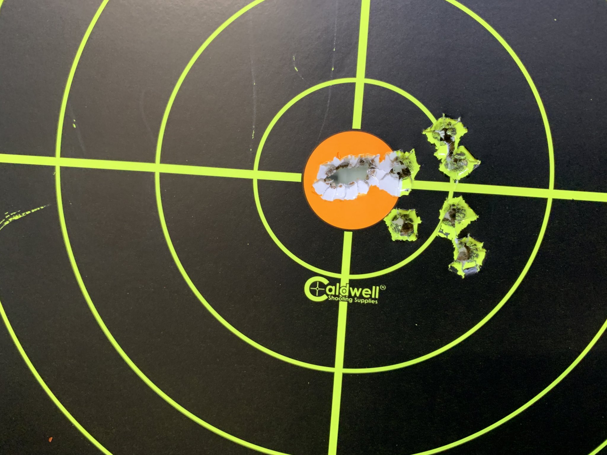

This photo is my Grendel Hunter/Satern upper. I am planning to do some hand loads following Sierra data. Only thing is I will be trying Barnes 120 TSX bullets and TAC powder. Will post results when I get some made.
Target is 100 yards, 20 inch Satern bbl using Hornady Black 123 ELD Match.

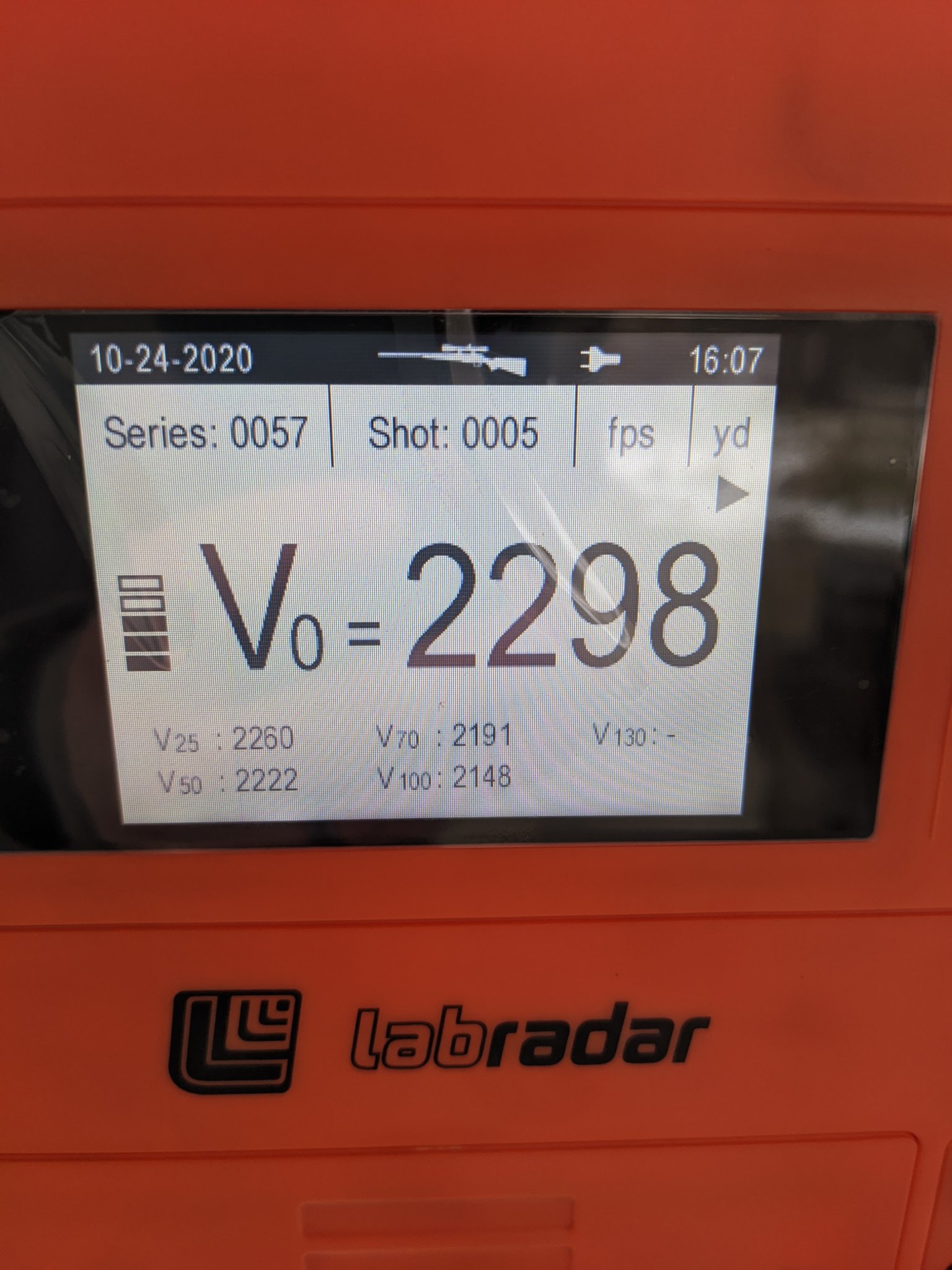

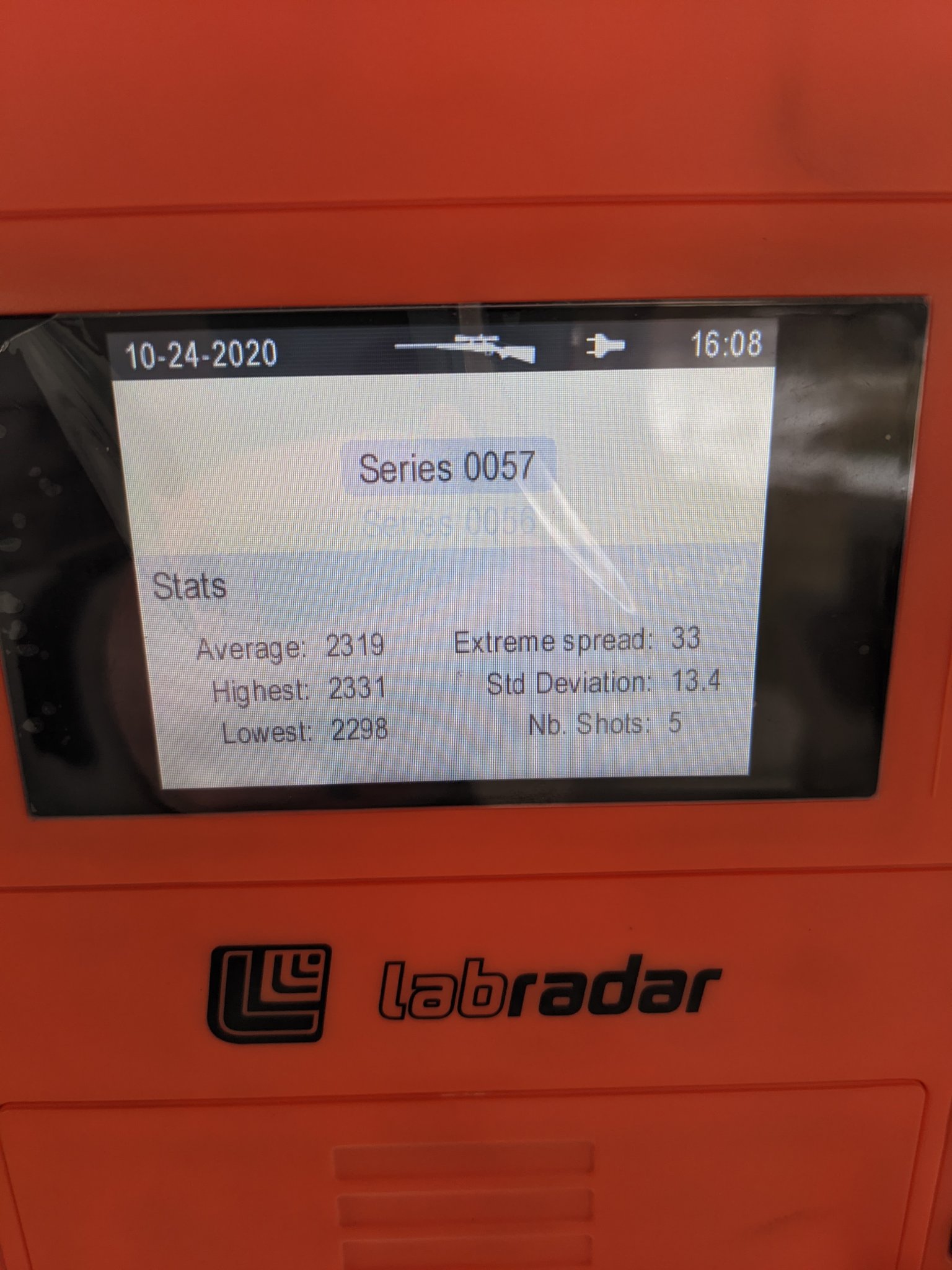

129 gr Nosler ABLR
26.4 gr 8208XBR
18" AA Lite barrel
2345 fps @ 65 F, 2319 fps @ 34 F
Pic compared to 6 BRA with 105 Hybrid, and Labradar readings. The slow shot read out to 100 yds, which is consistent with a G7 BC way over the advertised 0.267 (would be over 0.30).
I've taken five deer with this 6.5G load, all passed through completely and none went farther than 20 yds.
Reactions: st1650 and Snuby642
129 gr Nosler ABLR
26.4 gr 8208XBR
18" AA Lite barrel
