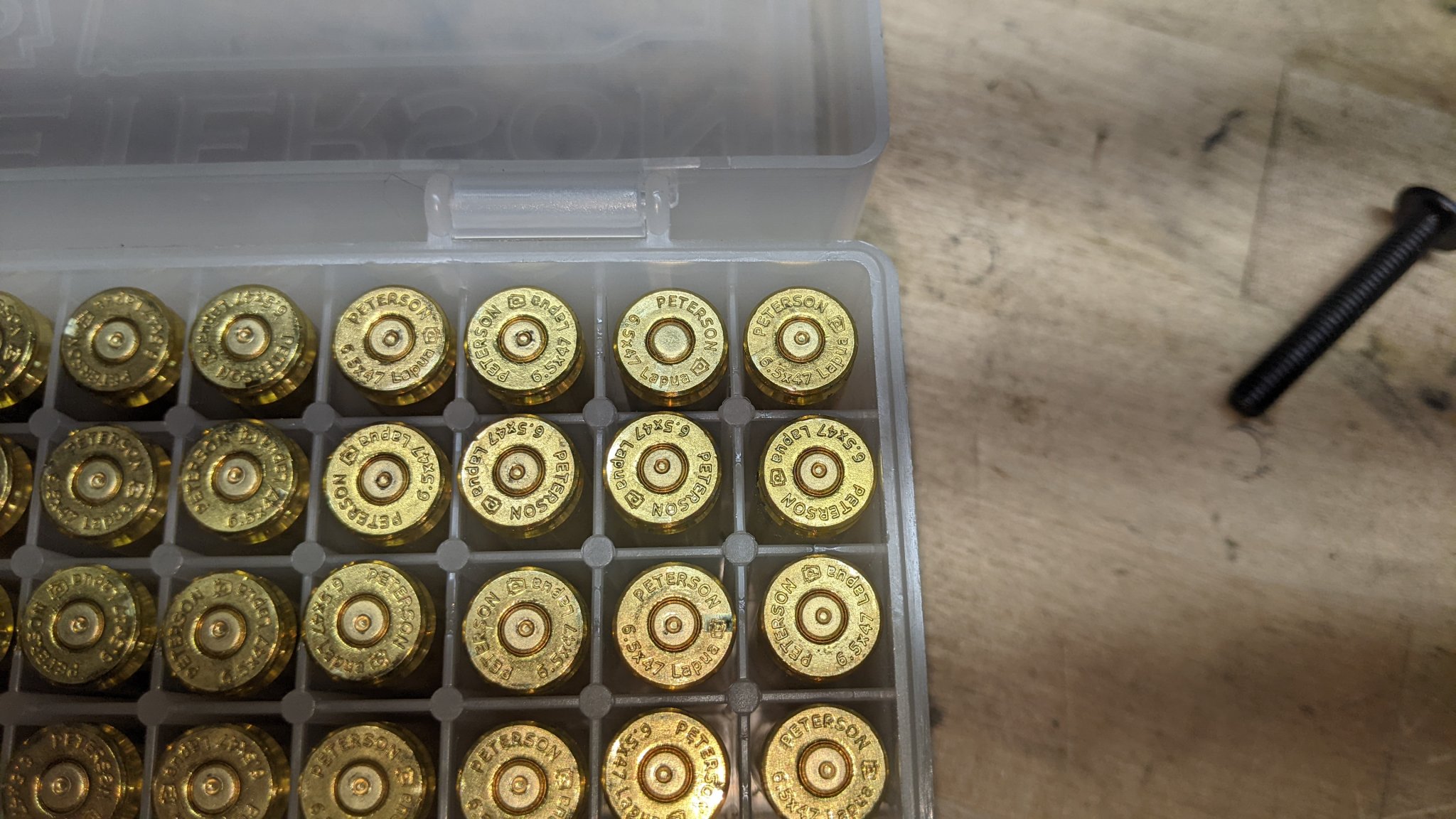

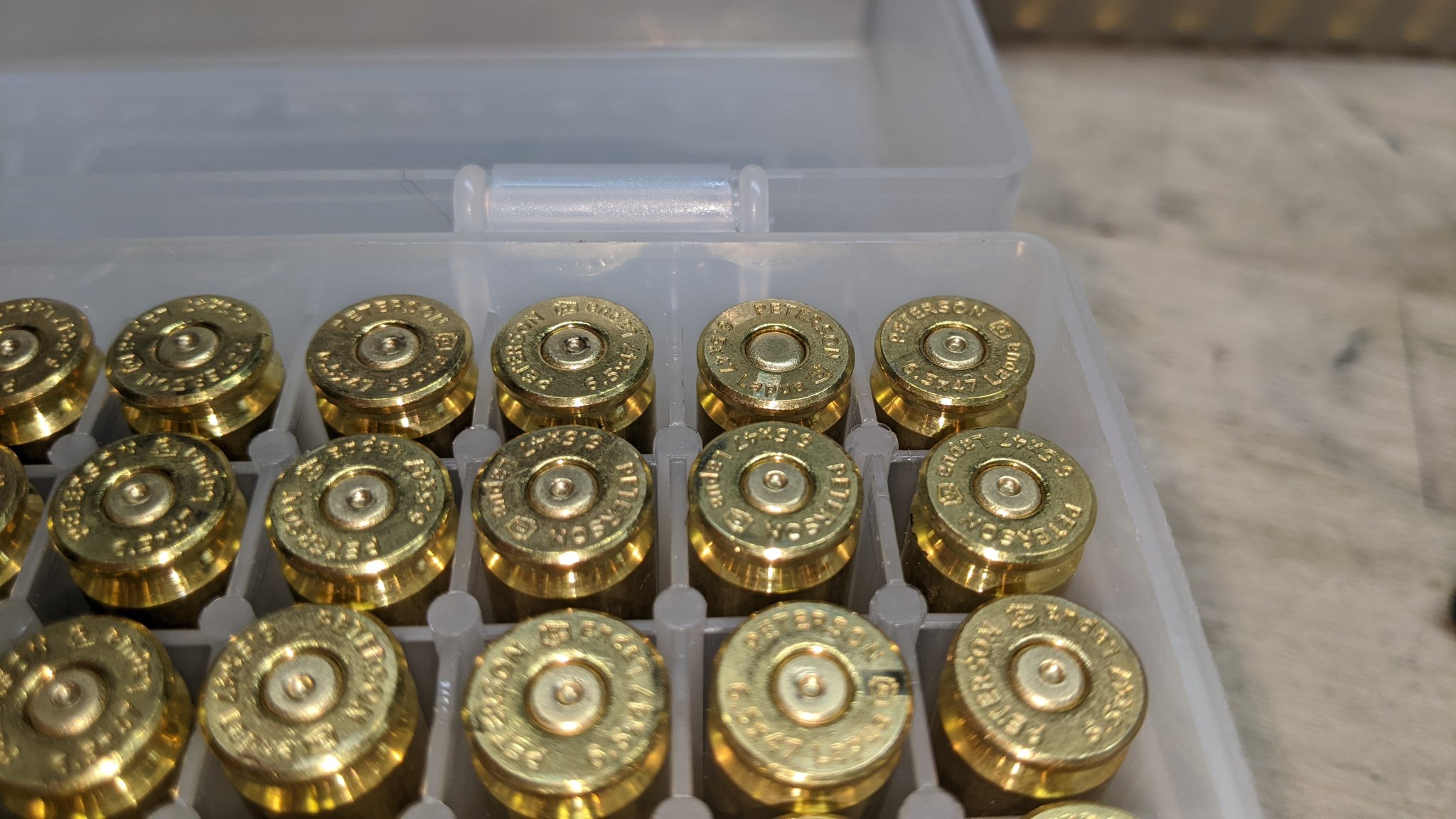

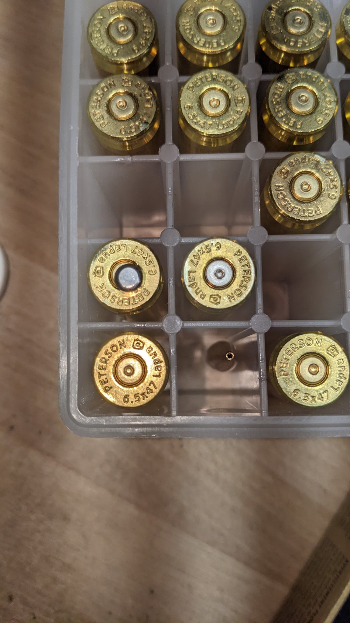

Has anyone ran into pressure signs with the 140 hybrids and varget? I get ejector marks and flattened primers at 36 grains, I still seem to be getting slight ejector marks at 35 grains.
New Peterson brass, cci 41 primers, sw precision (tried varget with same results),
140 hybrids. Tl3 sa, brand new Krieger shouldered, barrel work done by bugholes, suppressed and unsuppressed. 35 grains, 20thou off lands .001-.002 of neck tension.
It shoots great around half inch 5 shot groups, but only 2600 fps any ideas?

Well the barrel is new literally these are the first shots, I did check the neck expansion looks like around 3-4 thou, a loaded round measures 289 or so and fired case measures 293.
I wonder could the action have anything to do with it?
I don't think an action would cause that kind of problems, that being said u never know.
I'd get 20 pieces of lapua brass and load of powder charges till u hit pressure and see what velocity you come up with.
What freebore are u running?
Also I'd try some different primers.
See if anything changes.
Did you do load work up with that brass and rifle?? How far are you off the lands?
I found I had to drop my charge with Peterson vs lapua...
Reactions: DIBBS
Not sure of the freebore I'll have to ask, I told them I'll be running 140s and they chambered it for them I believe.
See pics for issues.
I put a new primer in there for comparison.

I've only put 50 rounds through the barrel, started with 34, 34.5 and 35 grains 20 thou off lands.
One more
This is a pic of federal gmm primer.
37.2 grains sw precision
20 thou off lands
Just wanted to add, no heavy bolt lift and charges are thrown with AND autotrickler.
Verifed with calibrated weight and 140 hybrid.
