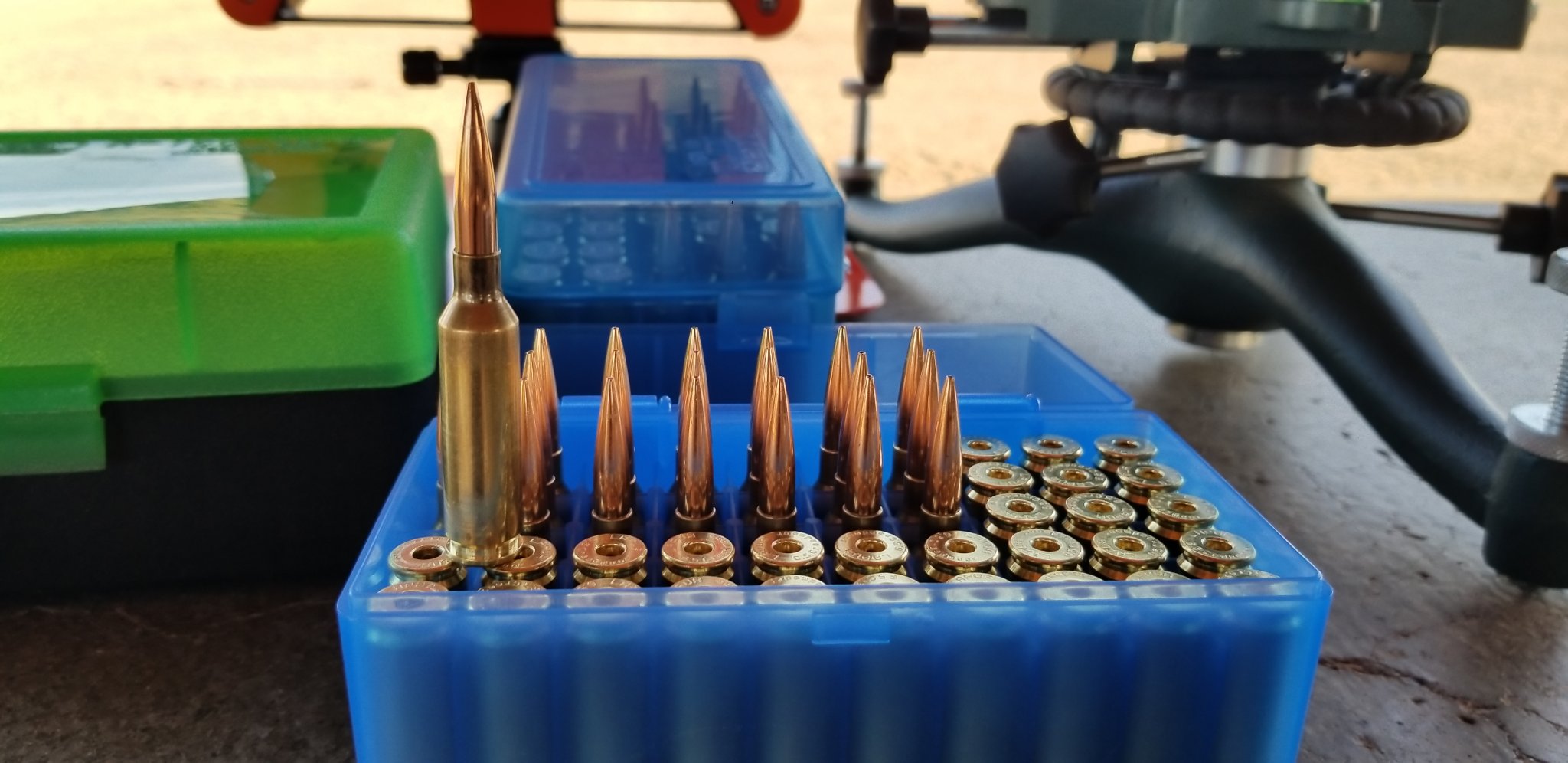

Just starting to load for 6 Creedmoor.
Alpha large primer brass (new)
40.5 grs Hodgdon H4350
Berger 105 Hybrids
CCI BR-2 primers
24" 7.5 twist barrel
2964 fps averagee
9.5 S-D
I seemed to luck into a very accurate node. I might play a little and see if I can find a good node that's a little faster though.

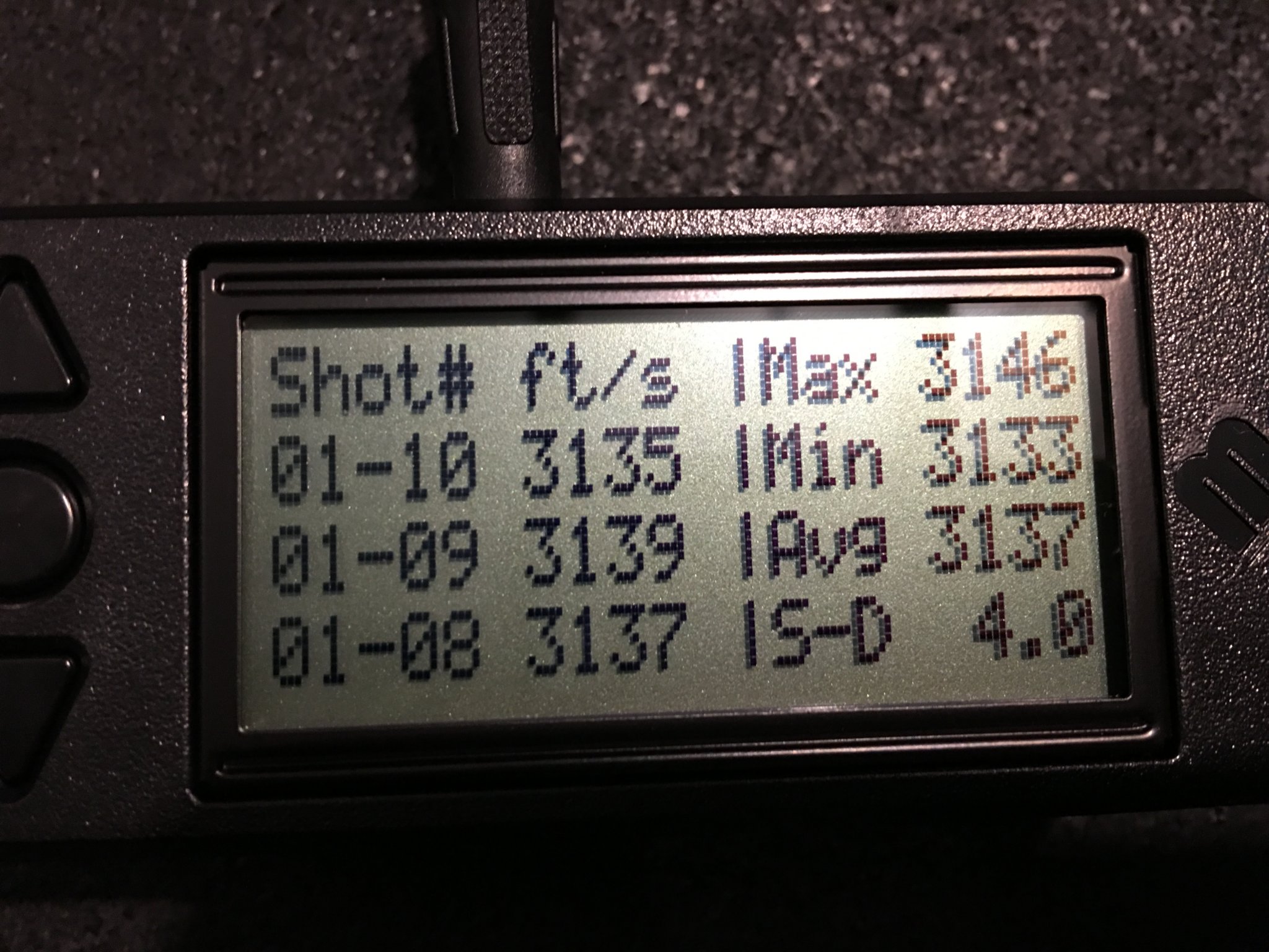

I just ran up a velocity ladder test to see what this rifle was capable of running H4831sc. I’ve got a 28” Bartlein 7.5 twist and here are my results with 110 SMKs and Peterson brass. Slight pressure signs as 45gr.
42gr- 2940fps
42.3gr- 2953fps
42.6gr- 2968fps
42.9gr- 3018fps
43.2gr- 3051fps
43.5gr- 3053fps
43.8gr- 3098fps
44.1gr- 3117fps
44.4gr- 3120fps
44.7gr- 3144fps
45gr- 3172fps

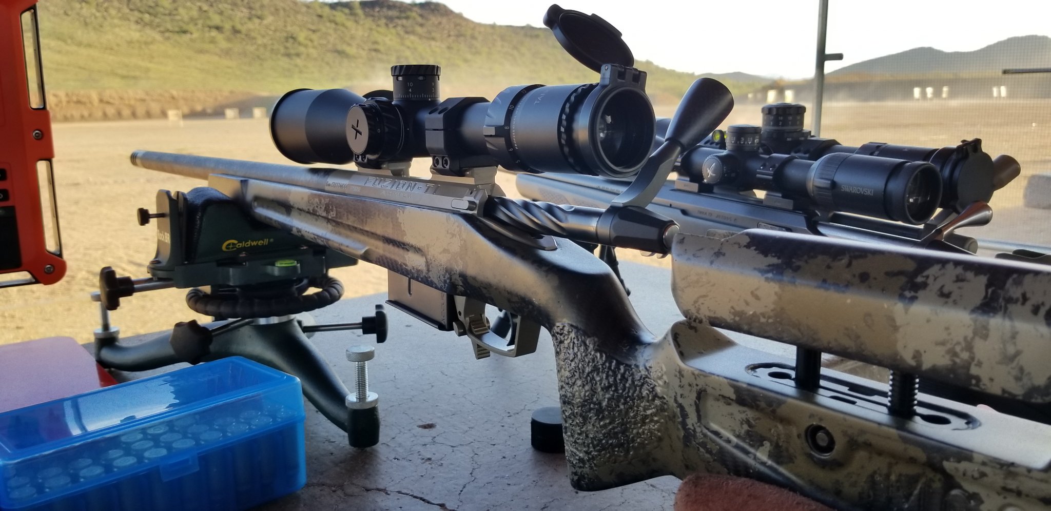

Just shot my new Axisworks built 6CM yesterday.
Lone Peak Fuzion TI SA DBM
TacOps carbon fiber bolt knob
24" Proof Research Sendero 1:7.5"
Axisworks 3 port brake
Manners Elite PRS2 in Tac Swamp
Axisworks SOL DBM w. AI mags
Trigger Tech Diamond @ 6oz
All metal in Cerakote Elite Sand
Seekins alloy 30mm medium rings
Tangent Theta TT315M 3-15×50 w. Gen 2XR MIL
Lapua SP brass
Fed GM205M
41.0-44.0 H4350
105 Hybrid
Had speeds.from 2950 to 3200 with no pressure. Everything except the 1st group with the cold/clean/new shot was under .5", and had two great groups in the .2-.3s.
42.0 = .240" @ 3056
44.0 = .302" @ 3200
