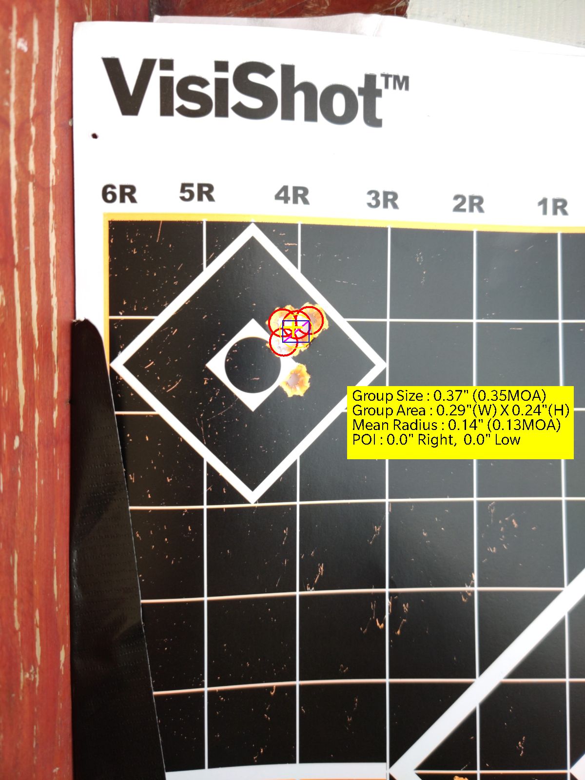

Did you Chrono them?Thanks for the info guys shot yesterday @.01off , 40.6 gns h4350 gave me 1/2” at 200yds for 5 shots
20 shots to find the load didn’t even bother to shoot the remainder of the charge weight test
Just curious what brass did you use? Seems like low charge weight for the 6mm.Thanks for the info guys shot yesterday @.01off , 40.6 gns h4350 gave me 1/2” at 200yds for 5 shots
Damn well those are pretty good numbers.

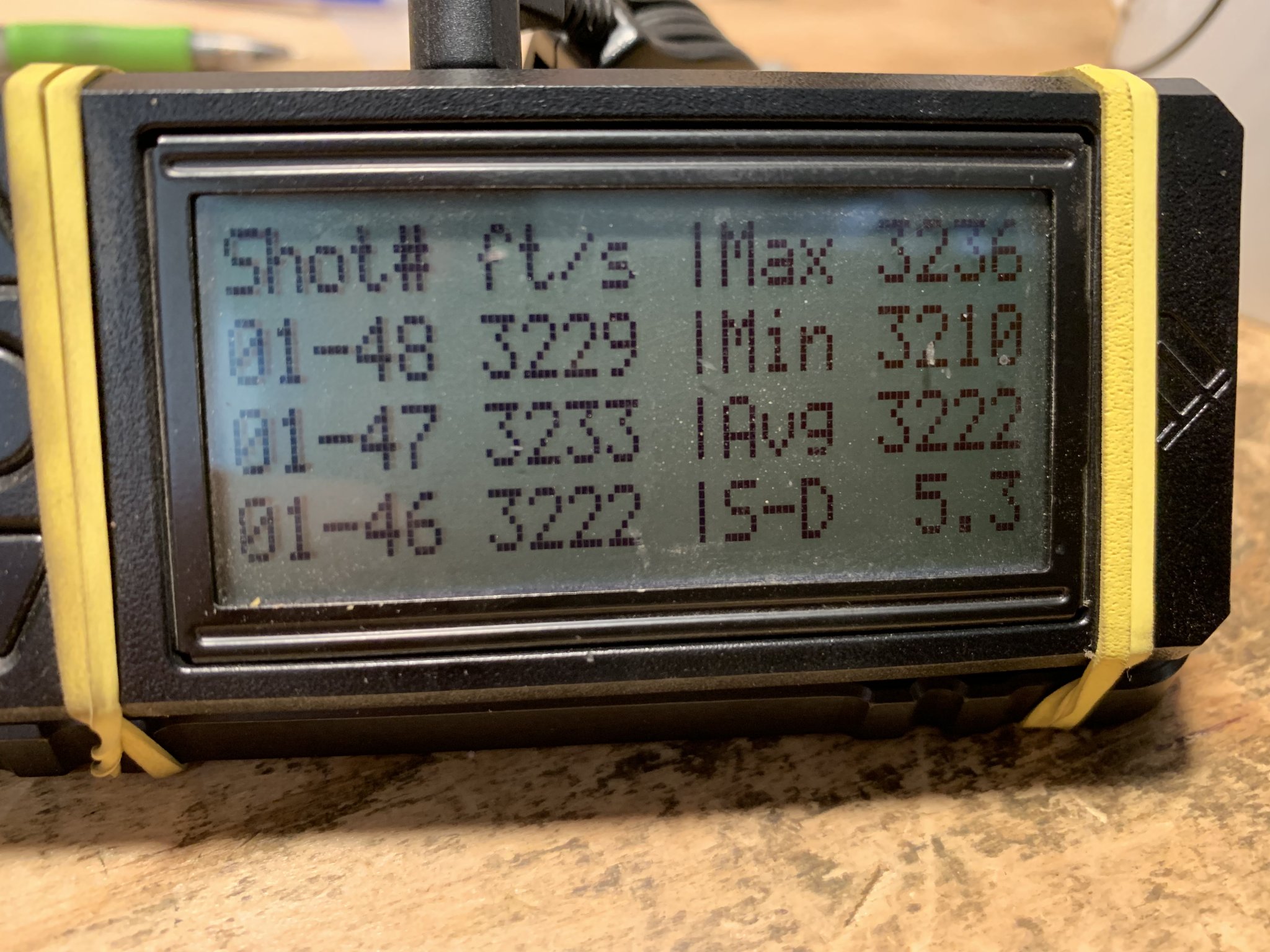

I ended up chasing speed and going with 42.2gr H4350 with great accuracy. Averaging 3230 out of my Havak PH1... after these next 100 rounds I’m going to see what the lower node is with 4350. I’m guessing around 3030 as that’s what the Hornady 108eldm and I’m blown away by the accuracy from factory while also having SD in the low teens.

I’m still running mine over 3200...648 rounds and dying by the round...hoping to get 2 more matches out of this barrel
What’s wrong with your Magnito speed? Mine has run spot on. For velocity and plugged in to a ballistic calculator. Run out to 1200 yards on multiple rifles.I’d much rather back off to 3000 FPS & have a barrel that will likely last at least 1750 rounds.

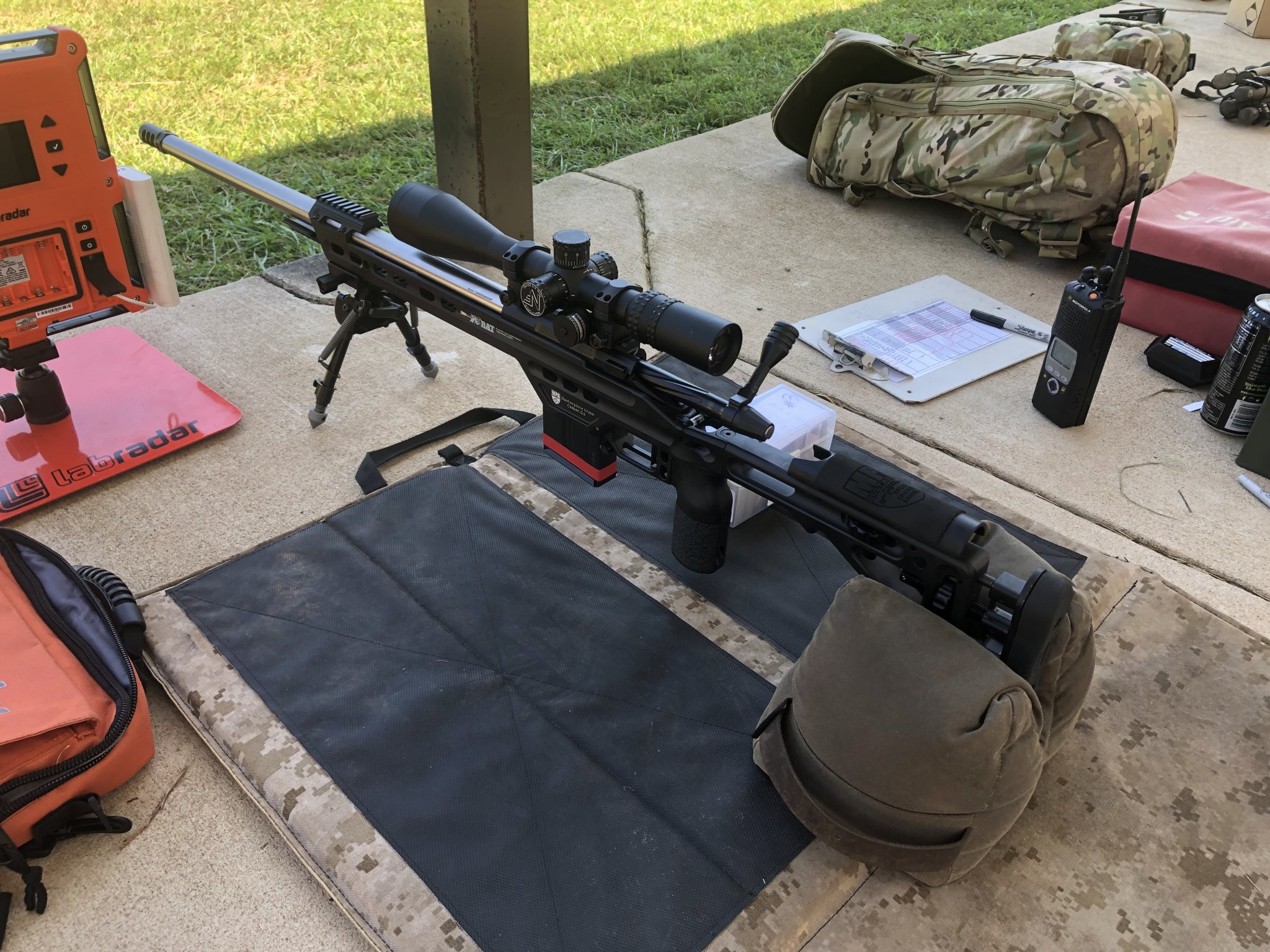

Was using a Magnetospeed on a spigot mount and a Labradar side by side for the first 50 rounds or so before I was ready to throw the Magnetospeed in the trash, I’m 100% selling that thing.
Ladder testing at 300...
Pretty much pointless for finding vertical nodes...
