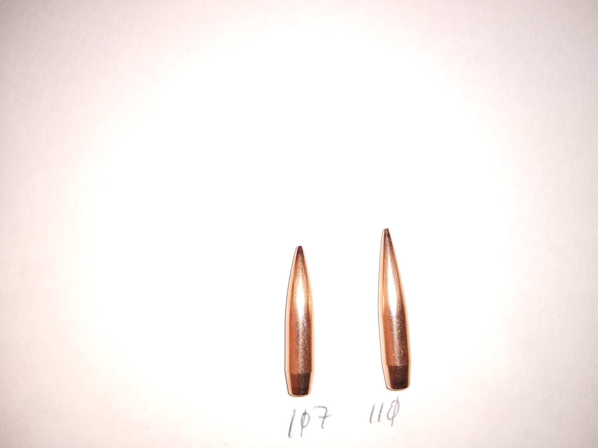

I picked up some 107's and 110's. The 110 is only 3 grains heavier, or 2.7 percent, yet it is 11 percent more efficient based on the ballistic coefficients. Looking at the 110 you can see there is quite a bit more material ahead of the bearing surface than on the 107.
Reactions: Strike_out

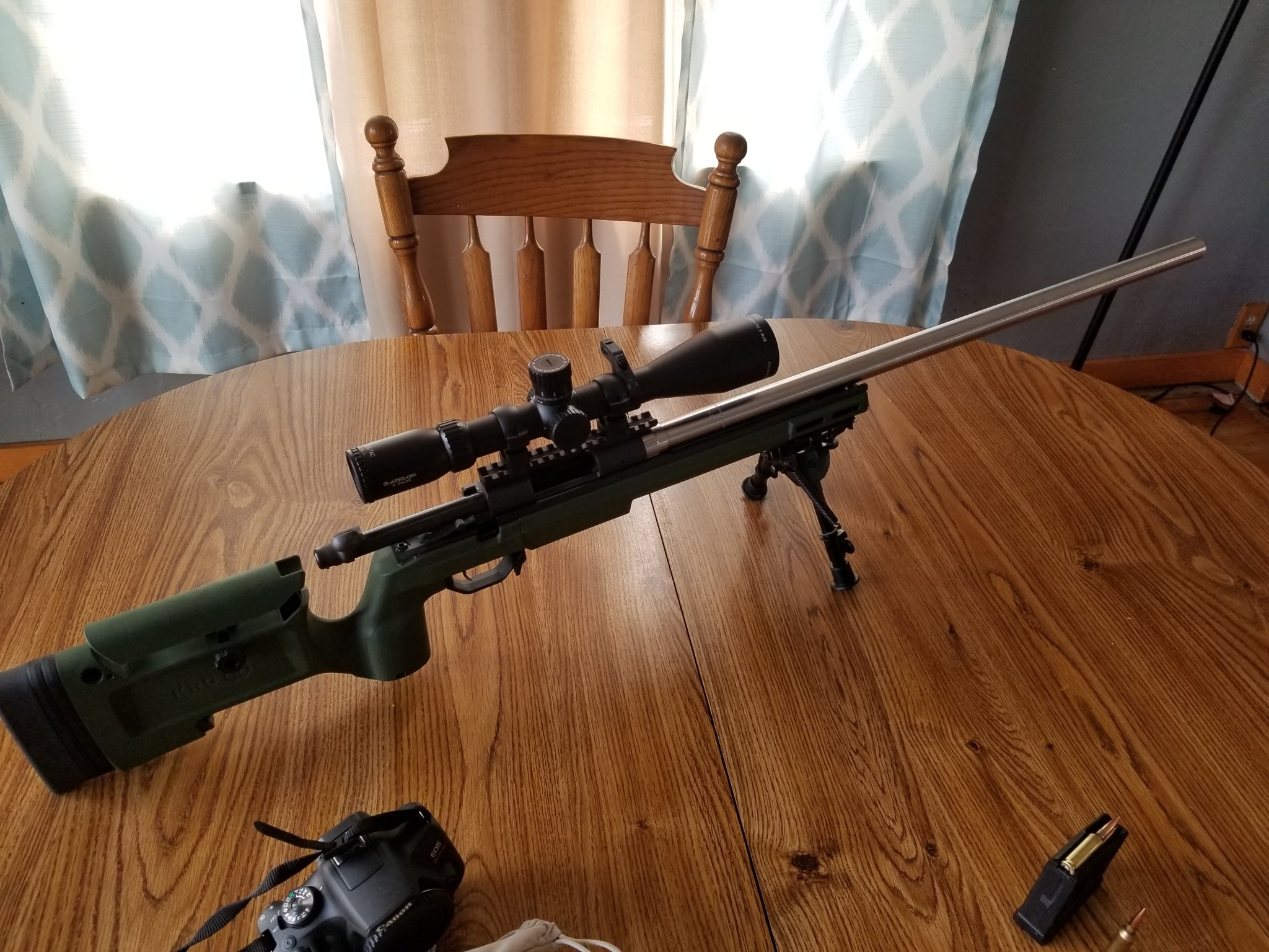

Pic of my rifle
Rem 700 action
Krg bravo
28" criterion prefit
Athlon midas tac
Egw 20moa base
