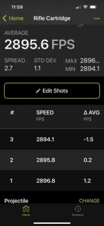

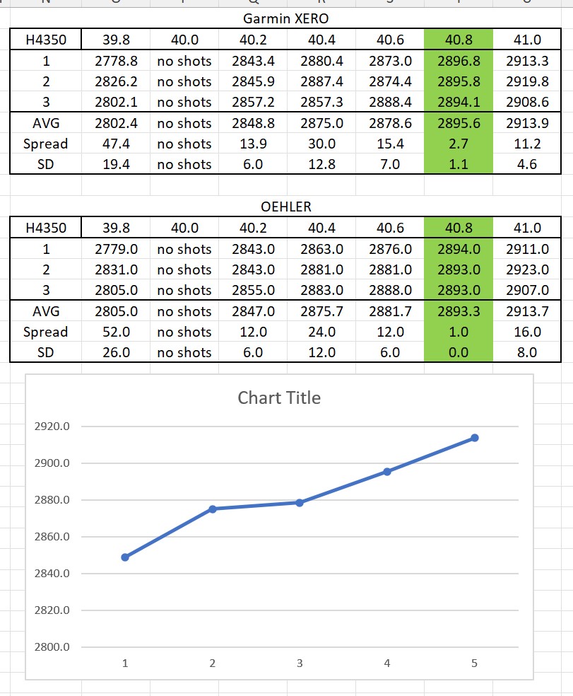

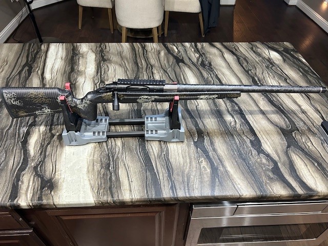

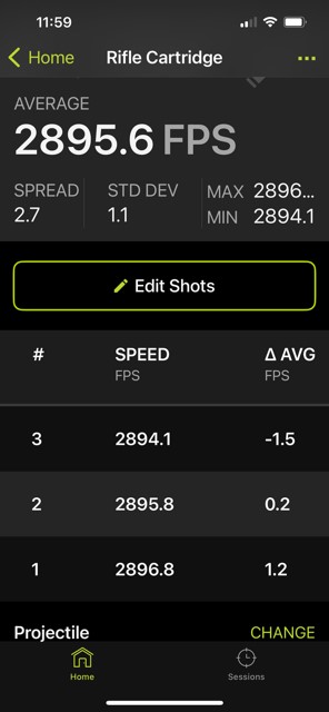

New lightweight hunting 6cm build Zermatt TL3 w/ 22" Proof CF barrel in MCS Pro Hunter.
Tested a load of H4350 from 40.0 to 41.0 in 0.2g increments.
Berger 115 VLD Hunting, Lapua SRP brass, BR4 primer, @ 2.800" jumping about 0.065"
Shots 1-18 through barrel, no cleaning or break in. Only 3 shot strings but 40.8g looks promising @ 0.240" measured. 41.0g same size.
Data collected using a Garmin XERO and an old school Oehler - very agreeable.

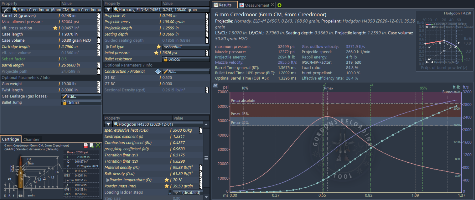

FWIW, I GRT'd it using my peterson case capacity. You're about 80 fps short which may close as the barrel speeds up. The simulation puts max at 41.6 and 62k psi @3100 fps, which is right about the hornady book max (41.7/3050) as well.
Thanks again.
Yeah, I would expect the barrel to speed up some as it only has 65 rounds on it now. 80 FPS might be asking a bit much though.
I usually find that I have to add about 30 FPS when I true velocity at 600-650. We shall see. I still have 170 pieces of virgin brass to play around with before I try to settle on a load anyway.

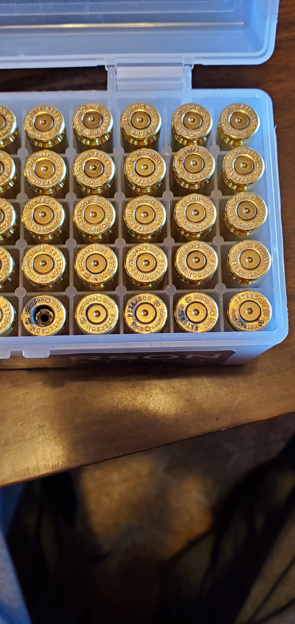

Here's my brass and velocities at 41g H4350 and 108 ELDM...May have figured out the issue is the WLR primers from a few guys on here. If you look at all the other pieces of brass, there's zero issues. Primers look fine, no cratering, no gas marks, no ejector marks, no heavy bolt lift. This was also on a 35 degree day.
Anyways, I'm now at 40.2g for right at 3000fps and 1/2 MOA from a 27" barrel...Pretty slow for a 27" tube but I guess it is what it is...

39.5 gave me acceptable accuracy in Peterson SRP brass, and there were zero pressure signs. My 6CM attempt a few years ago I used Hornady brass and 41.0gr of H4350, igniting it with CCI-BR2s. I wish I had a few more of those BR2s on hand these days.
I got a bit overly cautious I guess with this Peterson brass as I ran into significant pressure issues in my 6.5 Grendel going from Lapua to Starline brass (not relevant, but now I start low with new brass manufacturers). I was chewing up brass a full grain below book max off of Vihtavouri and Hodgdon. It is that whole "once bitten, twice shy".
Twist?
Learned my lesson on using cheap RCBS dies yesterday. The seating stem kept grabbing and holding onto my 109 hybrids...soooo I just substituted some 107gr SMK in their place until my new dies come in. However, I have zero idea how far I am to the lands, so my seating depth test today was a complete shot in the dark.
Serves me right for being cheap 😄.
Found a decent window where I'll be exploring further. I just used a nominal charge of 40.0gr H4350.
- Virgin Peterson brass
- CCI 450
At this point I'm pretty certain I'll just load to 2.215 (approximately 2.765 COL) and let it be for a while. Probably not even worth screwing with a powder charge test. Unfortunately, I didn't bust out my chronograph...but based upon my recent 108gr ELD-M results, I'm probably somewhere in the 2,925ish range unless my barrel is starting to speed up. It has 115 rounds on it now.
I guess I'll load a few more up and see how it does if I add a little more speed to it.
