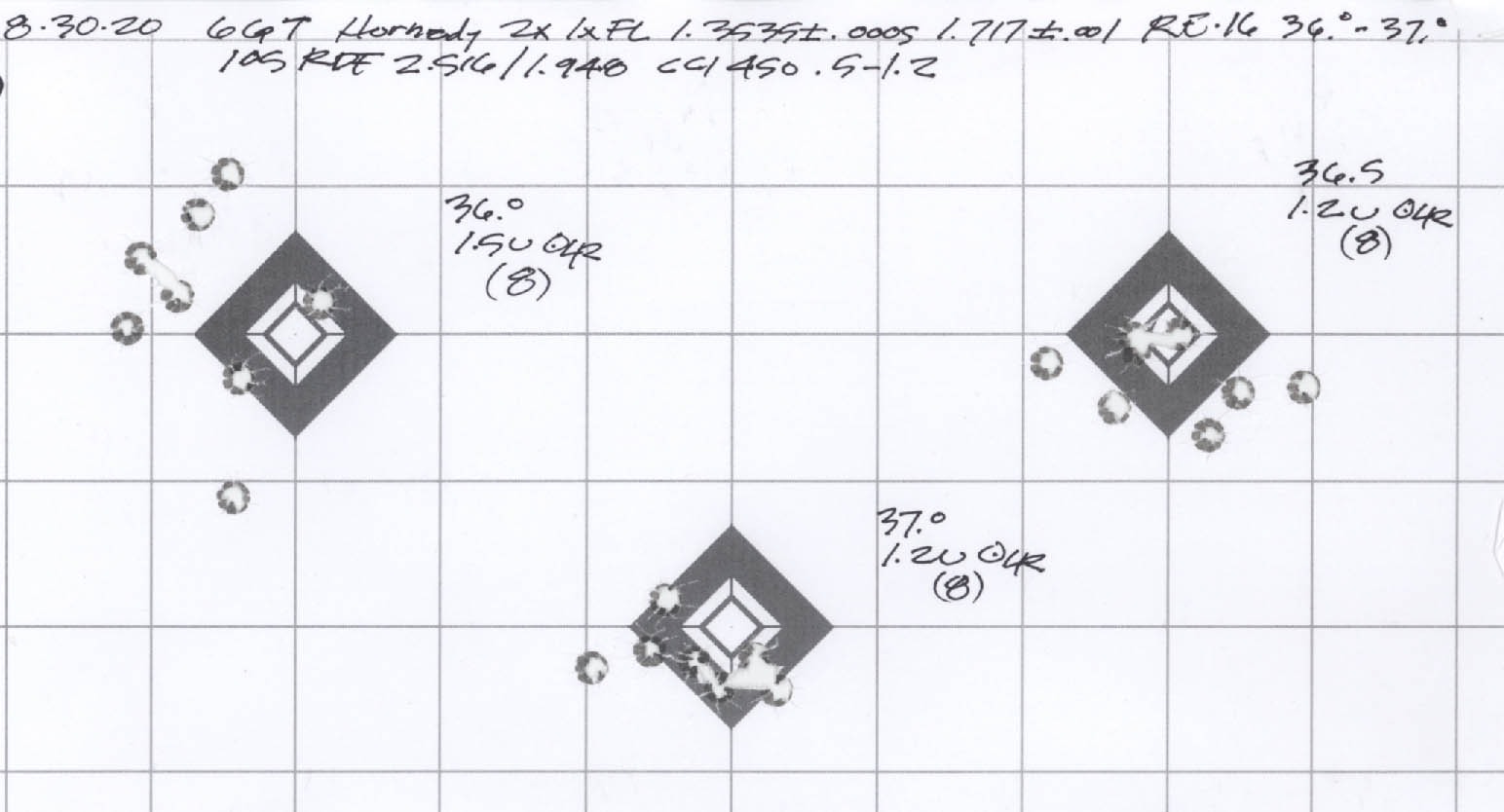

Yes indeed, 37.0 of Reloder 16 looks verrrry promising with 105s, if a bit fast.
Pic 1
200 yard 8 shot groups of 36.0, 36.5 and 37.0.
37.0 is obviously good, but MV was 3010. No obvious pressure signs, but will definitely check for pocket looseness on the next loading.
Previously tested loads are still doing great.

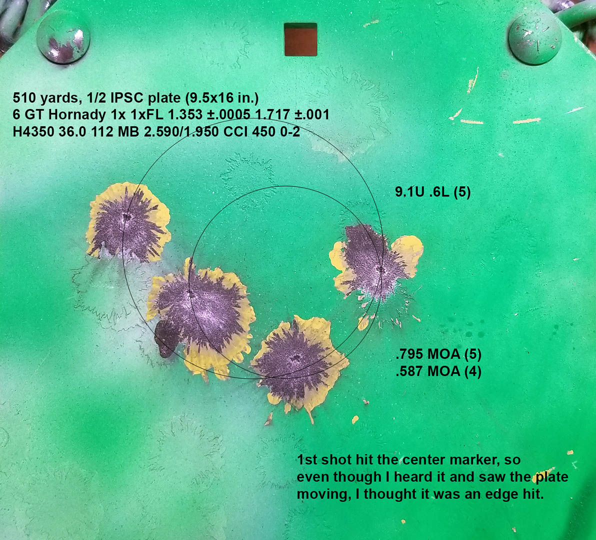

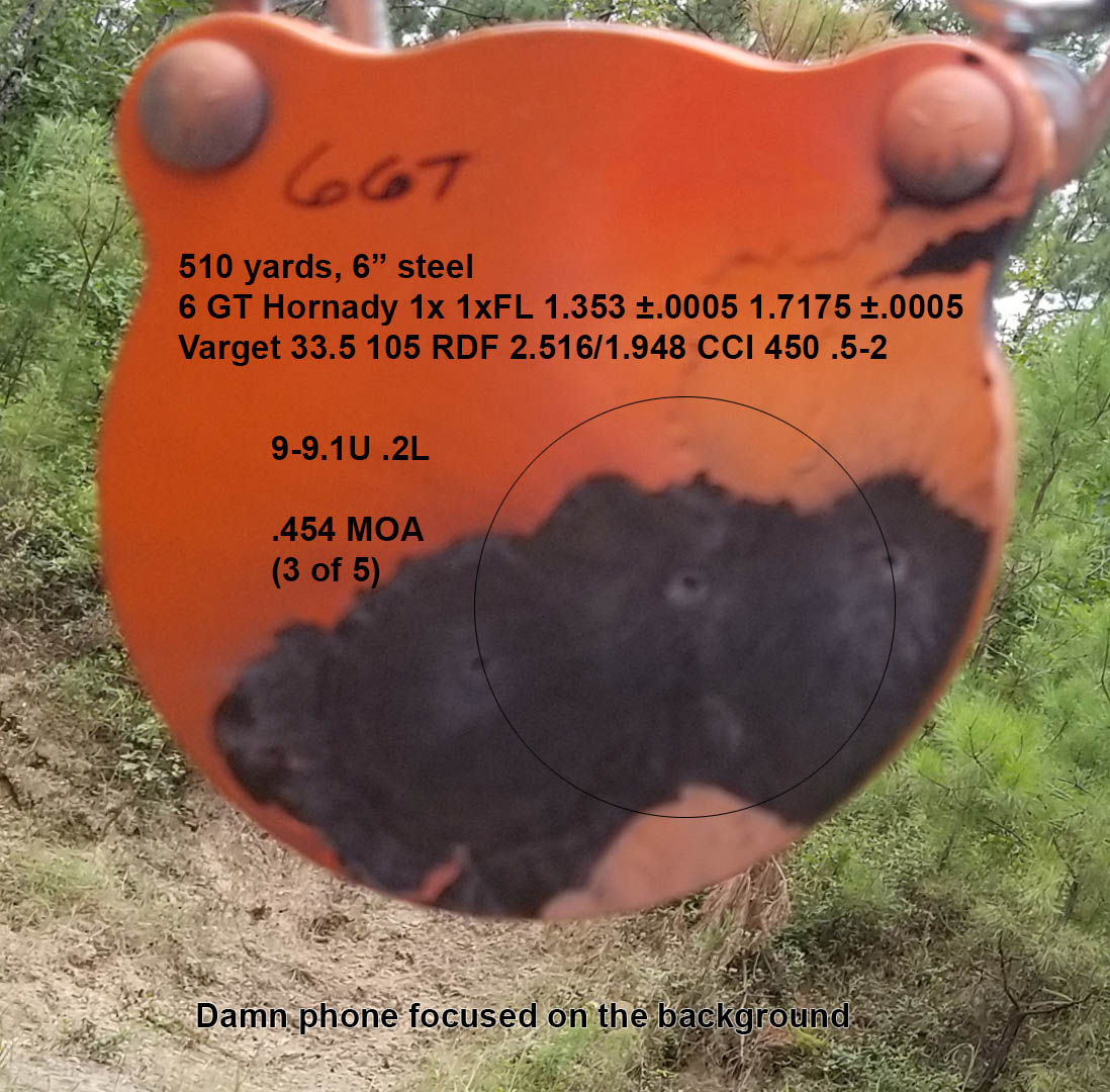

300 yard group with 36.0 of H4350 behind a Barnes 112 MB was looking awesome . . . until I yanked the fifth shot. @#$%^&! Same load was also okay on 510 yard steel. MV was 2900. Note to self: get more 112s, cut back on the crystal meth coffee.

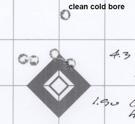

200 yard group showing the clean cold bore DOPE change.
400 and 510 yard groups on steel with 33.5 of Varget behind a 105 RDF. 2950 MV.
All loads with 1x or 2x fired Hornady brass, FL sized with .267 bushing. CCI 450 primers. Bipod and rear bag on a bench. ~3-5 mph 9 o'clock wind, ~90 degrees F, 75% relative humidity, near sea level.

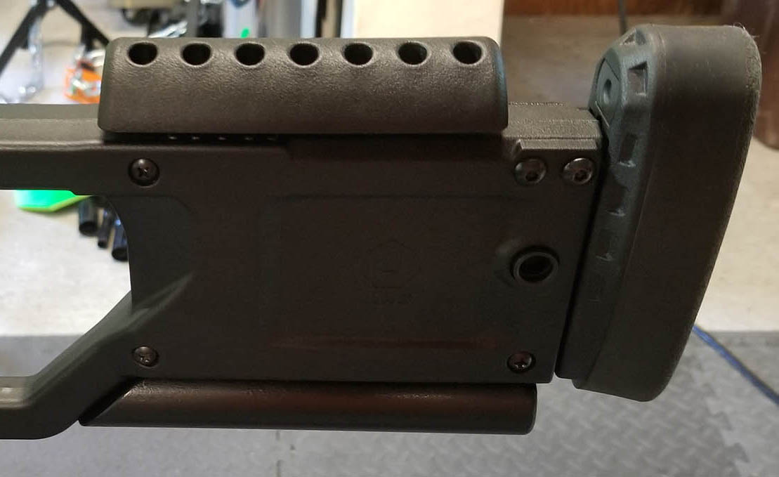

I also made my own 'Mark & Sam' style steel bar bag rider for the KRG. Seems to help.

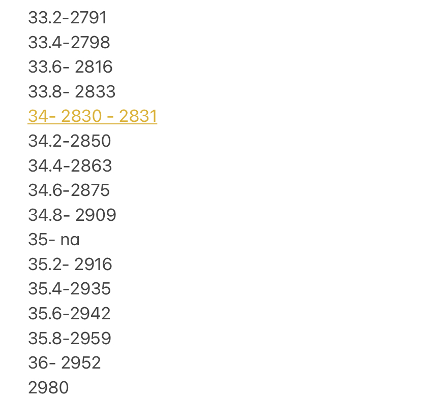

Varget gave me some pretty big nodes that I’d be fine shooting in. I think any of these charges would have shot well. This was my data. I didn’t find pressure until closer to 3000. Obviously yours may be different as you test.

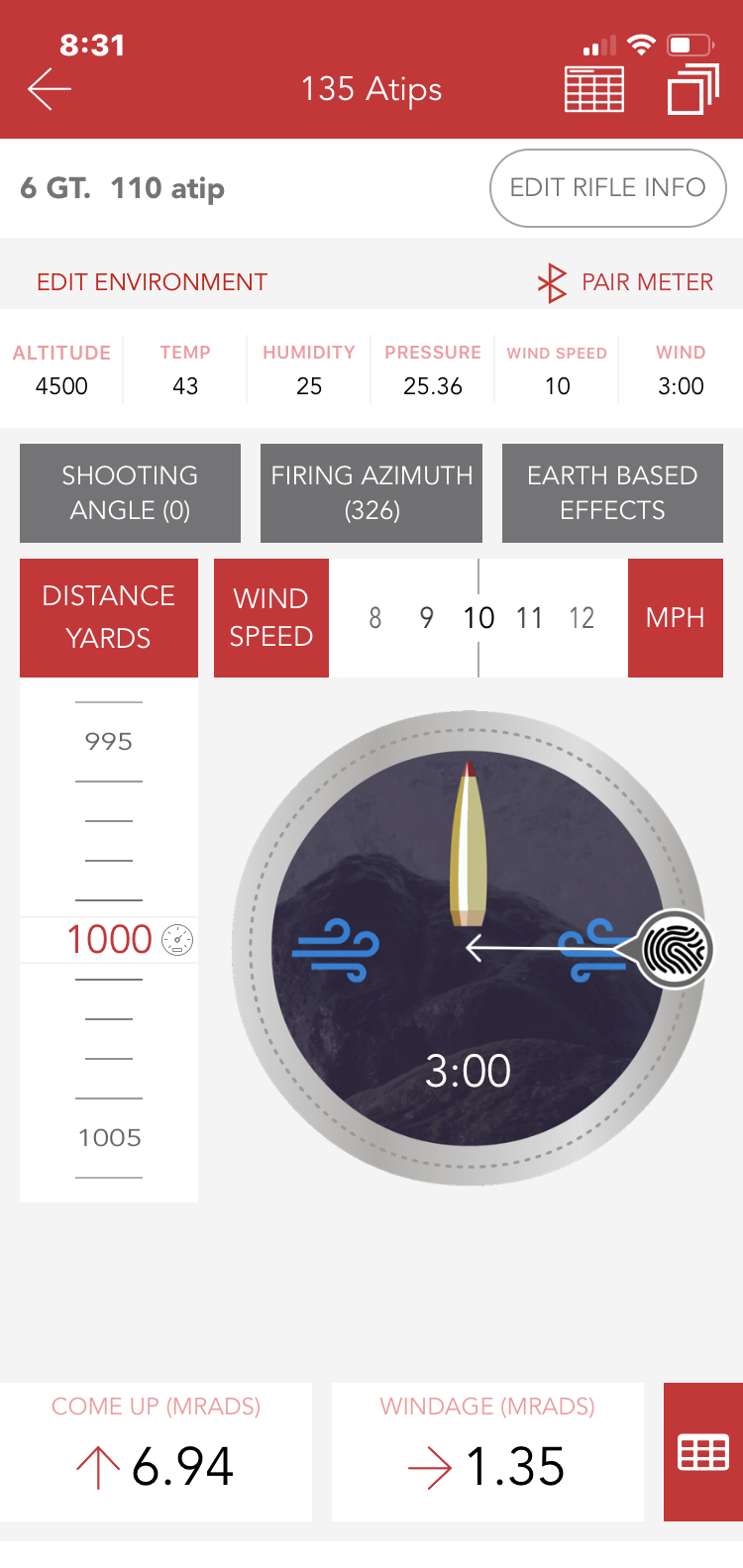

ATips are slightly better than 109’s but not better enough to justify double the price IMO. My first load I developed with the 6GT was with Atips and my load for the 109’s was the same charge weight and same speed. There was only .1 difference at 1K so I went with the 109’s at half the price. Have gone through 4 different lots and they’re very consistent.

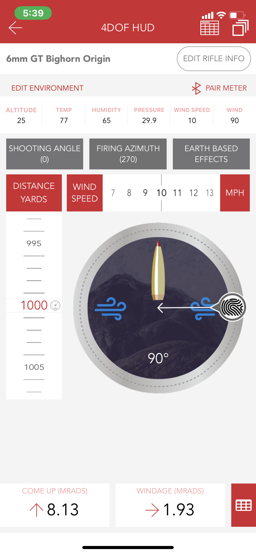

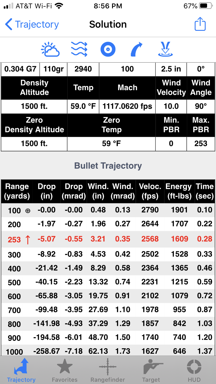

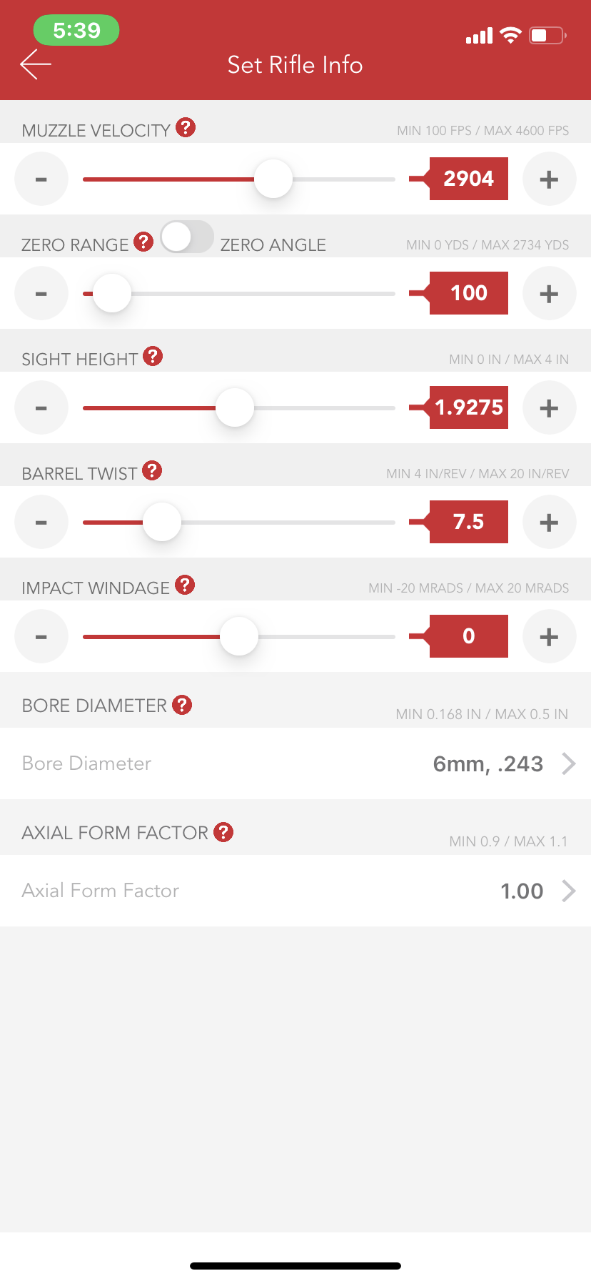

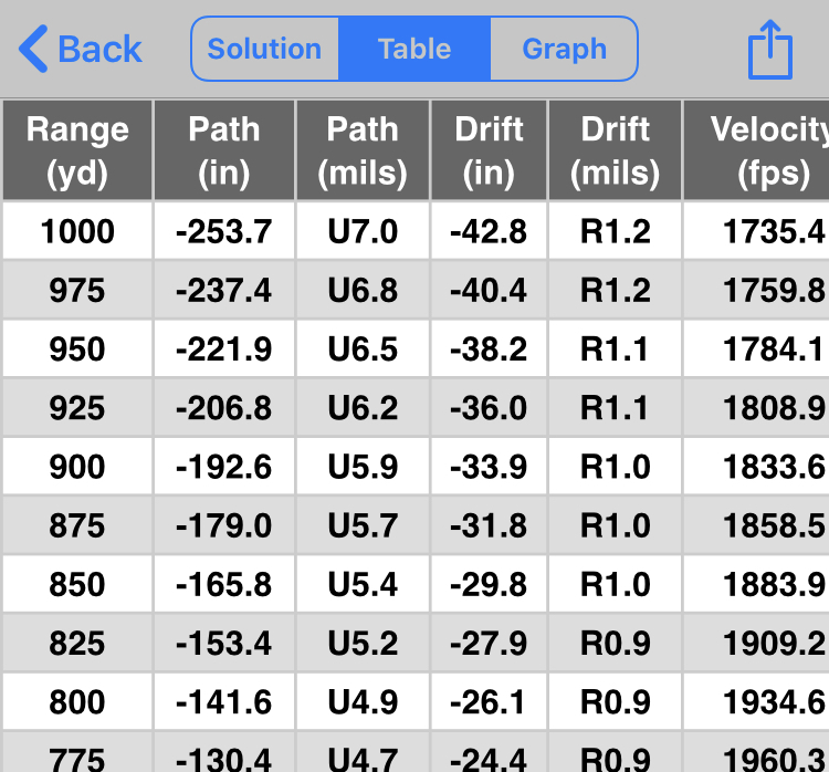

I get 7.6 and 2.0 when I punch that in.
I'm probably at a higher elevation. And I'm using a 9 o'clock wind with a right twist barrel. Not a 3 o'clock wind. There is some offset in spin drift between the two wind directions.
You have 0.7 mils of spin drift at 1000 yards? Do you have a 1:4" twist barrel?
not wrong samb300... come here and shoot it
I’ve shot A-Tips at 2840fps out to 1350 and can assure you those numbers make no sense.
If I take 2940 fps and crank the DA up to 13,000 ft it brings the windage needed way down, but also drops the elevation needed way down to 6.2 mils as well. Can’t have 7.0 mils of elevation and 1.2 mils of wind unless your calculator has the wrong wind, or some crazy coriolis and aerodynamic jump.

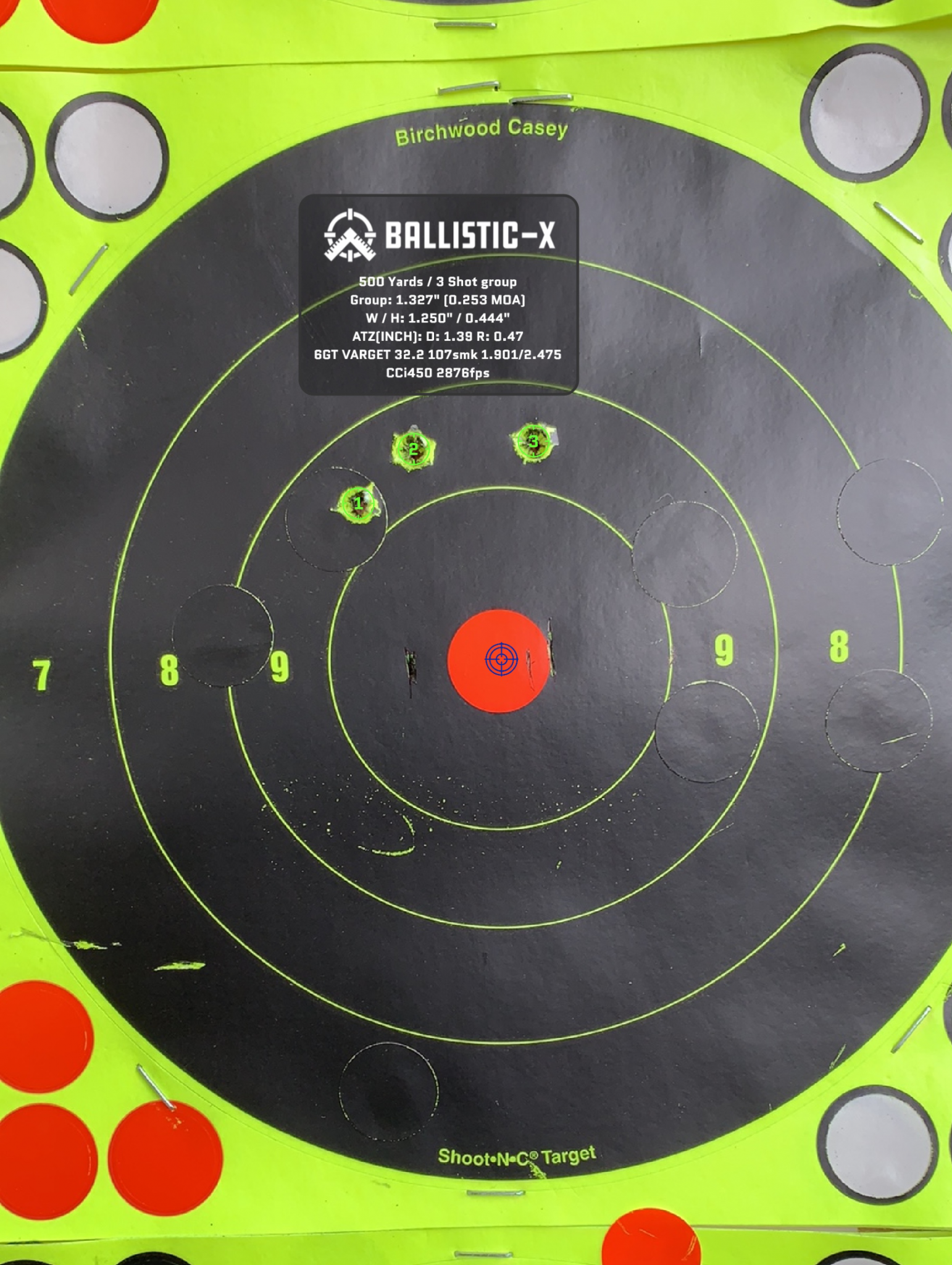

I shot a few rounds today to confirm zero and to check the point of impact at 500 yards. Some might think 0.065 off is a lot but, after reading the series of articles on Precision Rifle blog about seating depth I am a believer. I am consistently getting less than an inch of vertical at 500 but, have not been able to test out further (max is 500 at the range I belong).

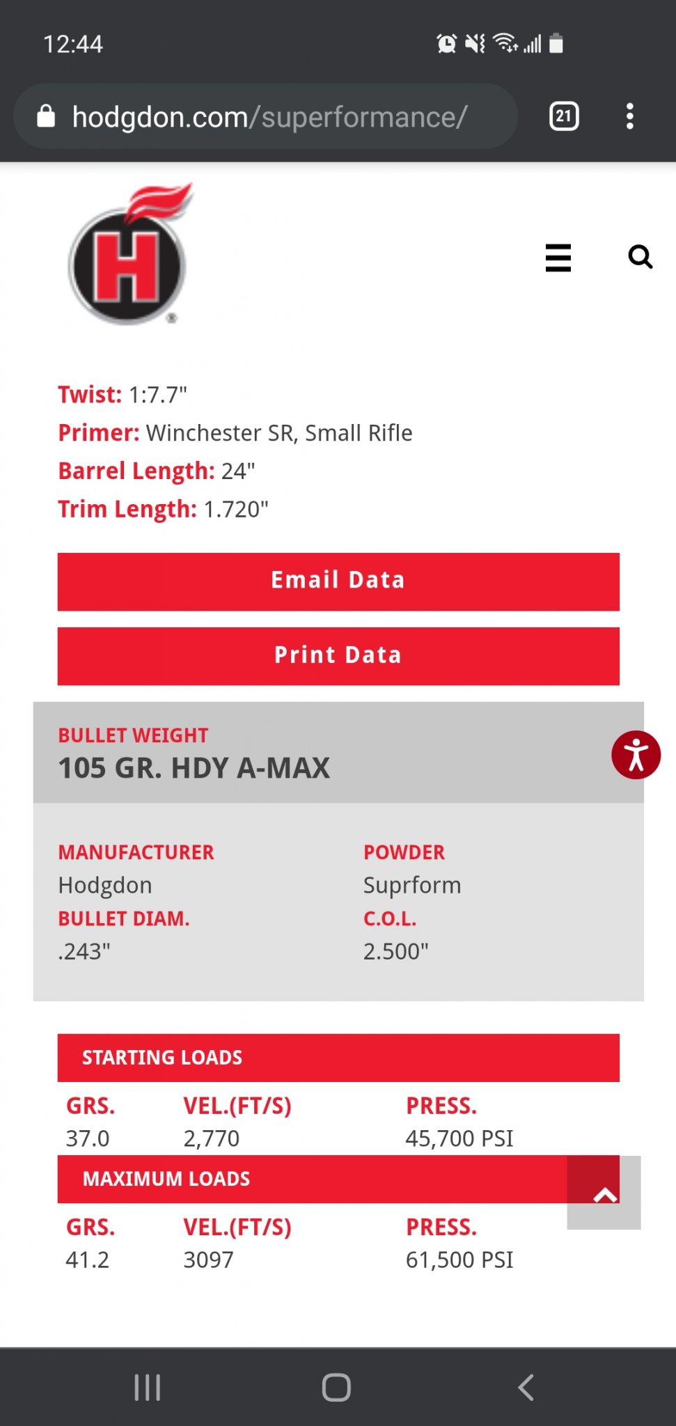

Has anyone tried the Hodgdon Superperformance? I've got a bunch so I might give it a go when I get everything together. It did well in my creedmoor. Screen shot shows load with a 105gr bullet.
