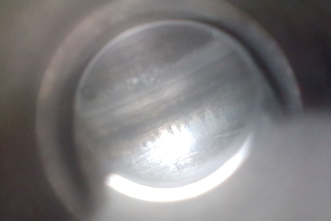

This is a pic of the chamber with the first 30rds fired after a chamber cleaning. I don't see any major carbon issues and I'm pretty diligent on cleaning the carbon out of my chambers to avoid getting a carbon ring. Especially after a bad experience I had with a Creedmoor.

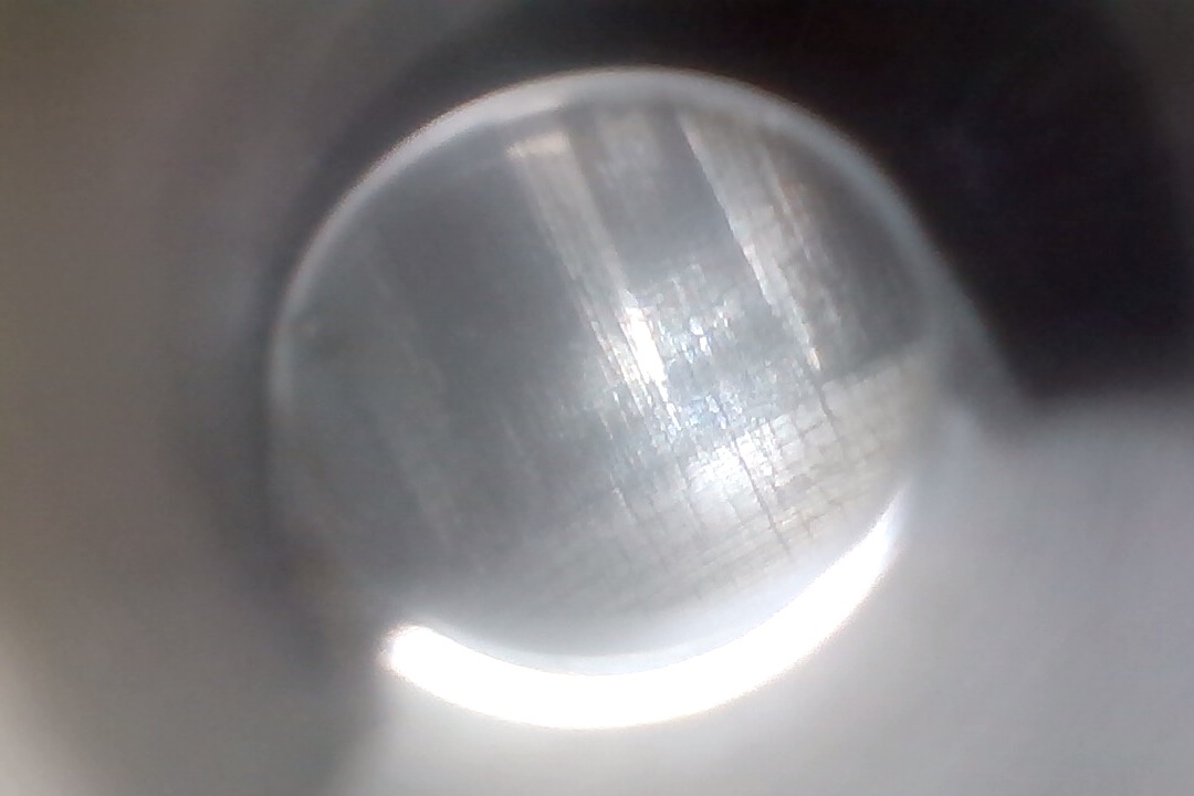

This is a pic of the rifling after 650 rounds on the barrel.

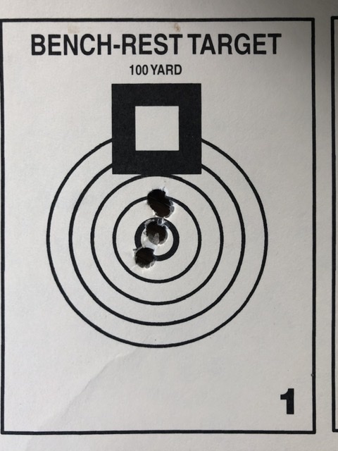

Switched out my proof barrel for a Bartlien 4 groove and all I can say is WOW!. What a difference. Gun just seems to shoot whatever I put in it. Only have 30 rounds down the barrel now but the gun is grouping incredibly well, even while cleaning between rounds and just using a random mild load for break in. My proof barrel that I took off was quite picky and finicky, to be honest. Glad to get some confidence back.

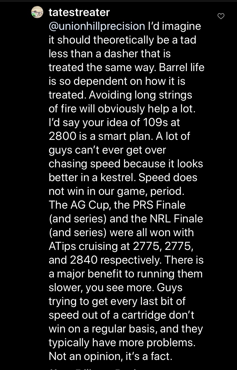

He said 2775 twice.
So why not just shoot a BR?
I’d imagine 1: it’s 110 a-tips. Straight BR might get a little hot pushing them 2775-2800 unless a 28”+ barrel. And 2: he was running 6bra. So it’s just load and shoot a match or practice for Fireforming. Might as well have the option to run faster if you want when it’s that easy.
I’m personally running a dasher at 2800 or so. I have the option to go faster if I want, but I also have extra capacity so I know I’ll never be close to pressure at 2800-2850.
We put people on a pedestal and try to emulate them. Who knows? Maybe he just wanted to try something different like the rest of us. He probably still has the BRA and you may well find out he went back to it in a year.🤷‍♂️
Human nature. People are always looking for "the next best thing" or the "easy button/fix". People at the top of any game aren't immune to that, and in fact may even feel pressured and more inclined to act on that human trait in order to maintain or advance a competitive edge.
Let us know how the velocity ends up comparatively.

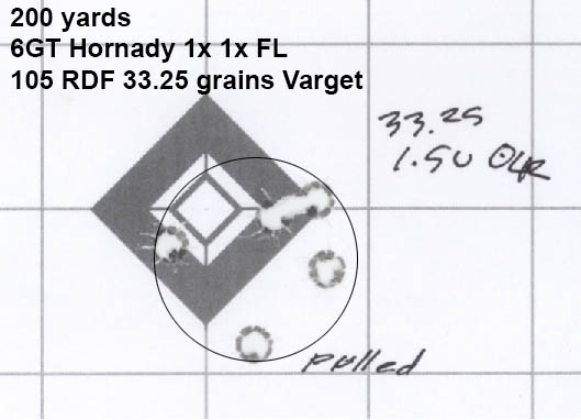

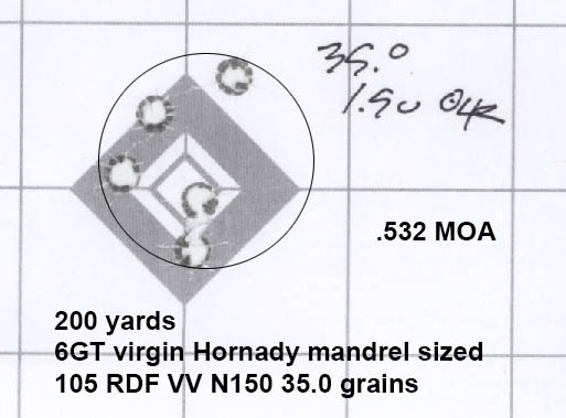

Some progress. Looks like 33.5 grains of Varget works well in yet another 6GT.
26" 7.5 twist Bartlein 5R HV
Tikka factory action and trigger
Area 419 Hellfire brake
All rounds fed easily from AICS mags
Bipod and rear bag on a bench
Little to no wind, ~95 degrees F, 70% relative humidity, near sea level
Loads tested with 105 RDFs
32-33.5 grains Varget
32-33 grains N140
34-35.5 grains N150
Loads tested with Barnes 112 MB
34-35.5 grains N150
36-36.5 grains H4350
No pressure signs on any of the loads.
All targets at 200 yards
1-2. 33.25 and 33.5 grains of Varget CCI 450
105 RDF 2.516/1.948 COAL/CBTO .020 off lands
1x fired Hornady brass, FL sized with .267 bushing*, bumped .0005 back, 1.718 trim
3. 35.0 grains of VV N150 CCI 450
105 RDF 2.513/1.945 COAL/CBTO .023 off lands
virgin Hornady brass, mandrel sized, 1.717 trim
4. 36.0 grains of H4350 CCI 450
112 Barnes MB 2.590/1.950 COAL/CBTO .024 off lands
I'm betting this load will do better. The horizontal stringing is me having too much coffee on a too hot day.
*I had to use the .267 bushing because my .268 bushing is actually .269 and bullets did not have enough neck tension to stay in place. Whidden die and bushings. Kind of disappointing since the Whidden dies produced a batch of 50 with a maximum of ±.001 runout. Most were 0.
I'm going to work up more of the best loads for longer range, and chronograph testing . . . maybe. It was just too hot to f#(k around with it last week.
