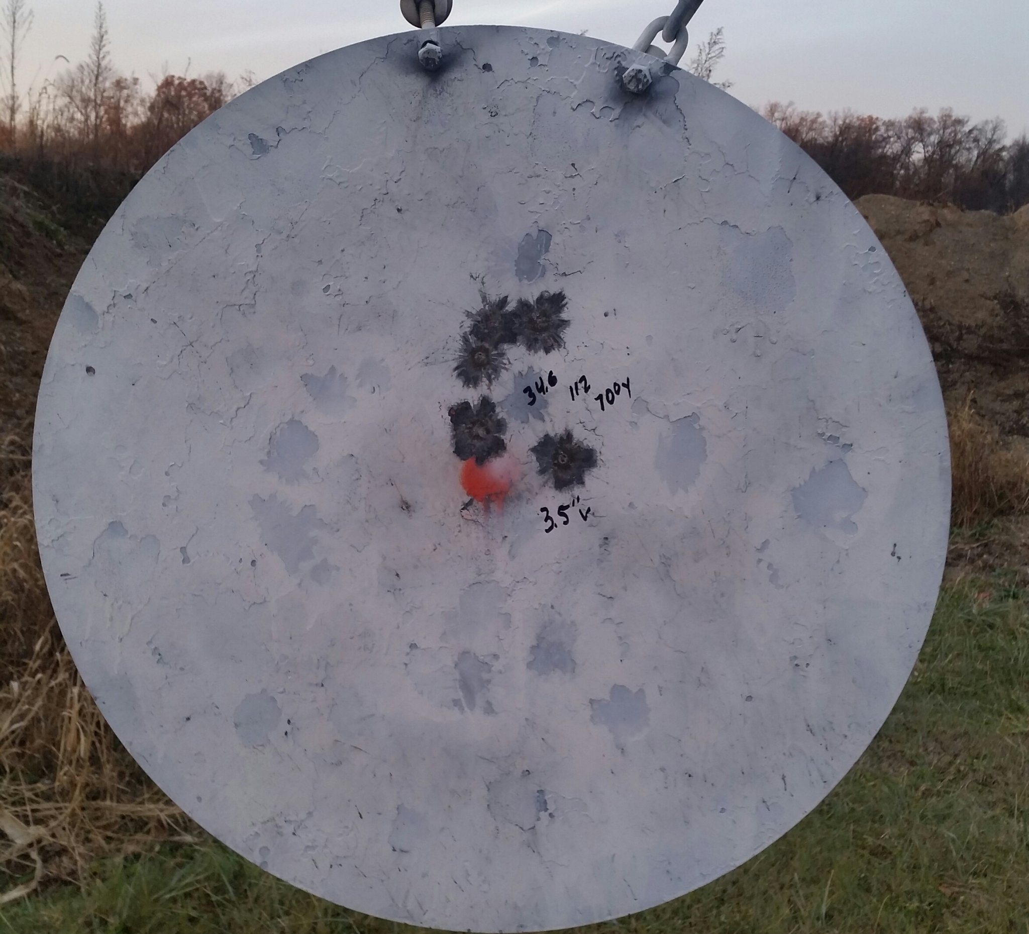

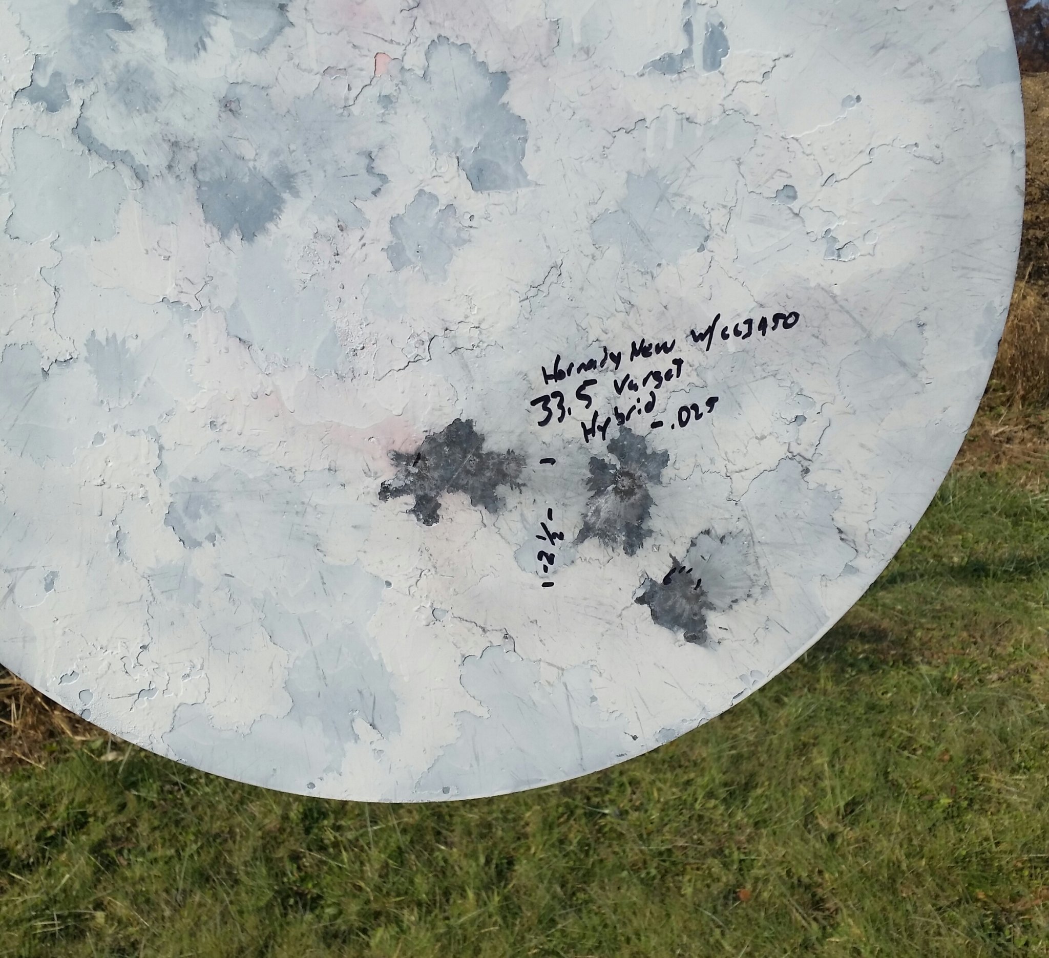

@NorCal Vu your 33.5gr varget shoots well in my barrel as well, 700 yards 6 rounds 2.5" vertical.

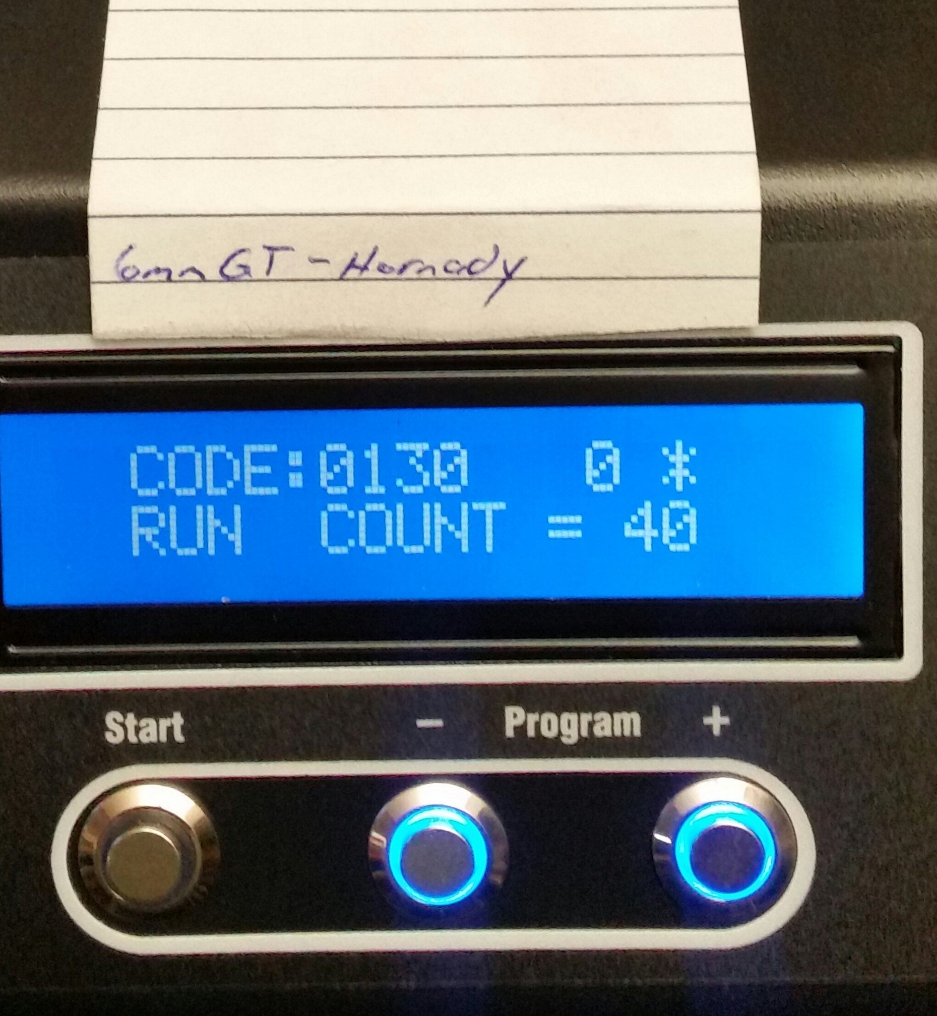

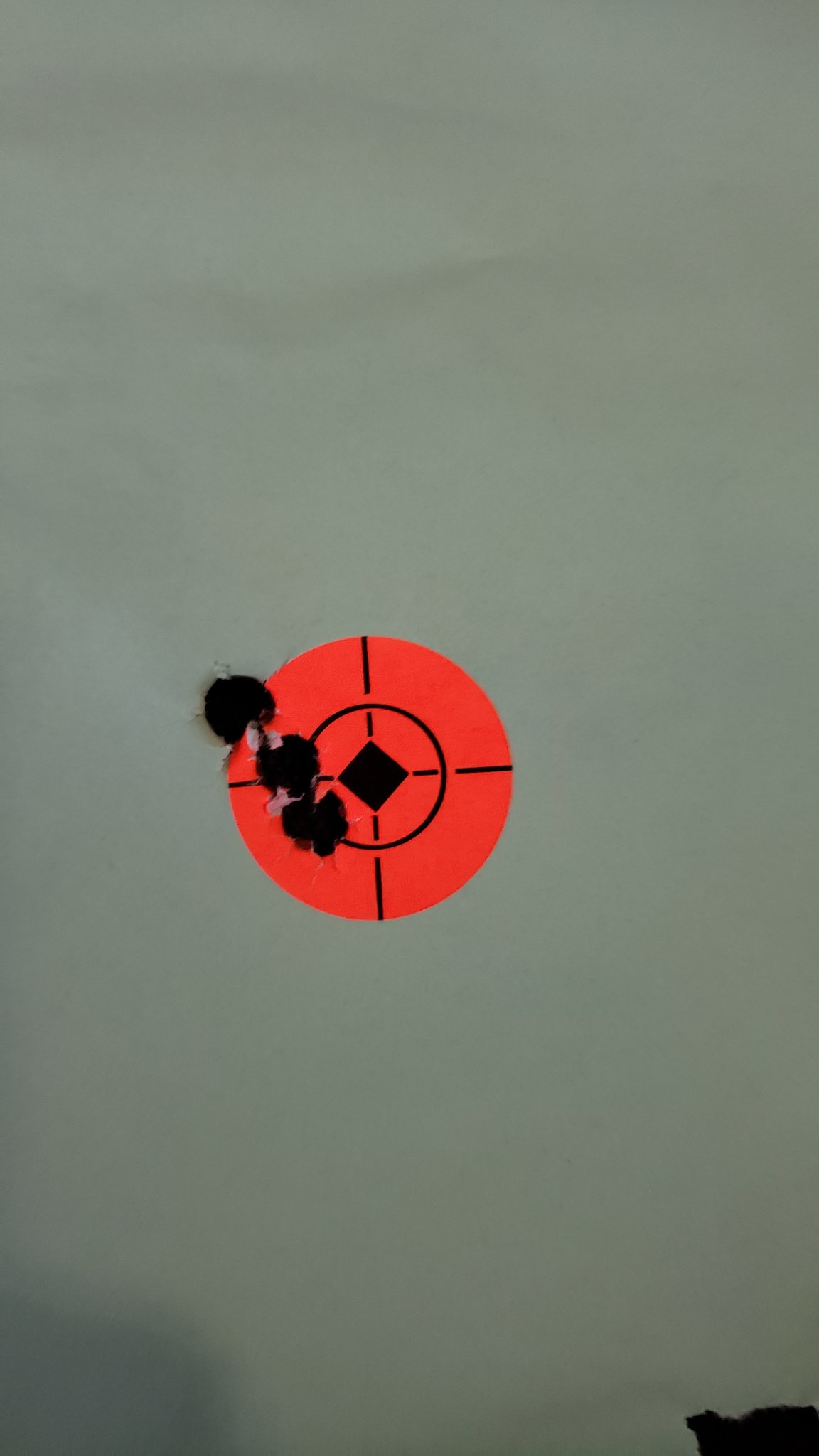

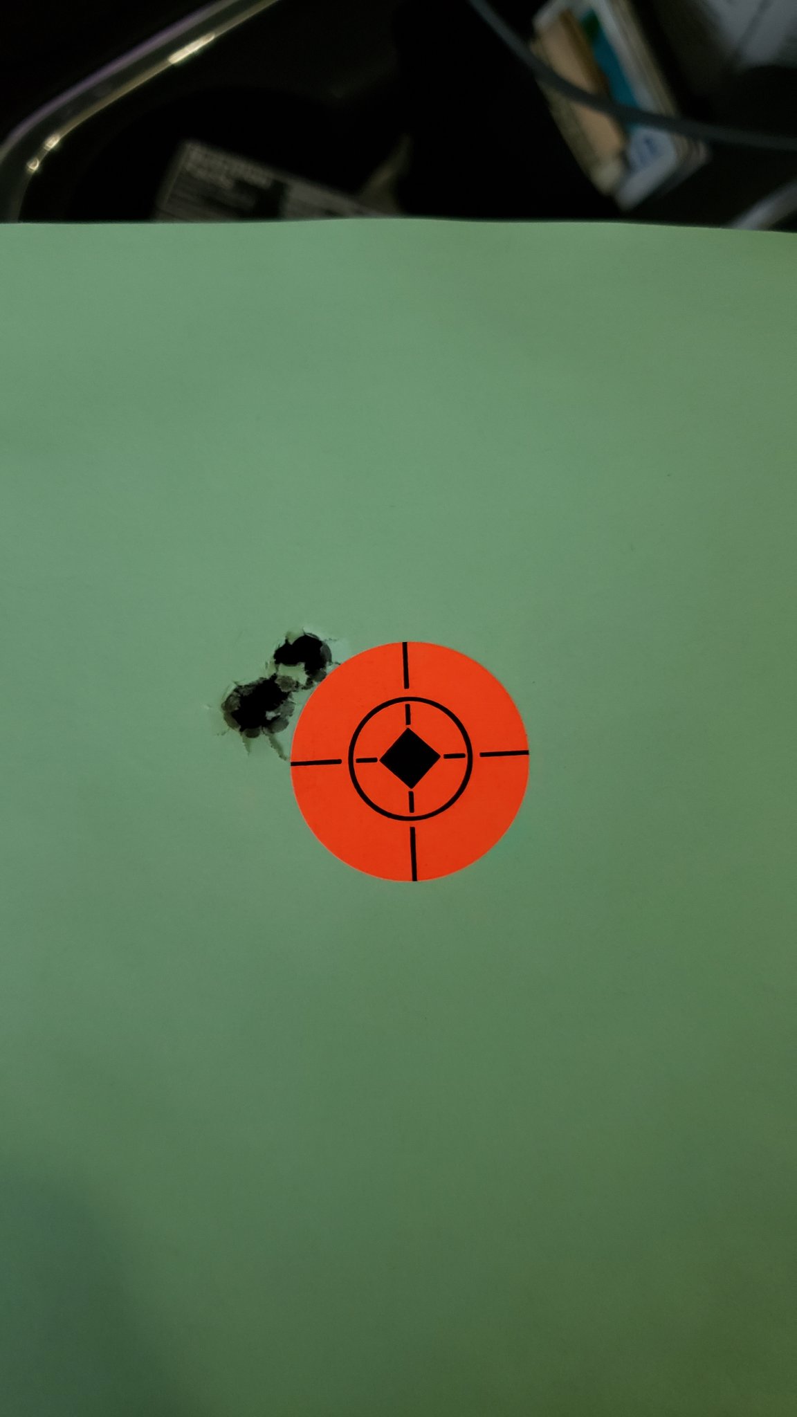

Working up at 200 yards, one inch dots, barrel is still settling in per my velocity swings just prior to these so I wouldn't read to much into ES. Also, lower right says 40, it should read 37 ;)

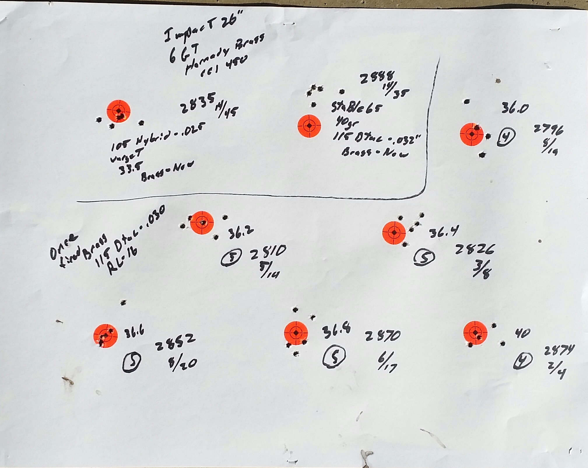

@reubenski my test target was a mess today, likely me but there appears to be a node in the 37.5-37.7 area, 37.6 had me doing 2948. 38 grains gave me 2977.
I also narrowed down my lower velocity node to 36.4 or 36.5. I shot 3 groups of ten 36.3, 36.4 & 36.5 and I'm pretty sure my barrel sped up at 36.4 as my ES was huge and it showed on the 700 yard plate. 36.5 settled back down with 5.75" of vertical for ten shots, see below. Velocity on that group (unfired hornady brass)
2859 sd5/18es
Compression can be heard when loading anything above the mid 36 grain area with RL-16 and that's with a 7" drop tube. And while more prominent at 38 grains it still was seating to the same depth for all loaded rounds.
I'll be verifying both 36.4-36.6 & 37.5-37.7 at distance in the next few days.
Then I'll move on to test Stable6.5...
Reactions: reubenski

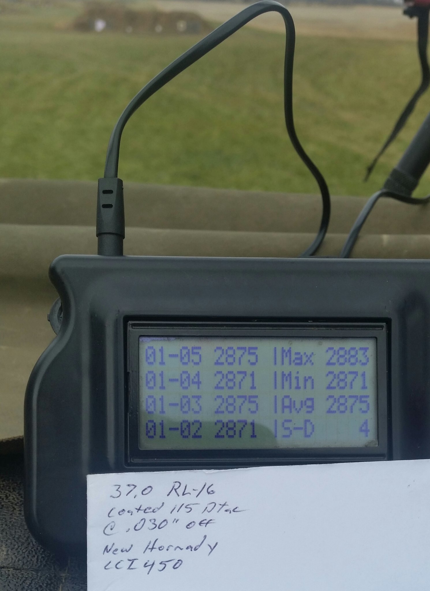

Data points with StaBall6.5 and Temperature stability in the 6mm GT case.
The load:
New Hornady cases, CCI 450 primers, 40.50 grains of powder, 115 Dtac's seated .030-.032" off the lands.
Procedure:
Ammo was exposed to temperature for 4.5 hours, then rapidly discharged within one minute of removal from each temperature source.
Because I was starting with a clean cold bore I discharged 5 rounds at 4 degrees, 3 rounds at 67 degrees and 3 rounds at 107 degrees. While some may call the number of rounds used into question, it still gives a baseline and I plan to follow up once I find the load I plan to use with this powder.
Results collected by magnetospeed:
4*
2937, 2951, 2923, 2951, 2939= 2940 sd11/28es
67*
2977, 2976, 2983= 2978 3/7
107*
2999, 2992, 2986= 2992 6/12
4 to 67 equal .6fps per degree.
67 to 107 equal .35fps per degree.
Confirmed my low velocity node today with RL16 and 115 Dtac's as 36.6 grains for 2871 sd 4/13 es. Looking at past targets and notes would place my high node at 37.7 with a velocity between 2948 (37.6) & 2962 (37.8)

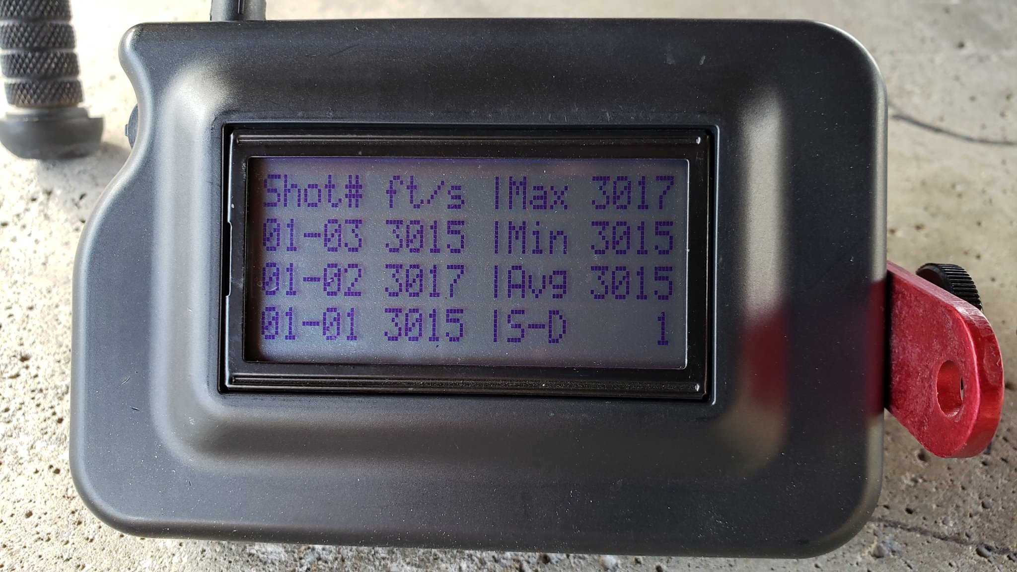

My load is 37 H4350 Berger 105 cci br2 hornady brass. 3015 fps. 200 yard groups.

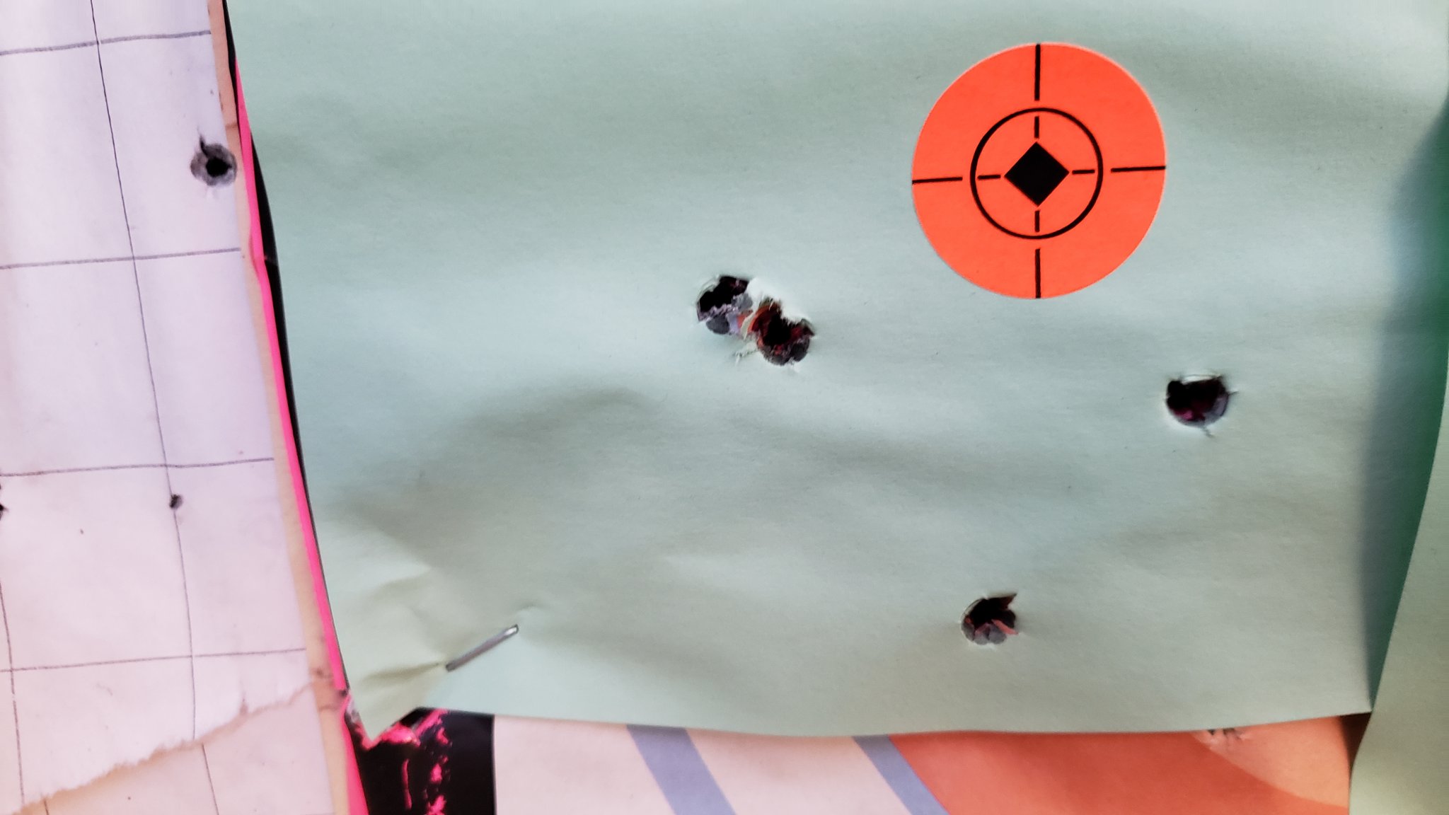

The new batch of 112's I can't get to shoot. Shot the 112 all last year and loved them. New batch are no good. Back to Berger's. Wanting on the 109's

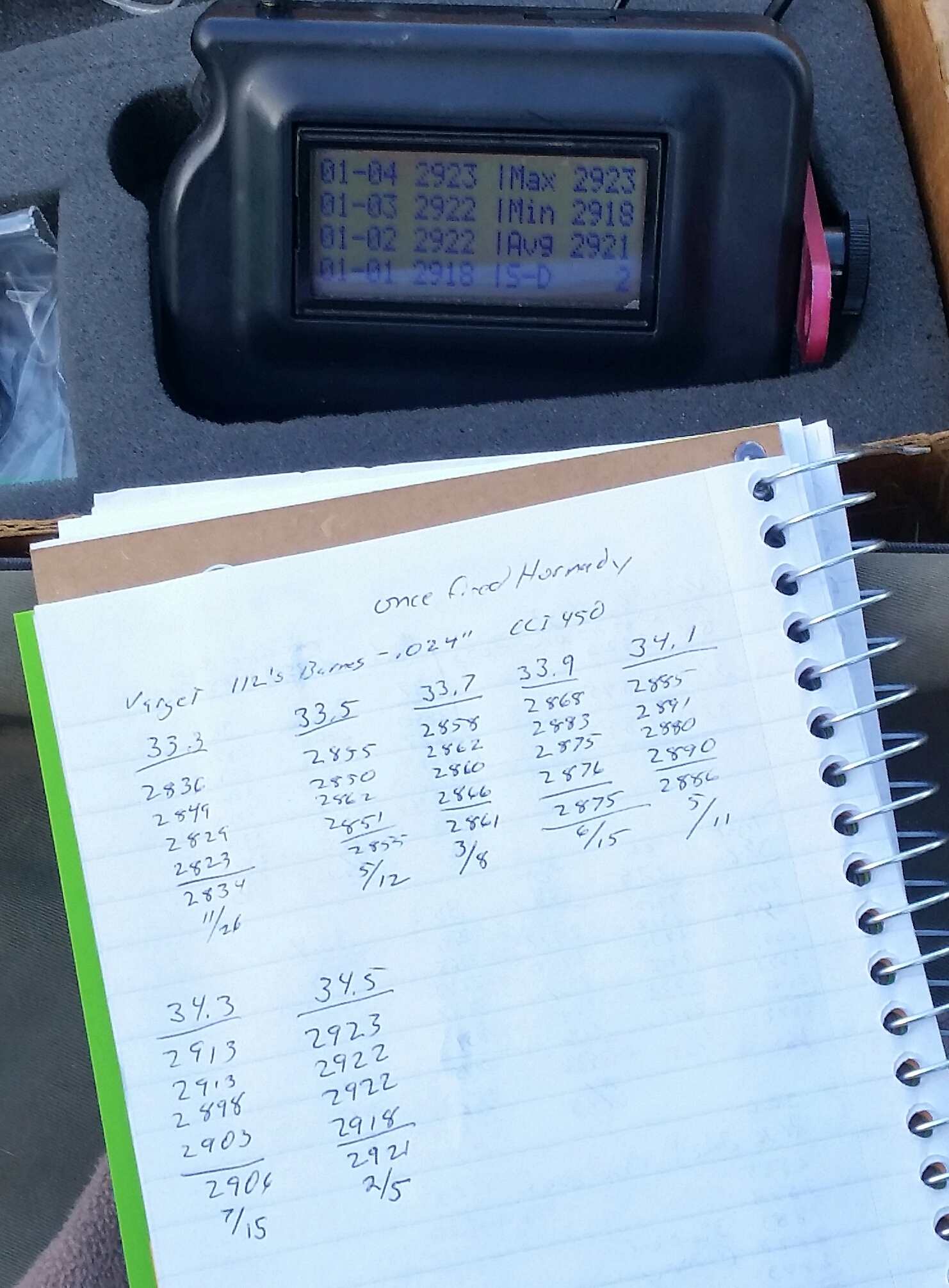

How new a batch are you talking? I just got 1000 rounds in from MidwayUSA last week. Loaded up some rounds with 33.2-34.0gr Varget and 38.2-39.0gr of Staball 6.5. Hoping it's an easy load development and I didn't waste my time/money.

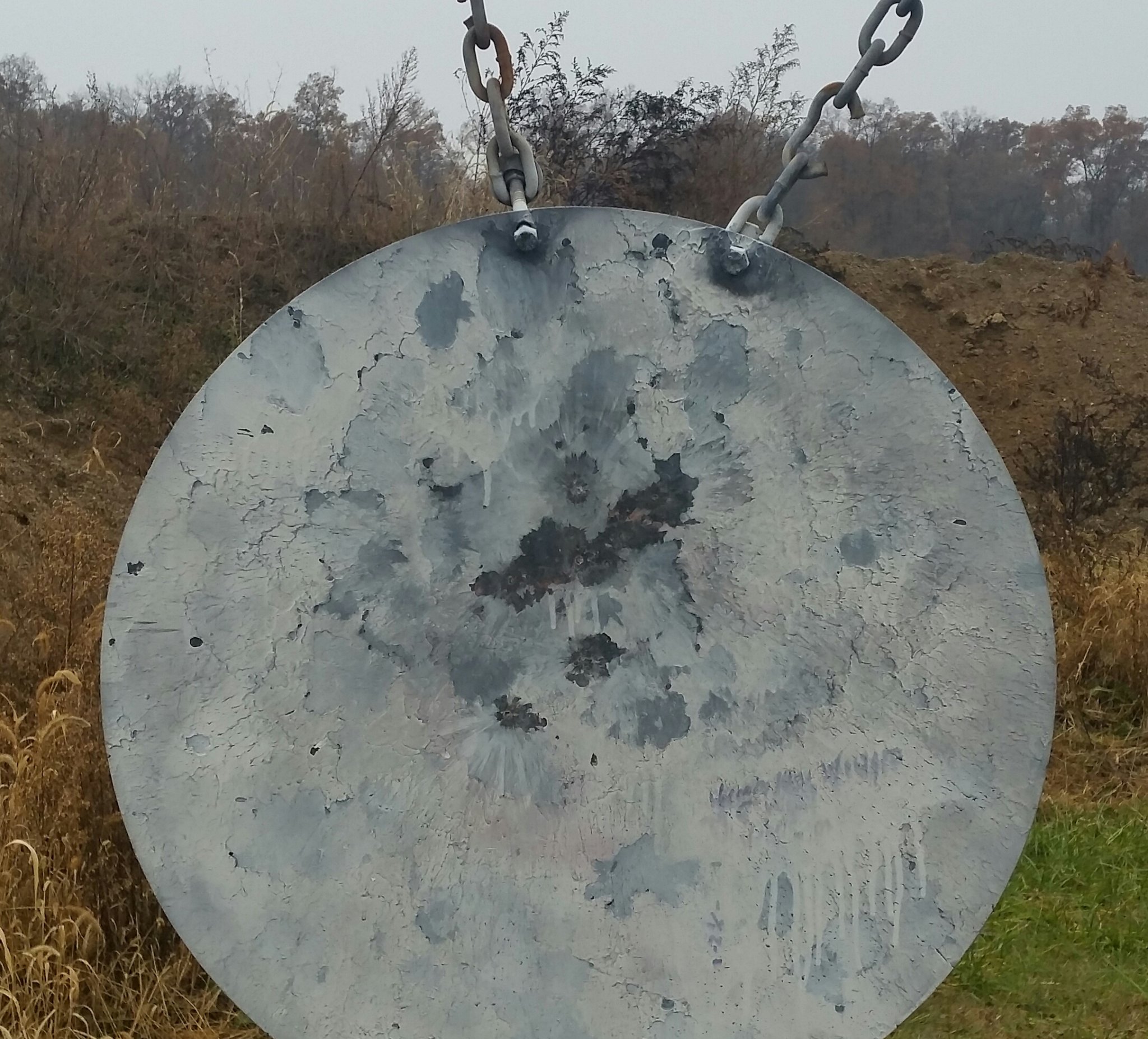

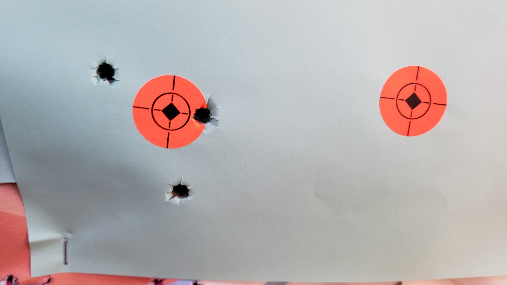

Barnes sold out of the 112 last year. Production started again in August. I got 15,000 in last month for friends and me. Had them shooting ok at 100 yards. Tried about 200 rounds with. Varget, h4350, and staball 6.5. H4350 was the best. Shot a local match and had funny groups going at distance. Came home an shot these groups at 200 yards with the match loads. That's a 1 inch dot.
