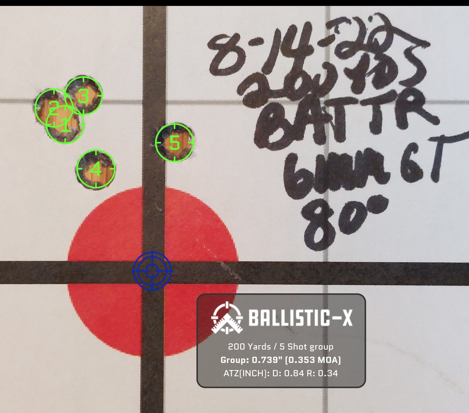

Went to the range to verify my drop with the new load. It’s not that fast but it definitely shoots good(2780fps). Our range only goes to 500yds so this’ll have to do till I get out to a friends range to check it at further distances.
Berger 109’s
Varget 32.6
CCI 450
.070 jump
Alpha brass twice fired
500yds 5 shots
450yds 3 shots
I’d have to go back and look(haven ran that combo in awhile). But I wanna say low 2700s

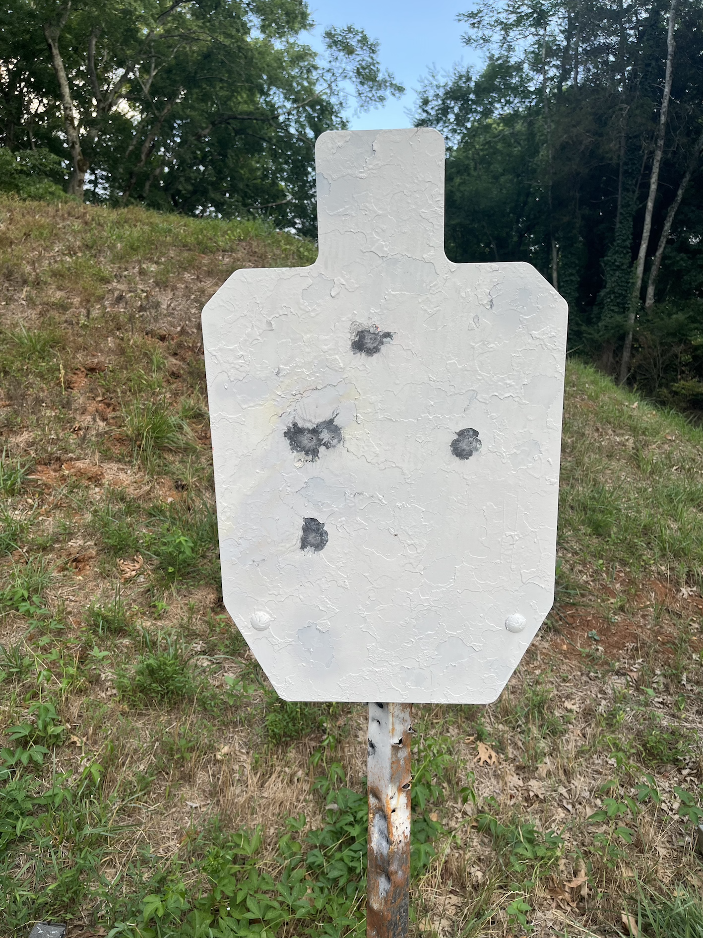

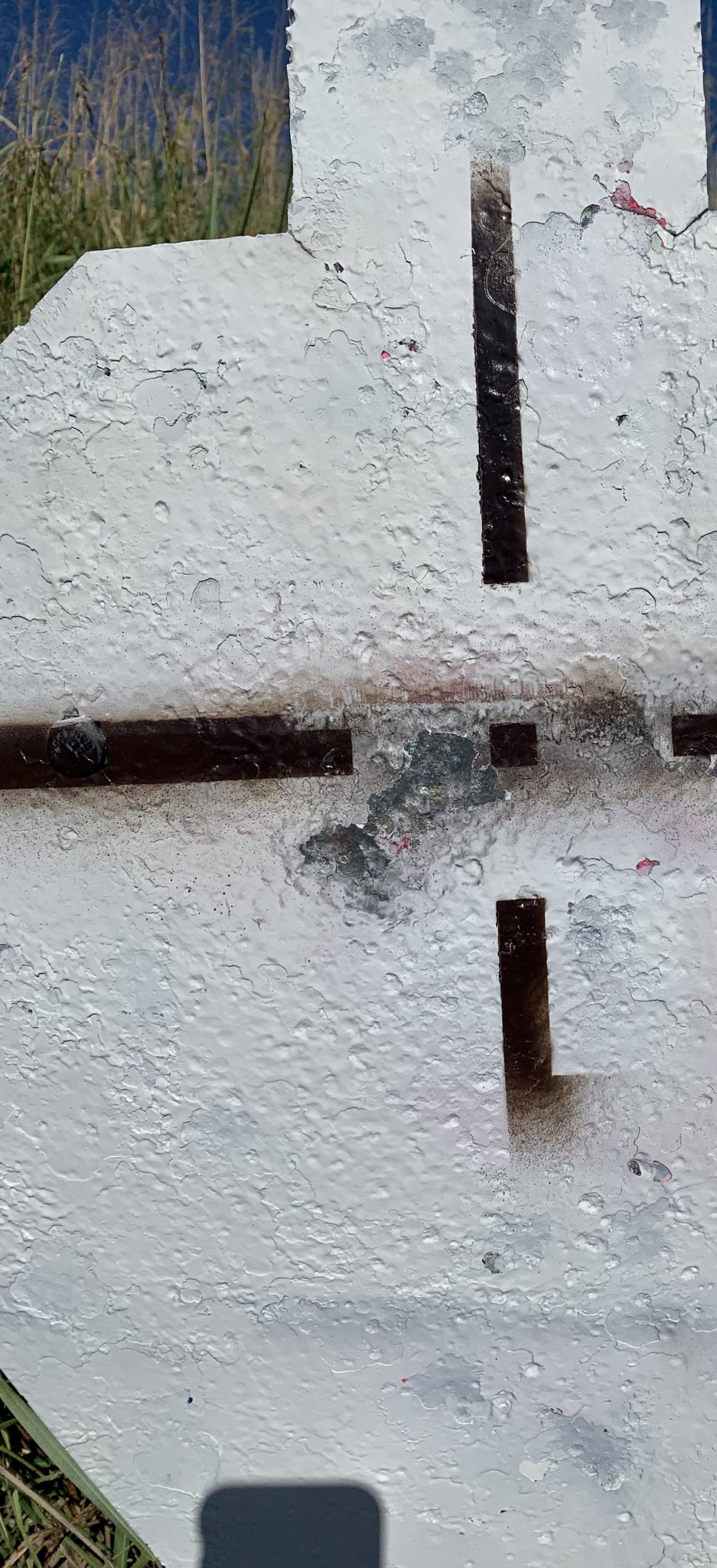

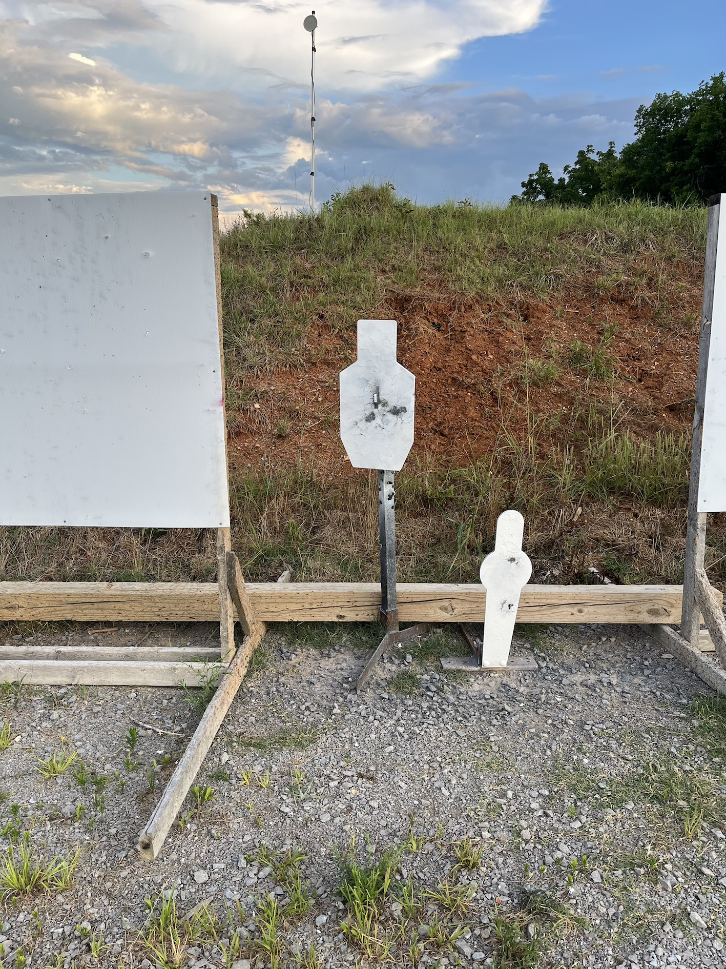

Alright brotatochips. Had to “qualify” the new rifle for the 1000 yard range per our range rules. Sub MOA 5 shot group at 100 yards and filling out a drop chart is all you need to do before you can take her to the 1k yard line. Then trued out the load in the kestrel and it said MV:2898 labradar said the 20 shot SD was 5.2. So do you fellas think my bullets are asleep or whatever?

Alright brotatochips. Had to “qualify” the new rifle for the 1000 yard range per our range rules. Sub MOA 5 shot group is all you need. Then trued out the load in the kestrel and it said MV:2898 labradar said the 20 shot SD was 5.2. So do you fellas think my bullets are asleep or whatever?
I almost missed the joke. For a minute there I couldn't figure out how shooting sub-MOA at 1000 yards and truing your load in a Kestrel turned into a pic of a 100 yard group lol.

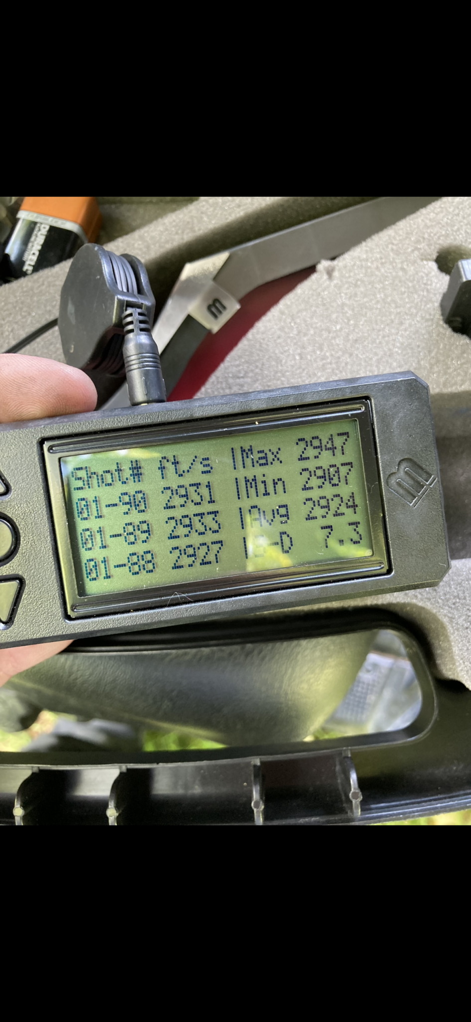

An SD of 5.2 over 20 shots is awesome, but what did the results look like at 1000 yards (group/waterline, bench/prone, etc)..?
Here's an SD of 7 (ES of 17) at 1250 yards, calm conditions (5-8ish mph), bench/bipod/rear bag, not much idea what it does at 100 yards, but I doubt it's too awful, 2 out of 3 touched in BOTH groups I shot zeroing it. I pulled the load out of my ass: I used 41 grains for no particular reason, just picked a number out of thin air, jumping 0.100" to the lands:
Reactions: RS14
THAT is a sick set-up. Yeah it's a procedure that the range has to make sure some 'ol boy doesn't yeet one out of his gran-dads 30-06 off the property. Gotta go sub moa at 100 and fill out a drop card to make sure you even know what that is. Out here in West Virginia we don't have target cams and cant drive down to the steel on that range, so it's all gotta be through the spotting scope. I'll say I'm confident in how she's holding out at 1k as after getting a firm waterline on a clean 12 inch plate started getting too easy, I started going for headshots on the ipsic target as that was the only part of it that wasn't all shot to shit. What range is that anyway I'm seriously jealous?!?
That's Strategic Edge in Chapel Hill TN, best range ever, pretty much one of the only reasons one would want to live in TN lol.
Just FYI, I wasn't trying to one-up or be a dick (well, maybe just being snarky since I thought you might have been taking a shot at me b/c I did make a comment about sleeping bullets earlier in the thread... lol).
I think those pics demonstrate better than I ever could put into words why I question many of these old "truths" guys use when talking about reloading... I've been hearing for a long, long time that one has to be .020" off the lands (or closer) and have just the right amount of powder to land in a "node" for a rifle to shoot.
Nope.
I honestly really am interested in what different guys' results are with their stuff at range, especially when they get crazy chrono numbers. JMHO but guys talk about single-digit SD's seemingly all the time, but most times we don't get to see much of what that actually looks like downrange...
Anything under 12 ish is literally just showing off in my opinion. I’ve won belly matches or long range challenges with sd’s of 18. It does help the mental game of literally just having to work the wind and the rest is put to bed though. Which is probably worth more than the single digit sd in and of itself.

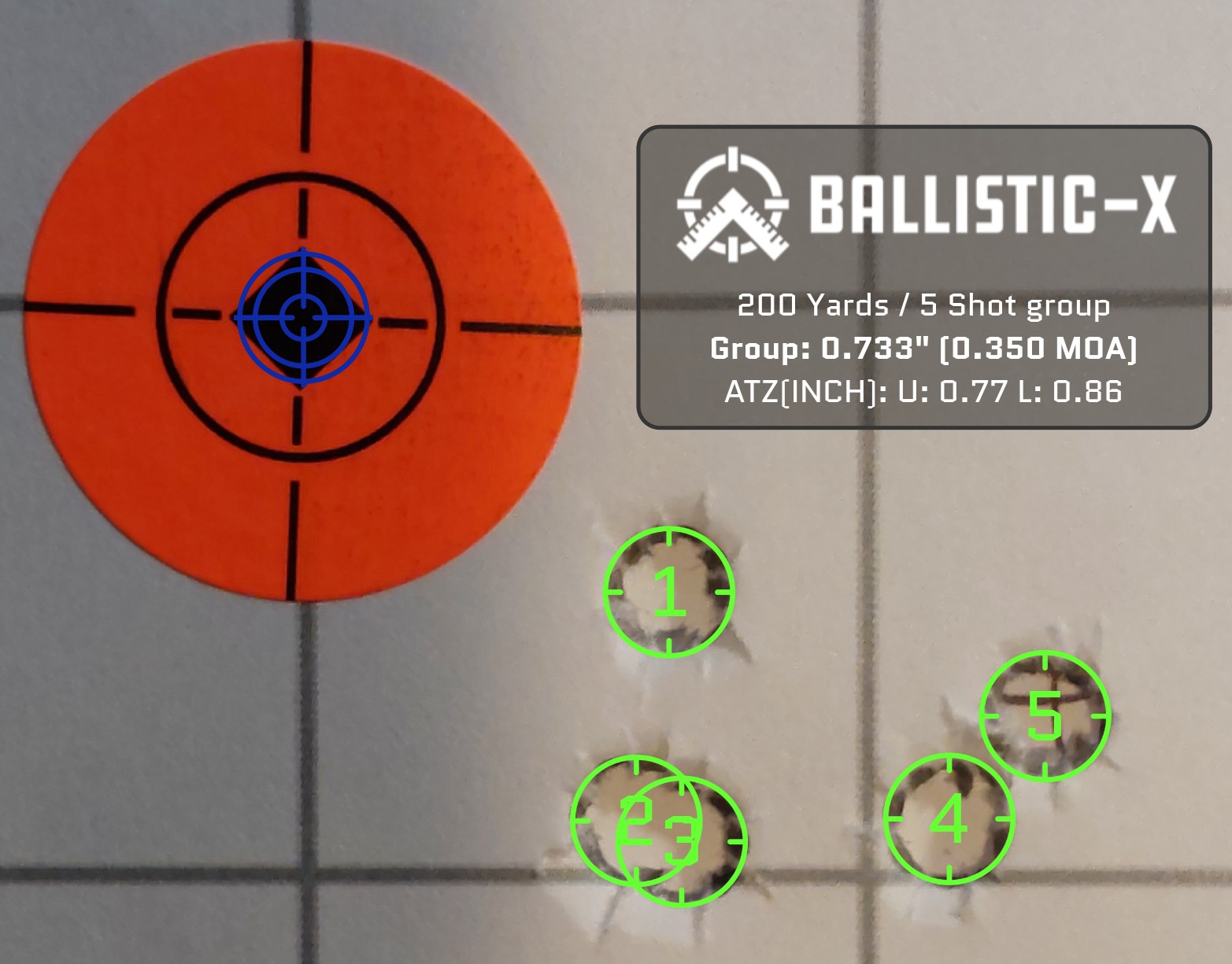

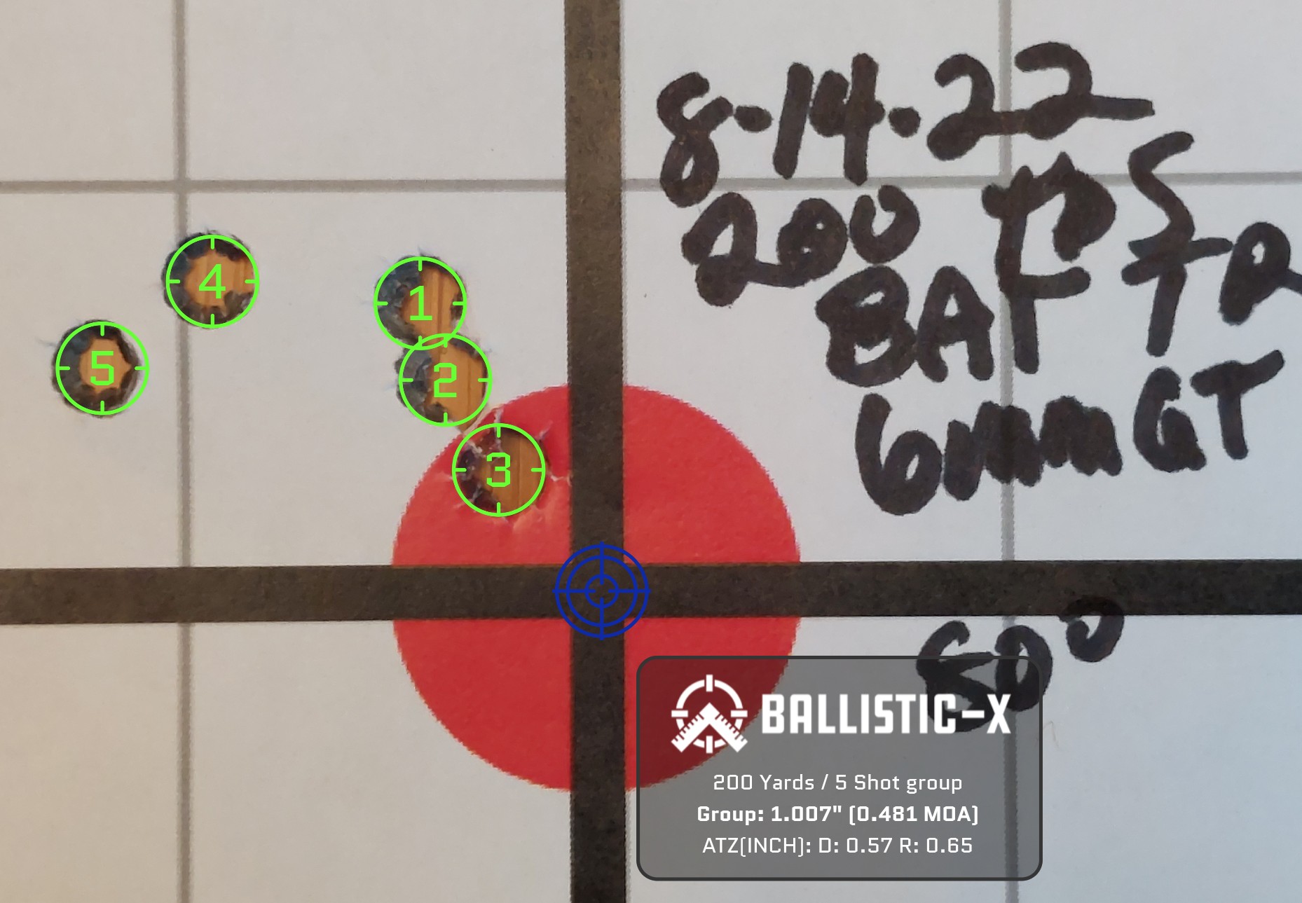

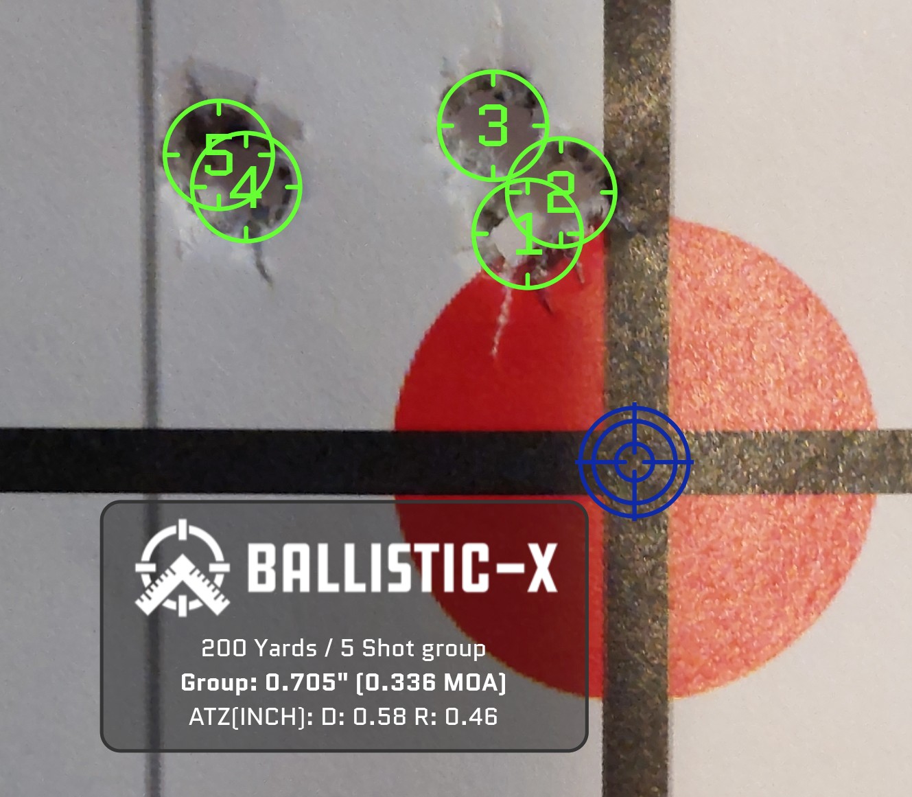

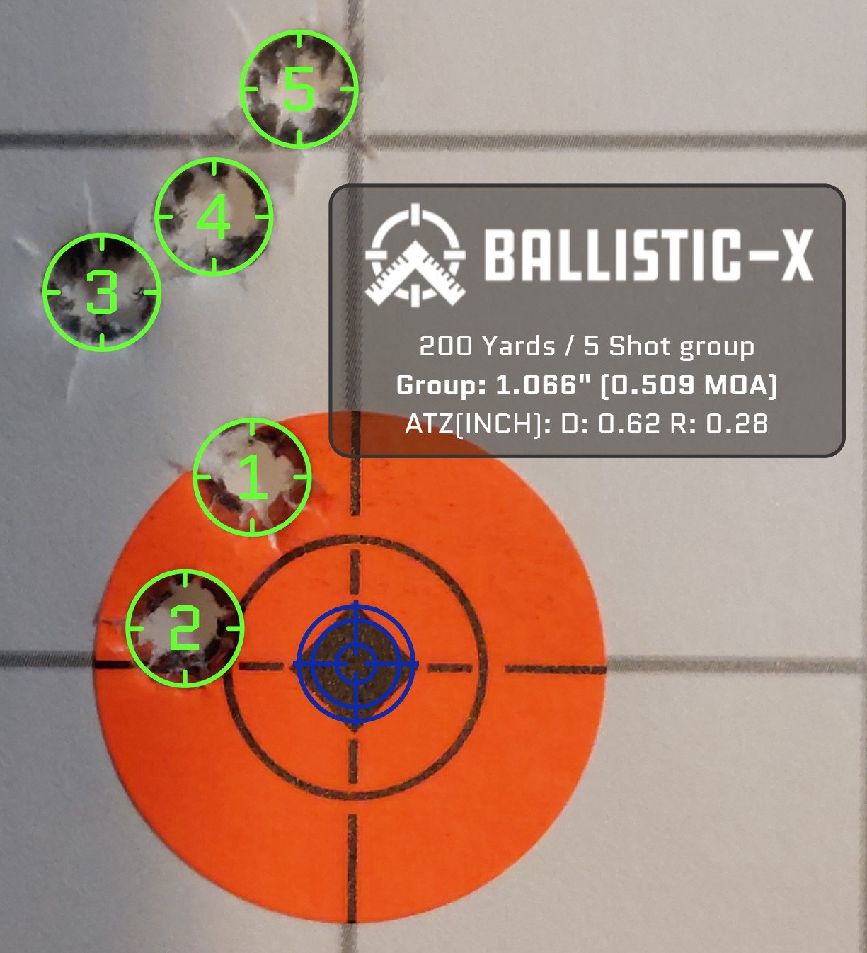

Loaded up some H4350 36.5 grains with SMK 107s. Tried them in 3 different 6mm GT rifles yesterday. Average velocity was about 2860, thought this would have gotten me to 2900+. Two of the rifles did better then the 35 grains I tried last week. Everything shot from bipod on a bench and warmed up with the 35 grain load first. Here's some of the results.
Oddy enough, my Curtis Valor Preferred the 35 grain loading, which was about 2760.

The rest of these are all from 36.5 grains.

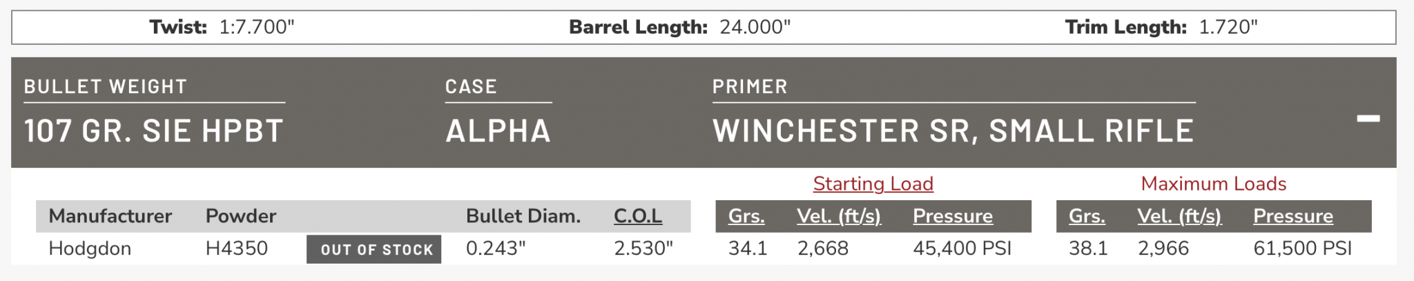

~1" or less at 200 yards isn't too bad, and it's cool that you're shooting those groups at 200... because I feel like way too many guys spend too much time and energy dicking around at just 100 when we're supposed to be building these things for going much further out.
Hogdon shows more like 38gr for 2900fps (with a wonky 24" 7.7T of course :rolleyes:), so your speed isn't far off... maybe see if you can get some "free speed" from a little more neck tension, if you even need it (might be fast enough), IDK?

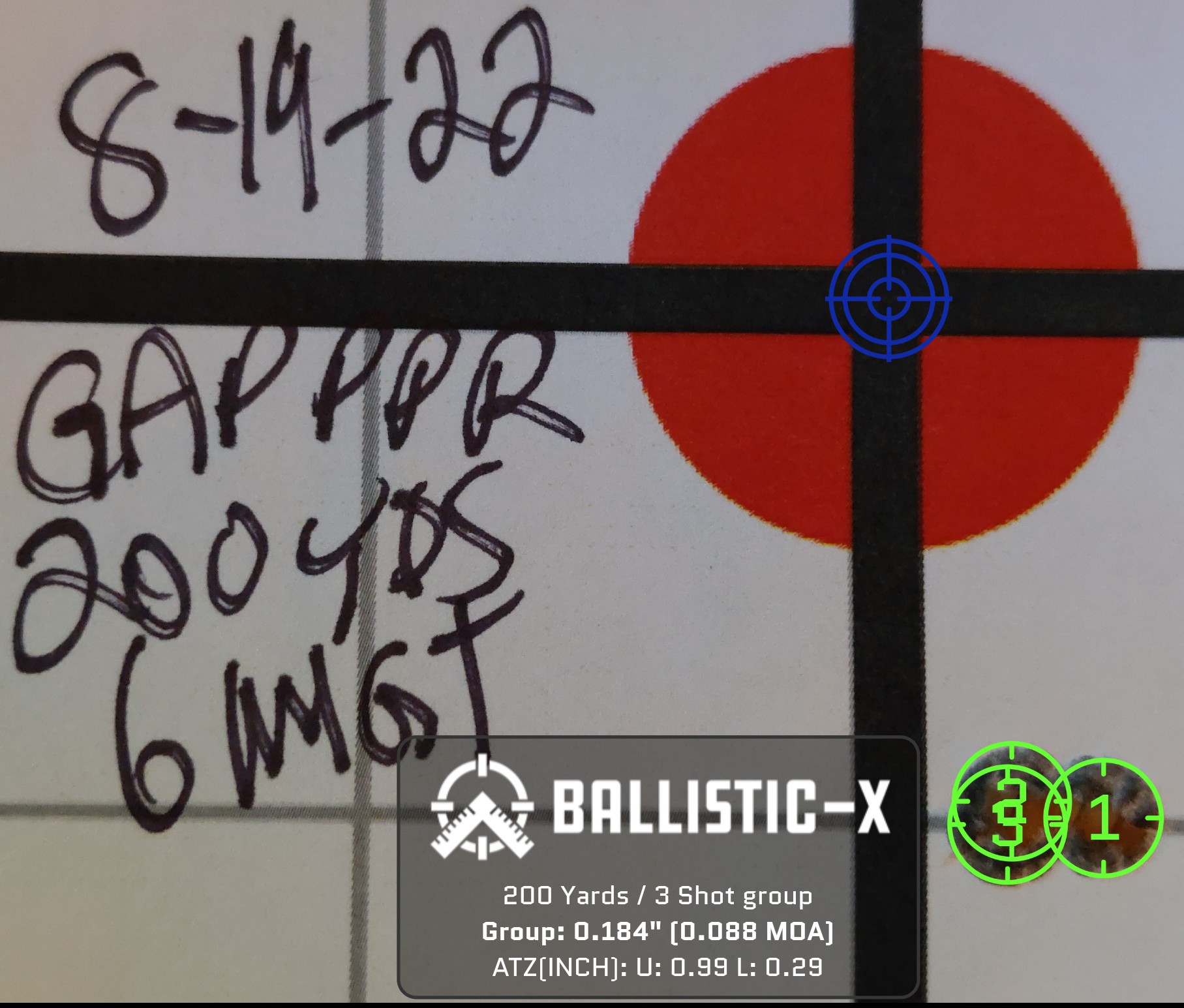

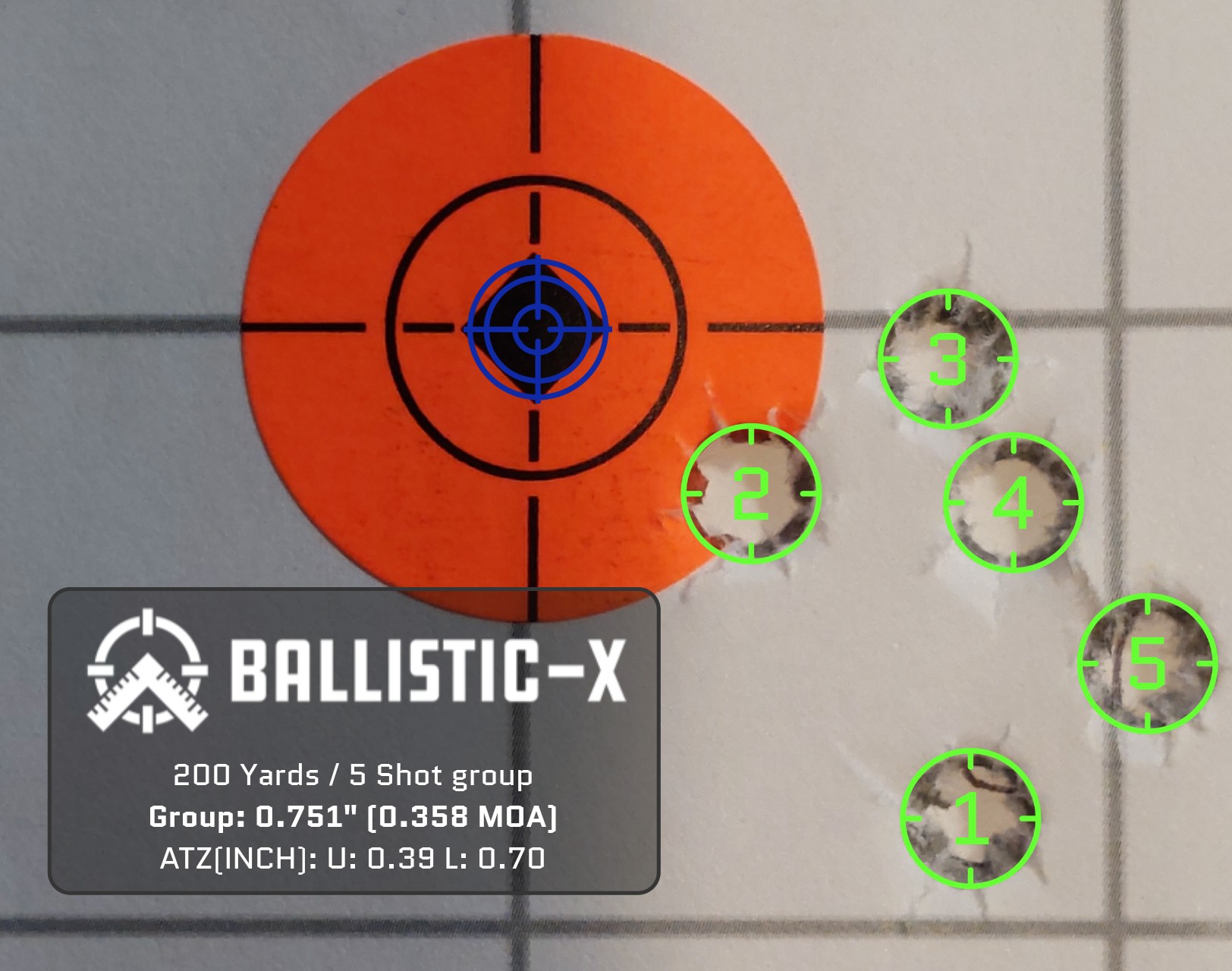

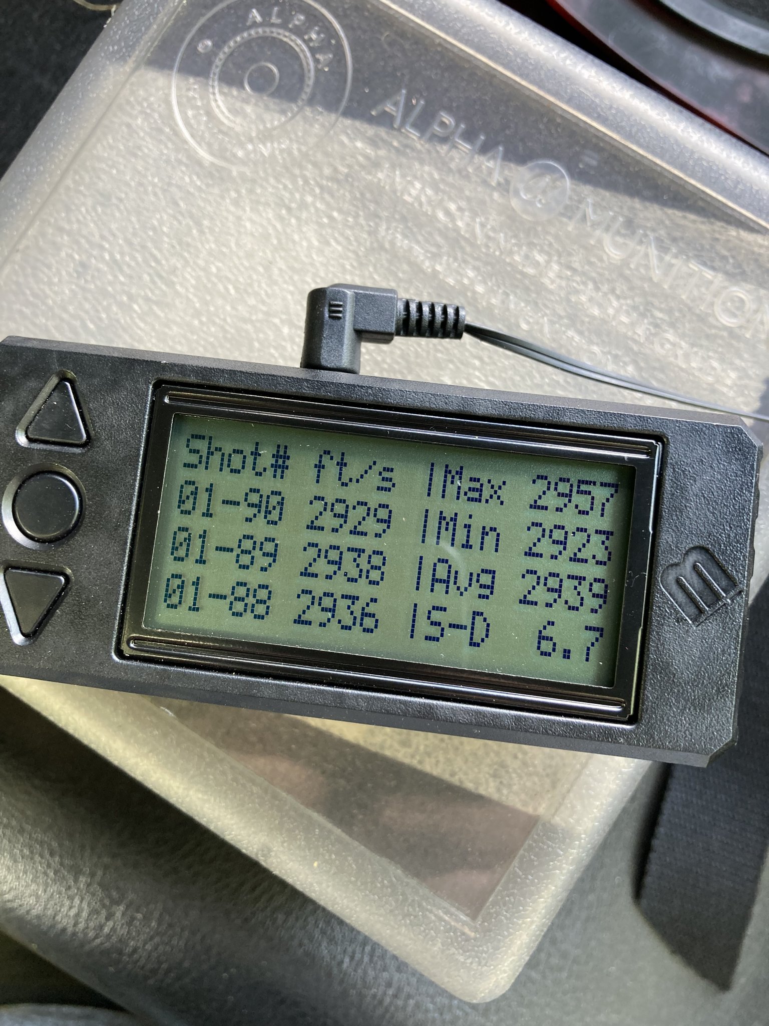

Results are in, 20 fired and resized Hornady 6gt cases has an SD of 6.8fps ES of 29 in my rifle... verses 20 new Alpha cases resulting in a SD of 4.7 and ES of 20.
To be fair the Hornady brass has about 7 cycles on it but I was very impressed that the Alpha did so well. I did run an expander mandrel through the necks first prior to loading the virgin Alpha brass.

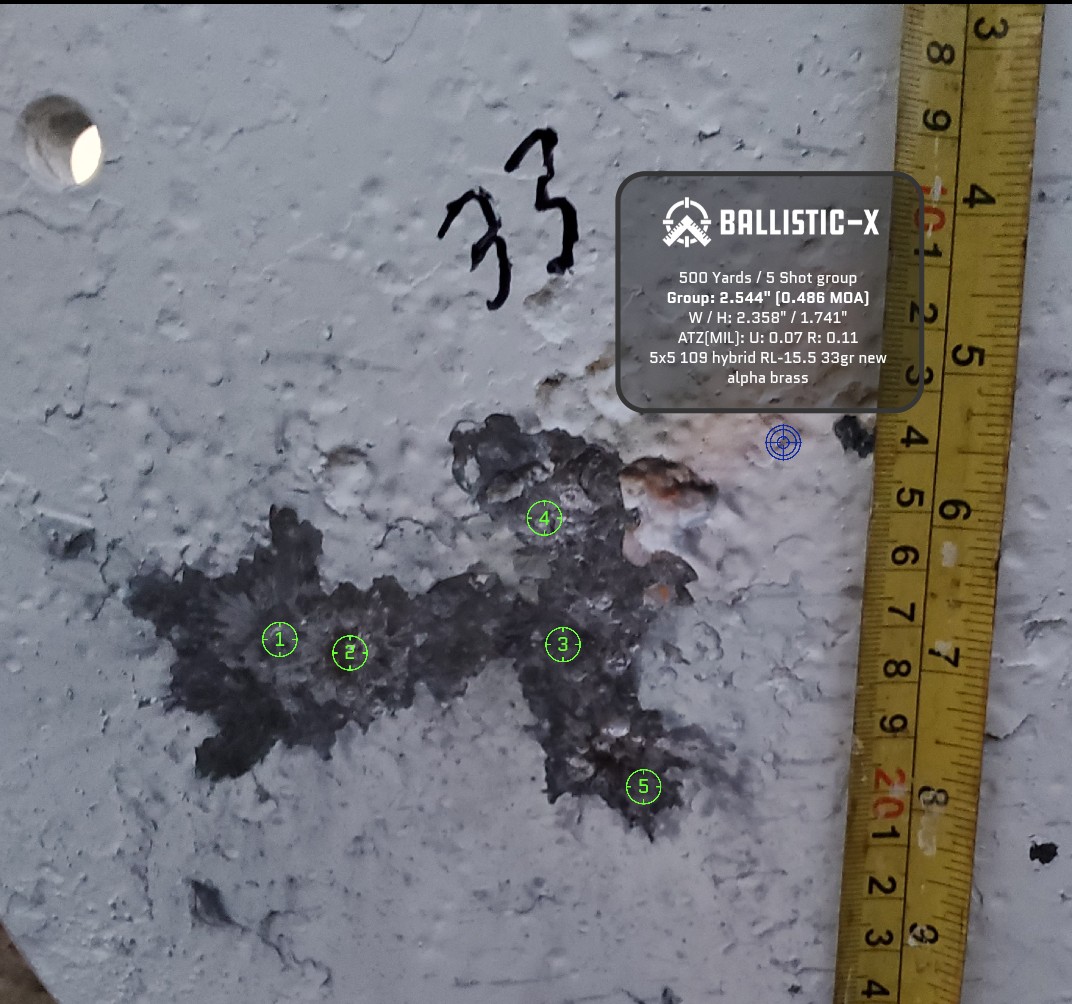

Rl 15.5 at 33.0 grains with 109 Berger Hybrids, 2793fps out of a 24" Bartlein mod400 barrel with 2301 rounds on it as of this firing.
Since every post should have a picture here are 5 at 500 and 5 at 700 of the alpha brass.

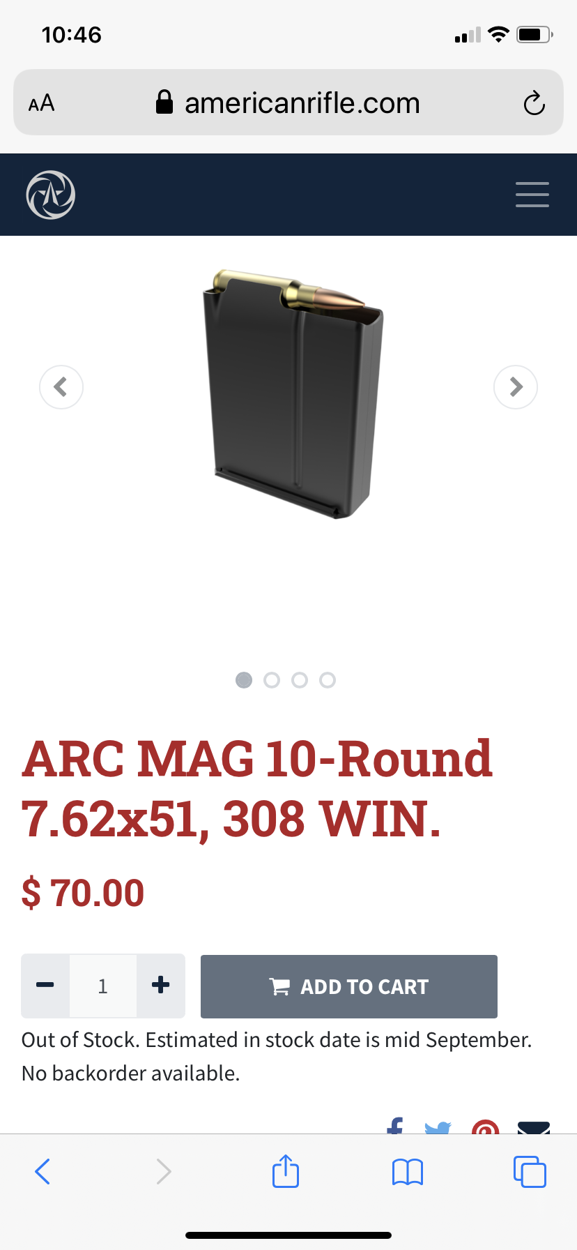

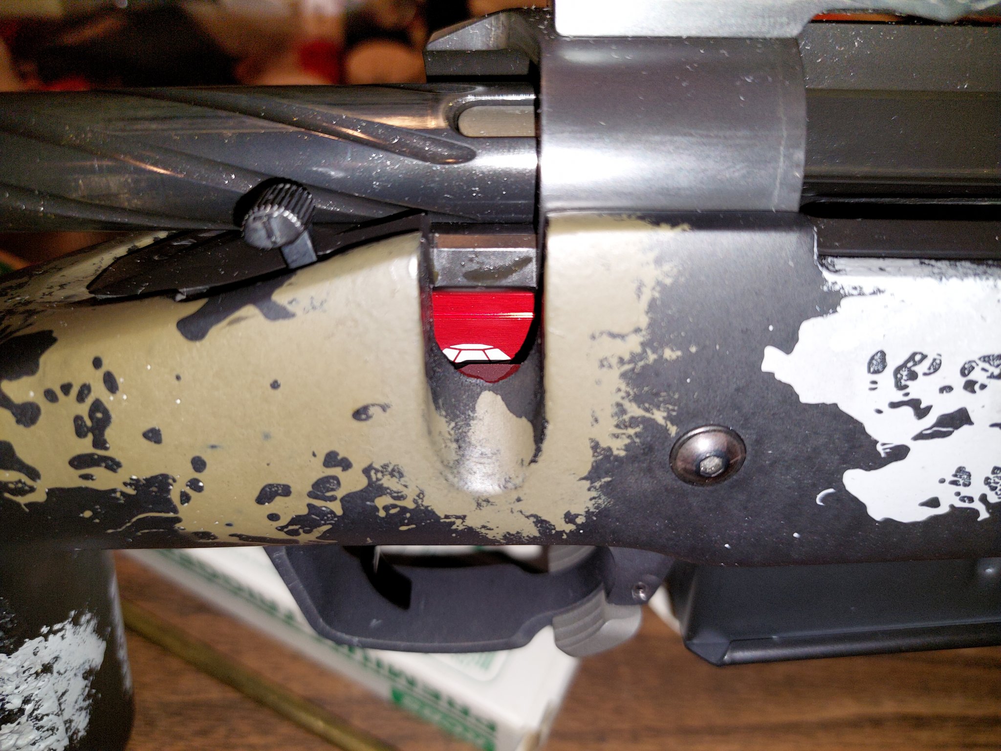

On a non load data note, I was having a hell of a time chambering the first round out of a full AI mag in my TL3, accurate mag was better but, just ok. Then I tried the MDT 12 rounder with the binder plate and it’s like buttah. Anyone else had this experience?
Kinda opposite exp for me. Both were tough to load the top rnd (loaded mag). Sometimes the MDT nose dive. Both mags have tuned feed lips.
I prefer Accurate-Mags
I only have the MDT 12 rounder. Feeds fine as long as I only load 11 or less. 12 is a no go and stovepipes the first round.
ARC mags are either loved or hated it seems. I Love them & also have 3 + 1 with the 419 extension. I’ve had zero issues running them in 6GT, 25C, & 6.5C. Actions are ARC & Tika with KRG Xray.
I even run my lone peak fuzion 6bra with the arc mags. I have to load the rounds about 1/4" forward of the rear plate, but runs very well might have 1 or 2 miss feeds out of 100 rounds. A lot of positional of a bag on big props, a long mag will cause issues. I wish someone could come out with a better design for the br based cases. I know some run aw mags, but I had hell with em.
That estimated date has moved out like 3 times in last 2 months. I hope they have a boatload comming or they won't last long.
Possibly post a WTB add? I recently purchased a new xlr chasis from a guy, he happened to have a few extra arc mags he wasn't using. I was happy to take them off his hands.
