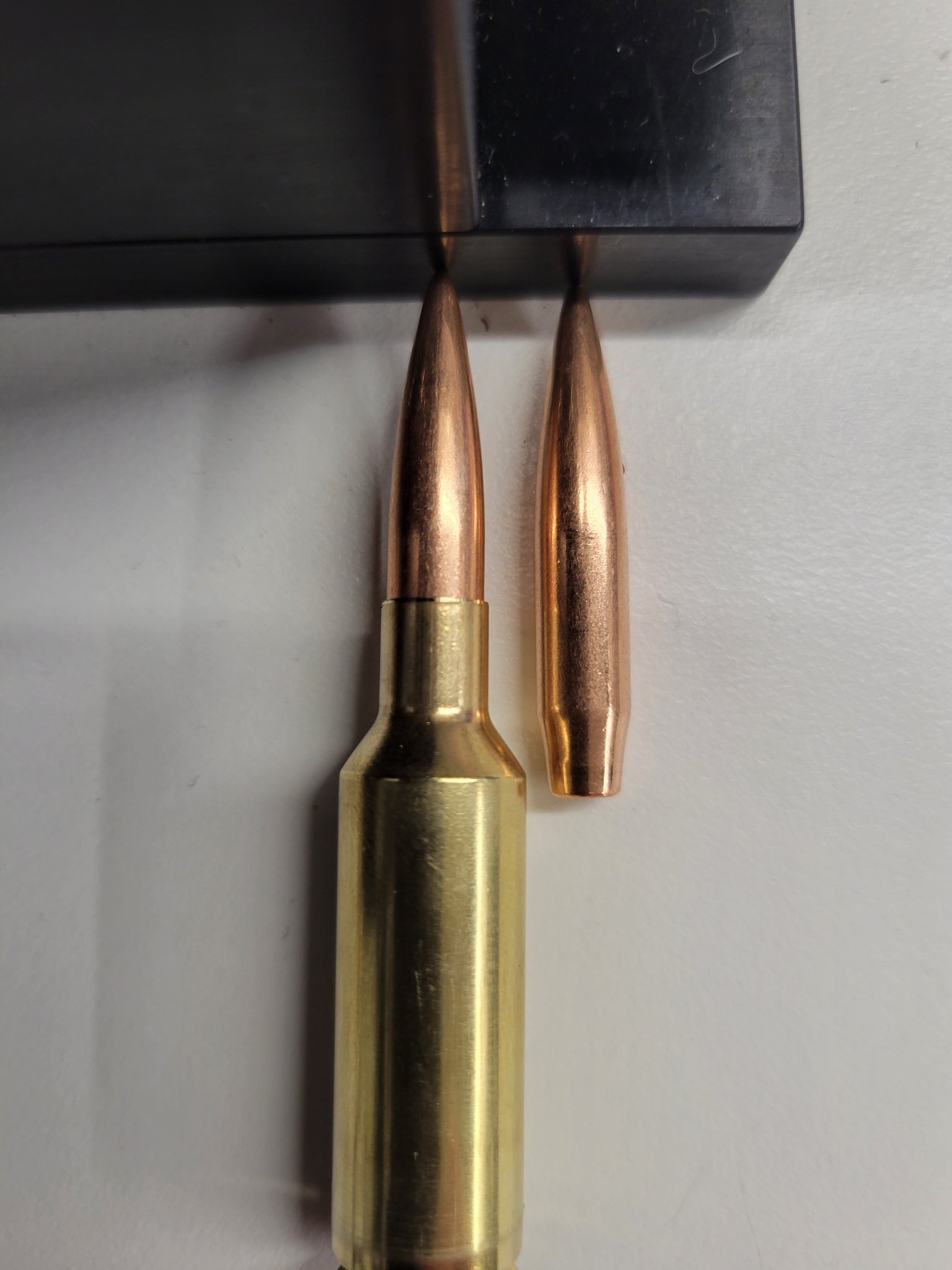

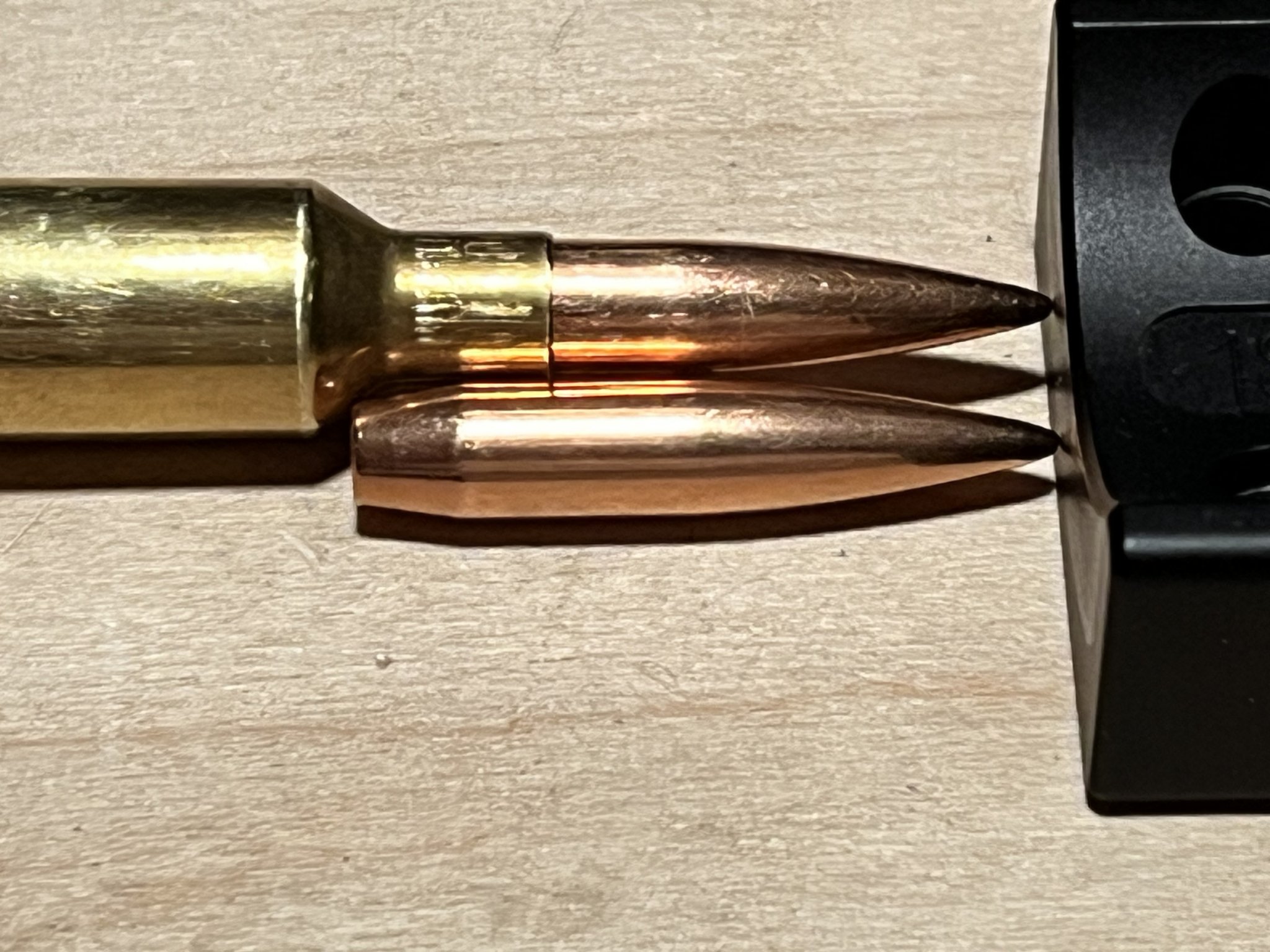

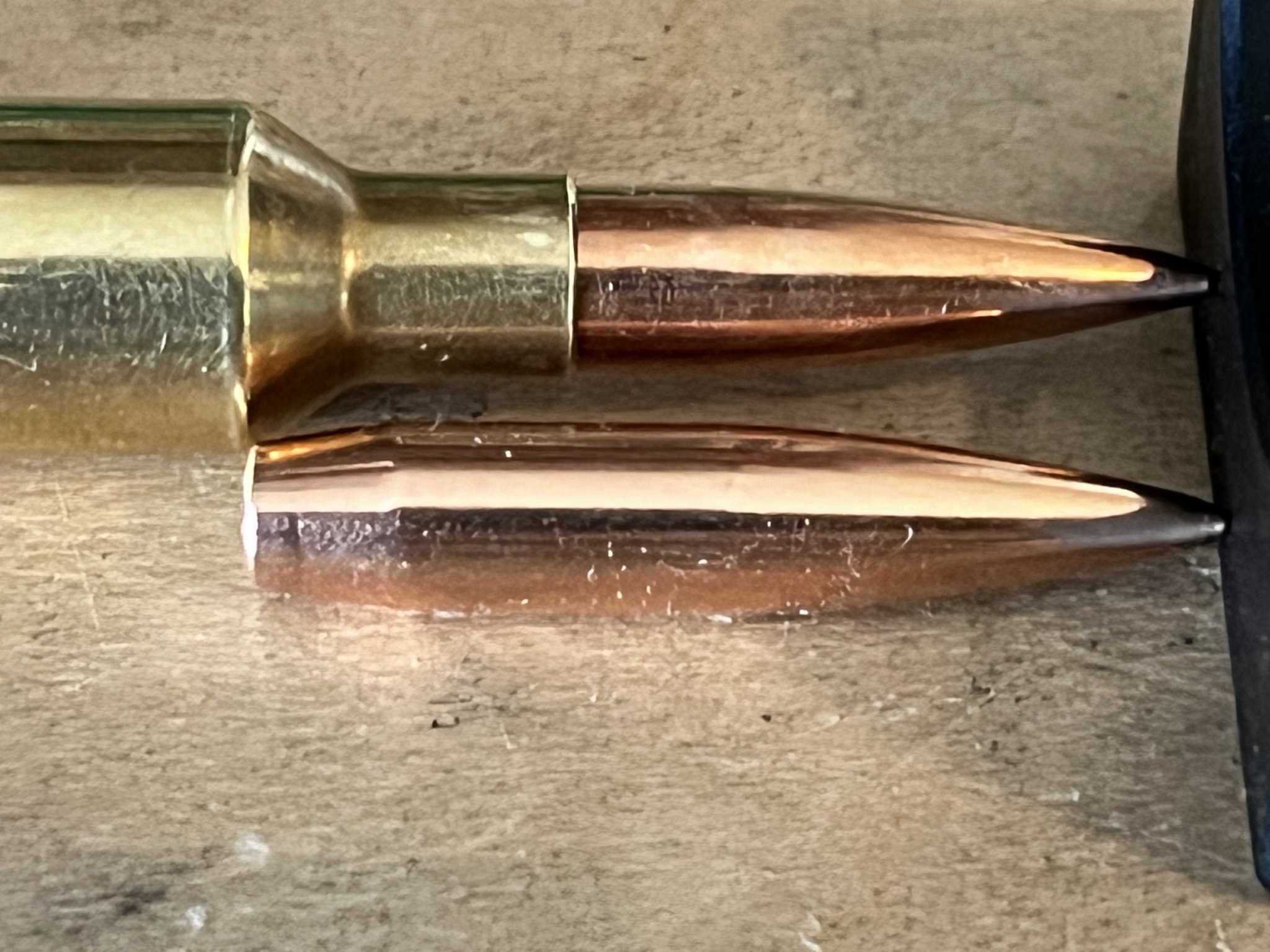

Here’s .180 free bore in a 6GT…bullet is a 107g SMK…
1st pic is the freebore the barrel came with…got it from a buddy and he said it was .120
Had my smith add .060 yesterday
2nd pic is with .060 freebore added so total is .180

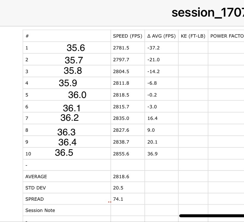

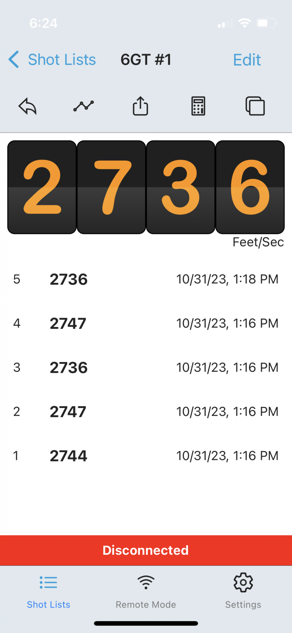

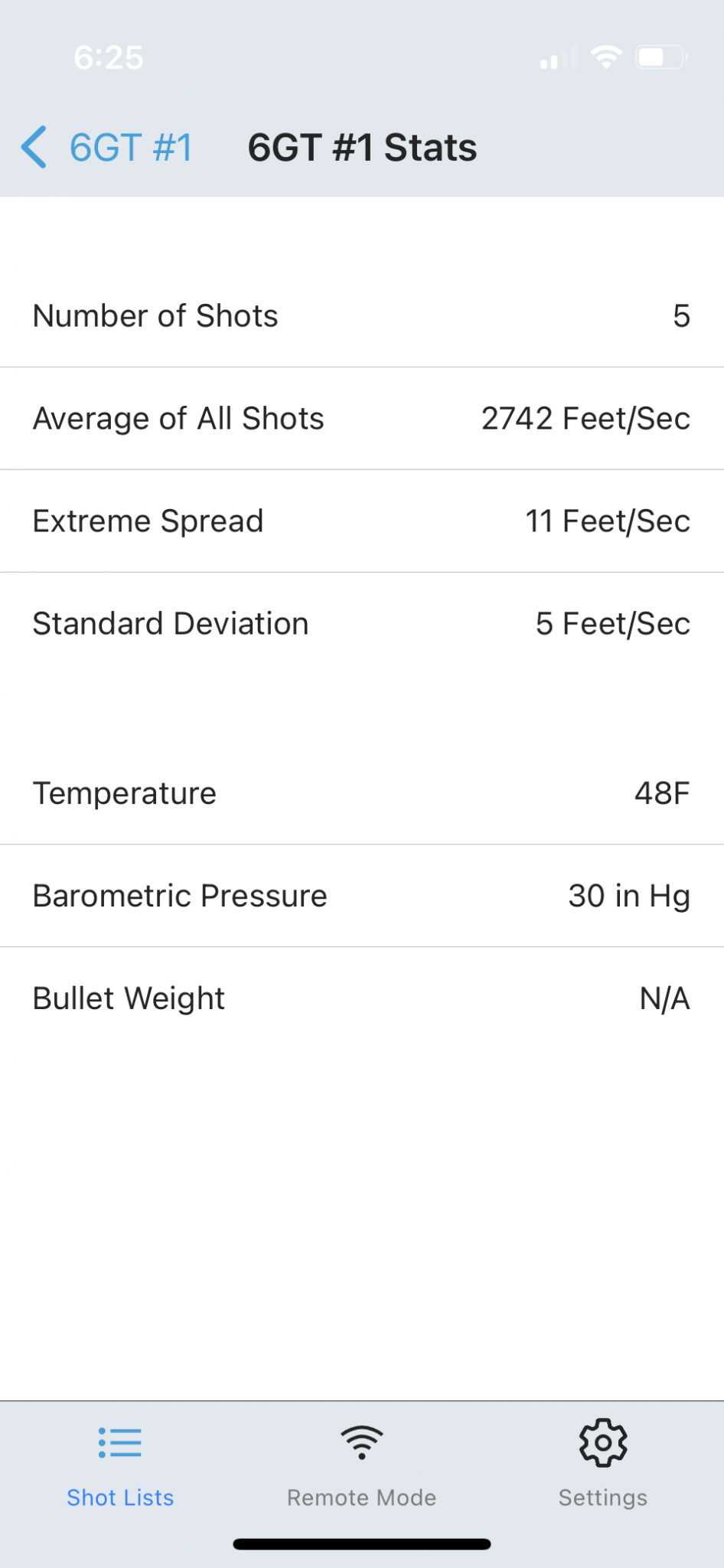

I loaded up 10 rounds of the 112 Matchburner over 36.3 grains H4350. The results were mediocre. I've had much better numbers with Varget.
That's pretty slow, you'll probably see better accuracy results up around 2810-2830 avg. What's ur barrel length? I have several 8# jugs of H4350 from different lots, and velocity varies quite a bit.
That's WAY slower than most of us seem to get with that load - I'm using that exact load in Hdy brass and see 2920 fps from my 26" barrel.

IDK guys, @CJC73 I don’t think that’s too slow for this time of year… some of the top PRS guys are running speeds in that neighborhood, 2700ish fps is the new “2800” for most of the Dasher guys lol.
I was going just over 2700fps the other day and printed a fist-sized 5-shot group at 1000 yards.
Speed has little to do with accuracy IMHO.
Totally agree with this.

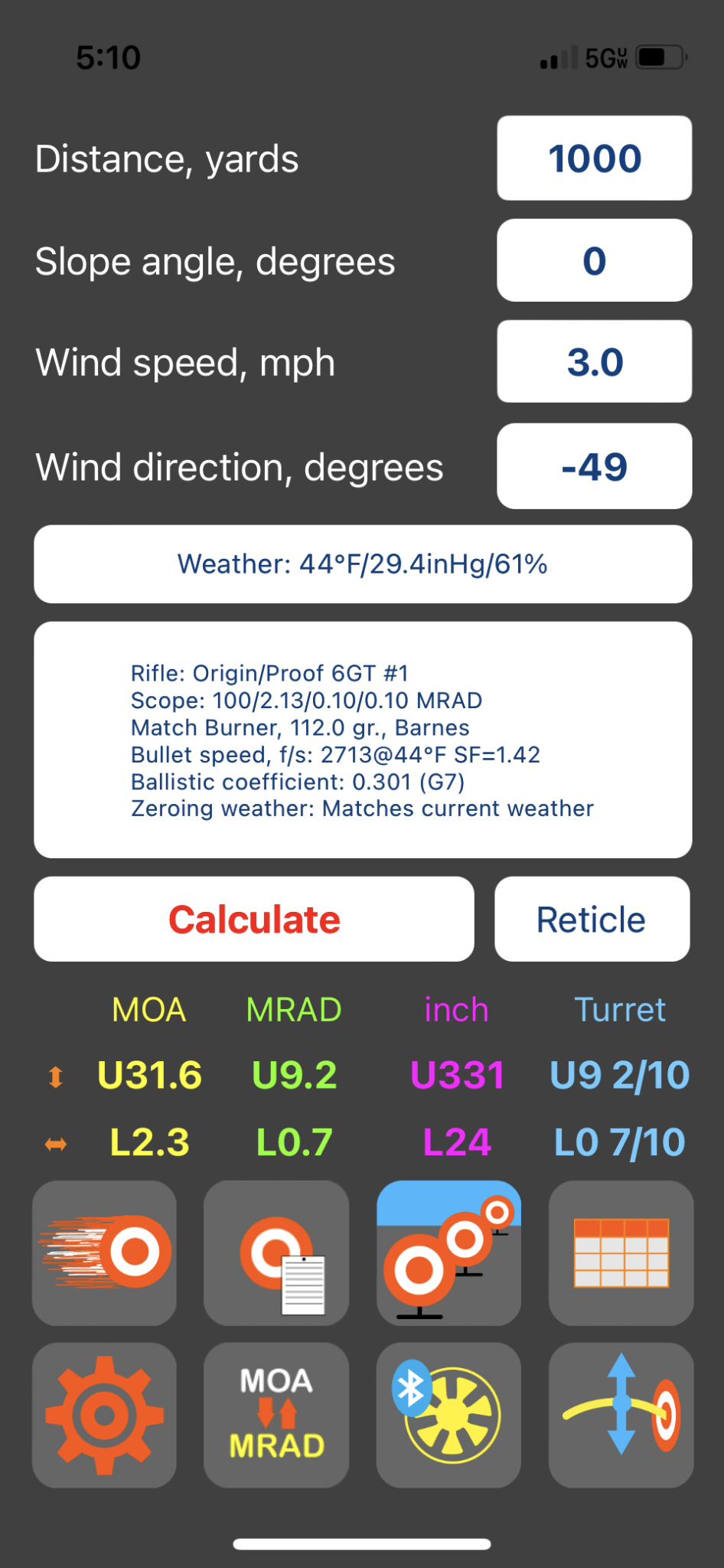

Guys that rifle @WyomingShooter has is built on a sig cross, they come with 18" barrels oem, and the new barrel is probably on the short end as well. So I'd expect low velocity.
As to @CJC73 rig, that's a new 24" barrel, I think the upper 2700fps with 115s is about where that barrel should be with his charge of H4350. I run 35.3gr H4350 in a 28" at 2850-2850fps, round count of around 1k.

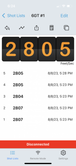

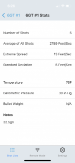

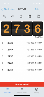

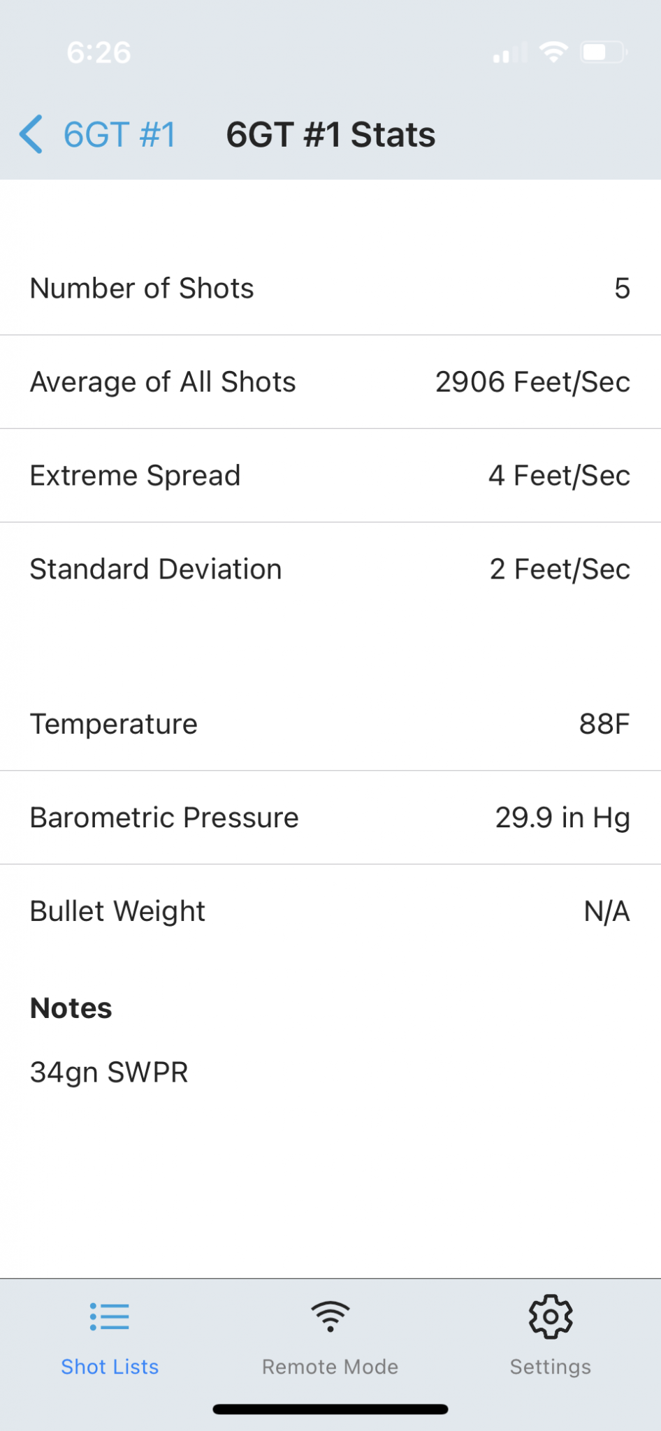

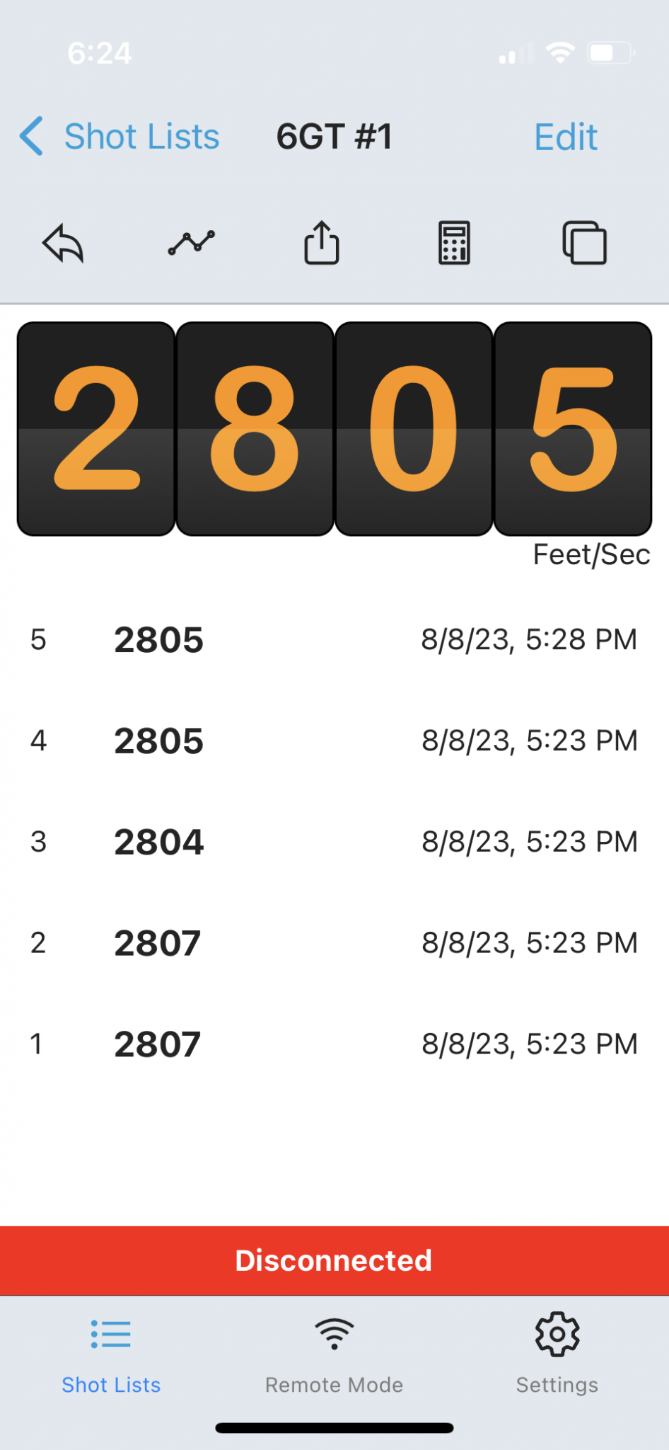

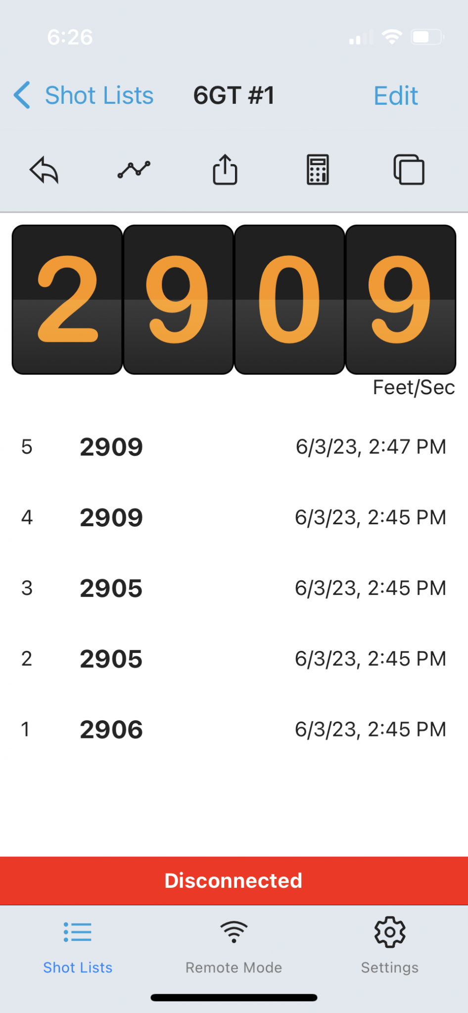

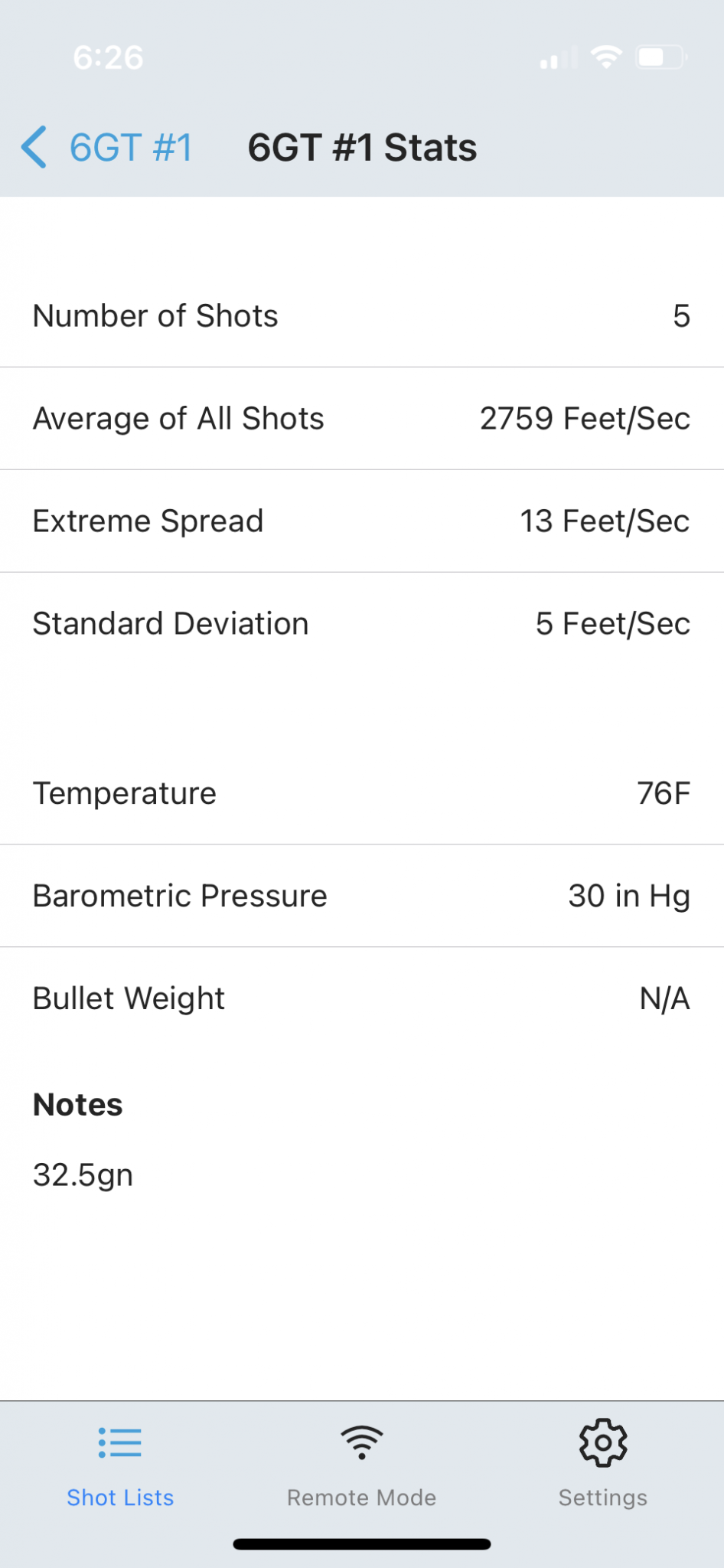

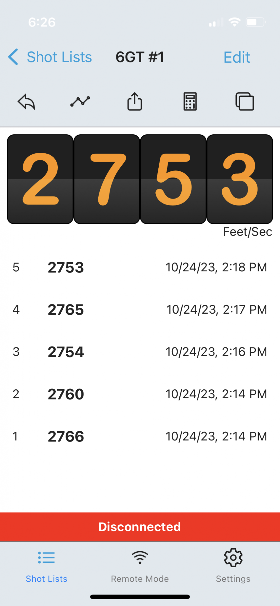

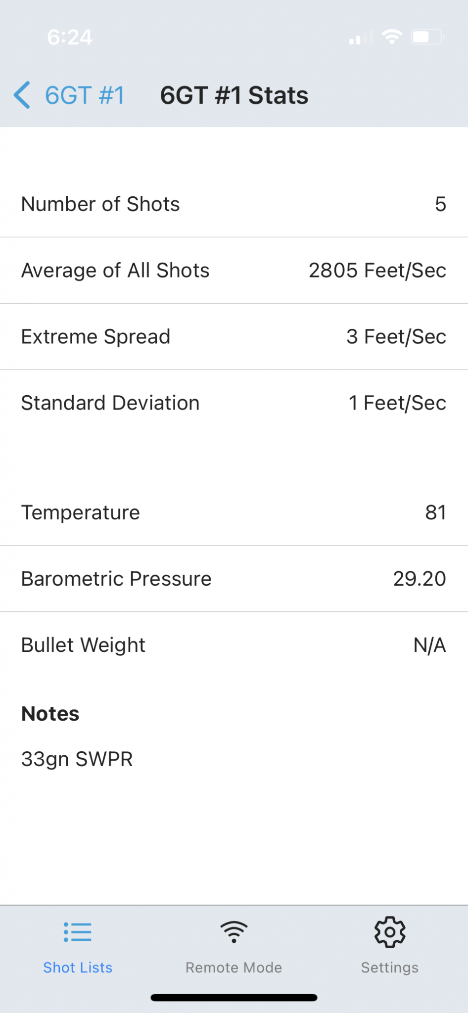

I actually slowed my rounds down on purpose a little while back...
I dropped a whole grain and went from ~2900fps at 88F to ~2800fps at 81F... and the only thing that changed is: now I can tell you which way a plate rocked and whether I was high or low on it inside 600 (at ~2900fps I couldn't pick it up as well until out to ~750 yards).

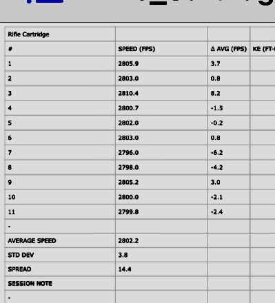

This is me maintenance checking on my current load (33gn SWPR) at 2 different temps (81F and 48F), then trying 32.5gn before deciding on 33gn (mostly based on 33gn being easier to remember than a number with a decibel point lol), and then when I was running 34gn and getting ~2900fps.

@CK1.0 Impressed with the low SD with swpr powder, rhat low of case fill at 2800fps. I plan to try dropping my 115dtac load down to low 2800s as well, but the 28" barrel isn't helping matters!
Yeah... that's something I can't quite explain... for now my theory is something along the lines of Varget (or Lovex SO62 aka SWPR in my case) being the magic-sauce some guys make it out to be lol. I hadn't used it before, I was only really familiar with H4350 or Sta-Ball 6.5 in 6CM, but It's the whole reason I went to the 6GT, to be able to use Varget/SWPR and see what all the fuss was about? I've seen consistently great SDs that are amazing sometimes and I don't know exactly why?

Yup, pretty much every bullet I have run is close to or at neck shoulder junction at .045. I will be looking to throat my next barrel a little. All mine are a .120 freebore. This is a 115 DTAC at .045
I'd go .180 with the DTACs...If I end up sticking with the GT I will have a reamer made with a .180 free bore.
There is no "optimal" powder across the board for any cartridge. It just doesn't work like that.
If your H4350 load was slower than your Varget load with the 112 MB in 6GT, then your Varget load was at higher pressure. End of story. That may be what you're after, but it'd be a mistake to think that Varget was capable of more velocity than H4350 in this particular combo; for some reason your H4350 load was at lower pressure, giving lower velocity.
Again, nothing at all wrong with loading down if that's what you're trying to do, but that's not what the comments regarding your load were about.
Sir - Thanks for your note. It appears my post was unclear. My bad. I'm not chasing velocity. My interest is in reducing my SD and ES. In my limited 6GT experience, it seems that's easier done with Varget than with H4350 - at least with 105 - 112 grain bullets.
I'm trying to figure out how any of that is relevant to the discussion about that particular load? Not coming up with anything that makes sense, other than maybe communications got crossed somewhere. If you go back and look, I and 406Shootist were replying to WyomingShooter, but you seemed to reply to us that you didn't think CJ73's load was slow?
"This time of year" has nothing to do with it - the discussion was about a specific load using H4350 which is very temp stable, not some sensitive ball powder. No way it lost 150 fps due to "this time of year" - again referring to WyomingShooter's load.
Also don't see how other people loading down for PRS, or Dasher loads, or accuracy relating to speed have anything to do with this. The discussion was about the velocity difference one person saw with a specific load that was a lot slower than the exact same load for others of us.
To add:
I ran the entire 2022 PRS season with my 6 GT going 2635 fps. It did very well. SDs between 3-11 through the life of a Hawk Hill Heavy Comp barrel at 22"
I wouldn't worry about slow speed in a 6 GT.
Just to give you an idea where mine is at. Chambered with a Manson .120 freebore then throated out to .185 the best we could tell by measuring it. 115 DTACS at .061 off that measurement.
Just a quick ladder once I got 225 rounds on the barrel just to see velocity. H4350 and no pressure signs
I'm just about hanging on by a thread fighting the urge to buy a hand-throating reamer... I just haven't turned the corner in my head of how to gauge exactly how far to ream accurately..? (So far, my best plan seems to be to just use a dummy round and the same "Deep Creek method" I use to find my distance to the lands... but it might be a painfully slow process that way.)
Ideally, I'd like to be able to load/jump .100" off the lands if I want, with whatever bullet I choose, and using my bad-at-math, probably flawed, calculations... I think that would mean something like ~.210" of freebore.
I suppose I could take a barrel to a gunsmith with a lathe... but I like to avoid gunsmiths and prefer to work on my guns myself if possible, as IME many gunsmiths seem to be more snake-oil salesmen than rocket scientist, with most as dumb or dumber than me lol.
On one hand, I really do feel like using a healthy jump does do great things for one's vertical consistency downrange, but on the other hand, I'm not completely convinced reaming and more freebore is the only answer... as just simply seating bullets deeper into the case and purposefully breaking the "bearing surface above the neck/shoulder junction" reloading "rule" has seemed to work just fine too for me (no donuts, no issues, etc)... but I could've just been lucky, and luck tends to run out lol.
IDK..?
IDK..?
Also your right in the ball park with your free bore to jump .100.

Not at all. Just trying to figure out what you were talking about. At first glance it looked like a poorly considered objection to our comments about velocity of a specific load, but on further consideration maybe you just mixed up which member we were talking to?
If that's how it's working out in your barrel, go for what works for sure - a lot of it depends on the velocity range you are looking for. That pretty well illustrates what I said about no one powder being optimal - if your goal is lower velocity with small SD, then a faster burn rate like Varget will be optimal for that application, while a goal of higher velocity (with equally low SD) will mean a different powder is optimal. One thing Varget does get you is lower charge weights, which equates to a little less recoil.
Personally I've noticed that H4350 is better suited to the heavy bullets than Varget, and got single digit SD from day one when loading in the 2850-2950 range with those 112's, but I started off with a goal of finding a node between 2800-2950 based on the ballistics I was looking for. However if your load is at lower pressure for some reason then you may likely see higher SD with H4350 than with Varget, which will peak pressure a little earlier and higher, and likely be more consistent at lower speeds. In my barrel the top end for the 112 over H4350 seems to be somewhere around 3,000 fps or higher, while Varget seems to be getting pretty hot even in the 2900 range, just my observations FWIW.
I'm still a little surprised how slow that H4350 load was in your barrel, when the identical load in at least 2 other barrels here runs about 150 fps faster, but that ~22" barrel does explain some of it. A looser chamber might account for the rest of the difference, which would also drop pressure and explain your higher SD. Just spitballing though.
