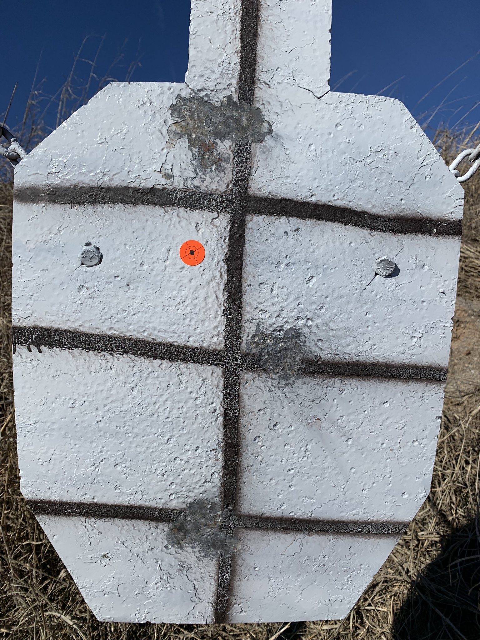

@Yondering I'm running the 112s 10k jump in my rifle, 309g7 was money to 880y perfect waterline at 2910-2920fps with 36.3gr H4350 from a 24" barrel. They shot equally as well at 100y at 36.6gr running 2950, but accuracy wasn't nearly as consistent on my targets at 660y and 880y.
Ha! Crazy how similar our results are. And I was shooting 883 yards just this evening with that load too. I ended up at 6.1 mils for DA of 0 ft and 7° down angle to the target. Also shot at 538 yd for a better confirmation of velocity (9° down angle, 2.6 mils to waterline); the chrono said 2931 fps avg (SD of 6 - for my purposes I'll take it) on a warmer day but drops lined up a little better in the calculator tonight for 2920 fps. Need to confirm that some more but hits were pretty easy and consistent at both distances.

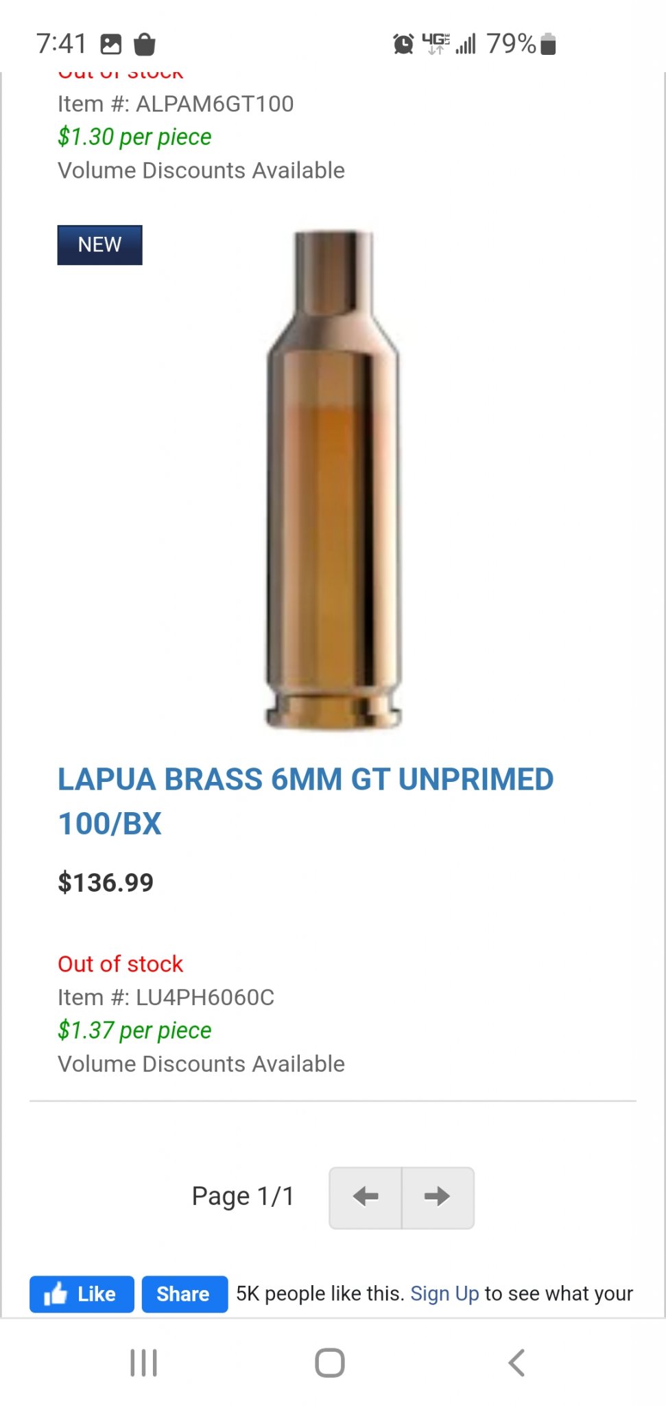

Has anyone heard about Lapua making 6GT brass?
Reactions: DubfromGA
Reactions: DubfromGA and RS14

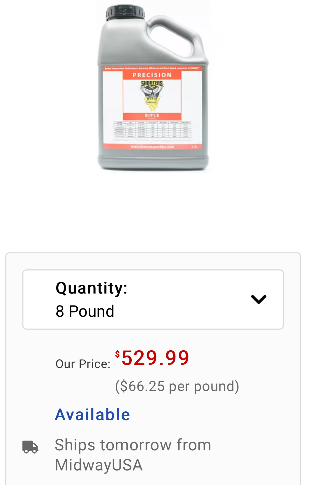

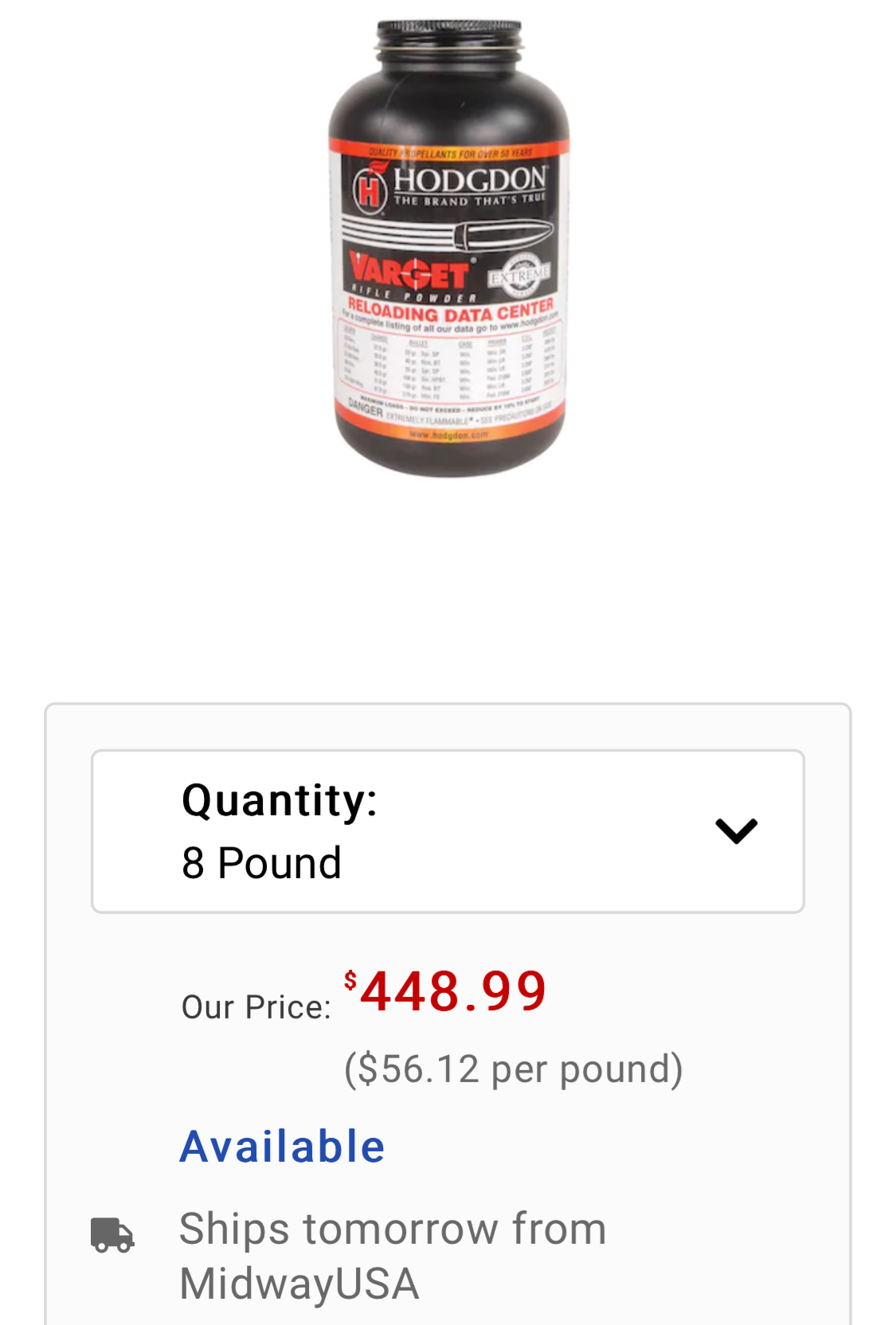

Powder Valley is significantly cheaper on the Varget and massively cheaper on the Precision Rifle.
Larry Pootterfield can eat a bag a' dicks today.
PV for the win.
Never realized the Gay Tiger was gonna hurt this much.........
PV for the win.
Yeah it's fucked
Everything goes from $30/lb to $50 or $60, we're the reason why these fuckers get away with it

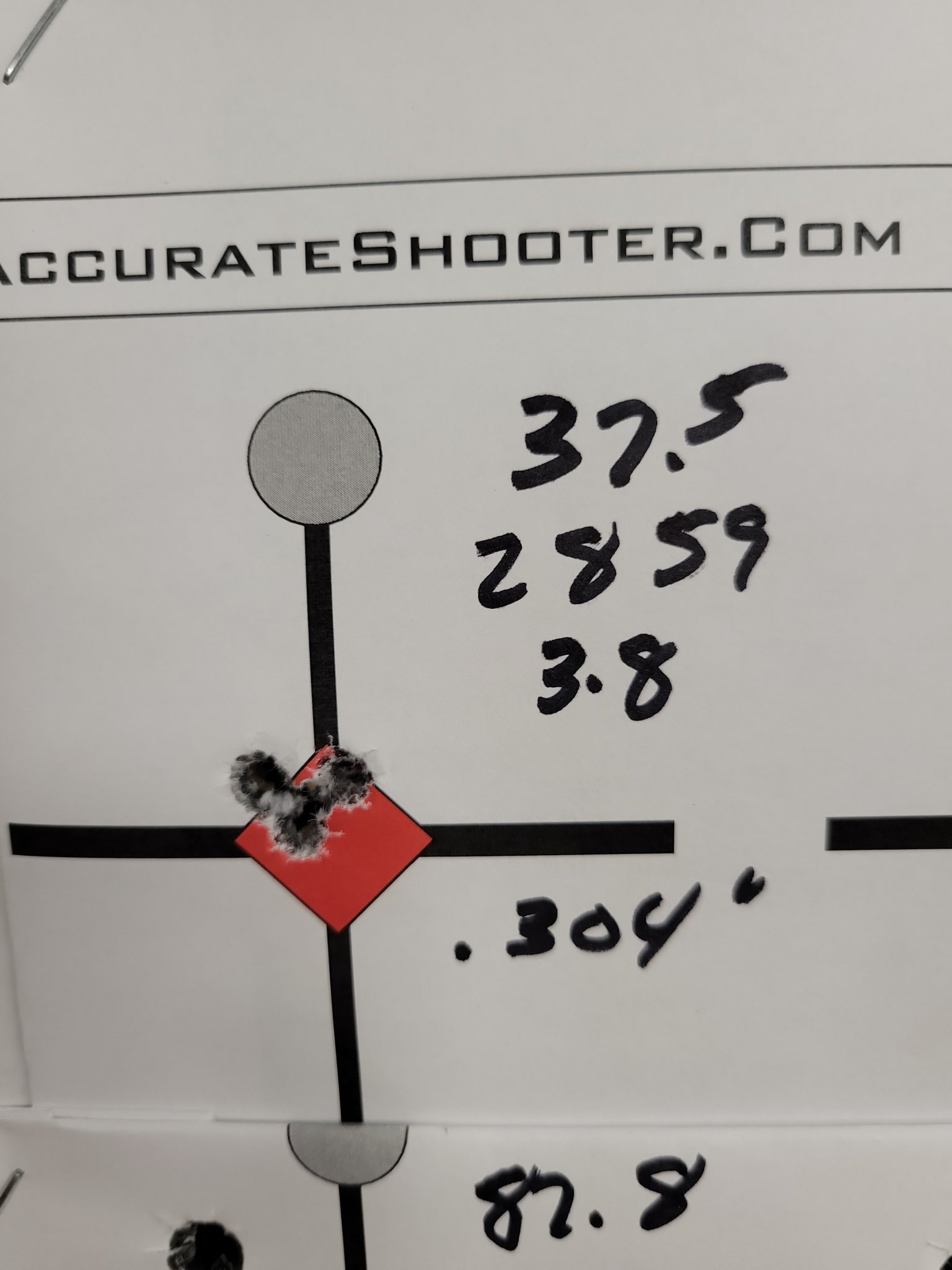

I am doing a final test this weekend. 2 good charge weights. I will shoot 1k for water line, best verticle wins. OBT on upper load is 37.6. 36.4 is the other OBT, on the money. We will see. TL3 in JAE with ZCO and Xcaliber straight taper at 27" - .120 freebore and 1-7.5 twist. Alpha OCD brass and Fed 205m primers. I could see my heart beating in the scope when I shot the 37.5 group. It was getting warmer out and I am still not 100% post knee surgery. I think that load can shoot tighter. I was just not shooting my best. We shall see how this goes. These were 4 shot groups. Garmin Xero and labradar capture.
View attachment 8338861View attachment 8338862
This will be the second year for me running the DTACS in a GT and so far I’ve been really impressed with them. To date I’ve shot my smallest 500 and 1000 yard groups with them. Last year I ran out of 109 ELDM’s halfway through the session and switched over to the DTACS. That barrel had a .120 freebore but was probably closer to a .150 from erosion when I made the switch. Even with the erosion I was below the neck shoulder junction and could only push them right at 2780 but it shot them lights out. That’s the reason this year we switched to the longer freebore.

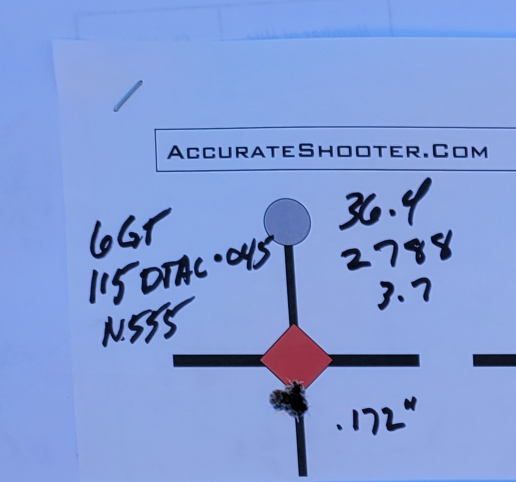

This barrel is still fairly new. I shot 110Atips at 2890 (37.7 N555) and was impressed with how flat they shot. I only had a few hundred but looked at all the high BC bullets available. I like Sierras too so DTACs were easy choice. I like heavier bullets shooting long range varmint silhouette matches, easier to see impacts at distance. I am right at or slightly into neck shoulder junction but not past it at .045 jump. .040 shot well too but .045 was slightly tighter, shot them both 3 times before settling on .045. I will go to the longer throat next barrel.

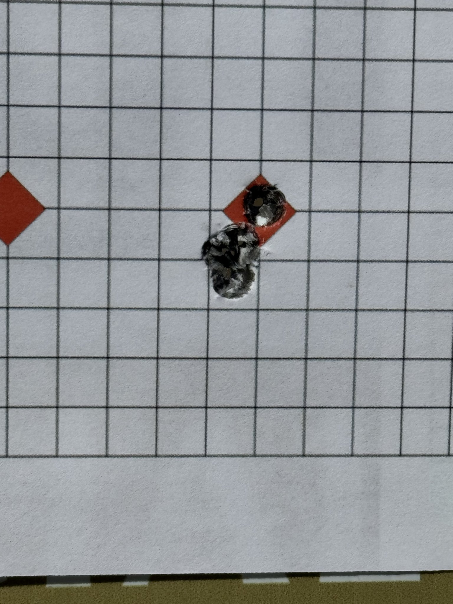

Just started load development with my 6GT. I wanted to narrow things down while I'm toying with virgin brass, and then finalize after my first firing.
27" Krieger, 1:8.
107gr SMK
Fed GM205MAR
Virgin Alpha
Varget
.030 off (1.945 CBTO)
Surprisingly, I was getting a wide ES (about 25-30) from 33.0 - 33.6gr. Once I filled the case up a bit more it came down. 33.6 - 33.8 knocked that in half with single digit SDs.
33.0 - 2,860 FPS
33.2 - 2,876 FPS
33.4 - 2,888 FPS
33.6 - 2,906 FPS (best accuracy, but need to tweak seating depth)
33.8 - 2,924 FPS
> 33.7 - Just shot to see what would happen if I cut 33.6 and 33.8 - is a winner, but need to tweak the depth a touch. This and 33.6 put (4) shots into the .2s, but kicked one out a half inch.
I will probably see how H4350 does next.
