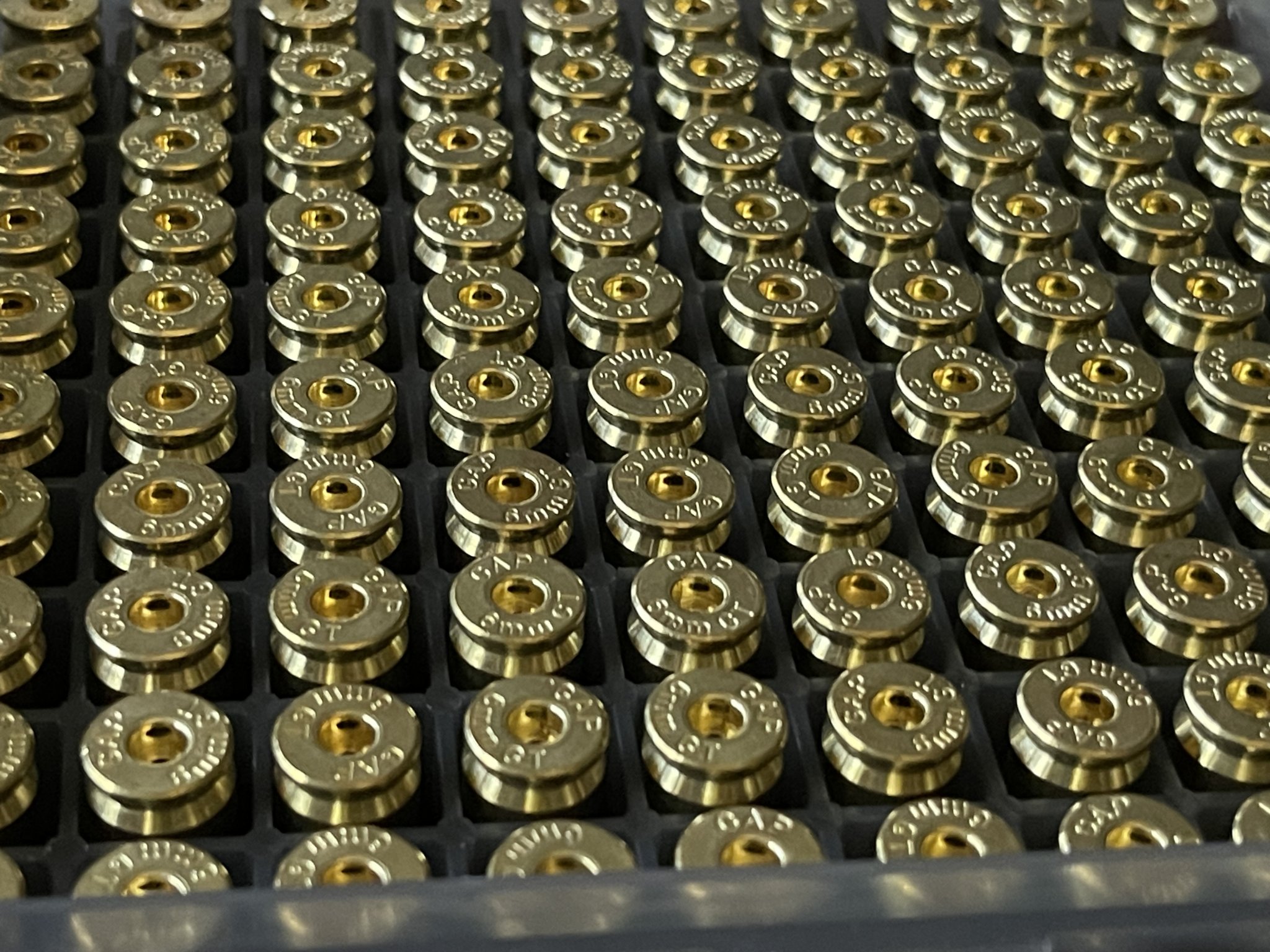

No loading today.....but I did knock out some brass prep.
This 100rd batch is now ready to prime, charge and seat.
Gonna sleep on it tonight and load 'em in the morning.

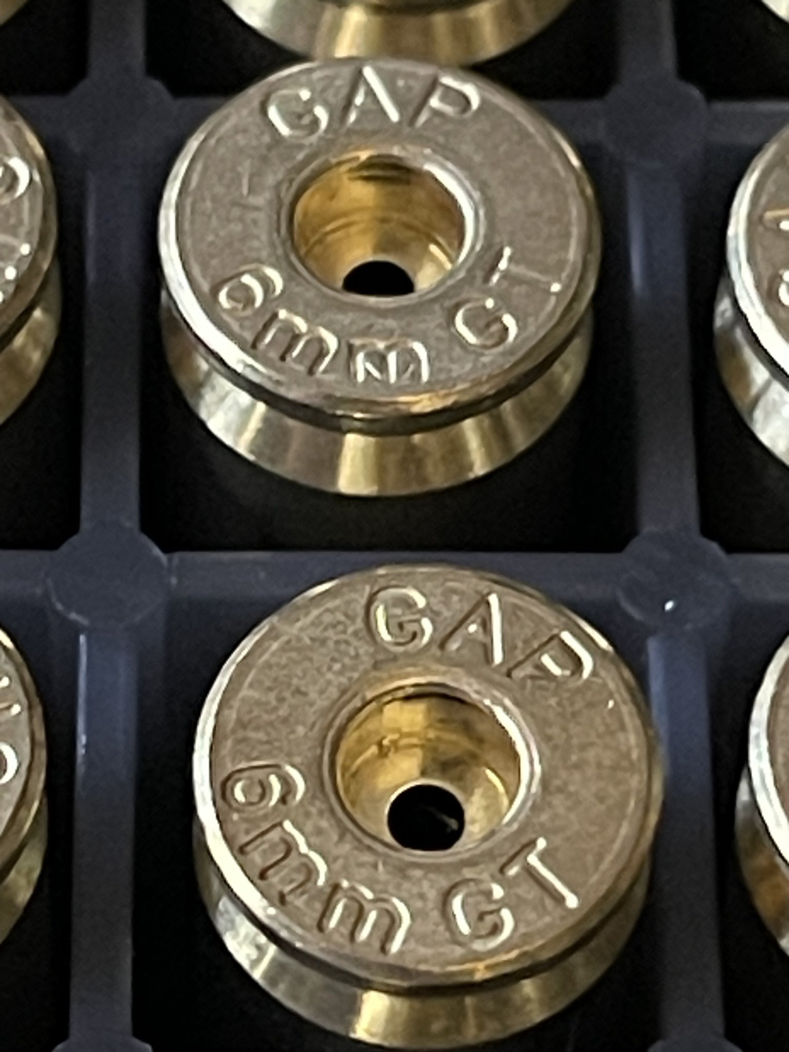

I guess I am the only ignorant one here - what am I looking at in the primer area in the first picture? Sorry, but I cannot figure it out. They are not loaded primers, but do not appear to be shot primers with a dent. What is that?
Reactions: John Glidewell
Shiny clean or new primer pockets... Reflections of the flash holes in the sides of the pockets?

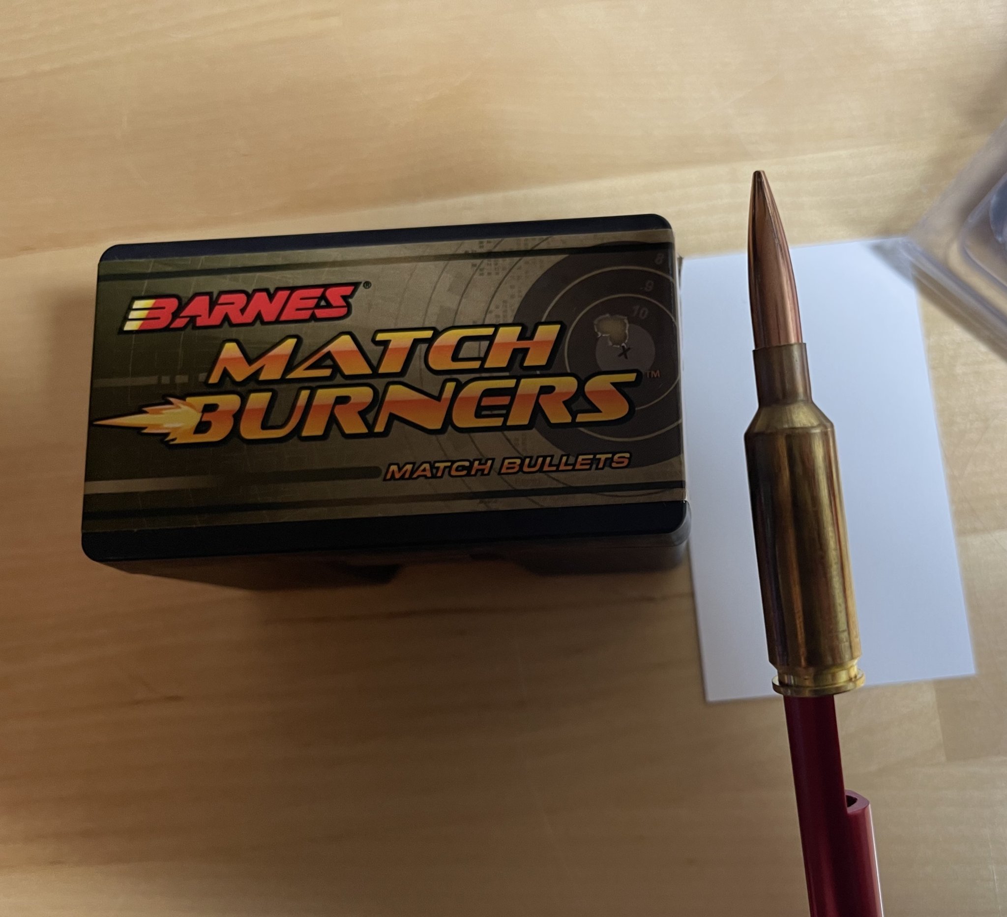

Great sales prices on the 6mm Match Burners this week at MidwayUSA.
Picked up 1,000.
Man I wish I had tried those. I really want to get away from the 109 hybrid bc I can't always find them and 2 for the price. I have read so much about the MB being inconsistent. I have to get some to give a try. If I knew my barrel would like them I would get 3k for the season.

The MBs are way more consistent than their price suggests.
The average reloader? Not so much lol 😂
I’ve been going back and forth between MBs and A-Tips and if I miss, it’s me, not the bullet’s fault.
Reactions: DubfromGA and Gogga

This is the 105gr MB.....representative of what it measures at jam in my barrel.
Gonna back it up and load 5-10 rounds at incremental charge weights and see how she does.
The fire is stoked.
Your posts on the MB gave me the confidence to try them.
I have some ELDM's & Varget set aside for this gun.......but I wanted to first get started with a more affordable combination. My local range sells SW Precision for $35-$40 / lb to range members. I've asked him to check on 8lb jug pricing. Until then I am trying to buy 1lb from same lot #'s.
105gr MB over SW Precision this evening or early tomorrow morning (y)
Hoping to find an accurate load in the medium-->3/4-ish charge range.
Thank you for helping get this plan going through your comments.
I'd have never tried them....and been unaware. Barnes, in my mind, was strictly all-copper hunting stuff.
Mighty glad to learn other wise.
Reactions: Gray shooter

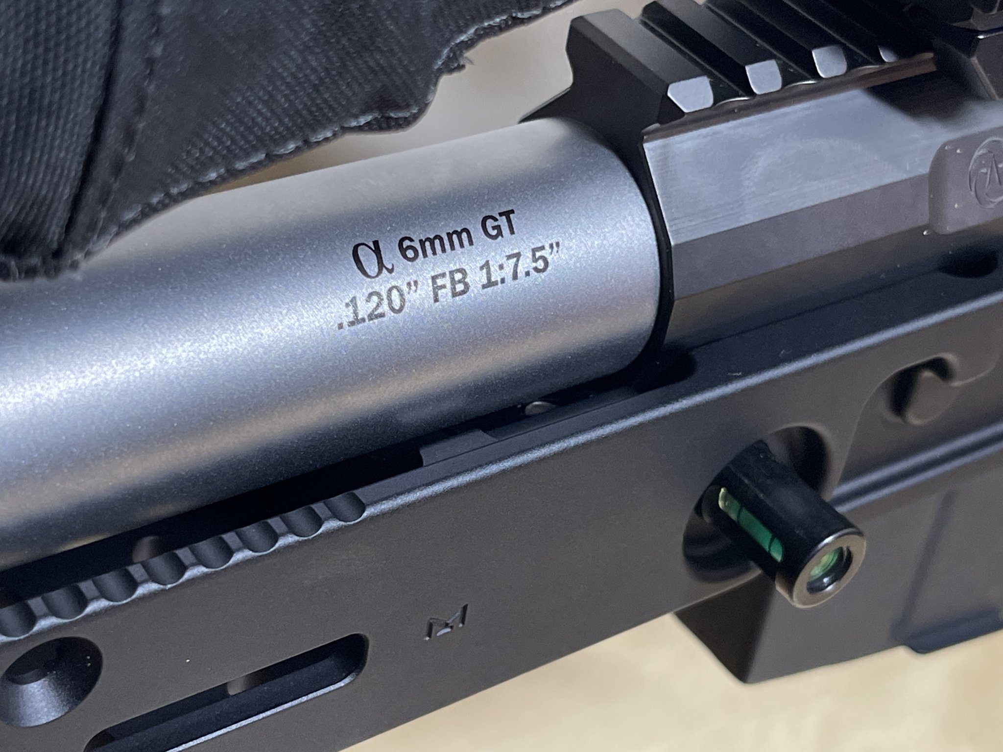

My barrel was cut with an Alpha Munitions Legacy Reamer with a .120” freebore.
Anybody have any advice or suggestions applicable to me and my chamber? I do not know anything about it other than what I wrote in the line above this one, well, other than the rather obvious math of .170-.120 = .050"
Only that you might have a hard time getting the longer/heavier bullets in there like 115 dtac. Otherwise you’re good to go. My latest barrel was apparently NOT cut with an Alpha reamer and now need to go through and small base size all my alpha brass
.120 freebore is perfect for 100 - 107gr stuff. Once you get into exclusively the 110 A-Tip through 115 DTAC, I'd probably look into the .170 just to get optimal performance. 108/109 works great in either from what I've seen, and I have run them with success in my .120.
In all reality, we're talking only .050 difference. There are a lot of cartridges with a much wider freebore gap (.223 comes to mind) when it comes to which is optimal for specific bullets.
A .120 versus .170 freebore will just limit how much you can jump, with heavier 109+ bullets you’ll be lucky if you can go as much as 20 thou off, chances are you’ll have to go more like 10 thou off… that said, it’s not a huge deal.

@Malum Prohibitum, 170fb is good for everything in my opinion. My ladies backup barrel is 170fb, and 105hyb shoot very well 60-80k jump at 2950fps. 109s shoot great jumping 40k at 2920. 115s at 2840fps jumping 20k. If. You only plan to shoot 105/107gr bullets, go 120, but if you're gonna go heavier, run the 170fb
I don't have a choice at this point in time. Maybe on the next barrel.
For what it's worth, you actually can have your gunsmith lengthen the throat, if desired, using a throating reamer. Obviously, if you had a .170 FB, you couldn't get to a .120 without setting the barrel back, but going longer is relatively easy.
Reactions: Malum Prohibitum
Or... shoot 1000 rounds, and you'll pretty much be there anyway? LOL

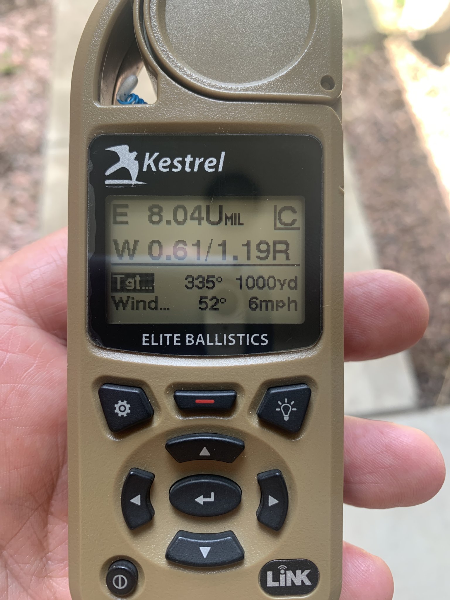

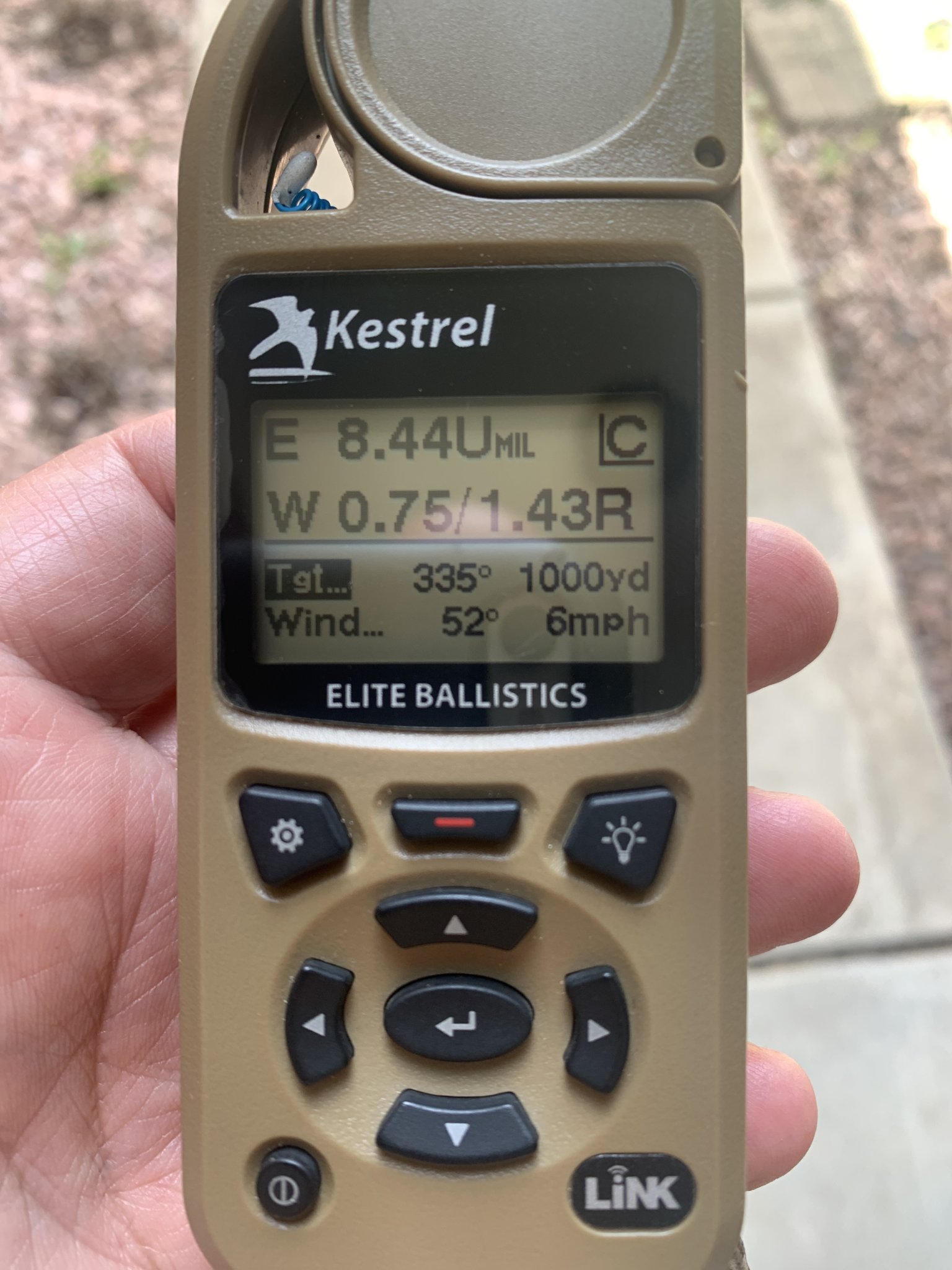

What's really enlightening is looking at how much of a wind change will push you off a target at a given distance. I don't really care what number I have to dial on the elevation turret (as long as its consistent) - and I've learned not to care what the exact number I have to dial/hold for wind is, either. What helps me the most is how wind tolerant the bullet is - how much can my wind call be off, or how much does the wind have to fluctuate before I'm off target. And then how much retained energy at each distance...
I did an analysis between a bunch of 6mm bullets before I ended up selecting Berger 108 BTs (they were available, which was important, but I could've waited or bought a smaller amount, etc). What's nuts is how little difference there is between most bullets for wind tolerance. Consider a 2 MOA target. At 1000 yards using the same muzzle velocity, every bullet I looked at but one had a wind tolerance of about 2 mph - and one that was better (the A-Tip, of course) was only 2.5mph. It's not a lot of difference in terms of keeping bullets on target at distance. The A-Tip and the Berger 109 both have a bit more tolerance at 600y than the others. (5mph vs 4 mph).
Where I *have* noticed the difference is retained energy. I'll hit targes at 1000 and there's not a whole lot going on (467 ft lbs at 1000), where an A-Tip at the same starting velocity will have more than 20% more energy...
You’ll have more wind change with 108’s than you will 115 DTACS. I’m finishing out an old barrel right now using 108 BT’s and there’s definitely a difference between the two.
6mph and 10mph
108’s
115’s
6mph and 10mph
108’s
115’s
DTACs weren't part of my analysis (at the time, they were seemingly less available than berger 109s) - but to do apples to apples - what's the spread between W1 and W2 on your Kestrel, there?
To be clear, I'm not saying DTACs are in some way inferior (or any other bullet, for that matter). By BC, the DTAC should be in the same situation as the A-Tip as far as my analysis goes. My point is that there's not a dramatic difference on target vs. the ability to make a 100% accurate wind call, and the ability to read changing conditions (but that retained energy - and therefore ease of spotting hits/misses at distance - is definitely significant).
Reactions: Gogga and drglock
Wind 6mph and 10mph
108’s .7 spread
115 DTACS .6 spread
Doesn’t sound like much but you’d have to push the 108’s at 3000fps to get them the same as the DTACs
And yes it all comes down to making good wind calls no matter your bullet or it’s speed
Reactions: davere and Gogga

I ran my numbers at 90 degrees (vs 52) - which should pull you down to about a 2mph change crossing .5 mil with the 108.. and I'd guess about 3mph with the DTAC (same as A-Tip). Don't have my Kestrel in front of me to do it myself, but looks like that'd line up. But at 1000, you've got what, 550 ft/lbs retained energy? Maybe more? After shooting these 108s for a while, that's actually a bit more significant for me than the wind difference at 1000 yards.
