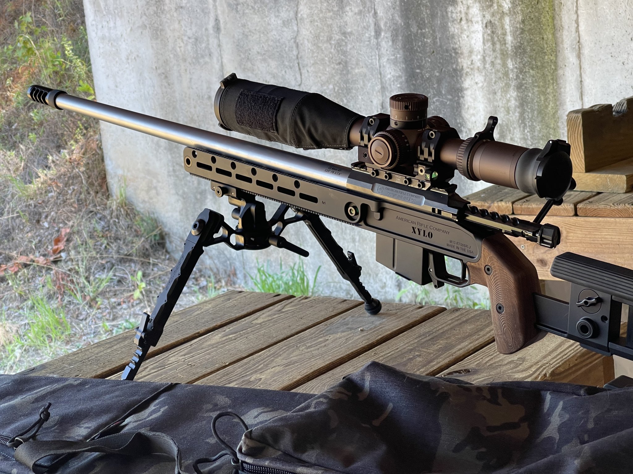

Just got a 20 inch 6GT barrel in from Altus, very impressed with how it works. Had a few loaded rounds left for my 26 inch match barrel so I shot those through it. 65 rounds total today hammered all day long. MV 2752 SD 7.5 The same load in my 26 inch barrel does MV2890 SD3.1. They did the badger EFR in the stock as well. Great stuff, very happy with how this thing is coming together!
Haven't gotten into my 2nd GT barrel, yet, so I haven't seen it there, but definitely seen it with other cartridges - especially when swapping barrels. Basically, the very bottom of the case isn't getting sized down and eventually expands just a bit.

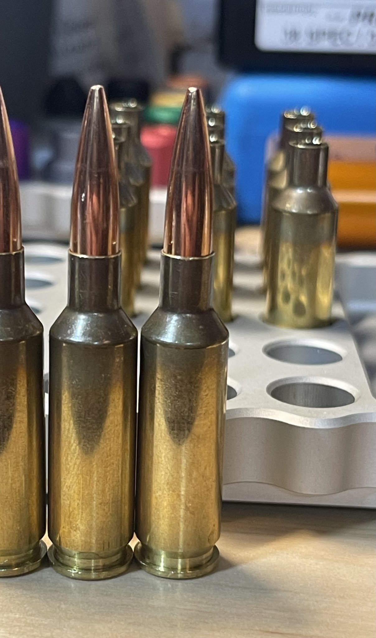

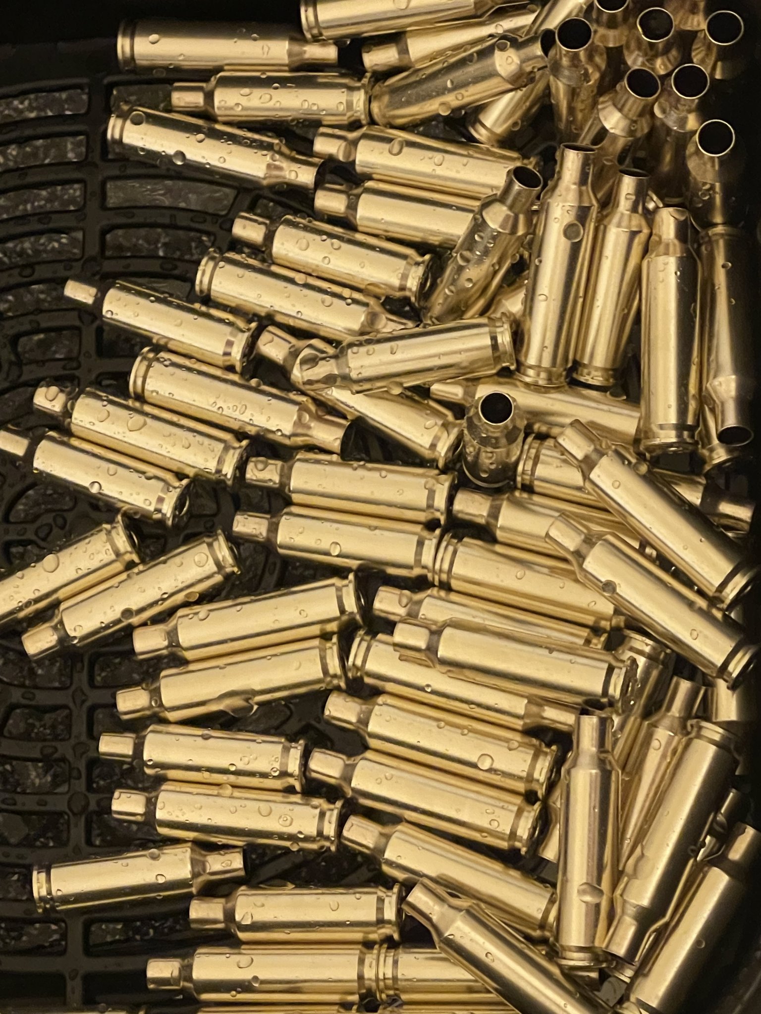

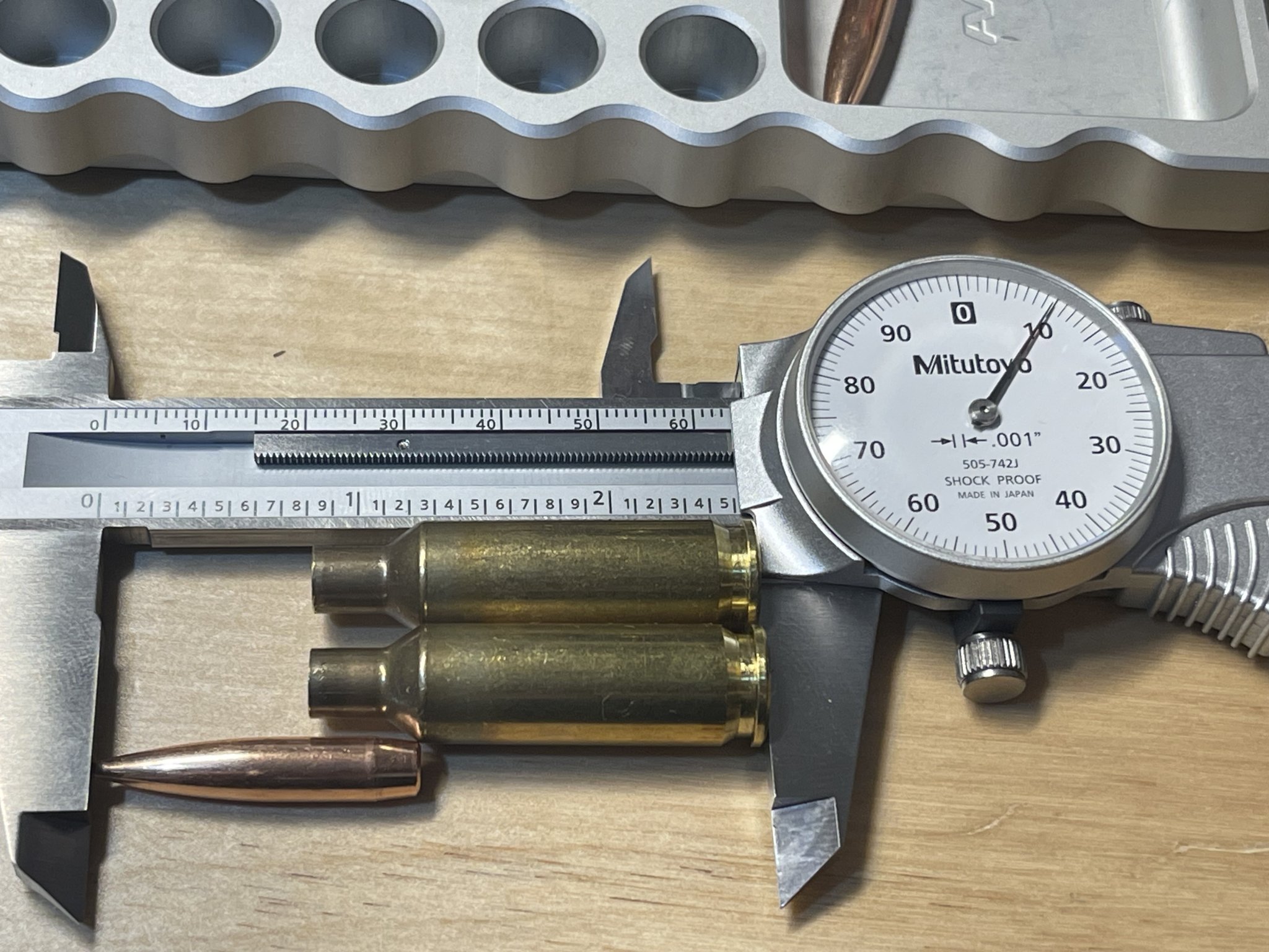

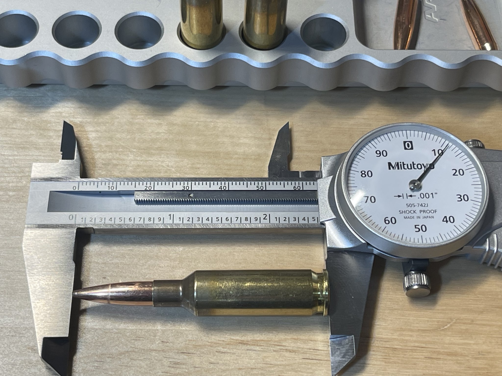

The fix for .308 case head size cases is actually surprisingly easy (at least, it has been for me, in the past). Get a Lee .45 ACP U-die (undersize sizing die), take the decapping stem out of it, and run your cases through it. It's a carbide die for a straight wall pistol case, so it's just a sizing ring - won't bump your shoulders or anything like that (which is something that *will* happen with cartridges that have a small base die - to full size the base, you end up squishing your shoulders back a lot, too). Then do a normal sizing die pass.
OMG I'm so glad I found this!! Thank you for posting this solution. I'm getting ready to go from barrel #2 to barrel #3 and I COULD NOT get my brass to freely chamber in #3. Thought I was going to have to scrap almost 400 pieces of 4x fired Alpha.
Interestingly- Hornady, Widden, and Forster 6GT dies wouldn't size far enough down the base but my buddy's RCBS Matchmaster would.
Also running the brass through the Lee 45acp undersized die works for me as well.

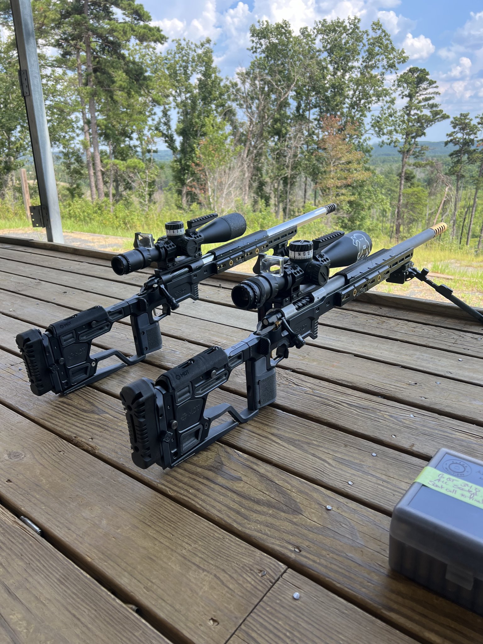

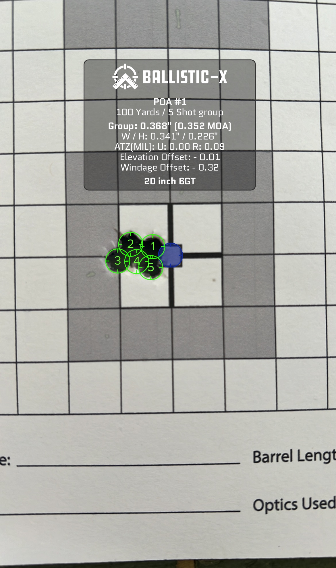

View attachment 8457507View attachment 8457508View attachment 8457509View attachment 8457510
looks good got lapua brass on back order & ordering a barrel fro krieger already got rifle just going to switch barrels
Redding dies, too, for calibers they make. I ran into it initially with 6.5 Creed. No one made a small base die for it - was trying to figure out other options - but didn’t want to set my shoulders way back, either.
I forget where I came across the .45 ACP die trick - here or accurateshooter.com, most likely, works like a champ!
Or just buy a RCBS matchmaster fl bushing die. It sizes tight as hell. My original 700x pcs 6gt ocd from 4 years ago, has idk, 8-10 firings on it. Several barrels now. I don't run hot, 2850-2950 with 109-115gr bullets in 28" barrels with H4350. They still come out the die @ 470-47025 using my micrometer. Never had a clicker cept when I sized one rotation with a BC Micron die that I bought on here. The RCBS sized the web down almost 001 smaller than the spendy BC die. Sold it very shortly after, ran all that brass through the RCBS, clickers gone.......

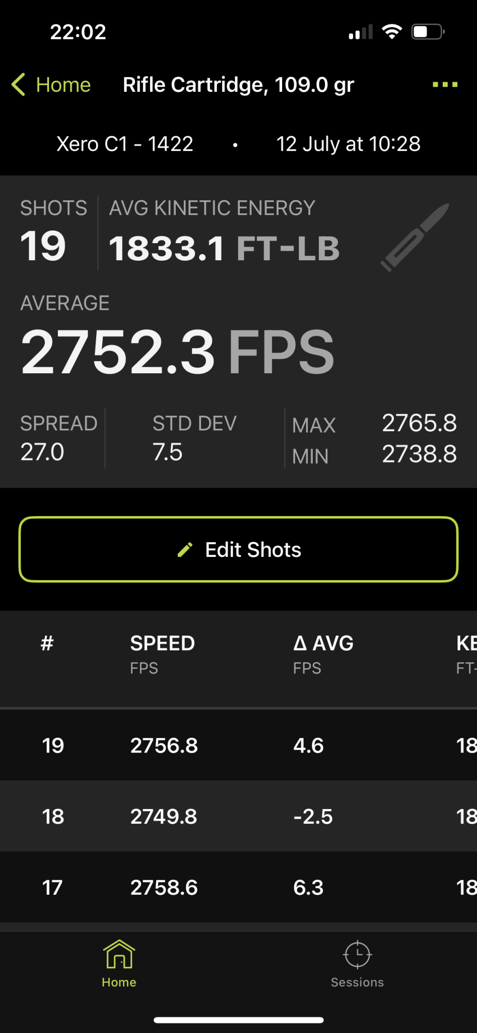

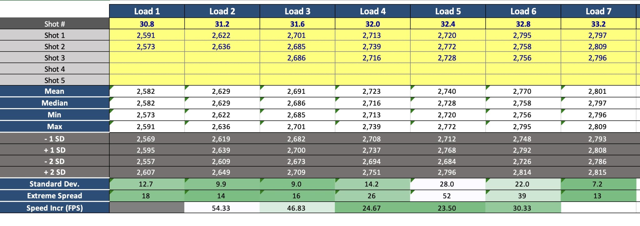

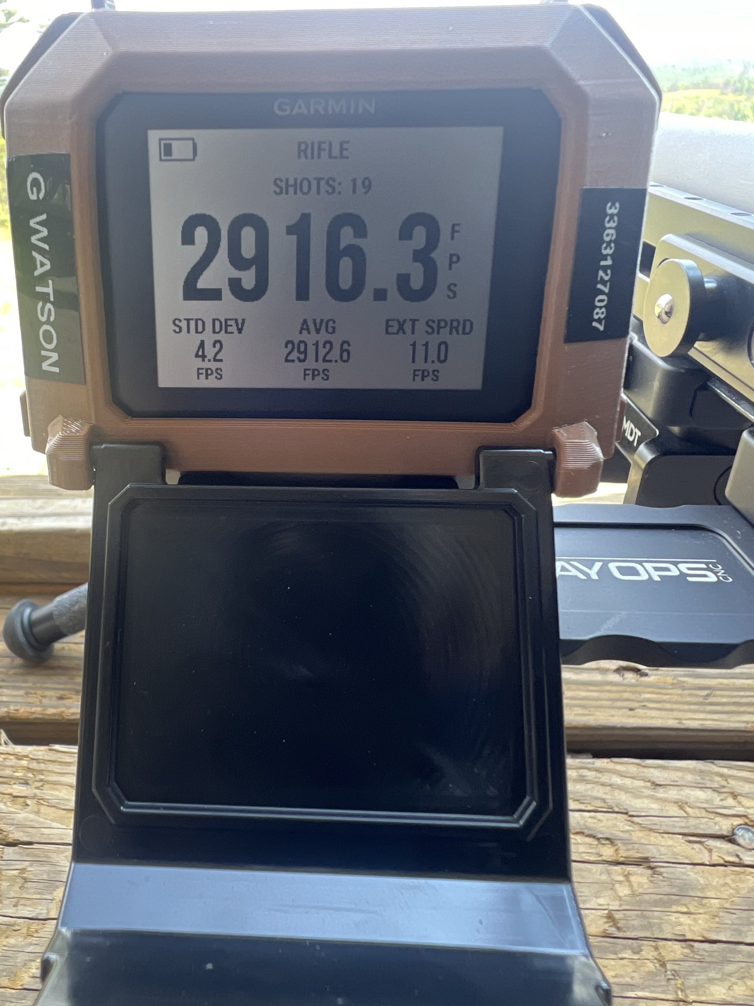

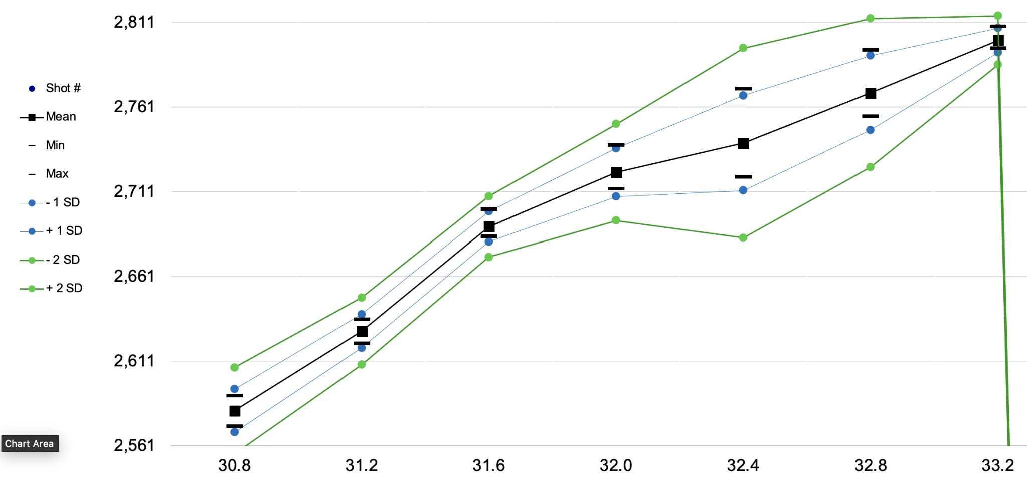

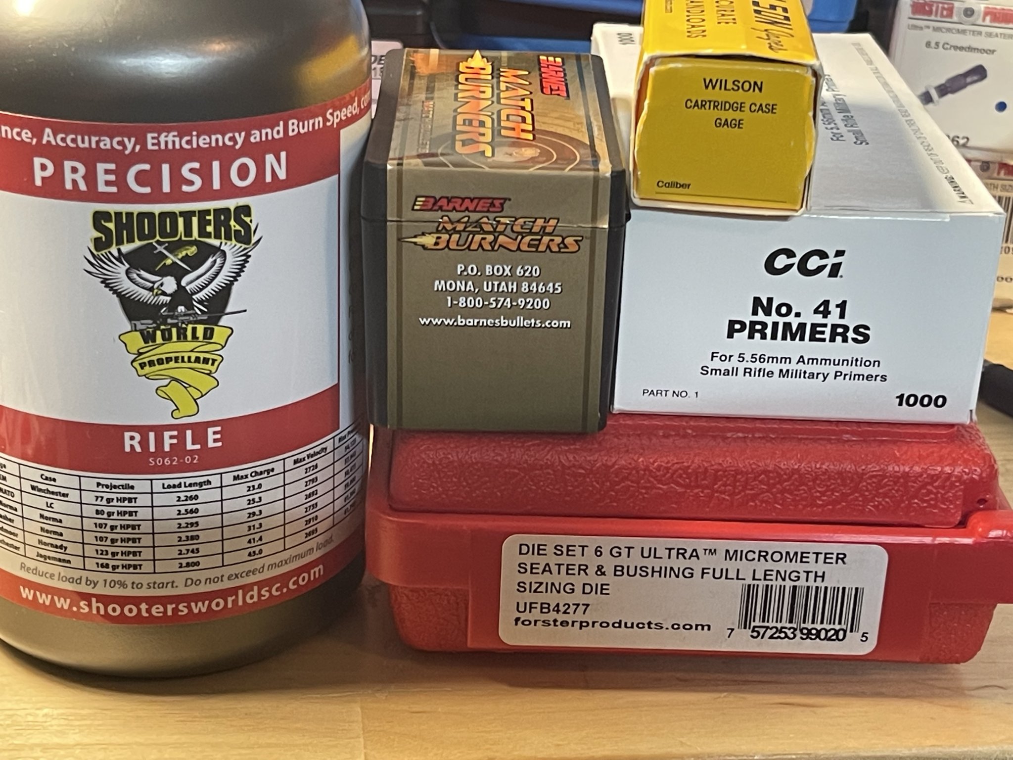

Loaded some incremental charges of SW Precision pushing 105gr MB last week.

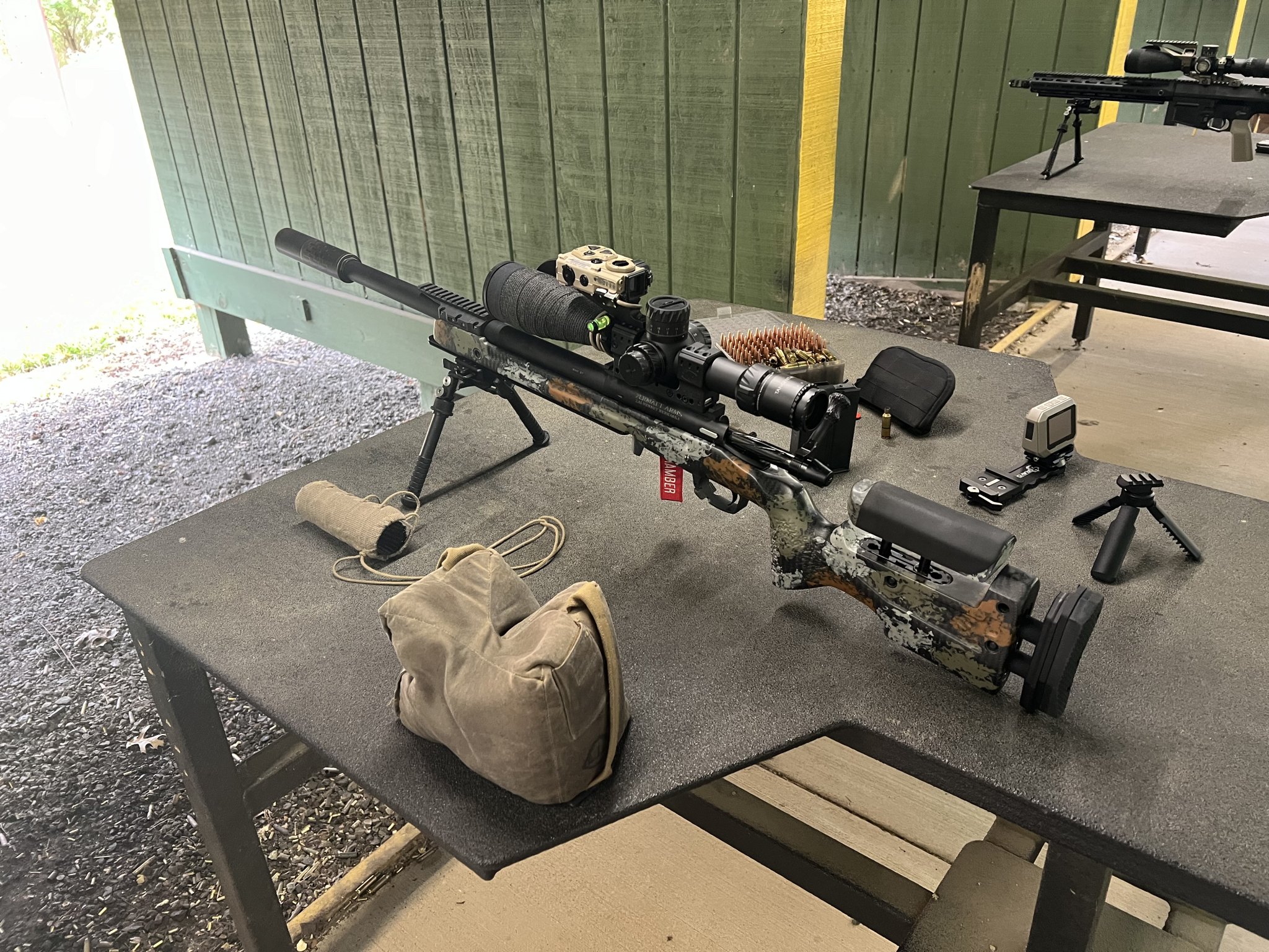

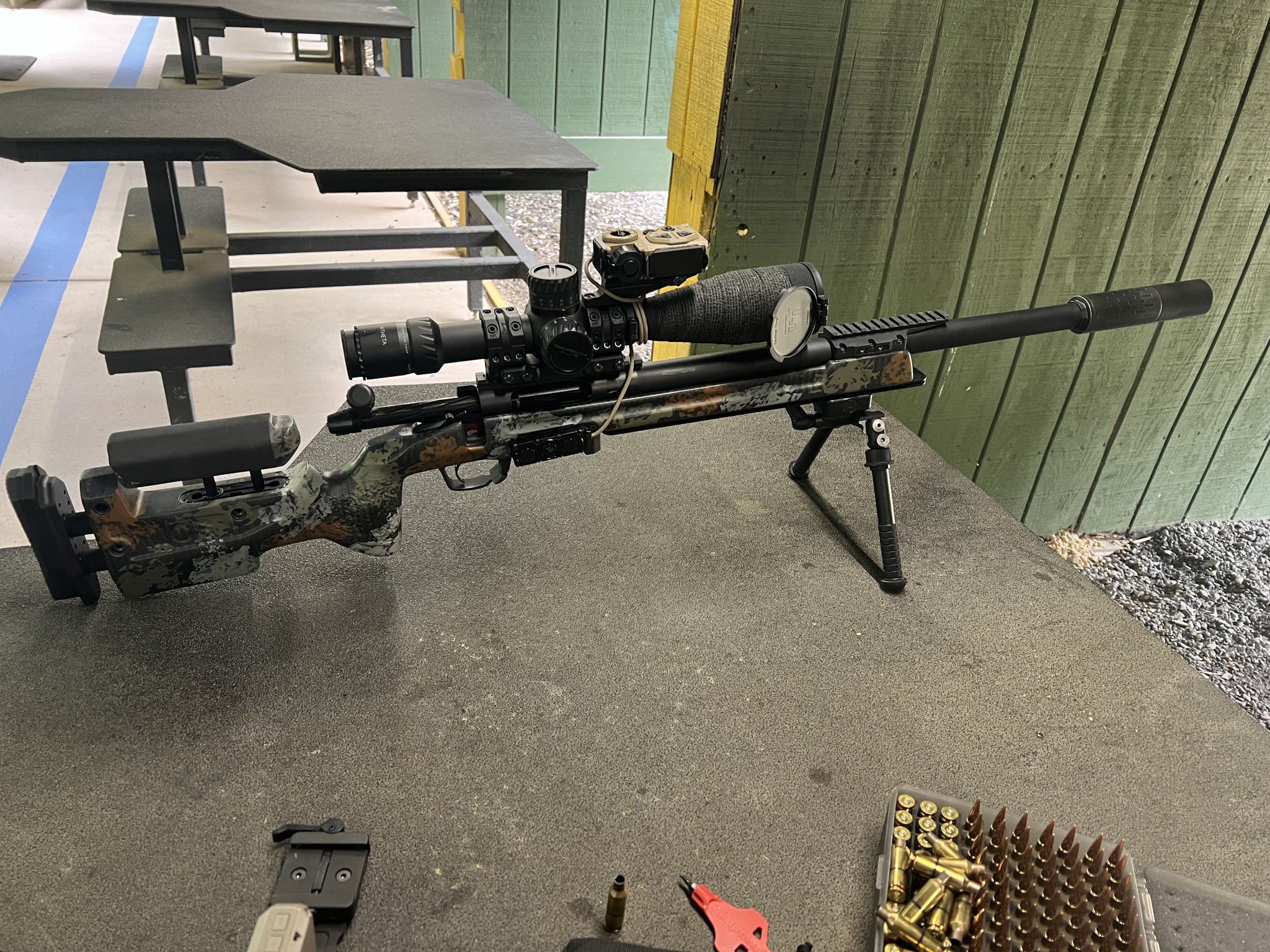

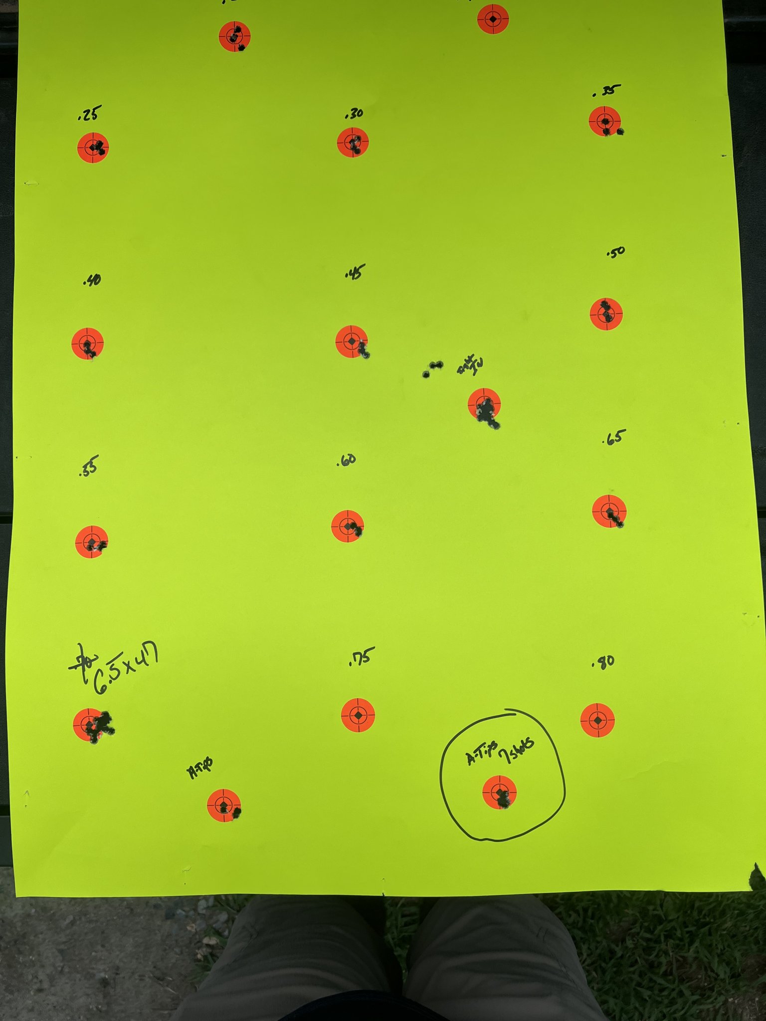

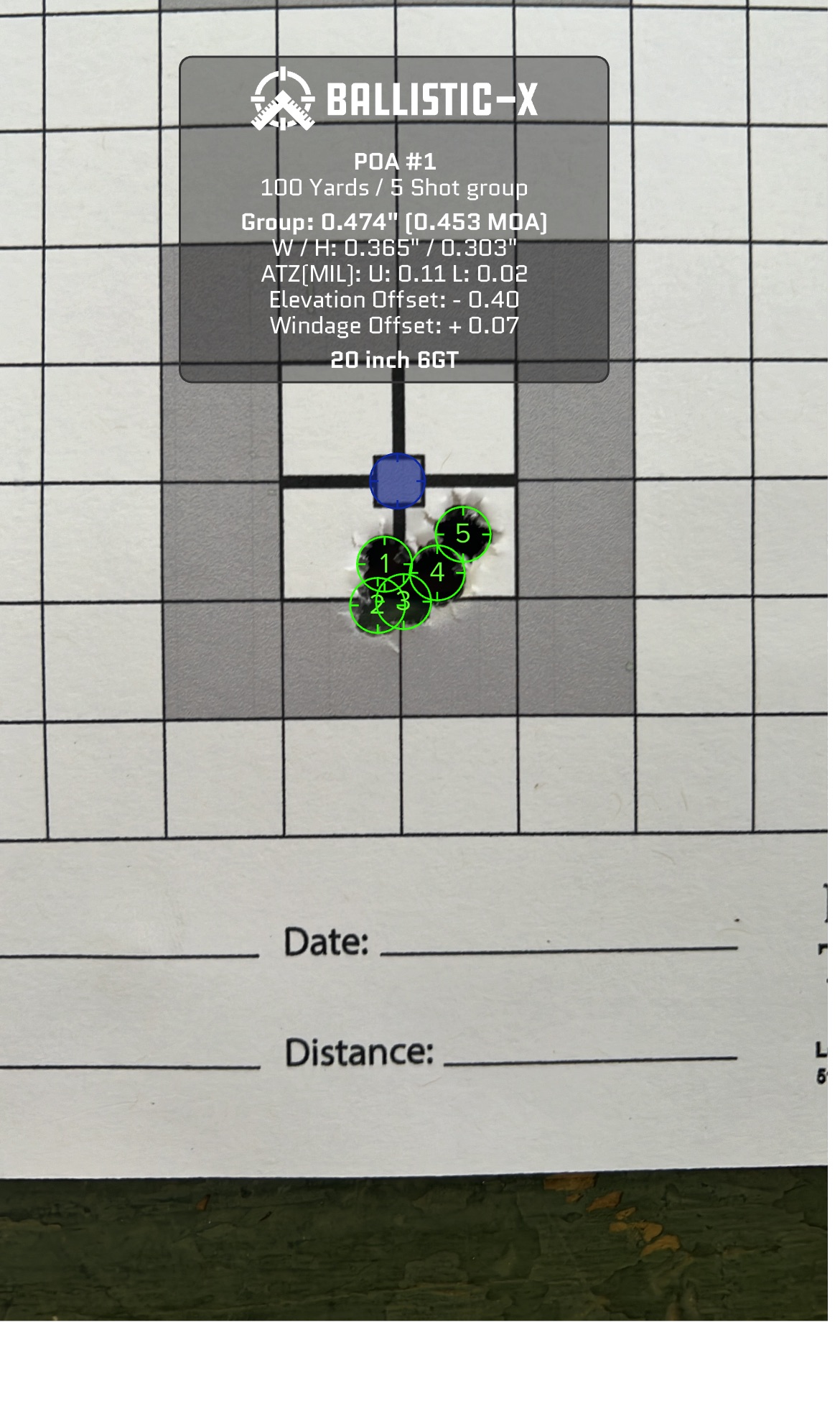

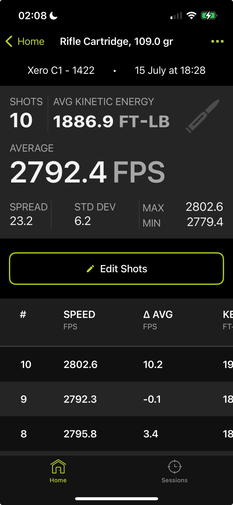

Went to the range yesterday....finally had a chance to shoot the new 6GT rifle.
No pressure signs whatsoever.
Will load some more at 33.8gr for next session.

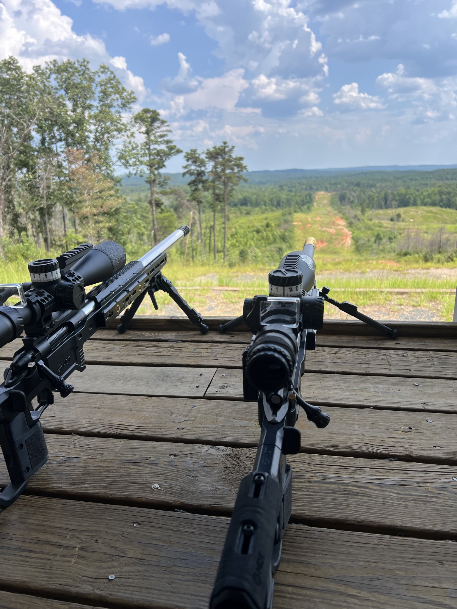

Also took a 6.5CM to shoot.
Brass was deprimed & cleaned when I got home.
Zero feeding problems whatsoever with the 6GT in AIAW mags. Gotta love the irony of a magazine labelled "arctic warfare" running like a champ in hot as balls, humid has hell conditions. :giggle: The gun ran great.
The 6.5CM fed like shit. Could hardly get through a single friggin magazine without trouble.

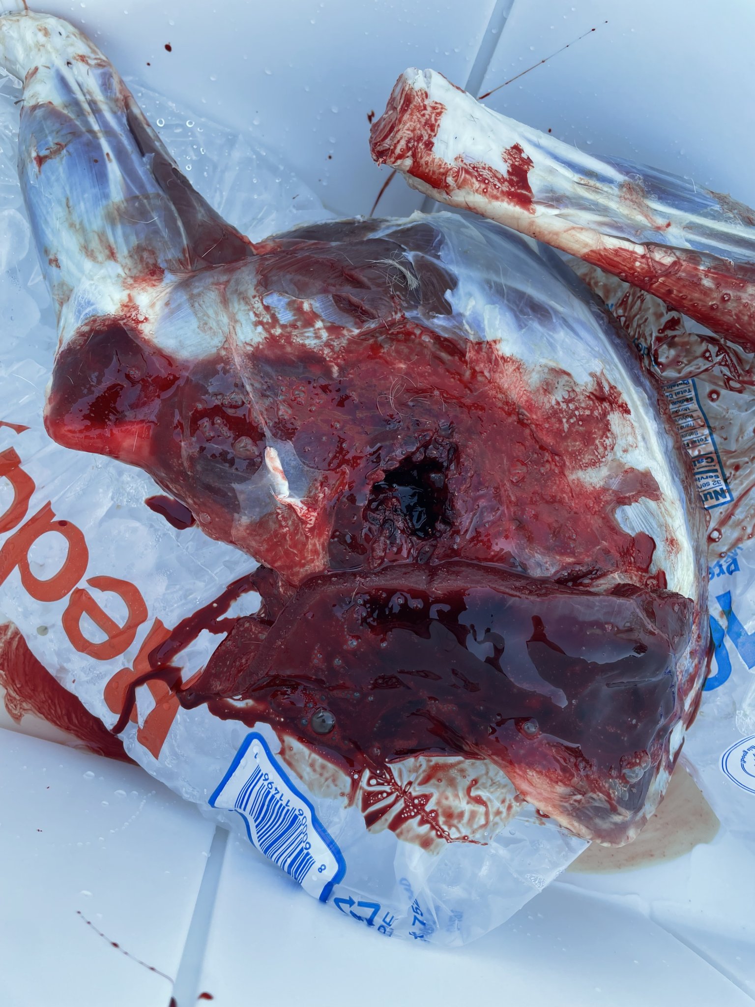

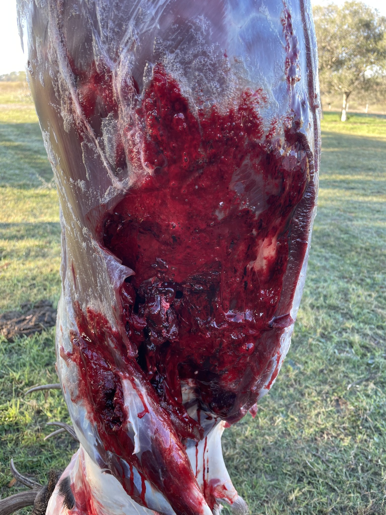

The 108eld-m (and I assume 109s) are straight murder seeds on whitetail.
I shot berger 140 elite hunters (260) last year and they are violent especially sub 100yards.
Both pics are exit side. The shoulder hole would be the armpit essentially. Shot at about 75yds

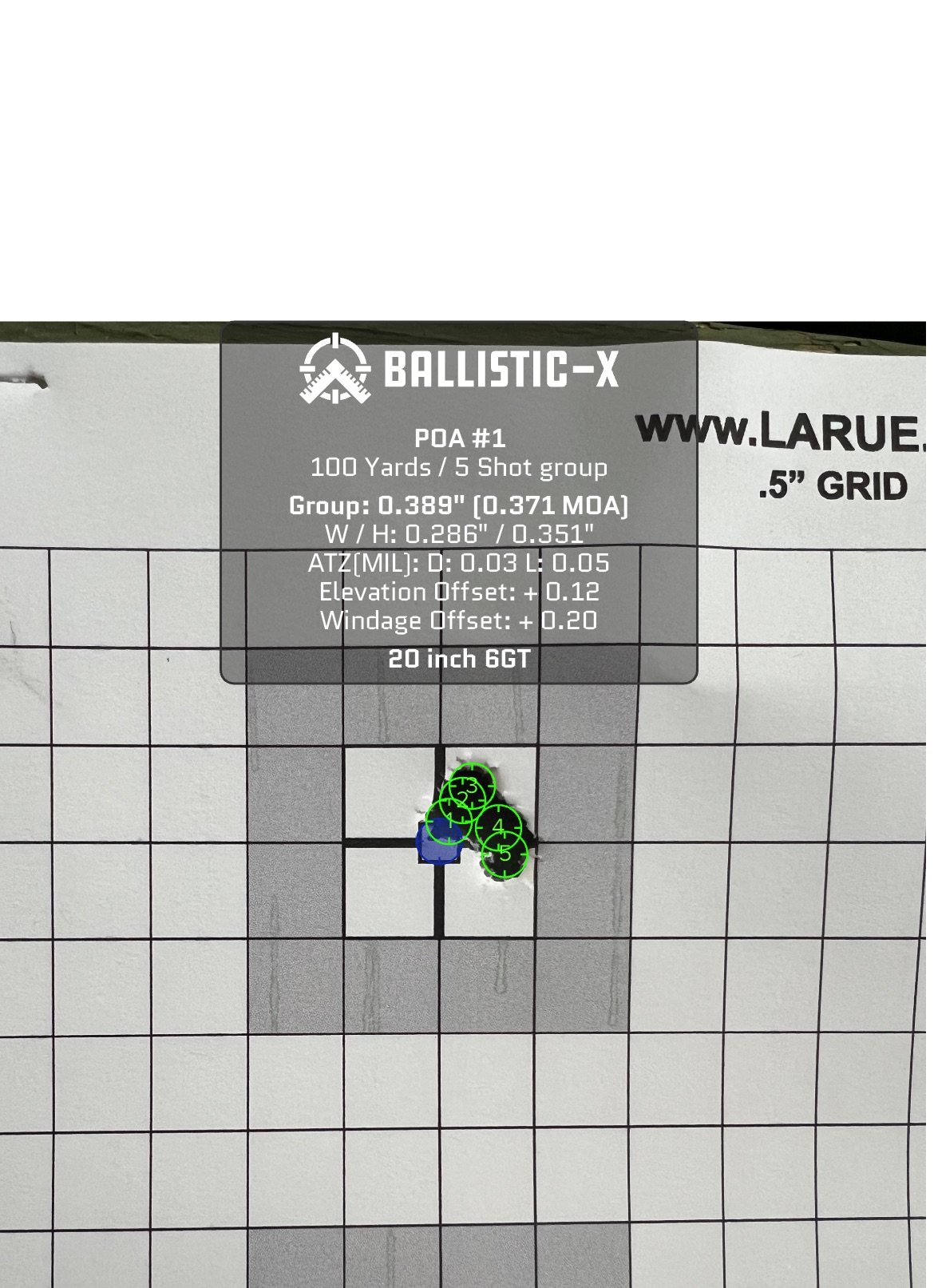

I'm no brain trust but, I built a 20 inch GT because I already have all the stuff for it. I have a match barrel but I rarely shoot bolt action PRS stuff anymore. Love the cartridge so I gave it a whirl. Last time out my load of 33.4 gr Varget gave these results. This was rounds 100-110 out of the new barrel. I think in the next 100 rounds or so it should settle in right around 2800fps with a berger 109lrht.
That's awesome info thanks! How do you like the setup?
That's moving right along! I just ran 107smk though the womans 26" 7.5tw Hawkhill 237 bore barrel, 33.4 and they were going 2860. Has bout 160 rounds on it. This exact load did 2950 in her prior 7tw Hawkhill. Less twist, 50k longer freebore, and lower round count must be a lot the difference. I ran same exact load of 35.8hr H4350 w/ 115 dtacs in my 30, 28" 26" barreled rifles one day, there was only 50fps between all three. These were all Alpha 170fb hawkhill 7.5tw 237 bores from same batch of steel. So not quite apples to apples, but close.
Really liking the setup. Not exactly light with the TCS and M24 contour but a lot handier with the suppressor on it for sure. Those 26 inch barrels are great for the game but get long quick with a can. The load is the same as it was for my 26 inch proof prefit match barrel and at this point I don't see a need to do any further development. It's nice when it goes easy for a change! The 26 inch was running 2890 fps with the same load.

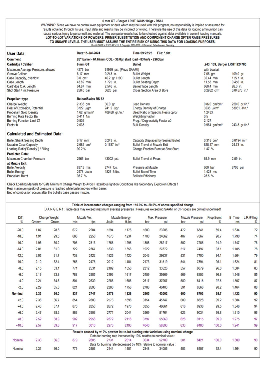

So assume you are a complete noob, and you have the following barrel:
  • Bartlein M24 Contour Barrel (26" Finish Length)
    -1:7.5" Twist
    chamber cut with Alpha Munitions Legacy Reamer with a .120” freebore
A big jug of Varget, a bunch of virgin Alpha brass, and the following cache of bullets
  • SIerra 107 Matchking 1000 rounds
  • 106 A-Tip, 1000 rounds
  • Berger 109 LRHT, 500 rounds
  • Berger 6mm 105 VLD Target, 500 (these were supposed to be 109 LRHT, but . . . when they arrived I saw only the yellow Berger boxes and just assumed the snipershide member shipped what he said and what I paid for. Imagine my surprise when I unpacked them weeks later, a little too late to complain, lol)
Which bullets would you use to start?
I was leaning toward the 106 A-tip. These are the factory "seconds" that everybody is having good results with. Then maybe when those run out switching to the SMK 107, then maybe getting into the Bergers.
My thoughts are mainly the price. I spent by far the least on the 106 A-tip seconds, so I thought maybe to use those up as I am learning and going to the SMKs next as the next least expensive bullets.
