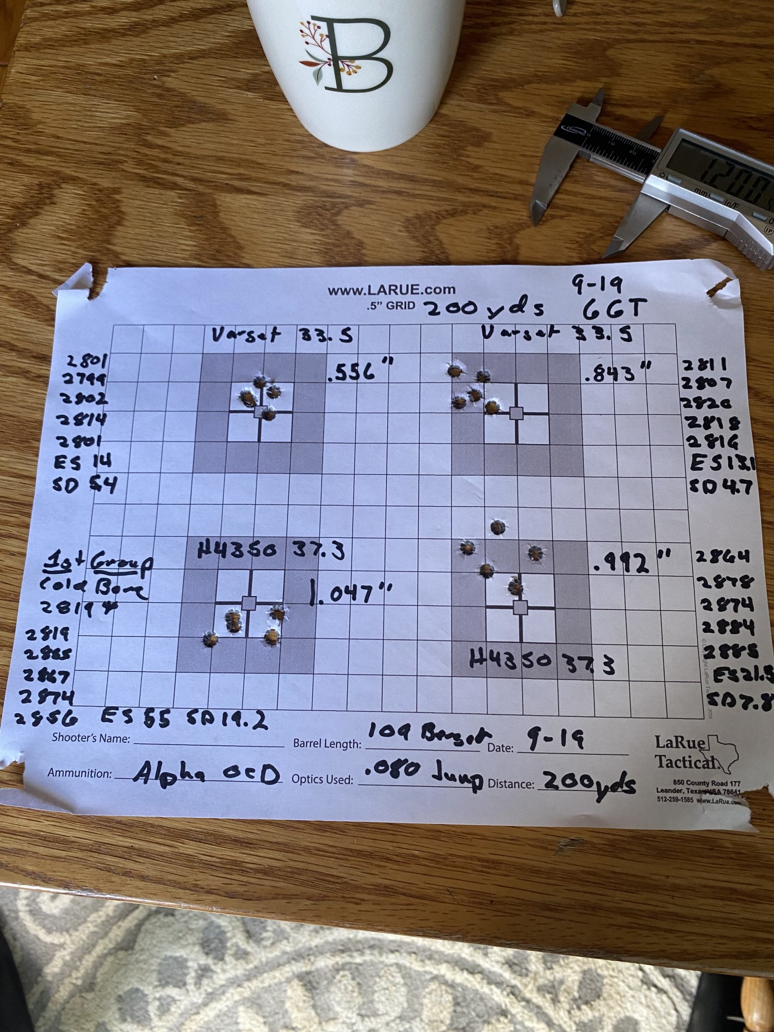

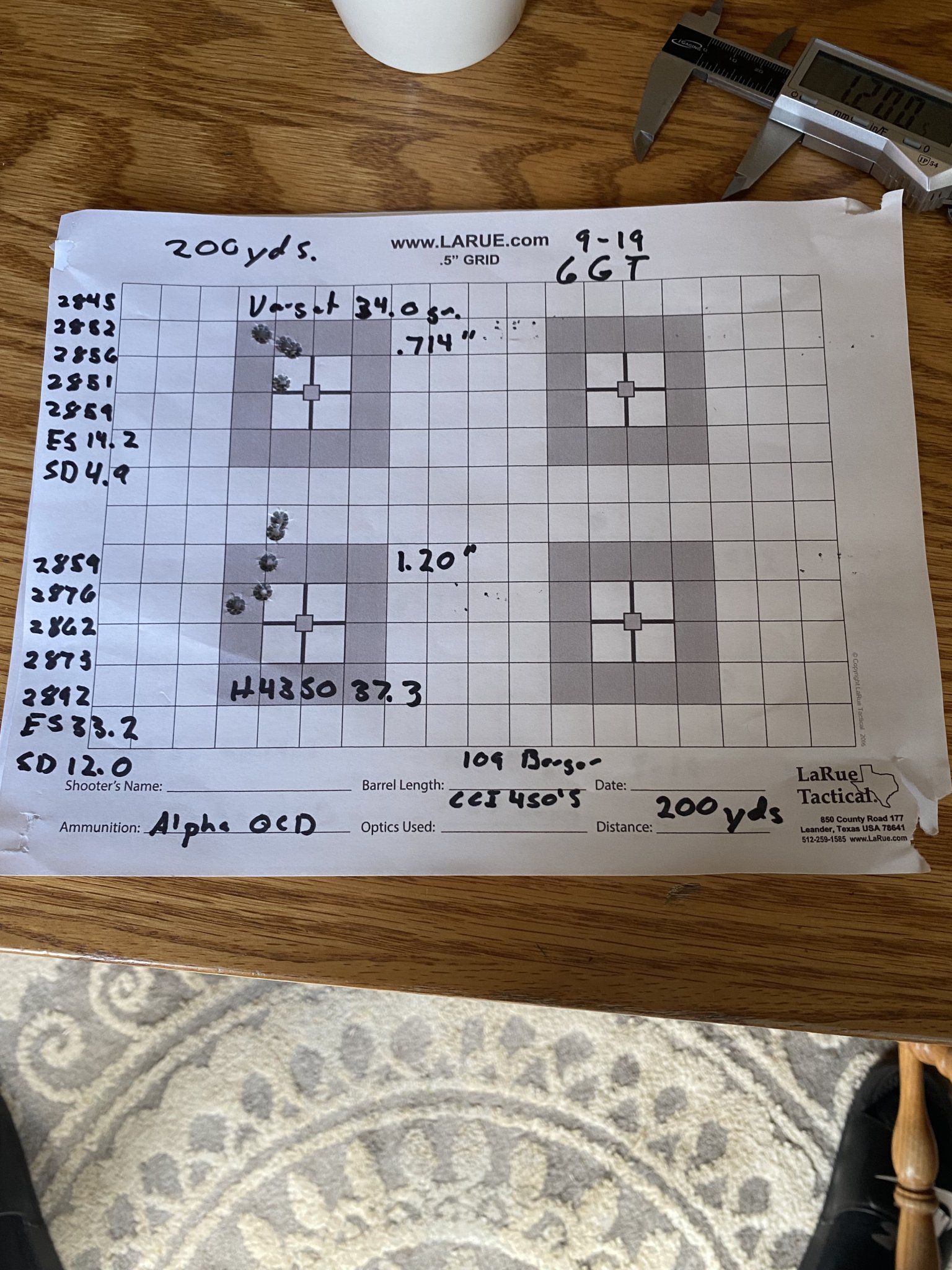

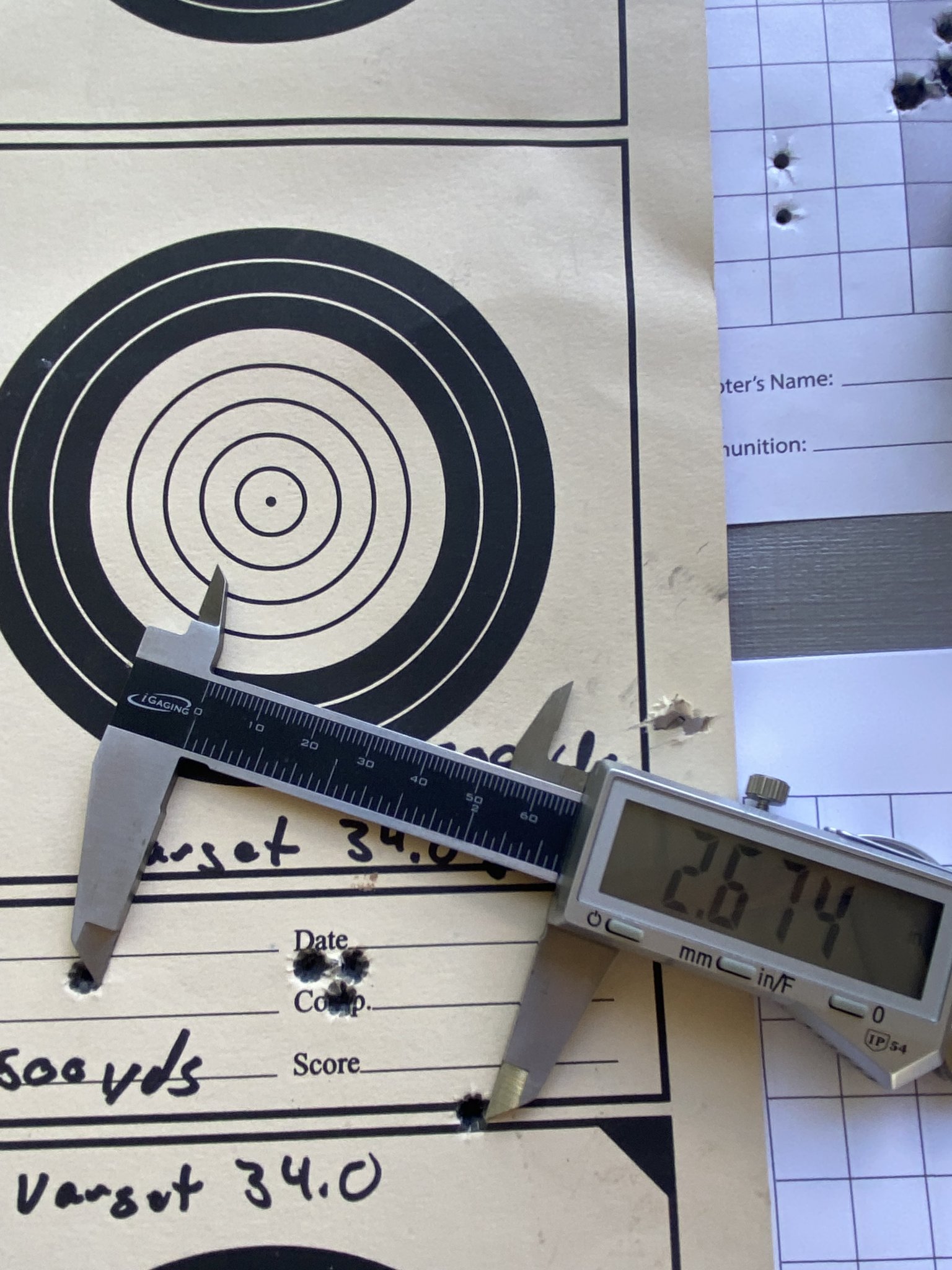

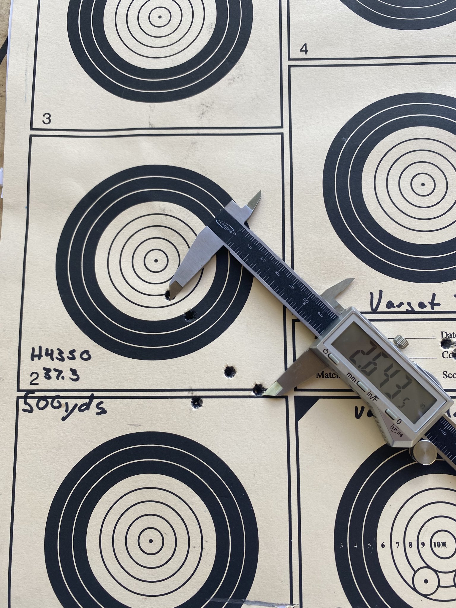

Took the 6GT out today, shot 3 groups with H4350 and 3 groups with Varget @200 yards. I would have to look at my notes but the velocities do seem to be increasing, round count is now at 150. Varget at 33.5 gr performed well and outperformed H4350 w/ SD’s, group size,and extreme spread. Varget at 33.5 gr averaged just over 2800fps, need to look at what others have posted to see if that’s below average too? I pushed Varget up to 34 grains and even though the velocities didn’t quite average H4350 velocities, I began having heavy bolt lift and smearing in the case head…..not sure why that would be. I also rushed and shot two 5 shot groups at 500 yards, I like the consistency between the two powders, they performed essentially the same. I didn’t have any more of the Varget 33.5 so I had to use the 34.0 gr. Nobody else at the range had a chrono to cross reference but I don’t believe it’s the Garmin. Going to load up some more Varget and get Strelok set up.

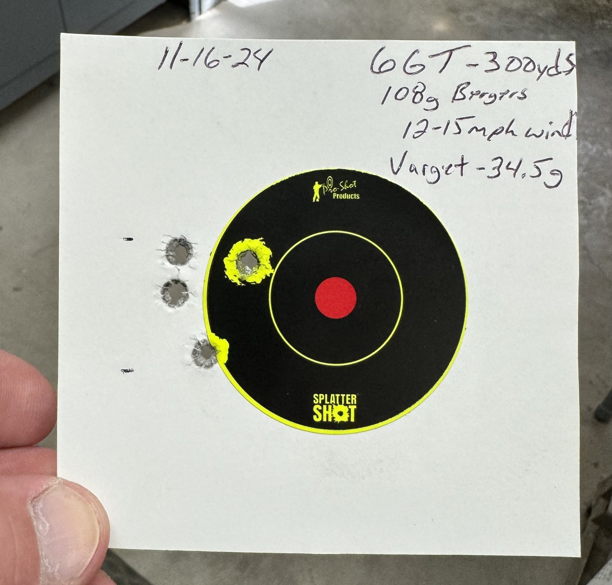

Was shooting H4350 at 37.6g with 108 Bergers. Wanting to try some Varget so ended up settling on 34.5g with the 108’s. Varget showed me better consistency on target and over the Garmin.

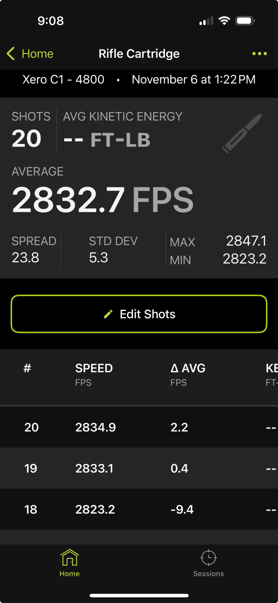

This is 33gn Shooters World Precision Rifle under a 106gn A-Tip, average 100 group is ~.3" (hammers out to 1250 yards too):

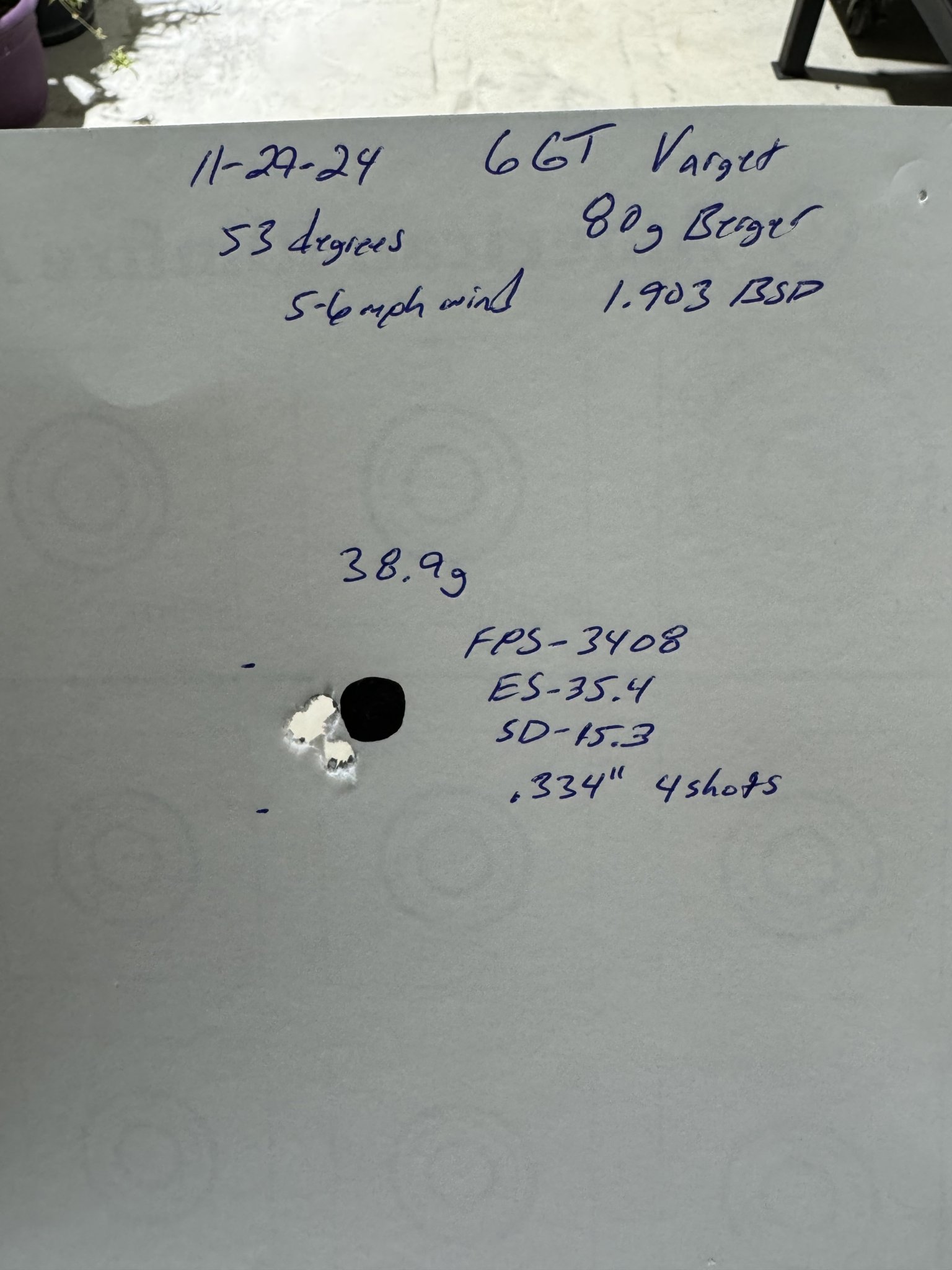

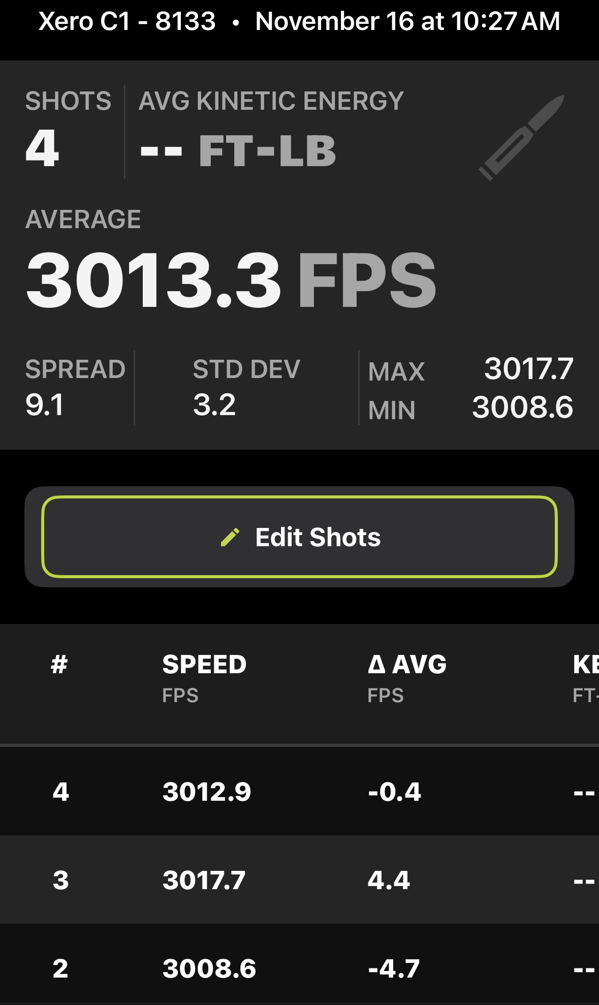

Just had a 1-10t Muller spun up for a varmit rig. Showing promising results with the 80g Berger FBV and Varget. Have 30rds down it so far just testing. Metering like shit right now but just fire forming.
