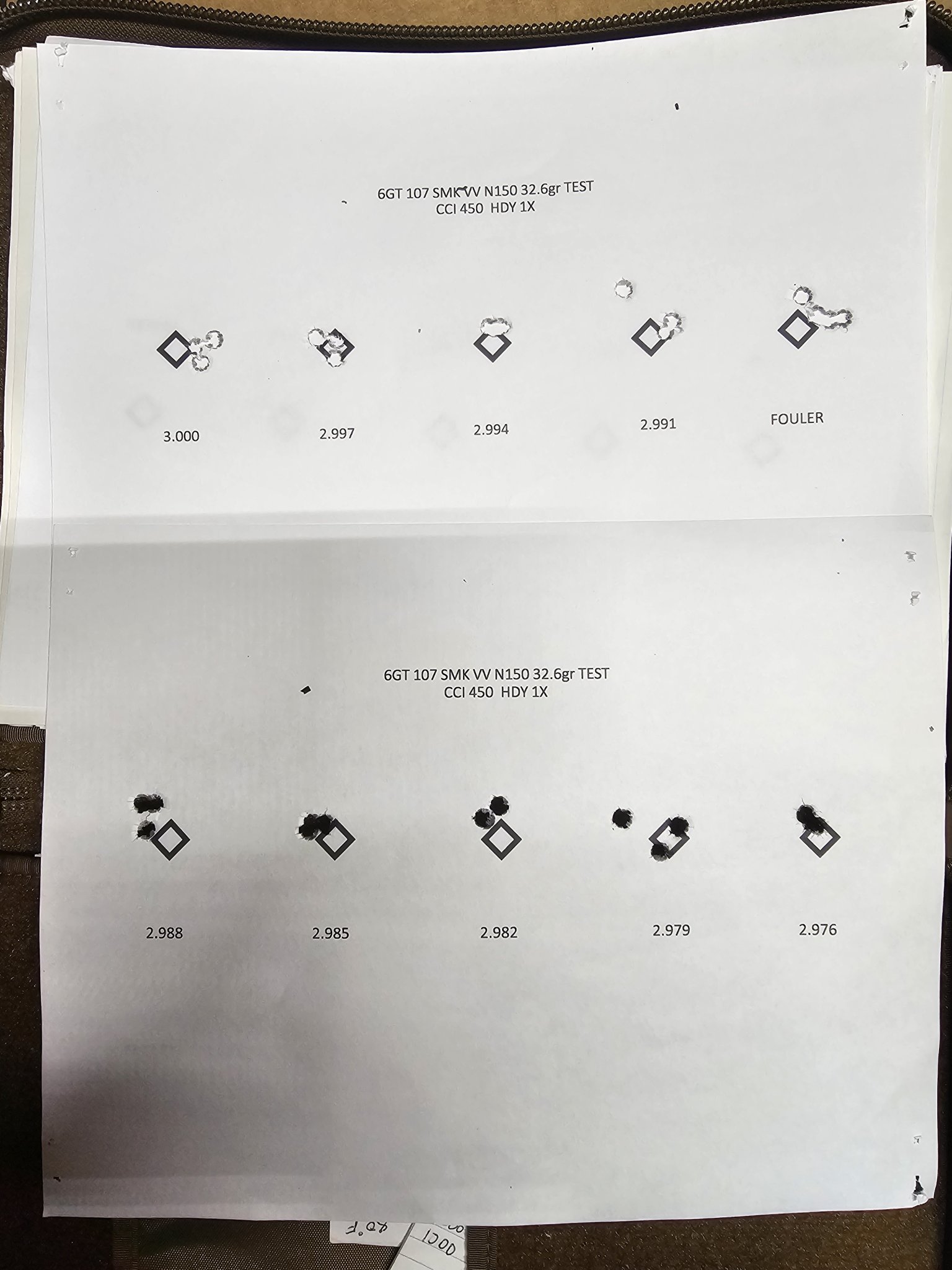

Loaded 15 rounds and tried an uber-basic seating depth test today, starting at .030 and going to .075 in .015 increments. Just shot (3) groups of 4, and (1) group of 3. I did warm the barrel up. I shoot these in backwards order too (short to long)...Basically because if something shoots lights out all I have to do is seat the next group in a little bit and try to duplicate the results.
Anyway, .075 was UGLY. Well over MOA and vertically strung. .060 double grouped on me, then .045 and .030 hovered around the half-minute mark. Velocity for the two groups I recorded was right at my minimum with single digit SDs. I should mention here that my barrel has already done well with N150 and the 105 Hybrid at a similar charge weight, so this wasn't a shot in the dark.
It's a start. I'll load up some more in that seating depth window and play with charge weights a touch next. We'll see if it falls apart on round two.

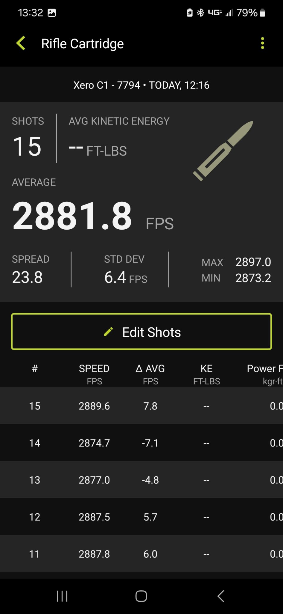

Piss off! What brass? I shot 109s with 32.8 of Varget on Alpha brass and BR4s after talking with GAP at their range. Was shooting 34. Even George said "thats on the hot side". But I sure wasn't seeing those velocities.

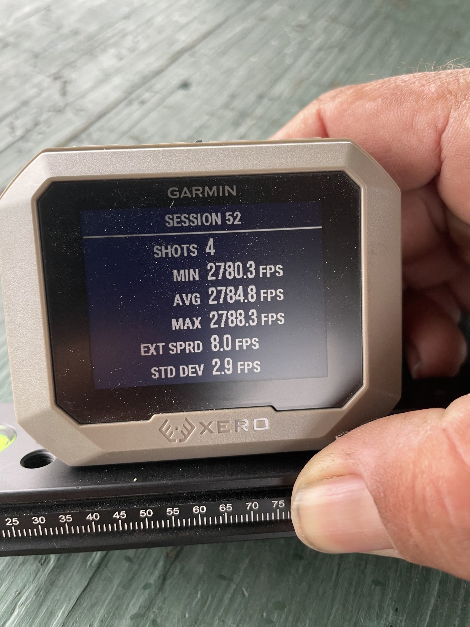

Alpha. Actually last weekend I discovered another load that showed me better results than H4350 and Varget…. RL 15.5. Shot a 5 shot group @ 300yds .631 then shot this 10rd just to confirm. Very happy with the results of RL 15.5

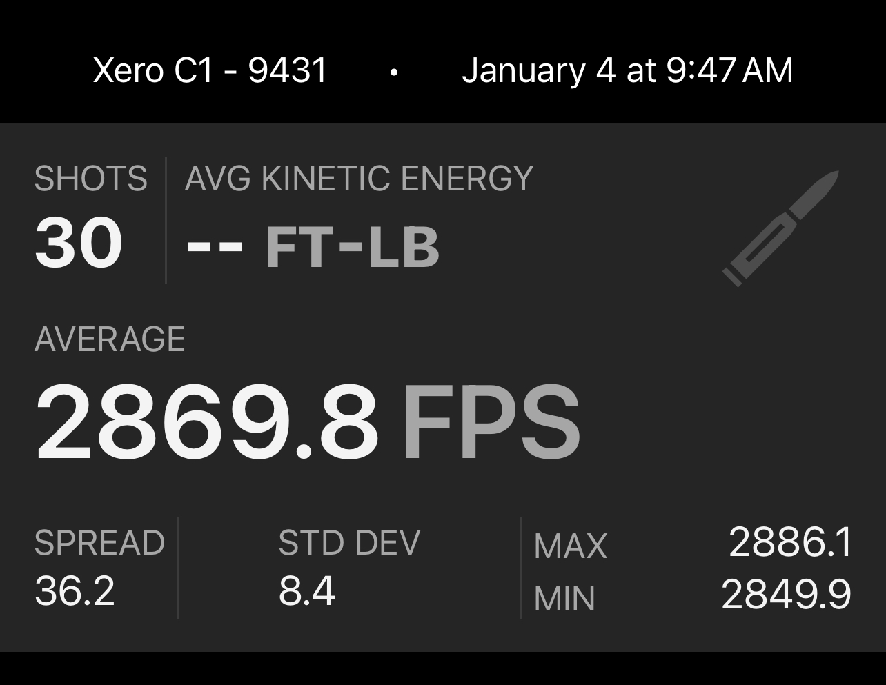

FWIW, Varget is pretty temp sensitive with lower case fills. I'm down 40fps from 80f to 28f. The cold bore is -50fps. Other people I know showing similar. H4350 doesn't have nearly the same temp sensitivity in this case likely due to case fill.
Reactions: WeR0206
That was unsuppressed.
It's 19f right now. I started warmer and it's only down 40fps.
That interesting, the listed post above I showed a 15 shot string, cold bore, suppressed and my first round fell inside the 23fps es range, it wasn't the slowest round either. I typically see a cold barrel cold suppressor 1st round be slow by 30-50fps. I know a handful of shooters who run suppressed during team matches, and they load their first round with a higher charge compared to the rest for the stage to keep velocity the same. I did it for my hunting rifle as I experienced it there too. However I have not experienced it with my 6gt and that suppressor combination.
Today I did my best to keep it from fully cooling. No big first round dips. All shot suppressed. It was 24 degrees by the time I was done. .2gr gets me back to the velocity I had when it was in the 50's. I'm guessing this is a combination of temps and throat erosion. For sure there is temp instability, It was a lot worse two weeks ago when I wasn't focused on keeping the gun warm. Yesterday it was warmer but 10mph to 20mph that cooled the gun down quick.

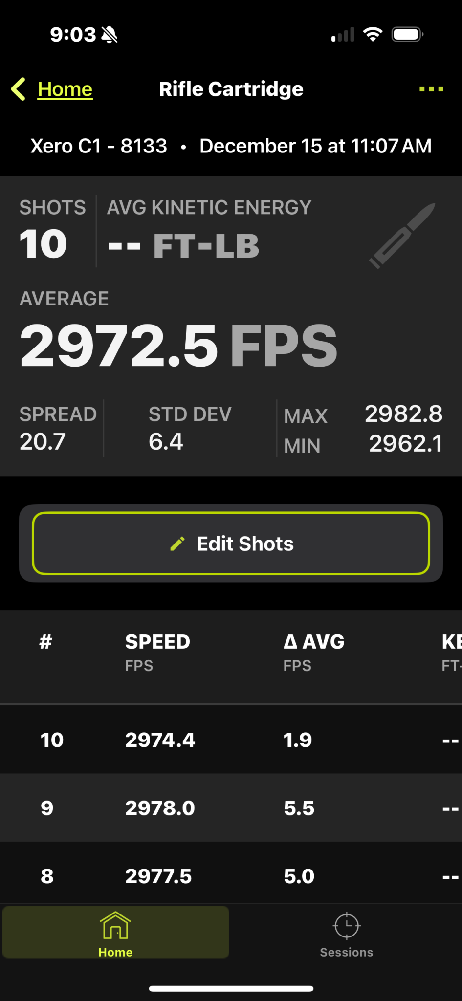

Sidetracked into absurdity again, I furtherd my little test into a hunting load with the 95gr Nosler BT and VV N150 that I have an excess of both. I'm only using these components for the testing.
My goal was 3K FPS and 2/3 MOA accuracy for consecutive five shot groups (27" barrel). I figured that it could be a dandy little coyote round out to 400 or so if I could meet those two parameters.
Unfortunately, I can't really say that the accuracy will be there. I shot today prone with a rear bag, so no chronograph numbers, but I did hit 3K FPS on the nose twice at 33.5gr during a seating depth test. Both times SDs were 4 and 6 respectively.
I think this is about as good as it is going to get. Not horrible for a hunting bullet across the board, but that group of 1.1" at 33.9 is probably the worst this barrel has shot. As such, I don't think that I hit my goal.
FWIW this barrel hammers with N150 and the 105 hybrid, it just hammers a little better with H4350.
It was a fun experiment anyway. I did have a bit of a perceived hang fire in the first group...don't know if that was me, or if it actually happened.
Dots are 3/4".

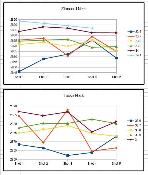

Good data. Your graph is titled standard and loose neck, i am assuming this is referring to neck tension? What did you find or see in any difference with the group size with the 2 different neck tension? What was your neck tension?
96C

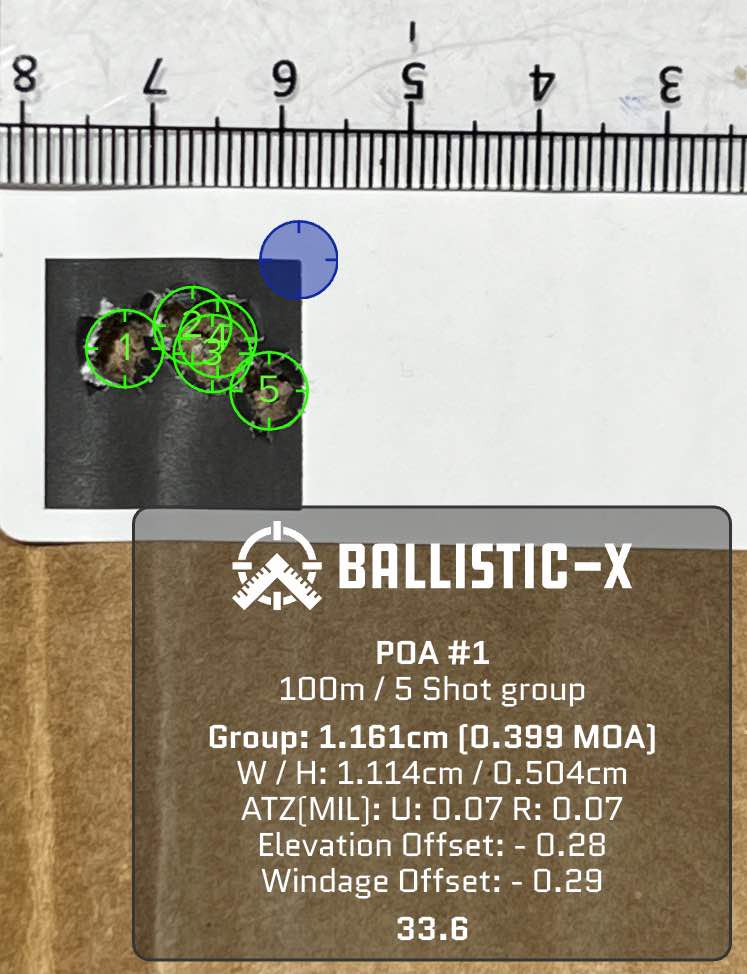

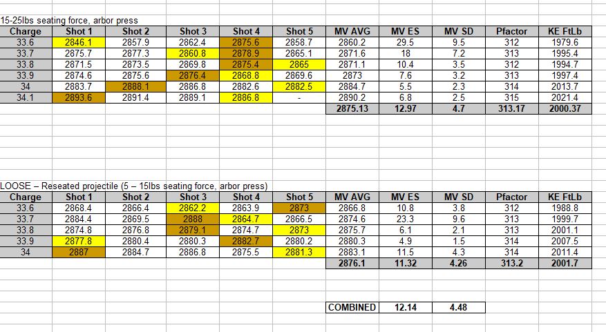

I had to use a kinetic hammer to pull the initial load data lot after finding that some of the brass in that box still had media from the dry tumbler in the flash holes (idiot). Decided to not re-size the cases (still primed) and couldn't be bothered pulling the decapping pin out. The necks were at that point a bit looser, as seen on the arbor press force dial.

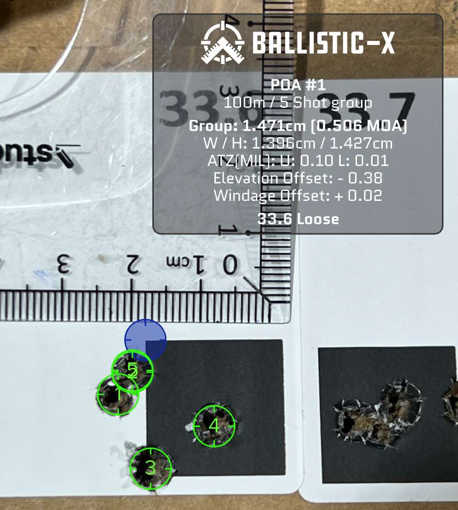

Die is a SAC 6 GT + 0.2410" Decapping Expander Mandrel with .263" Neck / Shoulder Bushing.
I was only able to fire one round of the 'loose' rounds at paper, mirage became a major issue at that point in the day so the rest were shot at steel to just get velocity information sorry.
The single group that can be compared:
ChargeTensionMV AVGESSDGroup
33.6Standard2860.229.59.5.399 MOA (11.6mm)
33.6Loose2866.810.83.8.506 MOA (14.7mm)
Overall, the velocity only jumped up marginally on the looser neck cases, but I'd be less inclined to trust them being beaten up the magazine and storage compared to the standard necks. It may never be an issue, but still.... They slipped in with almost zero effort on the arbor press. (y)

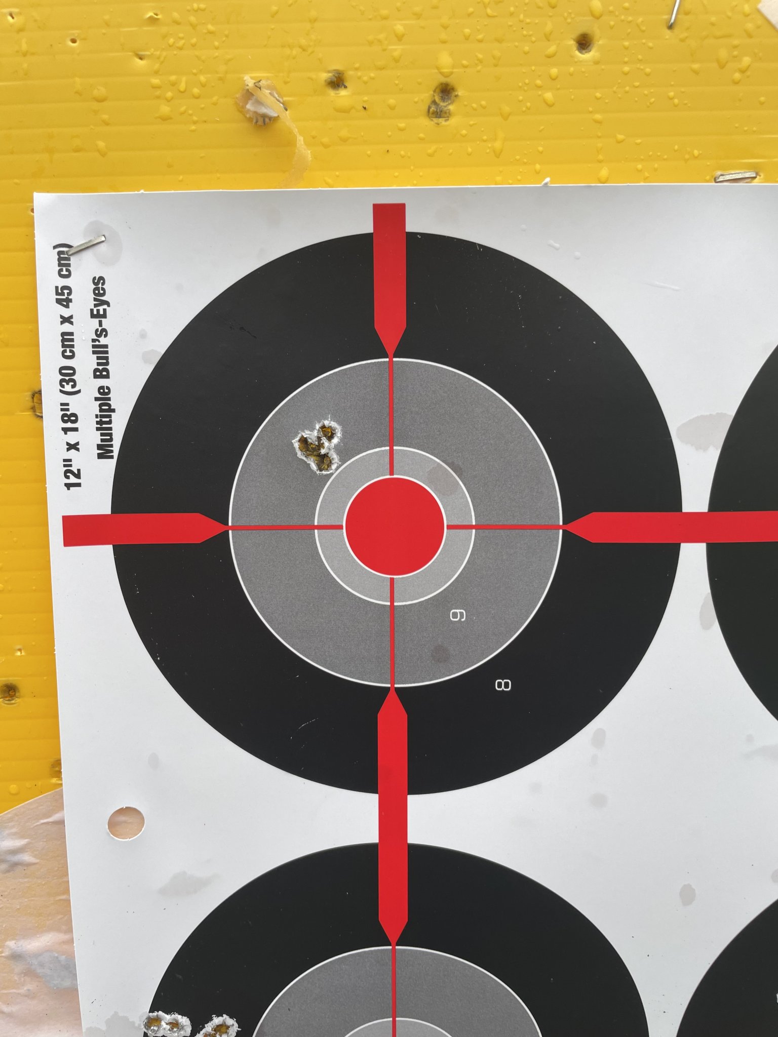

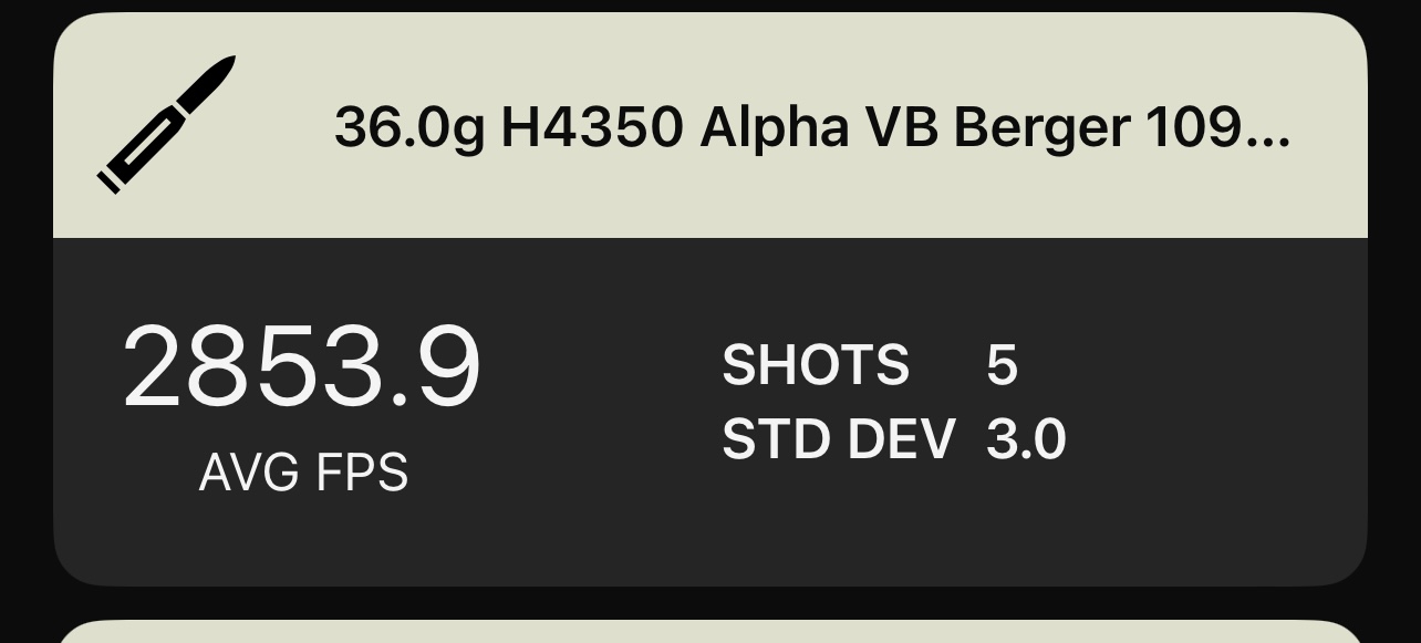

36g of H4350, Virgin Alpha brass, CCI 450, and Berger 109’s. This is my first Custom Rifle Barrel and not sure about others but it took longer than any of my Bartlein or Krieger to break in.
