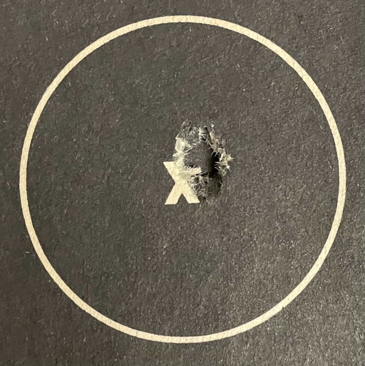

I love 6BR for its consistency. I’ve had many cold bore impacts on 1-2 MOA targets from 400-700 yards, but this was my last clean bore shot. I’ve never had a rifle that essentially always shoots to the same point of aim like this one does.

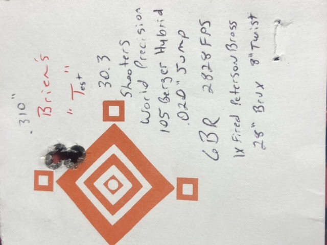

I hadn’t tried shooters world in mine till today and wanted a “baseline test/ velocity&accuracy
This was just one 5 shot group with no development so it could’ve been pure luck.
Looks good... I am going to be running SW precision this year as powder availability is a little sketchy.
Lapua Brass
Berger 105 Hybrid
Shooters World Precision
205M Primers
