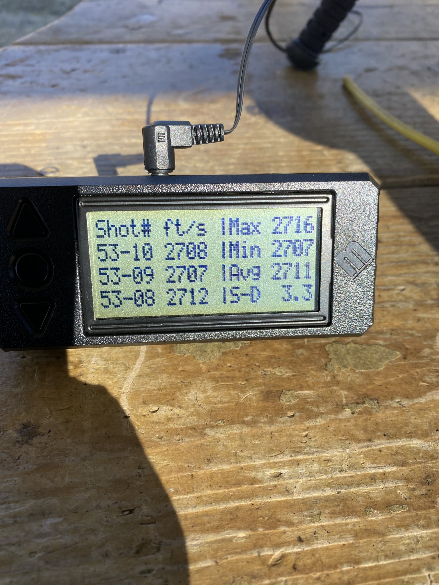

Got out with my new Bartlein today from StraightJacket. Loaded up 25 rounds, all loads were H4895 @28.5g with a 105 Hybrid, Lapua/450’s to zero and get an idea. Shot 4 rounds, zero’d and shot the below group (shots 5-9) Pretty happy to say the least. 10 shot chrono looks solid.
