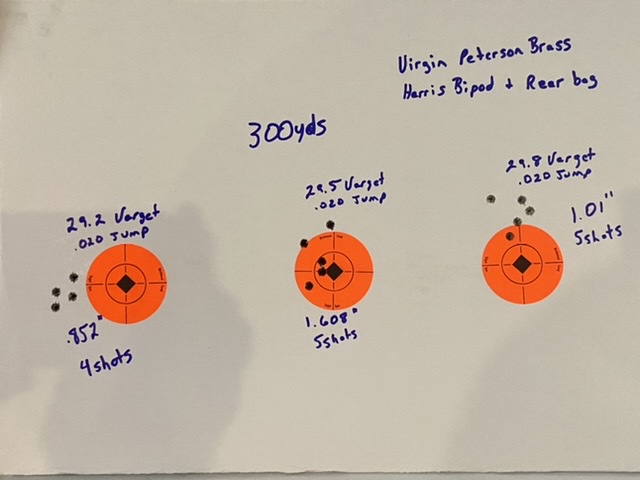

I was trying the new peterson brass. sent 3 charges at 300yds. 29.2/29.5/29.8 grains varget. My favorite was 205m/virgin peterson brass/29.8grs varget/ 105hyb jumped .020"/ 28" 8twist brux/ 419brake. Sun changed and I lost the first of the 5. Last 4 shots were all duplicate 2842fps.
All 3 groups were pretty good for me. I'm still playing poor with Harris bipods/ seriously thinking of upgrading soon. F1E807BC-502B-4F47-BB2E-E4B03DDE8081.jpeg
Reactions: alcap

I shoot peterson also. Love it.
