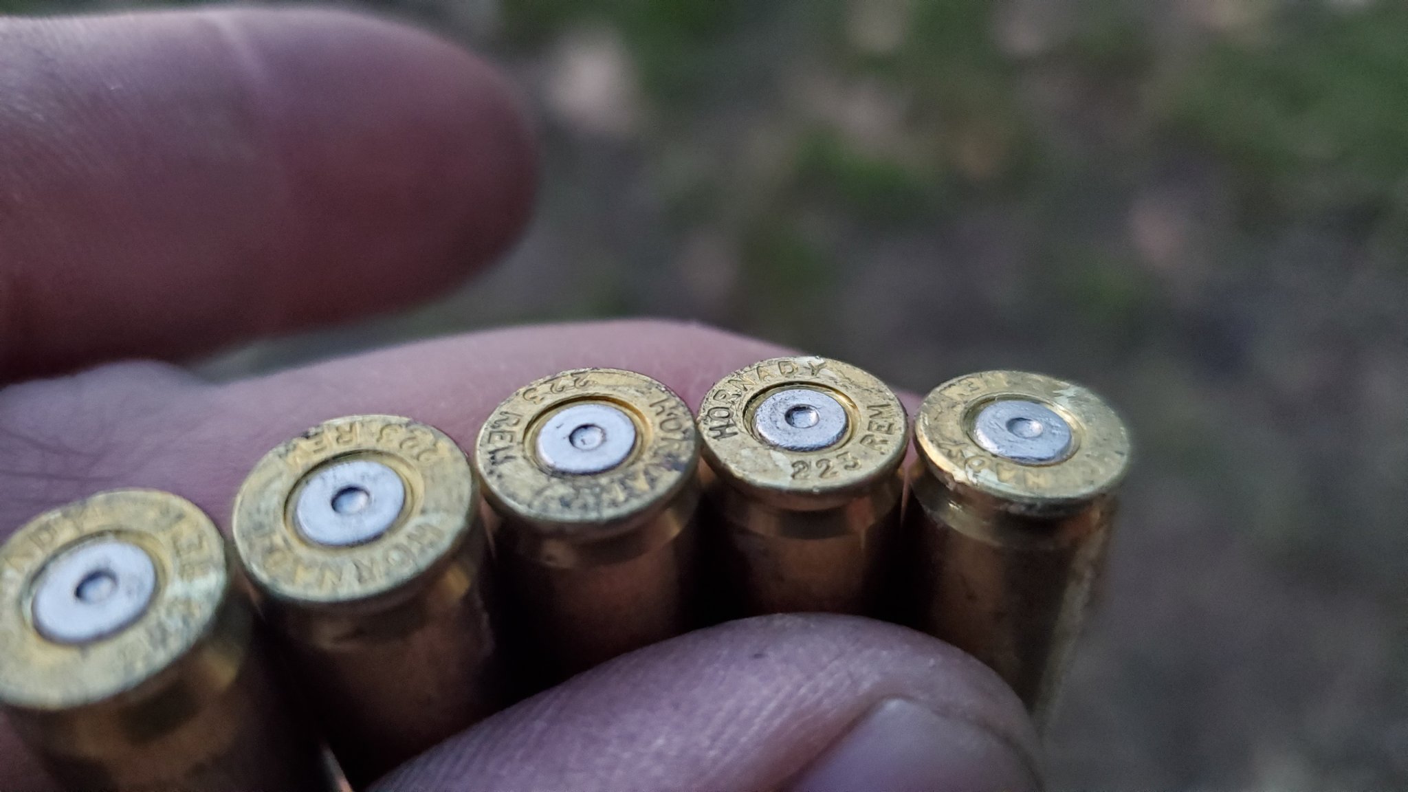

Here are twice-fired rounds (Defender brass) - same load, three with 400s, two with 450s. I forget the exact charge of which powder and my content list doesn't go back far enough, but it was nowhere near max.
