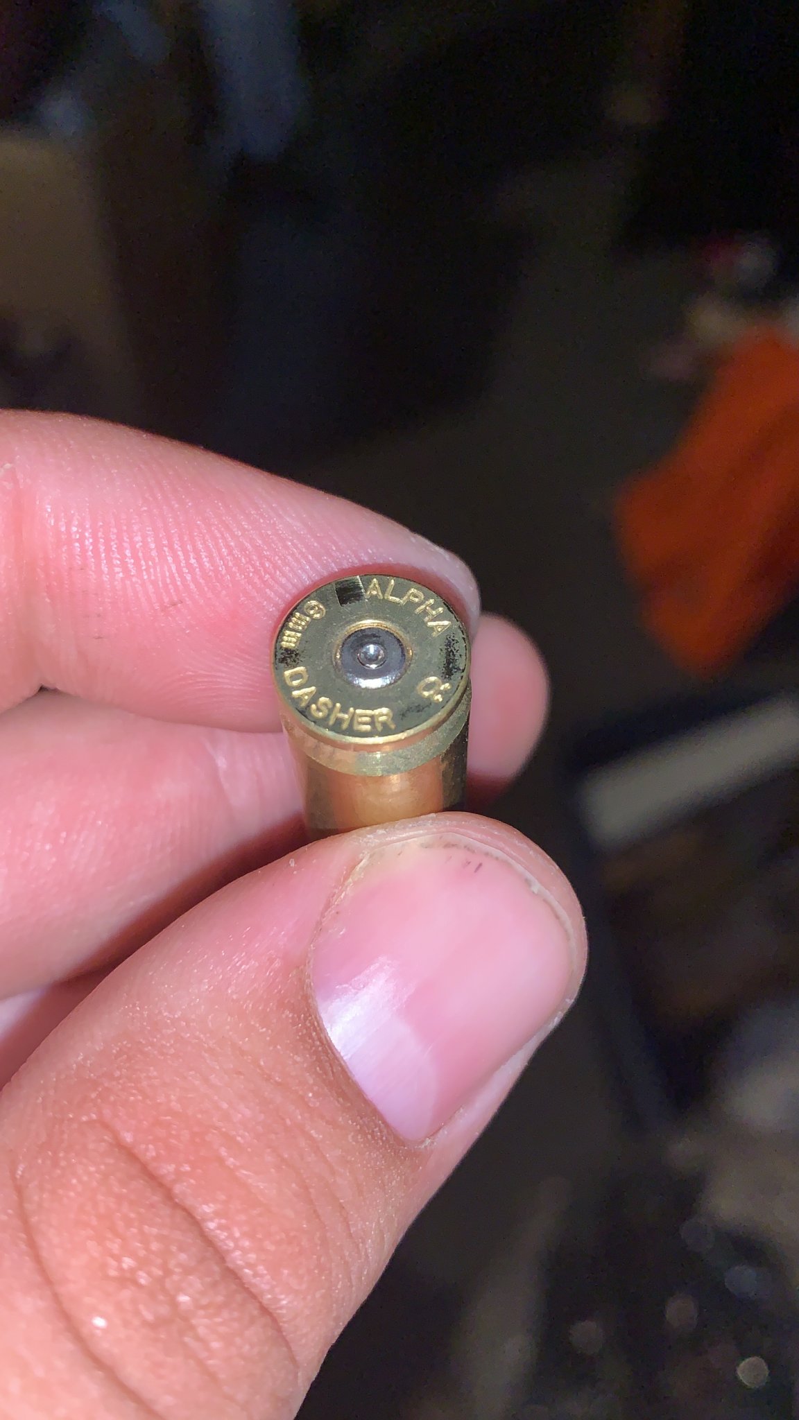

Just loaded my first Dasher rds this weekend.
Brand new Alpha OCD brass
450 primers
29gr Varget
108 Berger BT
Barrel is a Radix with .274 Neck and .120 freebore
Jam was at 1.730" and I started my initial jump at .050 for CBTO of 1.680".
Sound like a decent start off point?

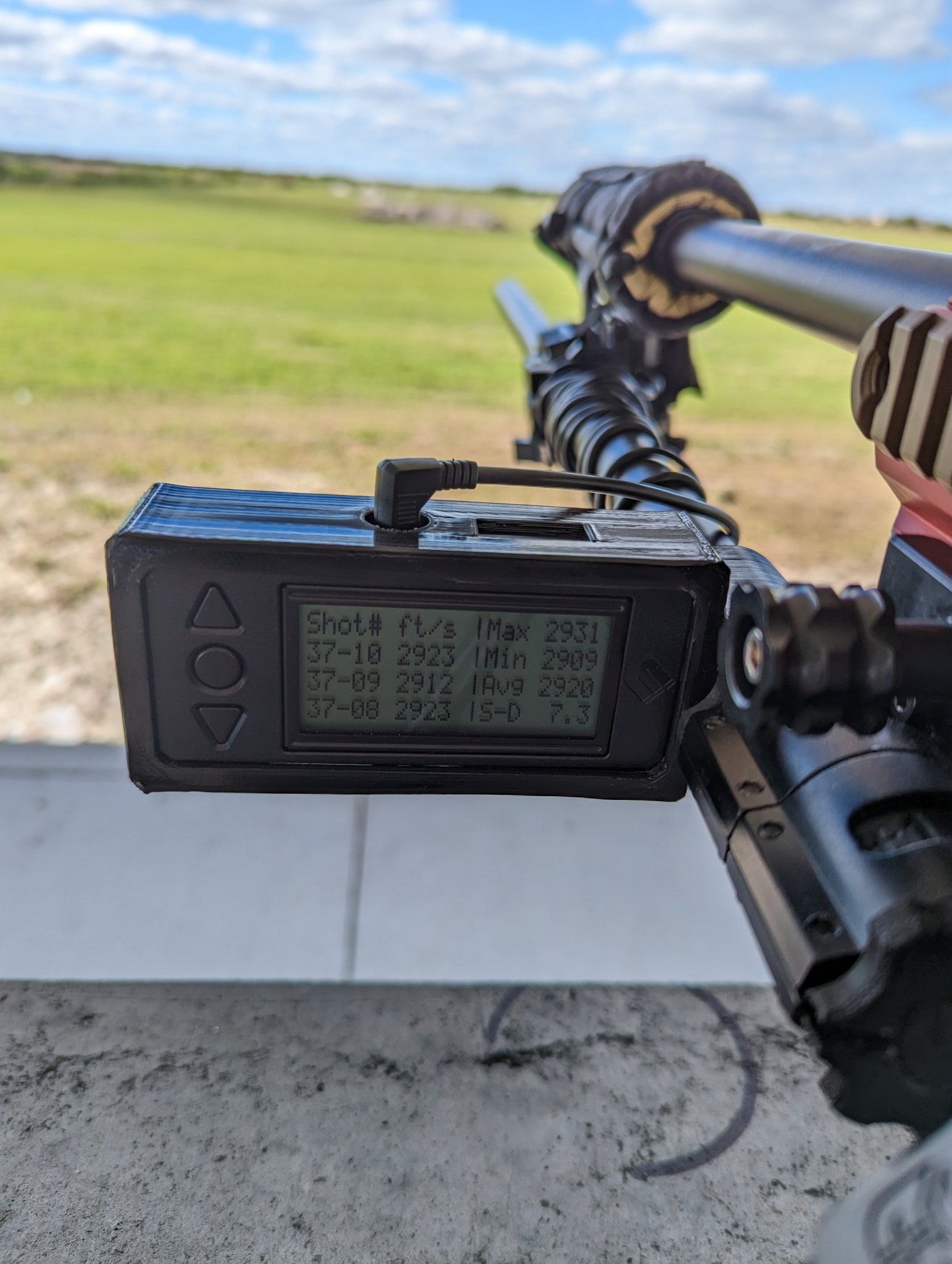

23.5" 1:8 Bartlein
105 Hybrid
32.7 gr Varget
Lapua FF'd Brass
CCI BR-4
2929 FPS

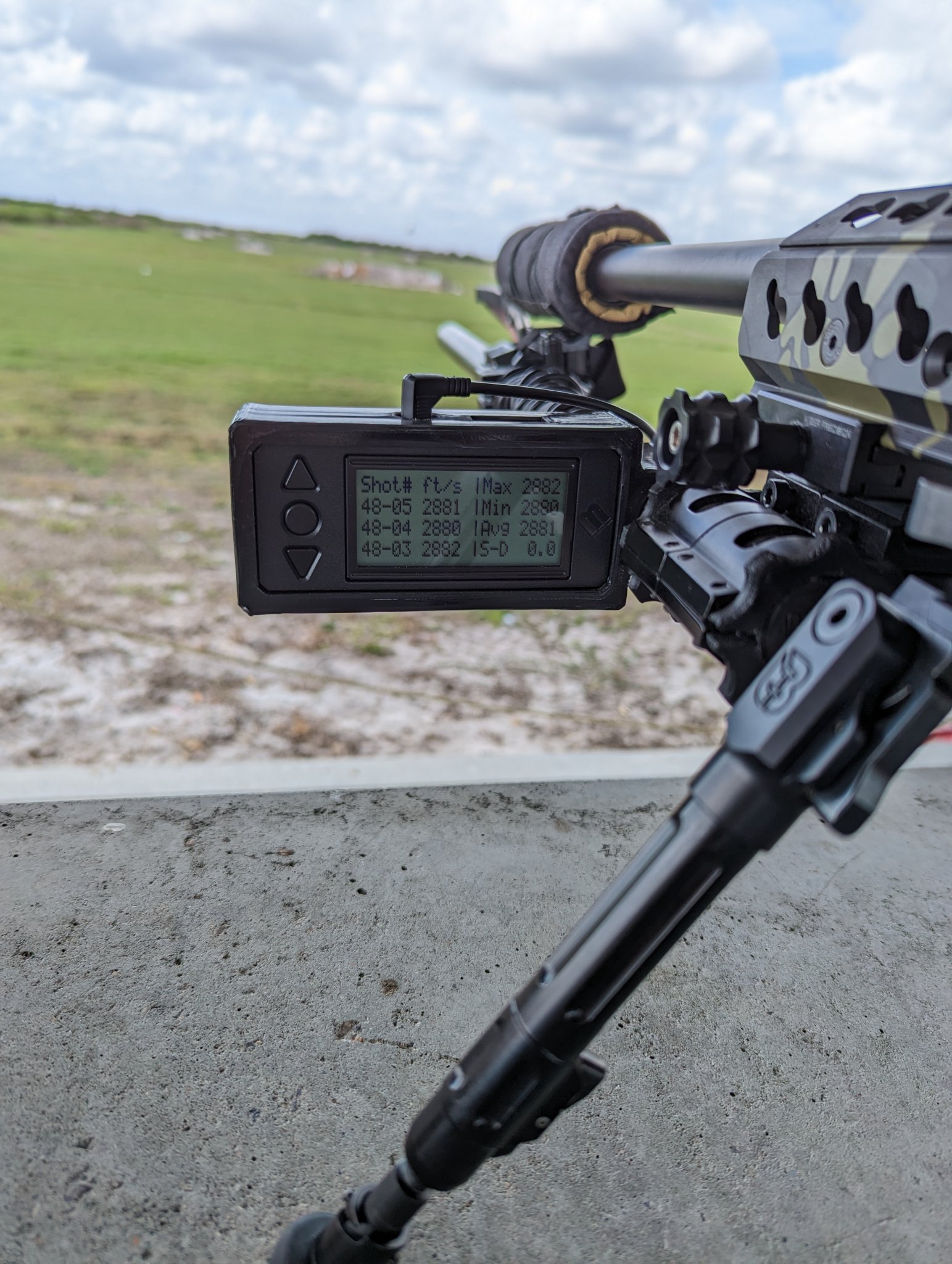

I'm currently fireforming brass for another 23.5" 1:8 Bartelin barrel; I'm going to try 8208XBR and CCI 450 and see how it works.
Hornady 108 ELDMs
31.5 grains Varget
CCI 450s
Alpha Dasher Brass
2910 FPS

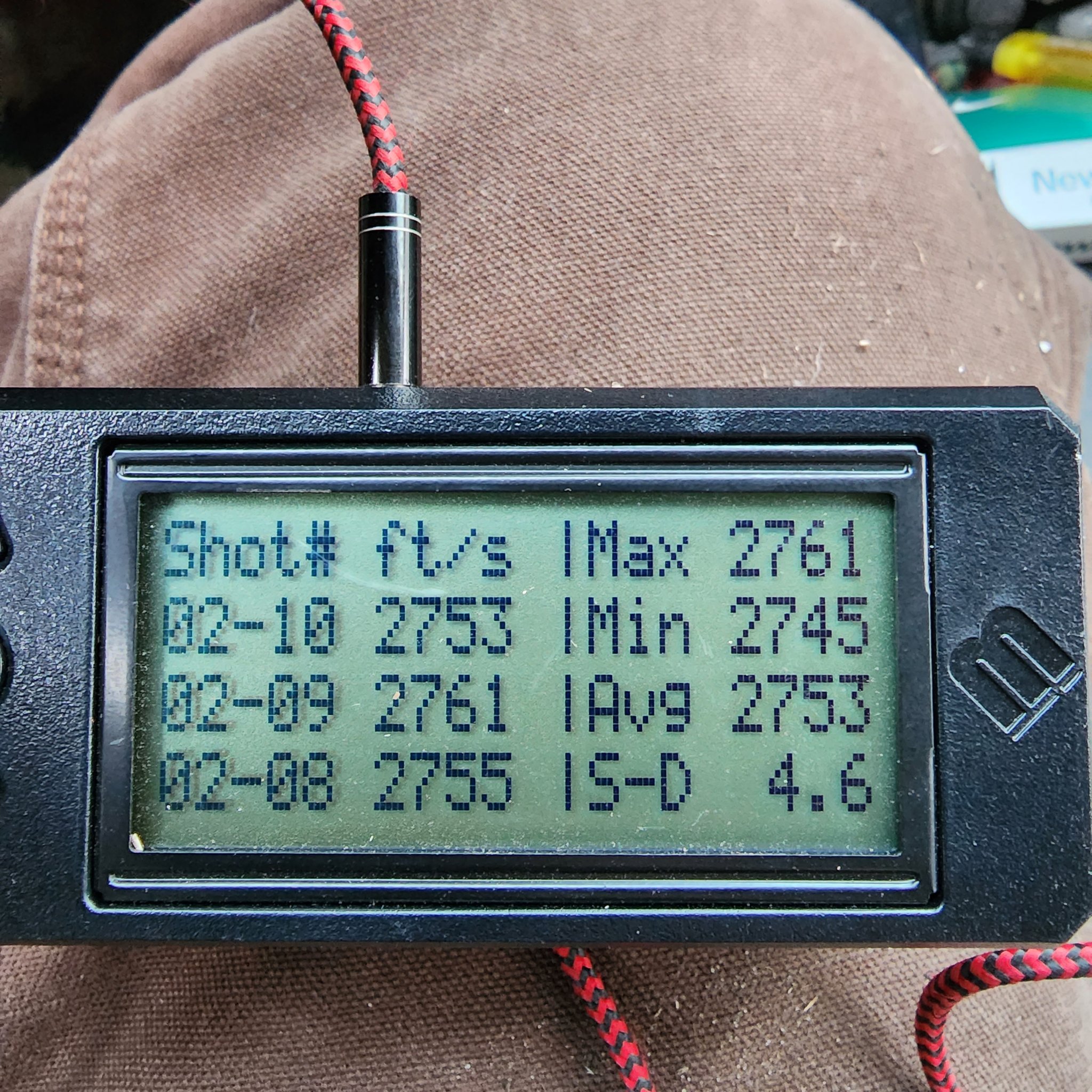

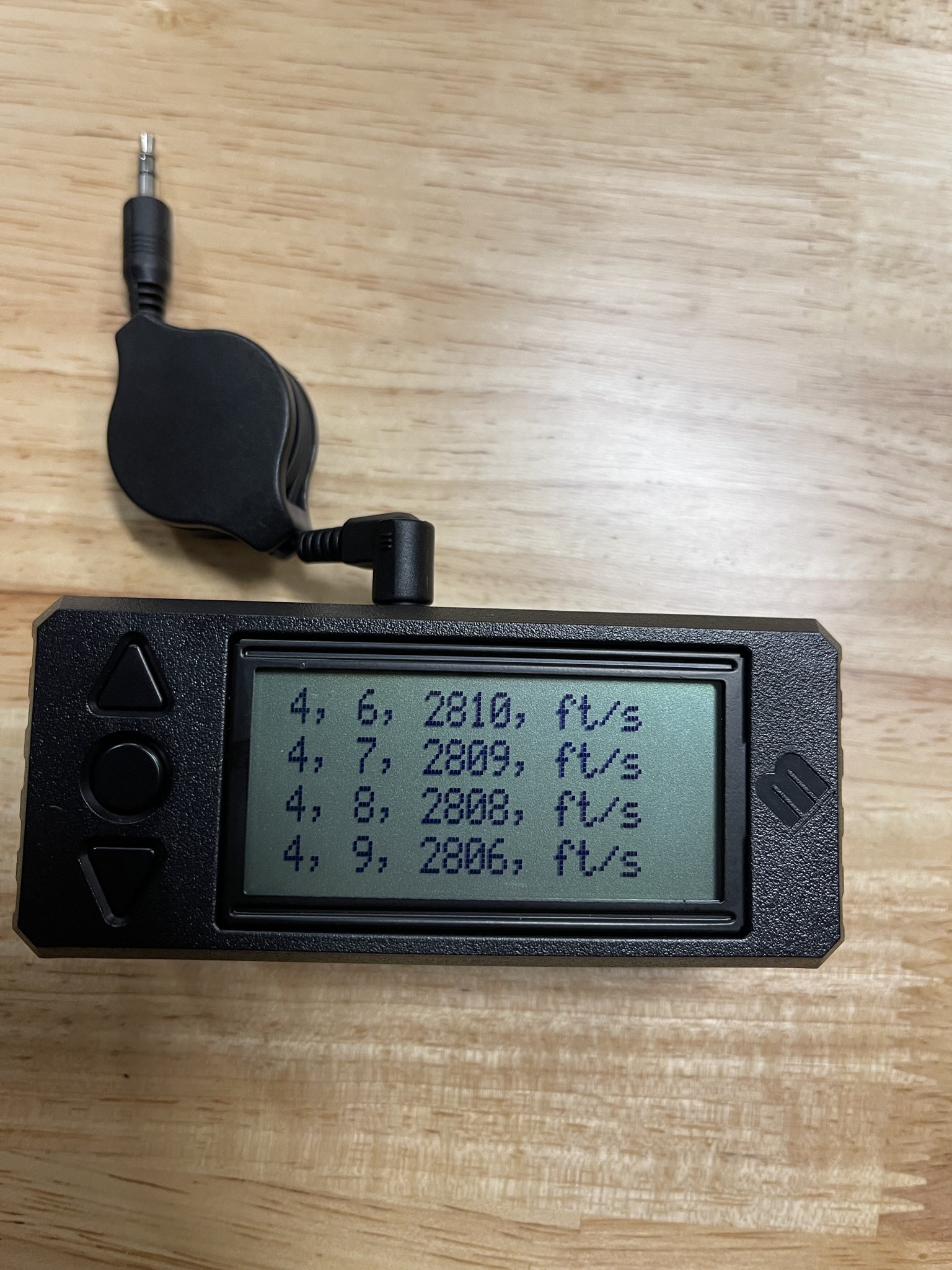

2753 velocity
@35° / 30 Gr. Varget

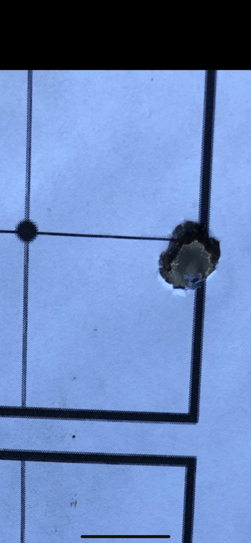

I think I posted that before but it works. Hits a 4" diamond at 807 yards 4/5 times. Repeatedly once the wind was figured out.
My buddy shoots literally the exact same load from the same loading equipment and same powder. Same rifle set up too. His reaches 2840 avg velocity.

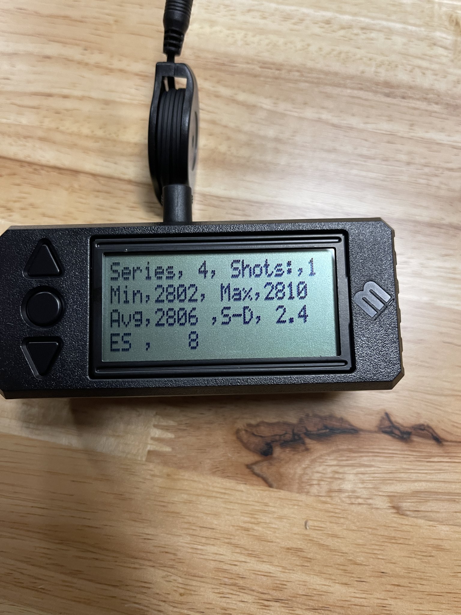

Here's 31.2gr of Varget with the 108 Berger Target BT in new Alpha OCD brass.
I was pretty meticulous in my prep and powder setup.
Took that load out to 3" plates at 500yds so far. I'm pleased so far.

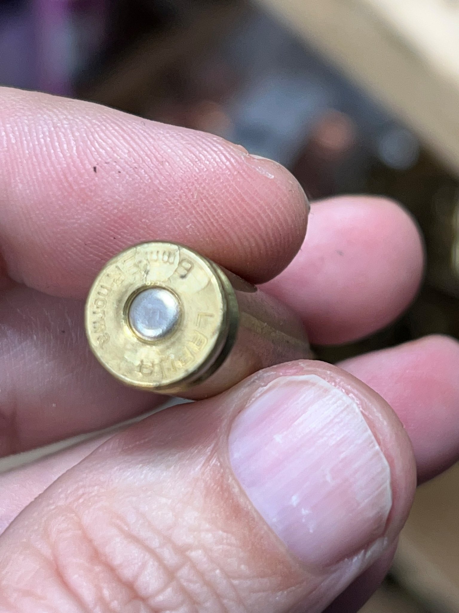

I will say I do get some weird marking on the case head with my alpha but never had an issue with primers @31.8. I had my smith and alpha comparing notes and everything was with in spec on both their ends, should I have back down the charge a little bit, probably but with everything being with in spec I just keep the recipe.
I will say I do get some weird marking on the case head with my alpha but never had an issue with primers @31.8. I had my smith and alpha comparing notes and everything was with in spec on both their ends, should I have back down the charge a little bit, probably but with everything being with in spec I just keep the recipe. View attachment 8057137
not too weird - it is an ejector that get hammered into the case. in my gun on hotter 31+ loads it gets so bad - brass gets into the injector and it gets stuck, so, it is just an other side of overpressure stress.
Well the weird part comes from it being big horn action, so I’d expect a thin line from the slot cut for the mechanical ejector but it’s a pretty good size swipe from something.
Reactions: Tx_Aggie
i discarded most beaten up cases, but here how it looks like when extractor prints.
with signs like that in my gun - 3-4 firings and the primer pocket expands so bad that primer falls out by itself at reloading.
just too much pressure at anything above 30.7-30.8.
you're posting an ejector mark from a normal plunger type action
@King_beardsly pic shows the mark left from the gap in the bolt head from where the mechanical ejector pushes through
Reactions: Paul73
