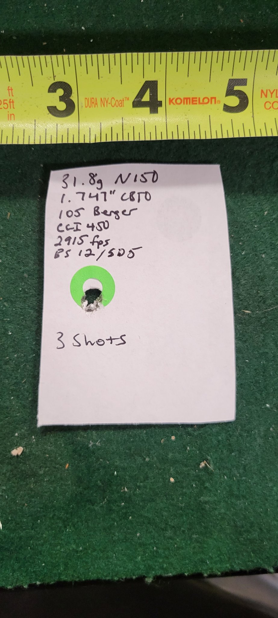

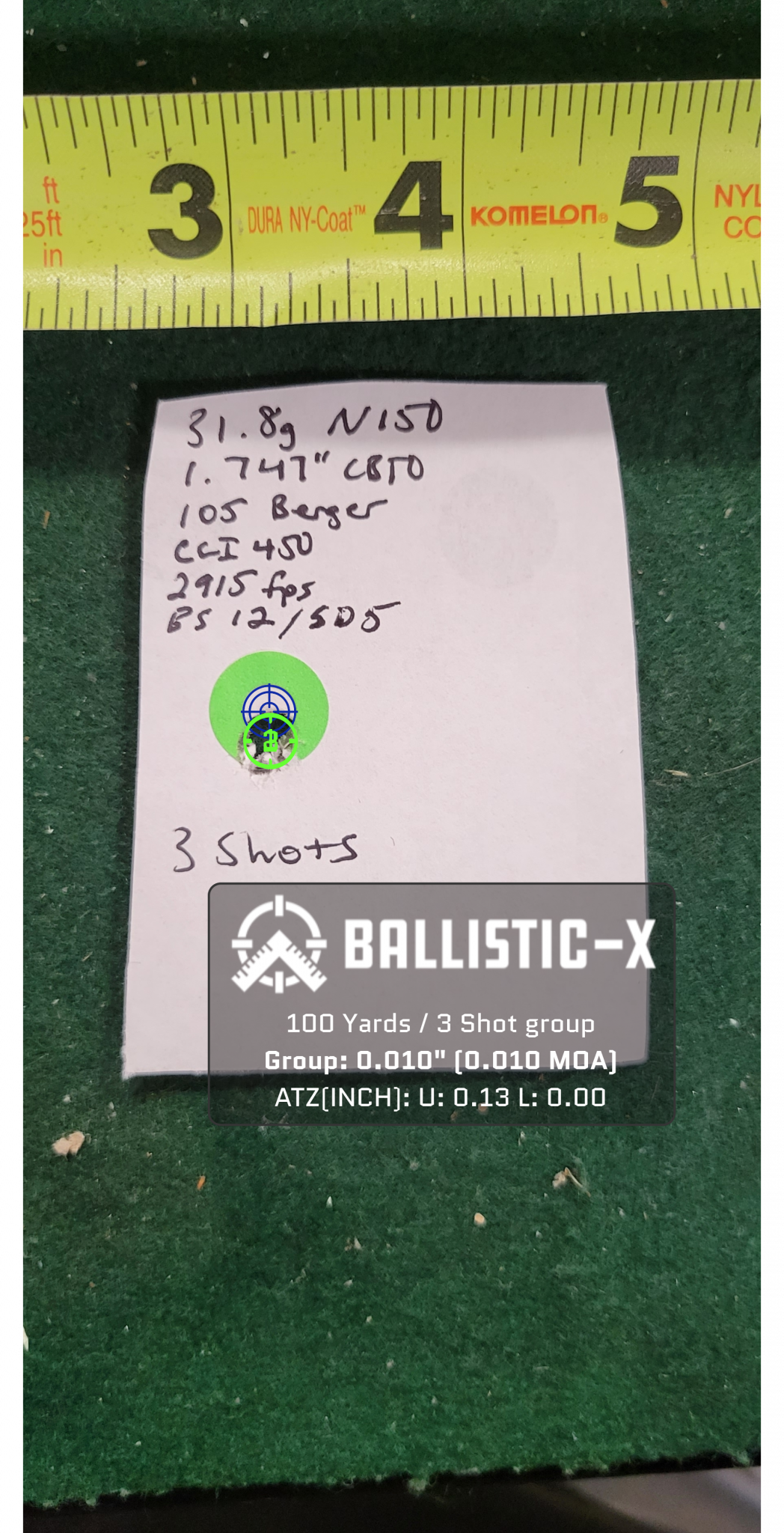

I love VV powders
I'm becoming a fan. I'm glad, bc I've got 32lbs of n150 and 8lbs of N555.
From 31-33gr, not 1 charge weight had an SD over 10. My varget load and n150 are the exact same and exact same velocity.
One thing I've noticed is, this N150 meters great, surprisingly, but bridges like a fucking whore in my funnel. Oh well, if it keeps shooting like this, I'll deal with the bridging.
