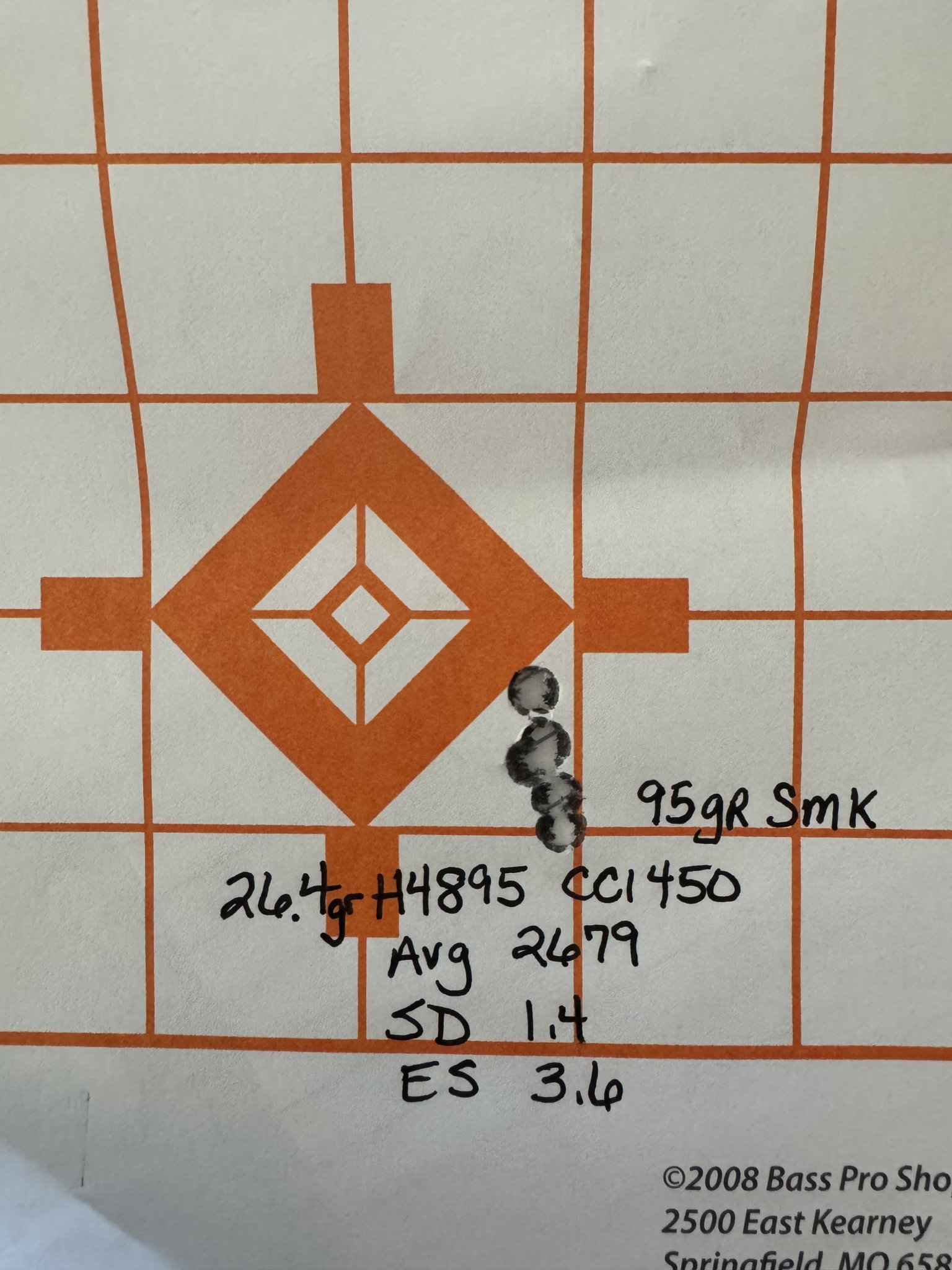

Several decent groups with H4895. Going to test some 90 gr Scenars this week

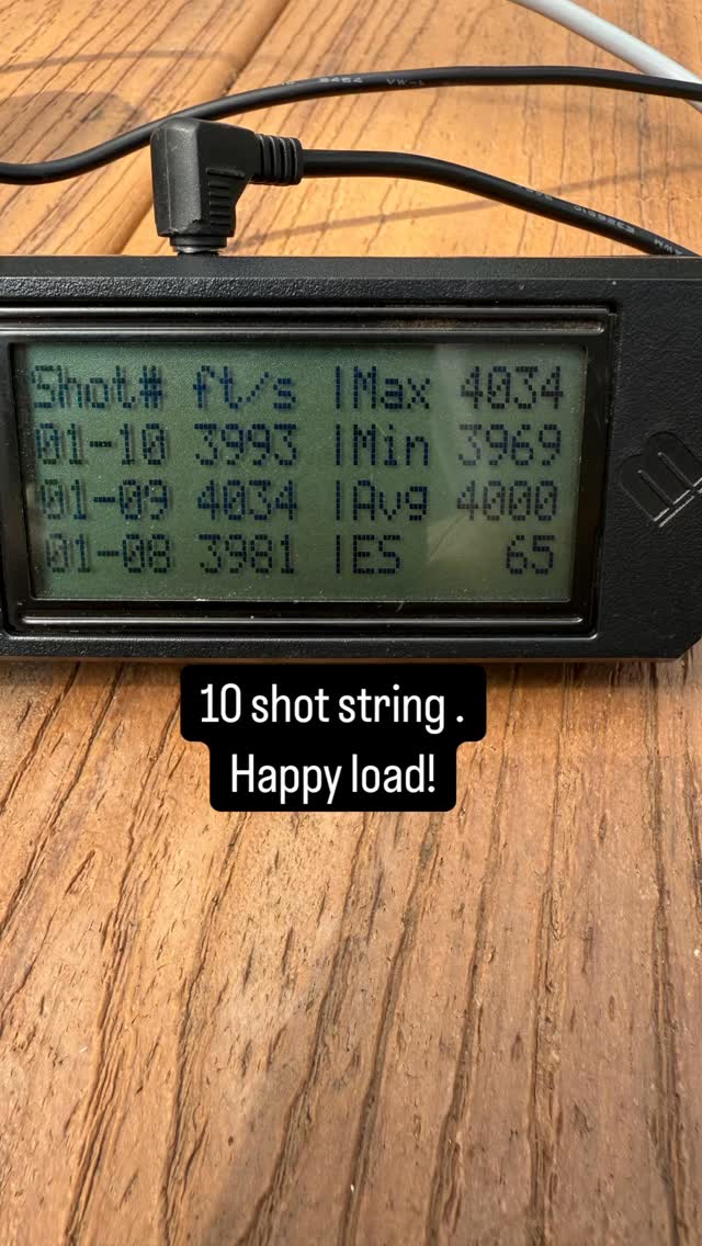

20 inch. This was rounds 6-10 down the barrel so speed isn’t there yet
oh wow... You're not gonna speed up too much. maybe 30-50 FPS. I'm not sure why they don't have CFE listed on their load data with the 90 grain bullets, but it's the way to go if you're looking for any kind of speed. TAC hit pressure in the low 2700's for me.
