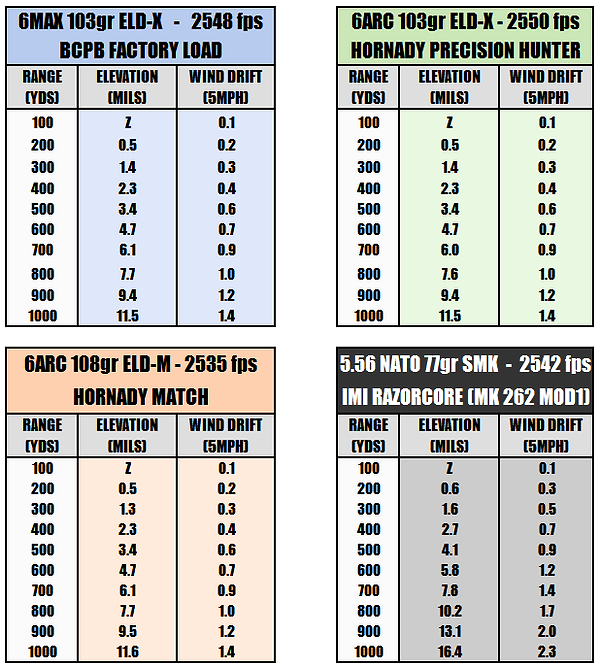

Can you run those same numbers for a 103gr eldx?
I feel like that weight is the sweet spot for 6mm class.
Running strelok pro, I am finding at 500M the 6max 103gr eldx has 50% more energy and 30% less wind drift vs 77tmk, both from a 16" bbl at my high elevation.
That is going off the 103gr velocity claimed above and using Streloks bc of .258, while the chart above has it listed as .2508.
Drop is basically identical for those 2 cartridges out to over 500M, which is nice for memorizing the drops, at least for me. Probably the same speed drop factor.

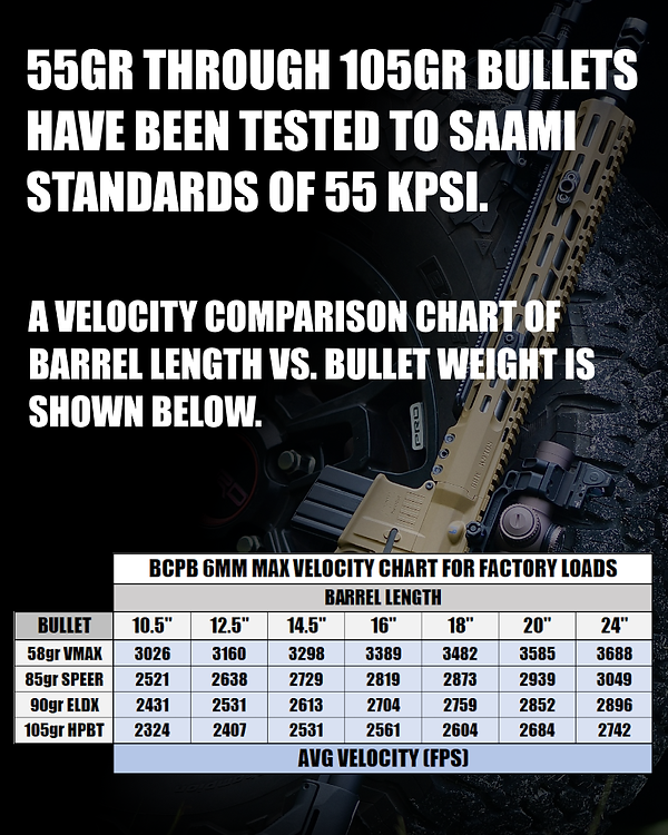

The 6mm MAX is pressure tested to SAAMI standards of 55k psi. It is a brand new cartridge designed for the unmodified mil-spec .378 bolt face, and a full mass bolt carrier group. The 6mm MAX holds 35 grains of water capacity which ultimately determines the energy potential of the cartridge. In this case, 1750+Lbs of energy. Why is that so significant? The 6mm MAX can launch an 87 gr Berger VLD at 3009 fps from a 24” barrel. This produces 1749 lbs at the muzzle, 1504 lbs at 100 yards, 1093 lbs at 300 yards, 775 lbs at 500 yards, 533 lbs at 700 yards, and stays supersonic past 1000 yards. These ballistics are at standard atmospheric pressure and temperature.
Cartridge designers have struggled with 2.26 OAL, and having enough room for increased case capacity. Until recently, there hasn’t been a .378 case head cartridge available that has a 35 gr water capacity. This amount of water capacity is the engine that can power heavier, and high ballistics coefficient bullets up to 100 grs. The 6mm MAX can do this within the constraints of the AR-15, and function flawlessly. So the end result is that the 6mm MAX can push bullets 55 gr to 100 gr, and do it with the same 2.30 OAL. Some designs have emerged shorter and fatter to accommodate a bullet with better BC and enough powder for useful velocities. When comparing the water capacity of 24 Nosler (29 grs), 6.8 SPC (35 grs), 5.56 x45 NATO (28.5 grs), 6×45 (29 grs), 6 ARC (34 grs), 6.5 Grendel (35 grs), .224 Valkyrie (34.5 grs), and what do we get? For the cartridges with .378 case head, powder capacity is less than the 6mm MAX. For the cartridges with larger case heads, you get the same amount of powder or less than the 6mm MAX. The end result is that the 6mm MAX (35 grs) allows for a .378 mil-spec bolt face with full lug integrity and powder to push the heavies at useful velocities.
The 6mm MAX has unlocked the code on the .378 bolt face AR-15 cartridge. We were able to increase the OAL to 2.30 with the .350 Legend parent case, and magazine, which were originally designed for the AR-15, and function flawlessly. With the OAL set at 2.30 for all bullets 55 gr to 100 gr, we were able to keep bullet jump relatively consistent for the inherent accuracy across all bullet weights. We have been able to achieve 1 MOA accuracy with most bullet weights, and sub-MOA with premium target bullets.
BC Precision Ballistics has spent 3 years and thousands of hours in research and range time to get the 6mm MAX perfected. Our case is only slightly rebated for a well balanced cartridge maximizing capacity and 100% reliability. We designed the chamber for functionality in a repeater and for accuracy. Sometimes those two requirements conflict with each other as reliability requires loose tolerances, and accuracy requires tight tolerances. We consulted with many lifelong industry experts throughout the chamber/reamer design and listened to what they had to say. We utilize carbide reamers for our builds, and our tolerances are kept exact for predictable performance.
Wondering about accuracy? On Aug 6th, 2022, I competed with the 6mm MAX in F-Class with my local club the Central Texas Silhouette Association or CTSA. Full disclosure on me? I’m an old F-Open High Master. My normal competition gun is a .243 30” Bartlein barrel running 105 hybrids at 3050 fps with a stout load of H4831SC. The 6mm MAX is not a competitive F-Open cartridge by any stretch of the imagination, but I wanted to see an actual real world test of accuracy in the hot south Texas switching winds at 500 yards. I used a 24” Bartlein barreled hunting rig. This is the same bolt rifle pictured on this web site. It has 2600 rounds of testing down range, and is till holding sub-MOA with a load of H4895 tested to SAAMI standards of 53,000 psi. The load was 26.6 grs of H4895, and 90 gr Lapua Scenar-L at 2.30 OAL. This load was straight from our loading chart on this web site. After the 3rd relay my score was 568-6X. Nothing to write home about by F-Class standards, but in the world of hunting and rifle accuracy these rounds would have HARVESTED GAME.
The 6mm MAX velocities/load chart can be found on 6mmmax.Net

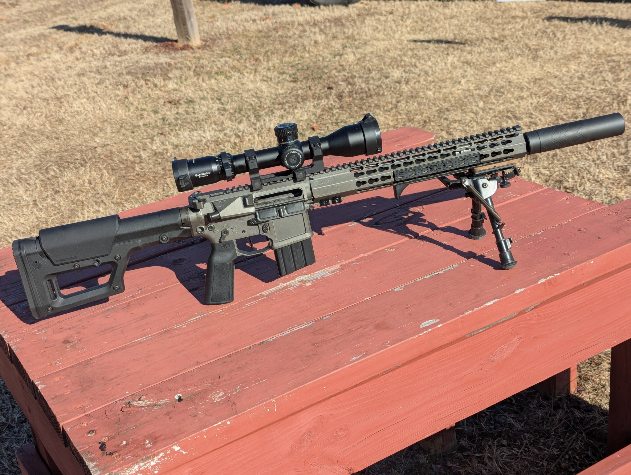

Anyone got their hands on a SOLGW 6max spr barrel yet?
Mine is the Saturn/Liberty barrel from BC Precision Ballistics, not SOLGW. I'm planning on putting together an SBR with one of the SOLGW 12.5", waiting until the 30 round mags become available.I got a 14.5 SOLGW barrel a couple of weeks ago, got the rifle together and shot a few groups of initial handloads so far... It's definitely showing promise with 58 gr VMAX and 70 gr Nosler Ballistic Tips for predator hunting, which is my primary purpose for it. I think @vmpglenn and @lonestar1845 are still running their 6 MAX barrels maybe they'll chime in here too
