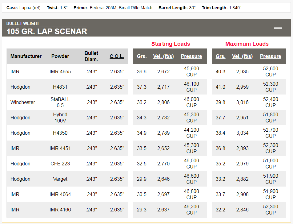

- What load data do you have and what group sizes do you all shoot? Pictures pleazz :)
    Decent starting and max, I always go to hodgdon first

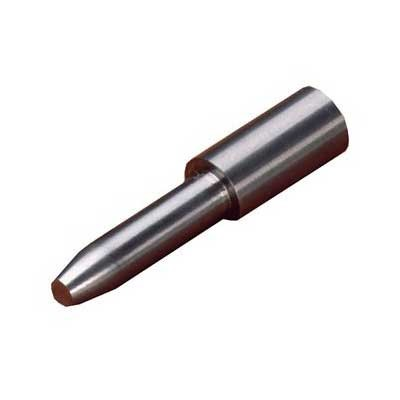

    That's all you HAVE to do. I'd recommend a Sinclair mandrel inside the neck to even things out and get the neck tension unbuggered from necking down.
    Then I like to trim mine so the necks have a nice chamfered and deburred edge.
    Hi,
    so you want me to buy a Sinclair mandrel and put into my Forster FL die?

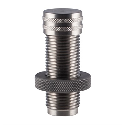

    This separate expander die body holds the mandrel, the case gets pushed up into it and over the mandrel.
    This is the mandrel that the case neck is forced up onto and which opens the inside of the case neck to the mandrel dimension.
    By expanding the neck when pushing up the case head is forced square to the press shell holder and the mandrel is forced square to the die body meaning that the neck should come out straight to those two surfaces.
    When you drag an expander ball through it the tension is on the thin soft brass case walls when the ball would be getting pulled through the neck.
    Hopefully your press is square (and it should be, if not thats a separate issue) so that the mandrel leaves the neck square to the bore center line but thats better than relying on the known not perfect stretchy brass to not stretch.
    Sinclair, 21st century and PMA all have interchangeable die bodies and mandrels. K&M is proprietary and not shareable.

    Okay I will. What size mandrel ?
    spife7980
    Luchador
    Feb 10, 2017
    11,848
    12,548
    Central TX
    Whatever size you need?
    Typically "turning arbors" are .002 below bullet diameter and "expanding mandrels"are .001 under bullet diameter. They used to be used to prep brass for neck turning where the expander made it just large enough for a tight slip over the turning arbor but now we are using them to actually set the inside neck diameter.
    21st century offers them in .0005 increments http://www.xxicsi.com/expander-mandrels.html
    Those dies are useful for getting brand new brass up to a decent neck tension as well.
    Hi,
    So if I want to use a expanding mandrel by K and M, is should be .001 under bullet diameter ( .243 )?
    I thought it should be .002 under bullet diameter ( .243)?
    It is .002 or .001?

    Hi,
    It is .002 or .001?
    Depends on what you want! K&M will also custom grind you a size. Some people want .001, most people default to .002 but some also like .003-.004. There is no wrong answer, only opinion and what you ind to give best performance.
    The k&m is also a bit confusing to me. I dont know if you can use just a press adapter or if you also need the window riser. And their instructions suck. I dont think the riser is necessary, just convenient.

    cudby, since you live in Denmark I would get a couple different sizes., maybe 3. They don't cost that much
    but the shipping will be the biggest thing. No sense getting one and find out it's not going to work
    and have to order and ship another.
    ( .001 .002 .003 under .243) .240, .241, .242
    You've got it covered depending on how you brass reacts and if you anneal or not.

    the 6x47 can be a picky cartridge. Mine took some work to get tuned and was pretty sensitive to neck tension and seating depth with the Berger 88s and 105s. I used a 272 neck and 104 freebore reamer. Turning the case necks and using a 269 bushing got me 3 thou of neck tension and the gun hammers now. Just be prepared to spend some time with load development.
    I FL sized lapua 6.5x47 brass in the Forester 6x47 die you mentioned to neck down. Then turned the case necks and ran them through a wilson 6.5x47 FL bushing die with a 269 bushing. Seated the Bergers with a Wilson inline seater and arbor press.
    Berger 105s
    40.5g of H4350
    CCI 450 primers
    im getting avg velocity off my Magneto chrono at 3150fps. Out of a 26in 1:8 twist Krieger.
    Gun hammers. Just took more effort on the handloads compared to my other rifles. Its common knowledge that the 6x47 is picky to tune. Read the posts over on 6mmBr and here. Good luck. If you need any help let me know.

    I am planning to shoot the 105 grs Lapua Scenar L and would like to shoot at app. 2.900 ft/sec. it that realistic or will there be too low a fillness degree in the cartridge ?
    I would like to get as a small recoil.
    Ranger188
    Dec 13, 2018
    427
    216
    You will run across a couple of nodes in the 2900 + range
    Of course the higher one will have more case fill, I would try to find that one.
    You will still be in great shape at that speed. The Scenar's are a great bullet. Very consistent.
    What powders are you looking at?
    Berger 105s
    40.5g of H4350
    CCI 450 primers
    I'll Second this, I also had to do a little tuning on the 6x47 but once you find it they shoot! My load is almost identical to jigstick, just a little slower with a 24" barrel!!

    If anybody is selling a Forster Bench Rest Full Length Sizer Die
    please send me a PM
