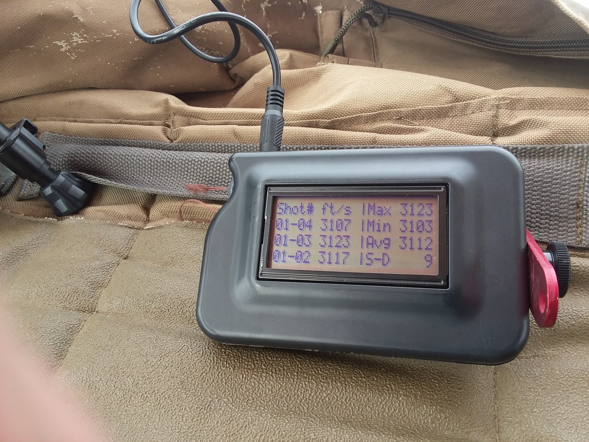

RL16 41.0
3124 @ 65774 Max PSI ( I shot this load and saw no pressure signs and ran 3138 )
100% burn
101.5% fill
RL26 45.5
3074 @ 55935 Max PSI
99.9% Burn
102% Fill
You can push the RL26 to 105% fill and not max pressure and should break 3100 but I don't personally like to compress a load that hard. 41.0 of RL16 was a nice light crunch on my load. My load I've run the last 400 rounds is 39.3 of 16 at 3025 and can just hear powder slightly rattle, it shows 98.6% fill and 59,086 PSI for comparison.

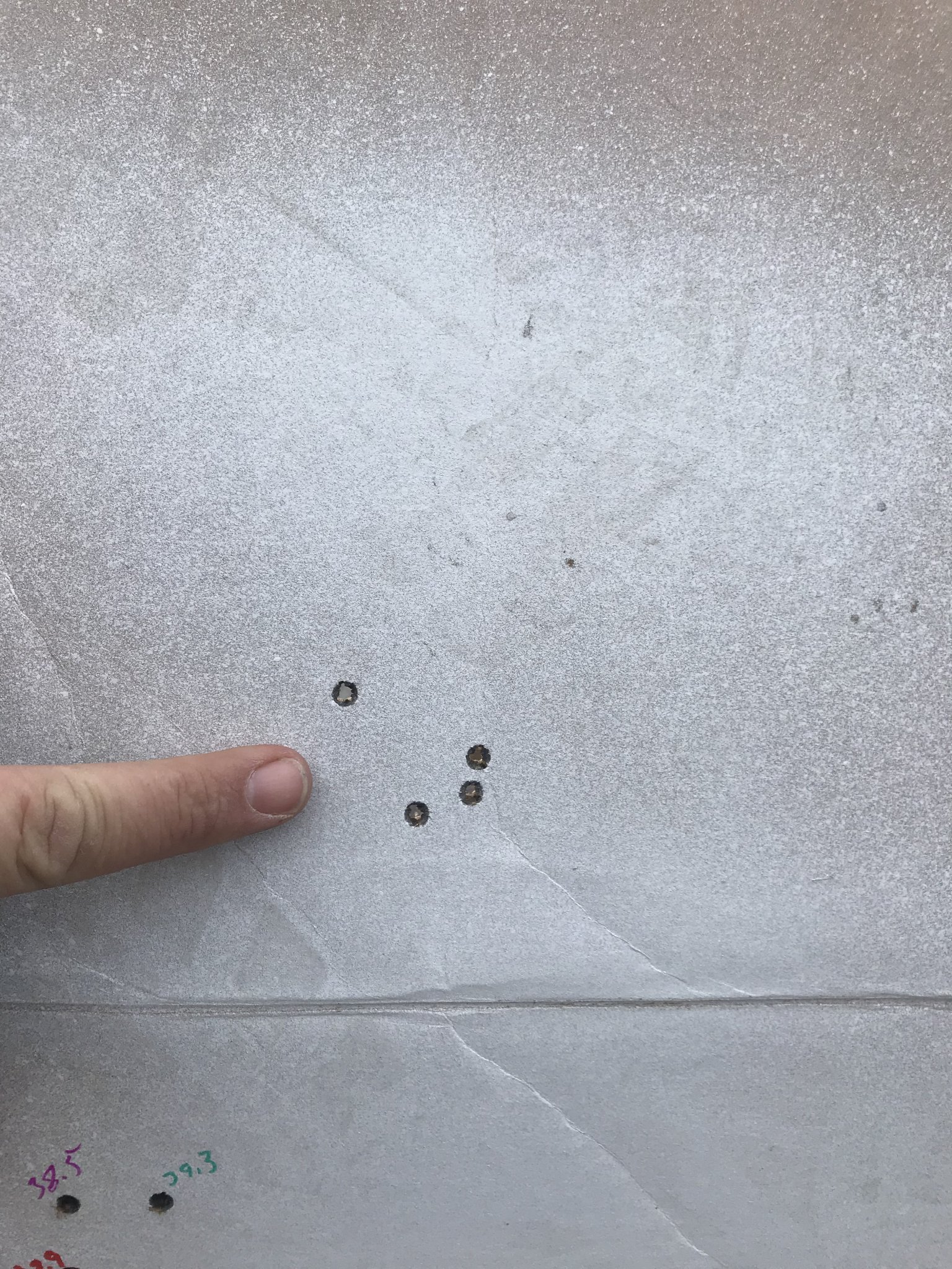

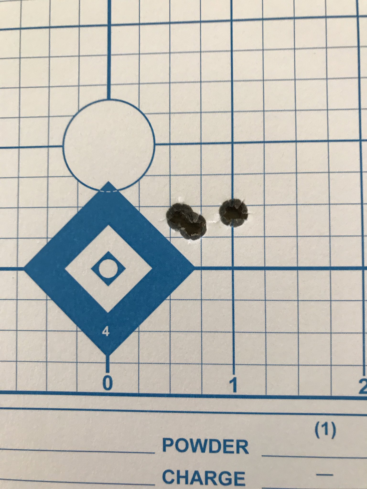

I got my new 6x47 barrel out today to run the first few rounds through it and ran a ladder test. This is my second barrel in this cartridge.
I had 4 of my guessed load left to shoot a group after ladder. I’m pretty happy with how it shoots the 115 dtac even with the flier (or maybe I shanked it) it’s a 1.44” group. Oh yeah the range was 510 yards!
I had 4 of my guessed load left to shoot a group after ladder. I’m pretty happy with how it shoots the 115 dtac even with the flier (or maybe I shanked it) it’s a 1.44” group. Oh yeah the range was 510 yards! View attachment 6999219

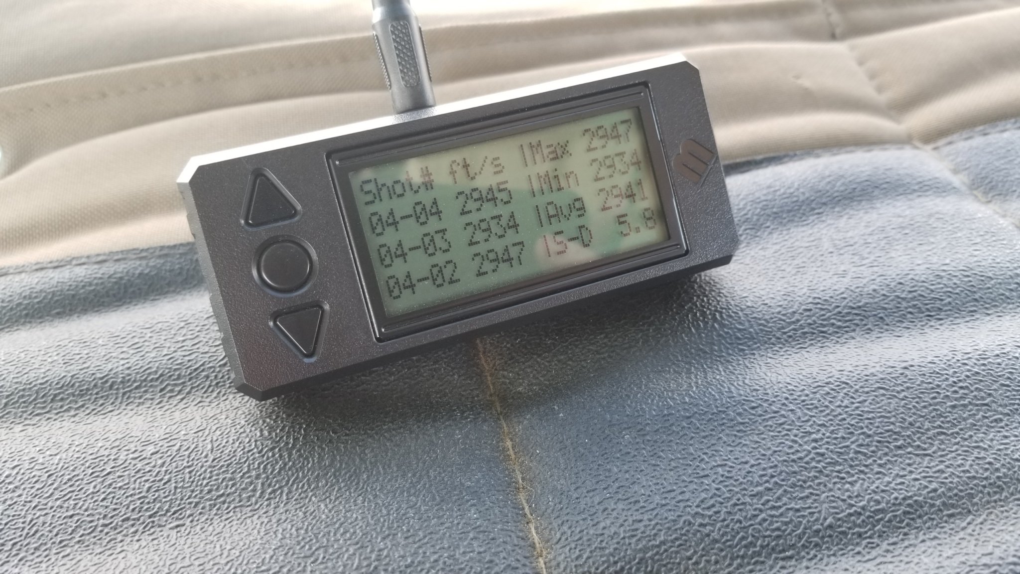

I’ve just been loading 38.1 grains of 4350 behind a 115 DTAC. Haven’t shot over a crono yet but I estimate they’re going right about 2900 based off checking dope out to 1100.
I plan to target a node below 2950 in hopes of getting a little extra barrel life.

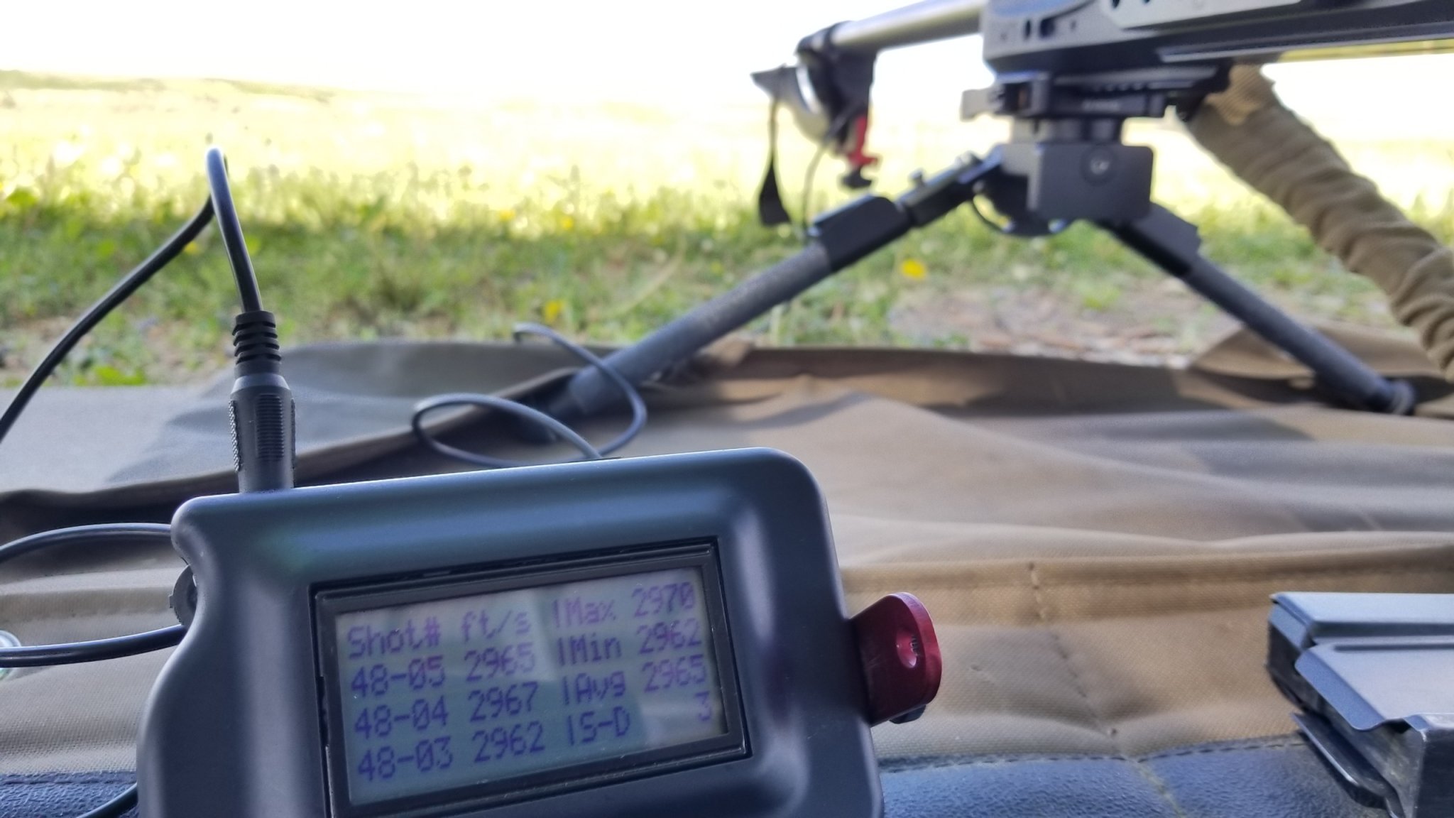

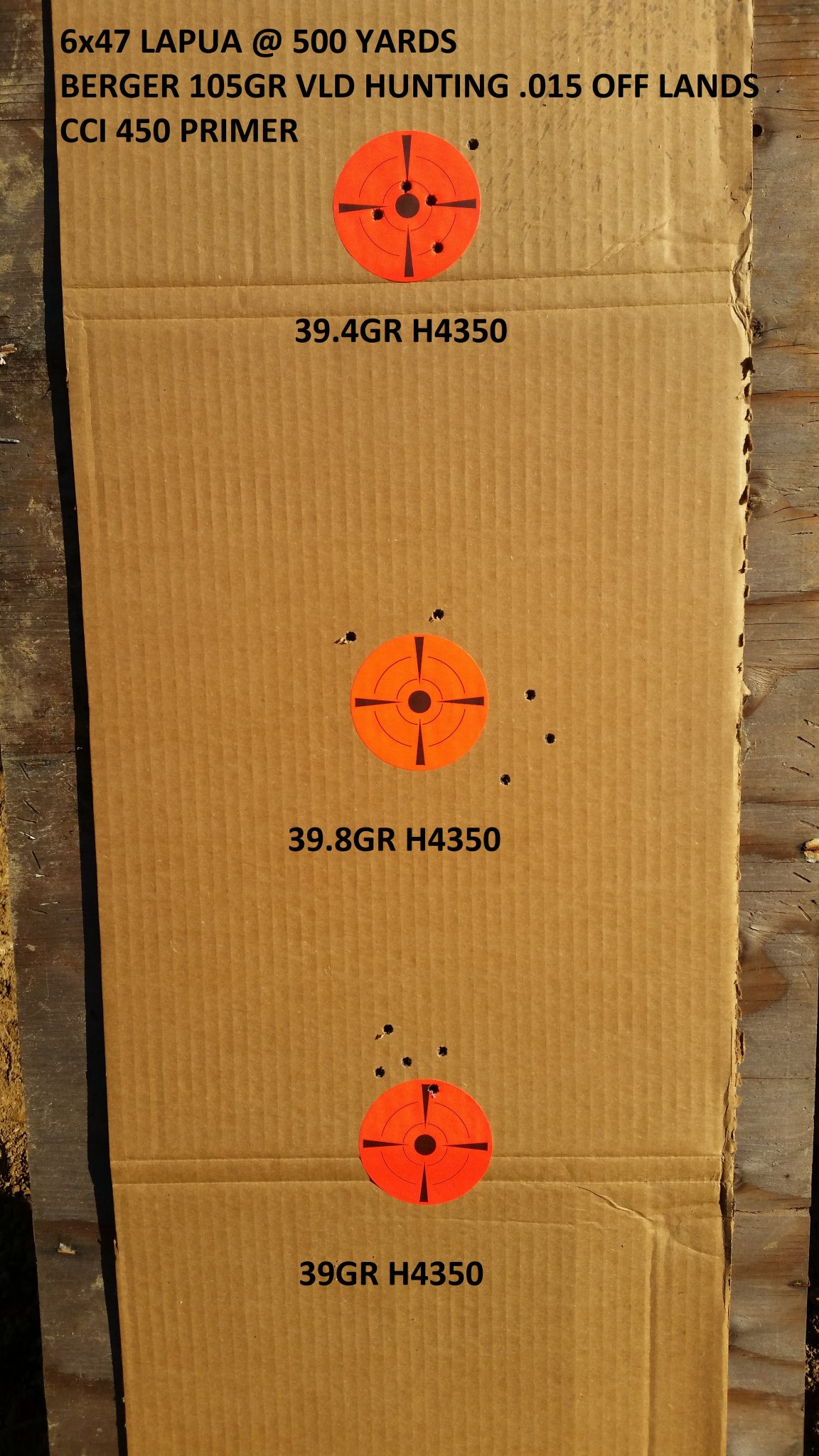

40.1 gr h4350
105 berger
28" 7.5tw Bart
.010 off
Ammo sat out for about 45 min with rifle, both were cold....10° real feel and was shooting .224v earlier so just set off a quick few. About -12fps avg and sd a bit higher, but pretty much on par with late summer chrony data.
7035528

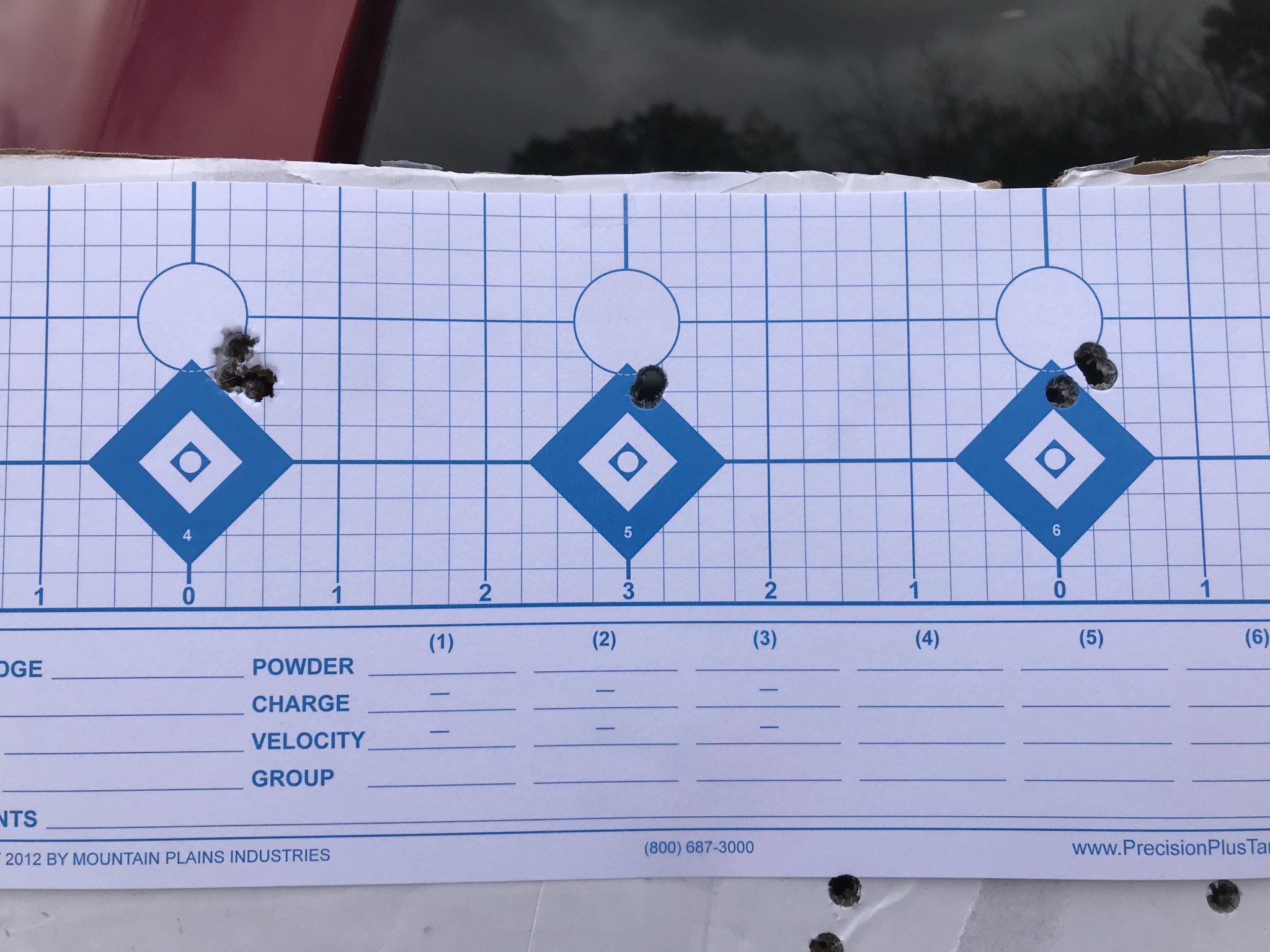

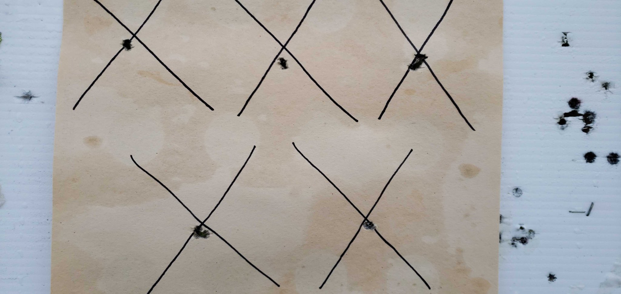

Ladder testing with a new 6x47 barrel using varget & 105 hybrids. I'm surprised more people don't use this combo.
What barrel twist and reamer?
28" 7.5T bartlein. Reamer has about .003 neck clearance and .120 freebore, but I can probably get a copy of the print from my gunsmith if you wanted more details. I've run berger 108's and dtacs with this reamer. The 108's shoot great, but I think I need a bit more freebore with the dtacs. After a few firings I think I got a donut and it started giving me weird fliers. The 108's and 105's sit well above it.

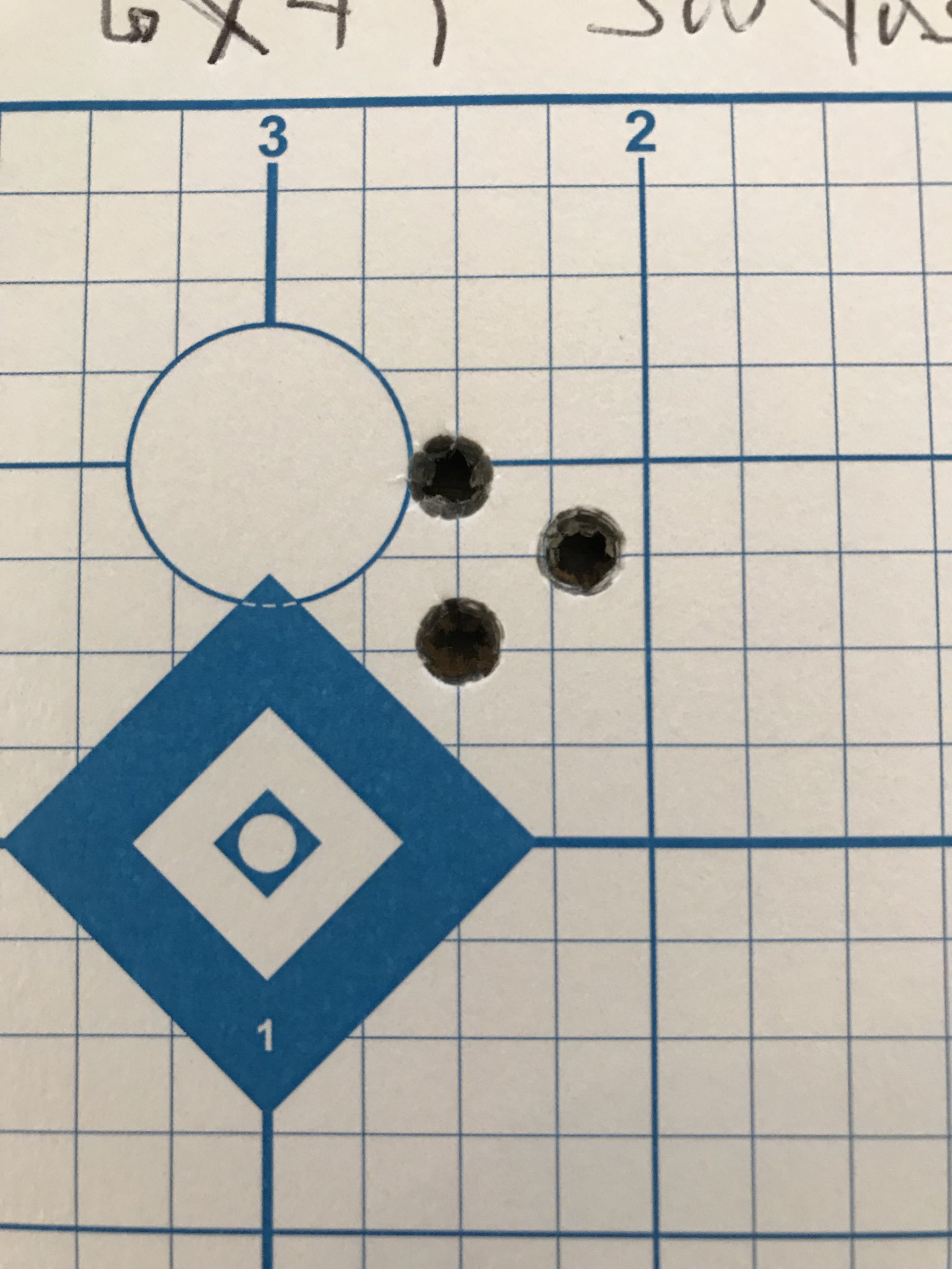

I built one with a Remington 700 action I had. I trued the action up and chambered a 28" Brux 7.83 twist heavy varmint barrel up for it.
I used a Manson reamer with a .272 neck diameter and .105 freebore. Shot these groups @500 yards to verify some load data. I built this rifle to do some long range prairie dog work. So far it has been a hammer.
Took my load out to 300 yds. Shot 6 groups, all under .6 moa
These are the 2 best. One was .407 CTC .136 MOA
This is shooting better than my 6br.

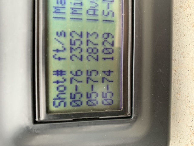

Shot 25 rounds at the lower OBT node with RL16, 2880 FPS. Groups down range were impressive, 1/2 moa or better from 400-1000. But, I had two rounds act really funny. One at 1050 FPS and one at 2350 FPS. The 1050 FPS round definitely was subsonic, and the 2350 FPS round felt weird and the trace dropped way low and didn’t make it to the target. Would running at 42k psi be an issue, or more likely something with the primers or maybe something getting in the flash holes?
This is exactly what I eliminated by forming my brass with large primers. It's getting cold this time of year and summer time loads start acting goofy. I believe this is inadequate ignition. Just try making 10 cases from 6XC large primer brass and I'll bet your problem goes away.
Don't want that, aye?!
